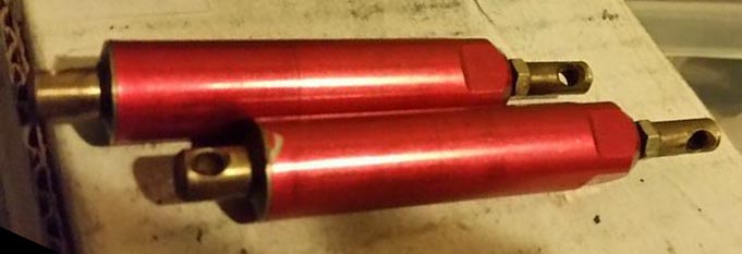

No, the #1886 shocks are a little bit shorter than the FM71 shocks, and was an upgrade for the Scorpion series and some gas buggies.
- TomEG
- Posts: 214
- Joined: Sun May 10, 2009 4:01 pm
- Location: Tromsø, Norway (Mariestad, Sweden)
- Been thanked: 3 times
Re: Old Turbo Rocky worth anything?
Thanks for reminding me of the FM-71 shocks. I had forgotten about them. And to add even more to the confusion, both the FM-71 and CB shocks came in v1 and v2 versions, with the v1 having the fill cap at the top, and the v2 at the bottom. AFAIK the #1886 only came in the v2 bottom cap version.
CB top cap (v1)
CB top cap (v1)
