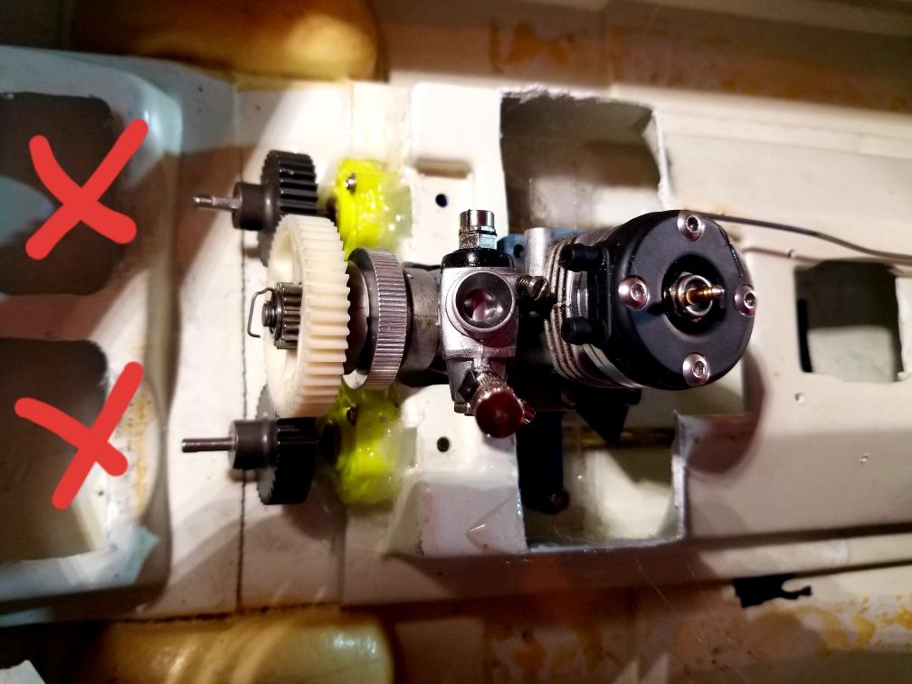

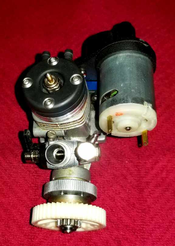

got the engine mocked up. modified rc10gt motor mount in there...cant see it in pic. the big white gear is the diff gear from a Hotshot/Frog modified to fit that clutchbell. the two red x's are where the original electric motors were

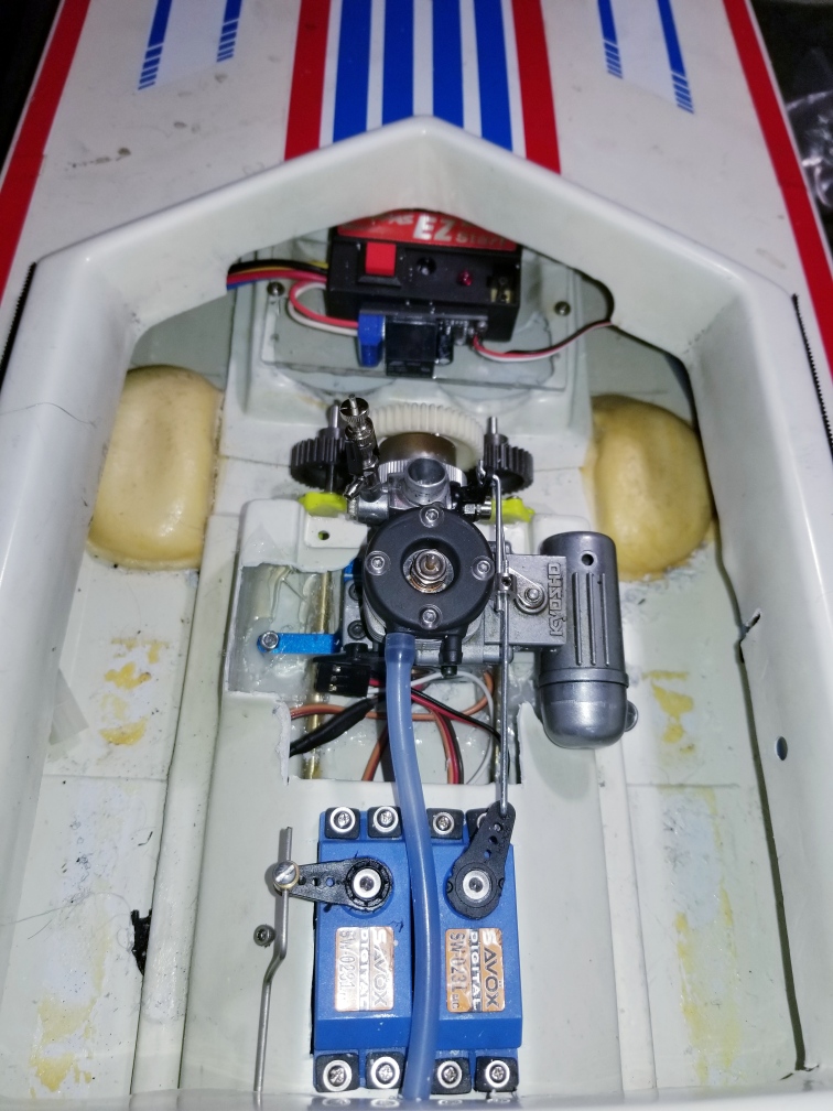

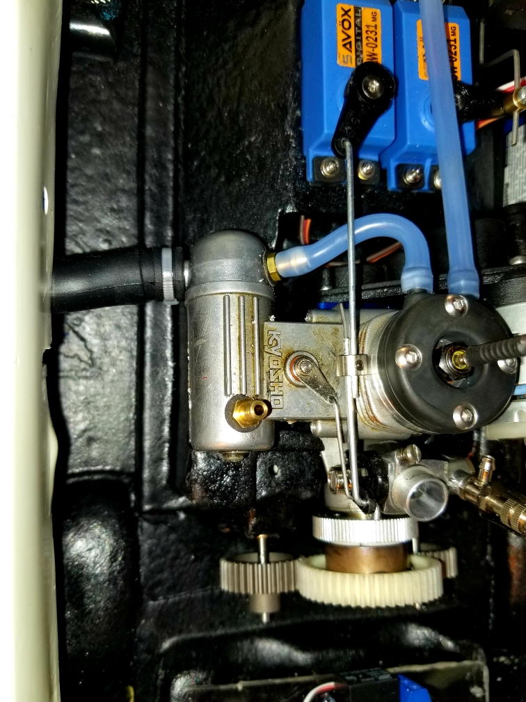

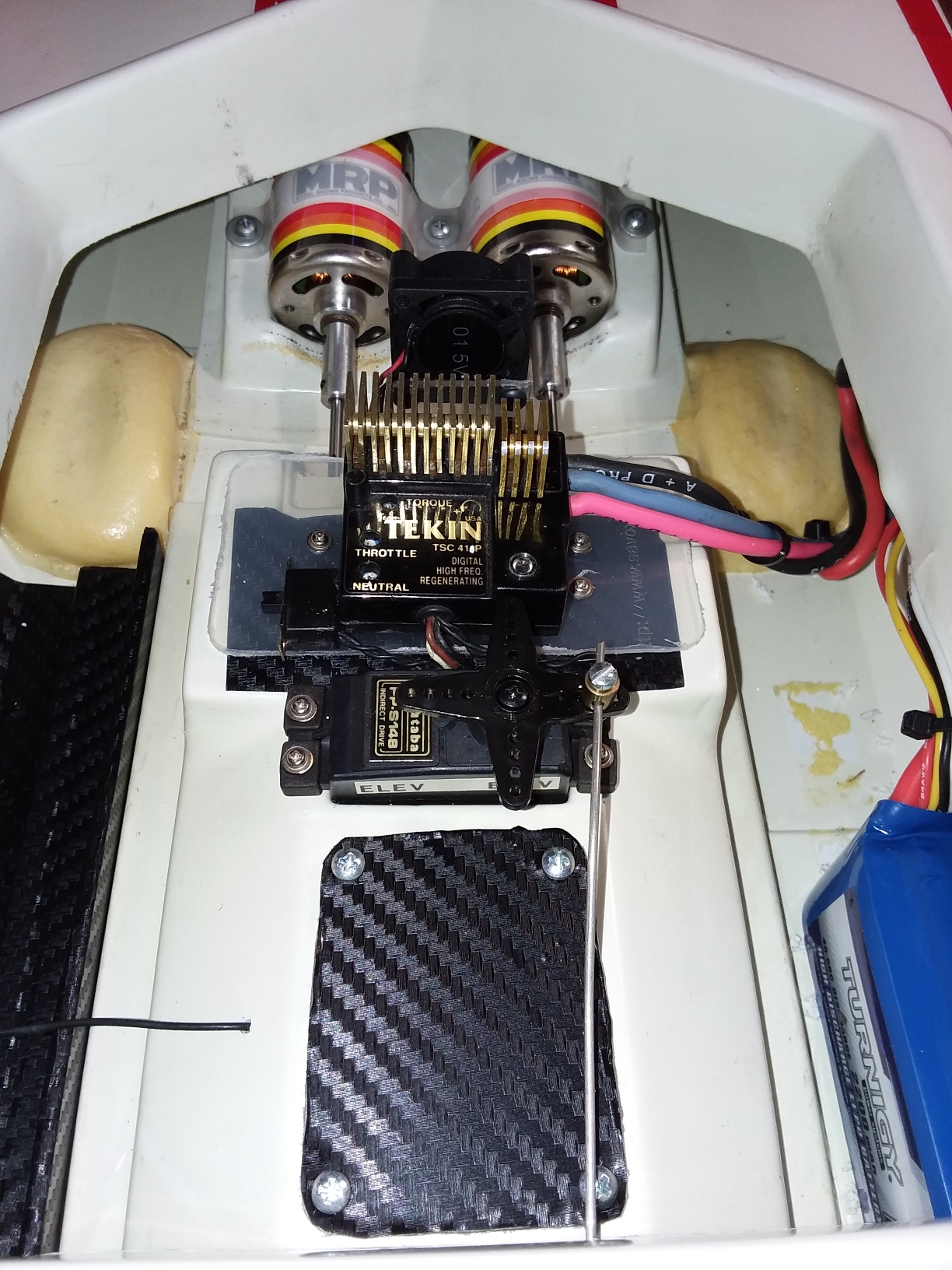

got some rigging done...heres a before and after up till now...alot left to do...tank, battery, electric start, water lines etc. gonna have the water come out the exhaust like a real boat to it runs real quiet. got a custom baffle in the muffler to plus a valve off the throttle to the muffler too. it will get dismantled once its complete and painted inside the hull

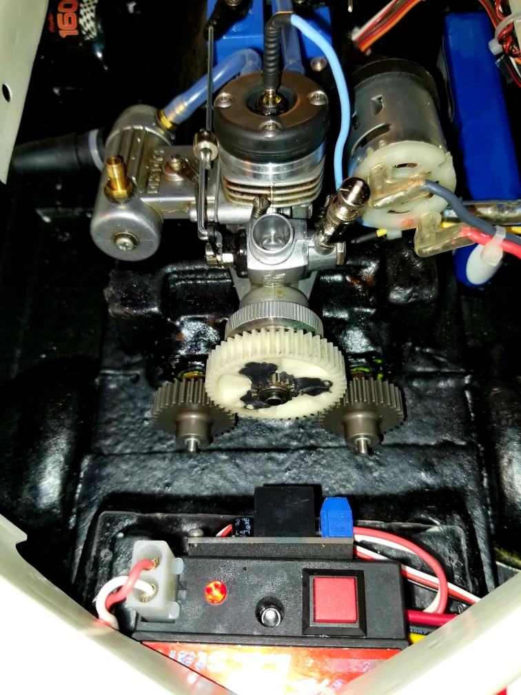

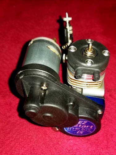

got the ultra rare K H B conversion kit in. it fit perfectly on my vintage 1986 O.S. CZ-2 engine. i hooked it up....hit a button on the transmitter and the engine turned right over and lit the glow plug.....gonna be sick when its all done....shocked no one digs it☹

Thanks! i got the entire bilge painted with black flexseal...drying now...gonna look good...
before i did i wired it all up and fired the engine! all worked perfectly. waiting on a dubro fuel tank but other than that it will be mostly done tomorrow. then if it works on the water i will clear over the entire outside to preserve the old decals and plastic....this things old!

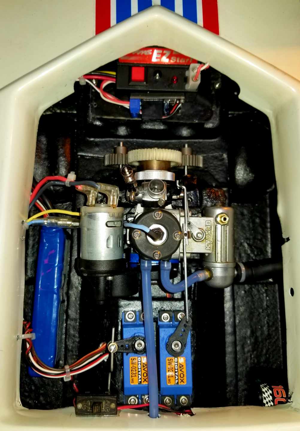

All done except fuel tank....this was a very challenging build....who knows if it will work or not
