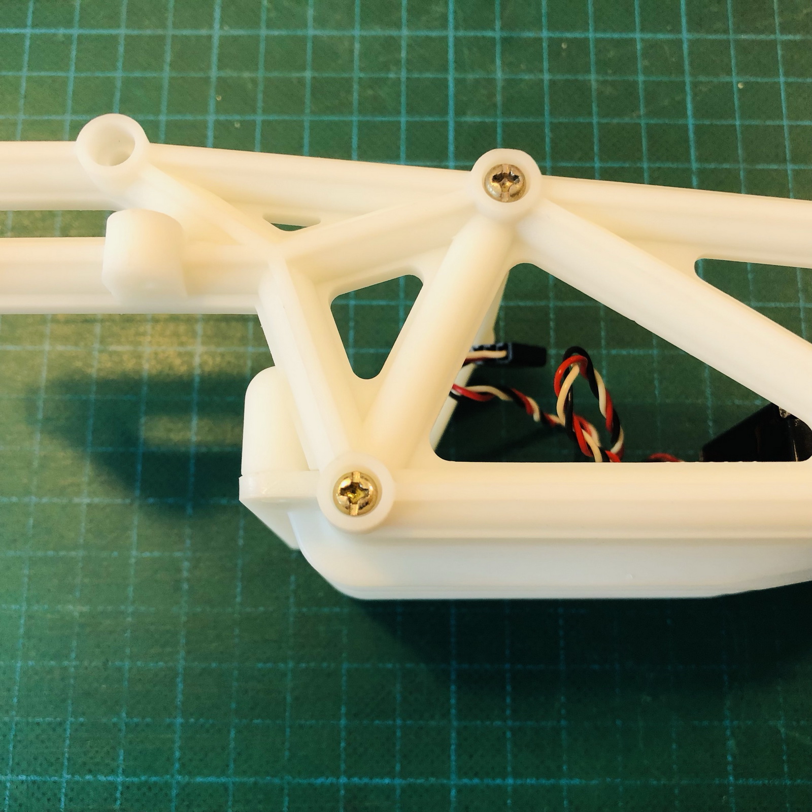

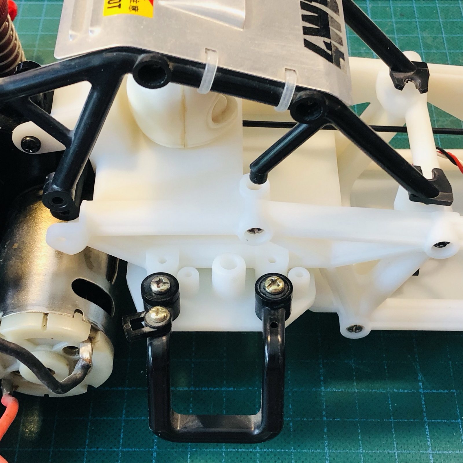

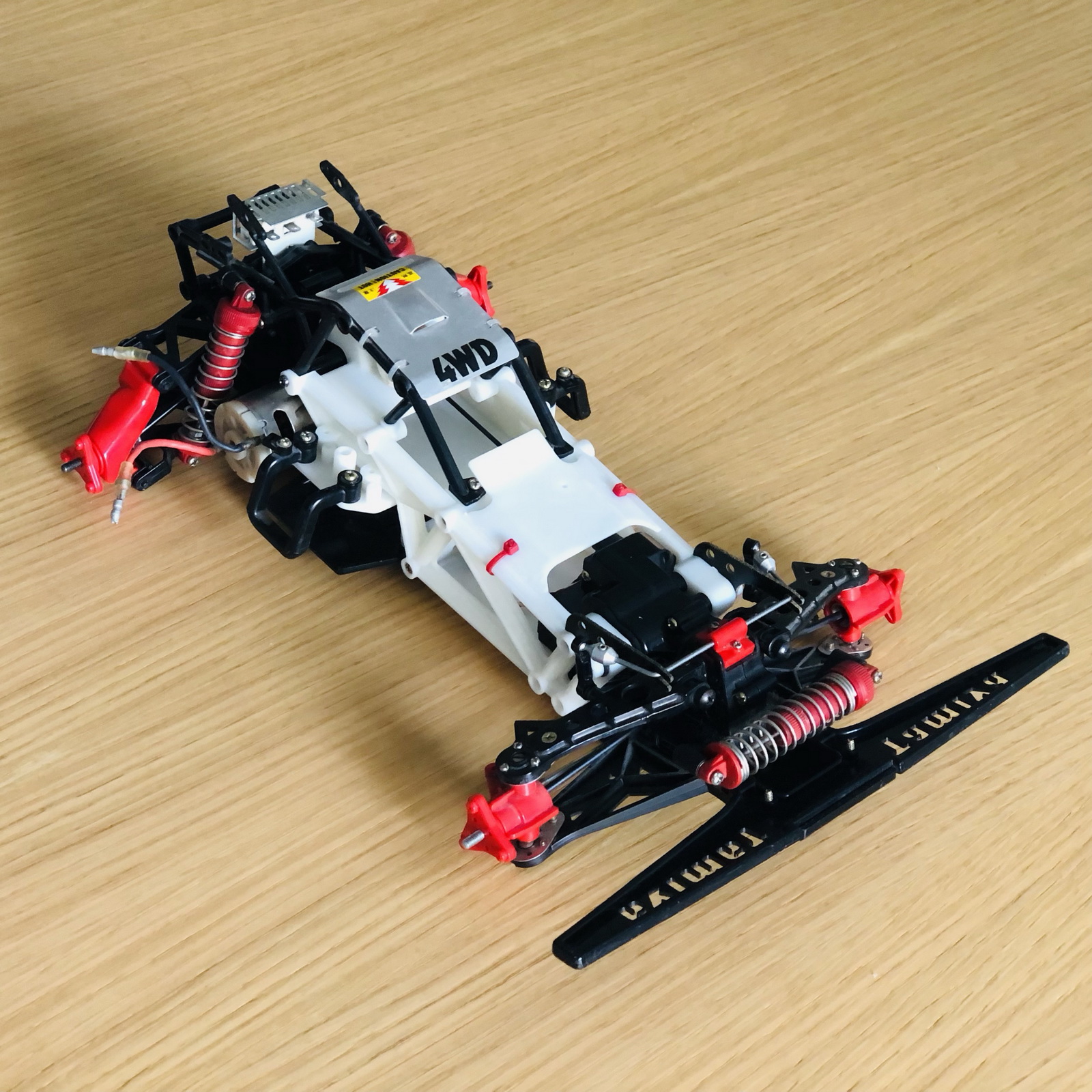

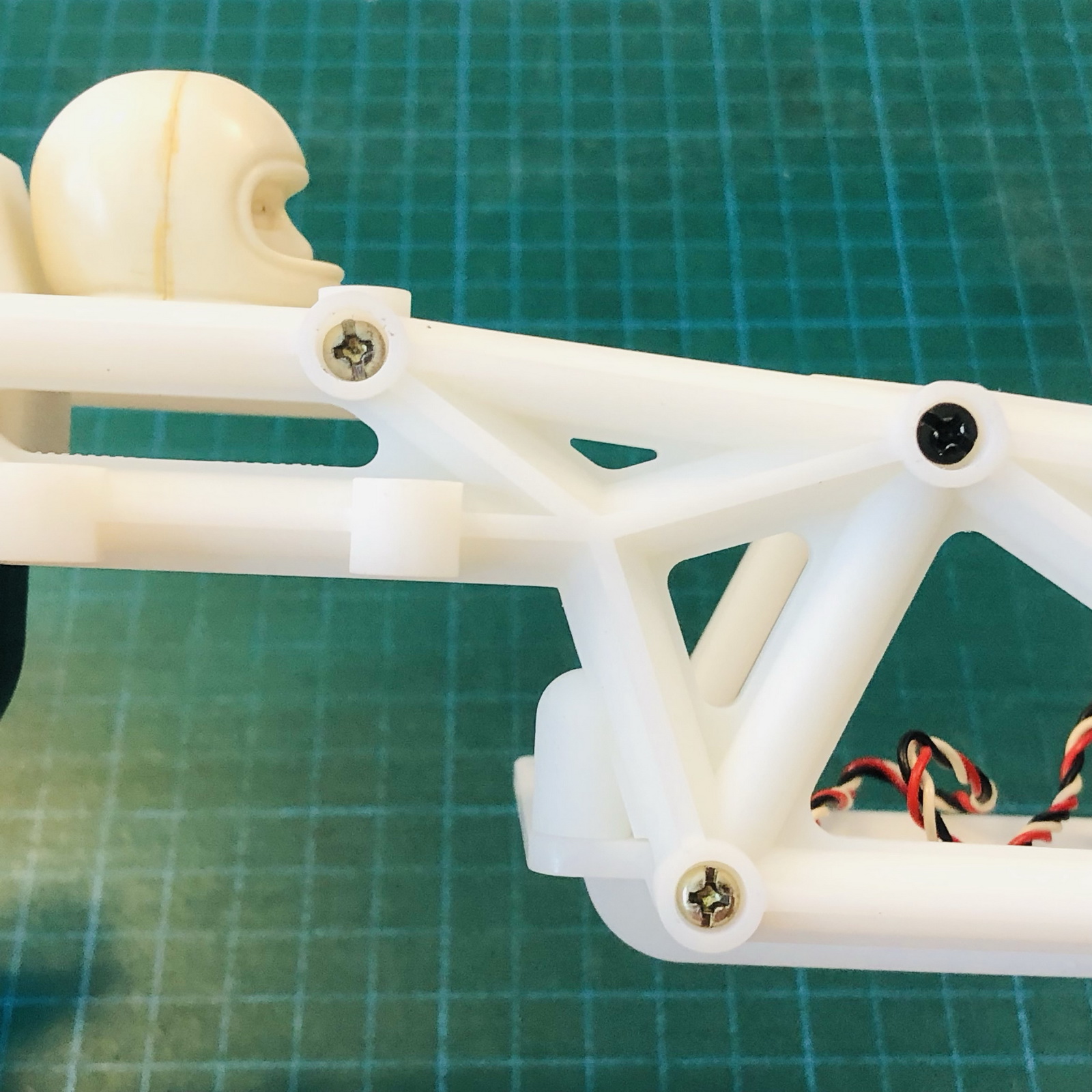

I attach the other screws M3x10 should suffice.
Always pretap the threads before as it can be hard sometimes (use a big handle screwdriver helps)

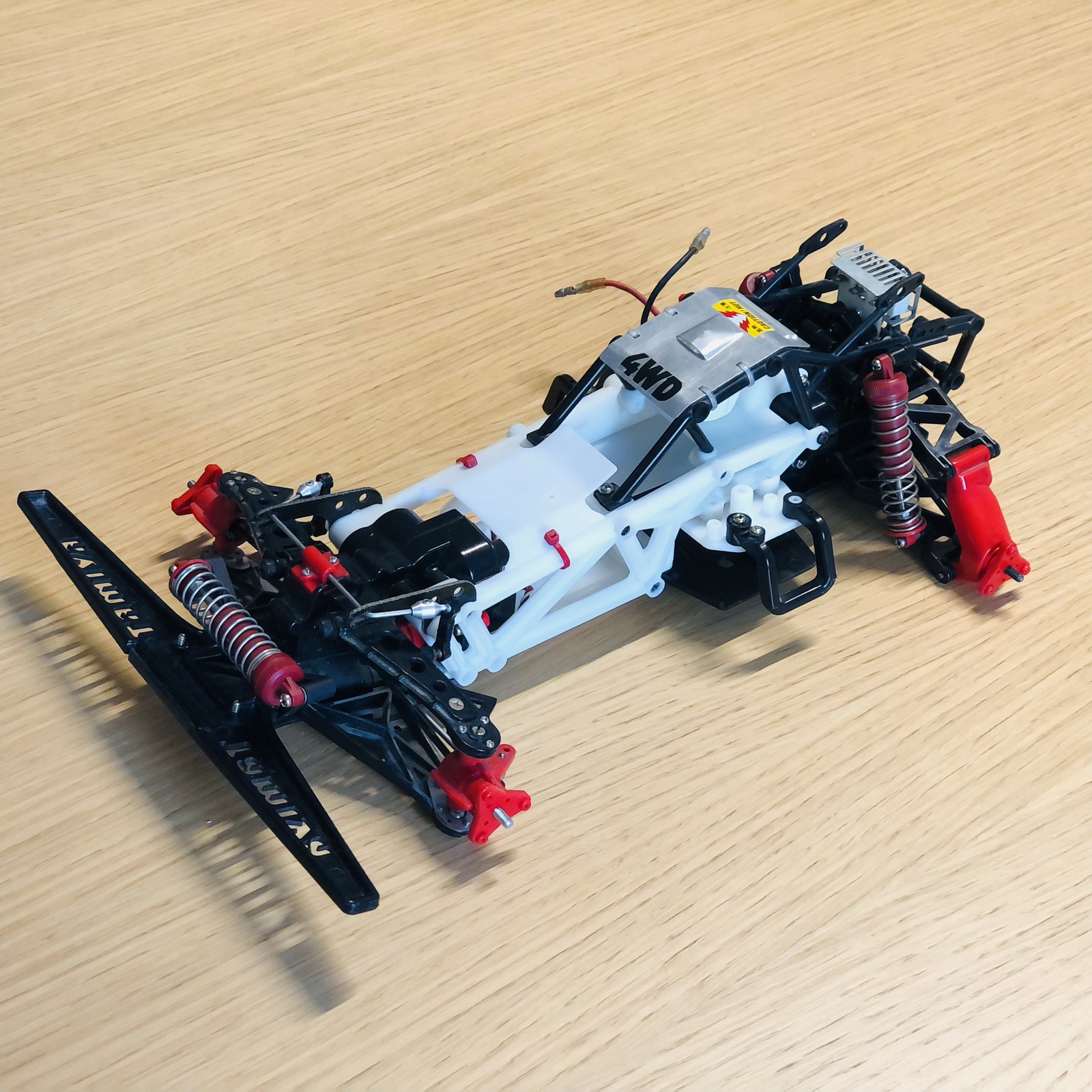

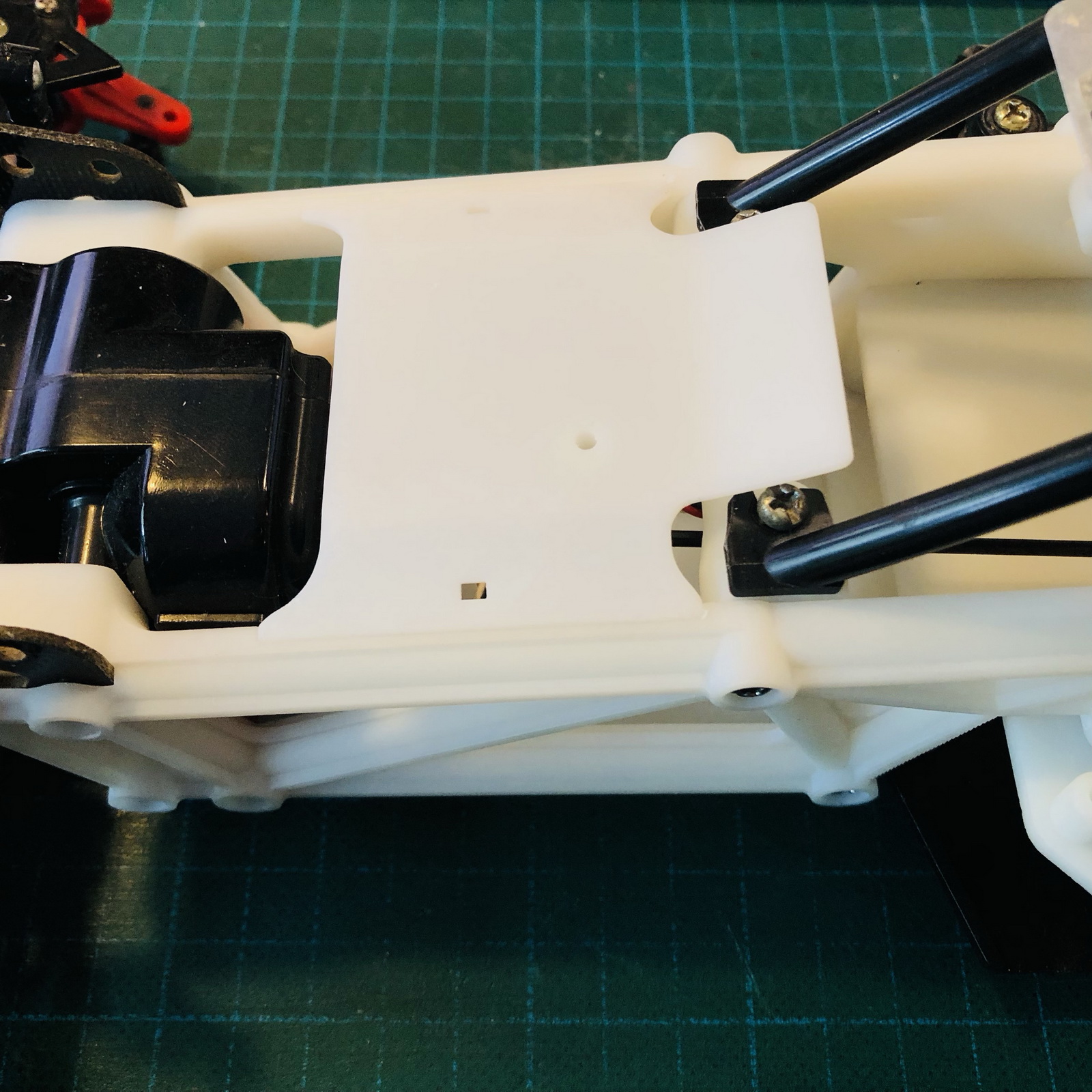

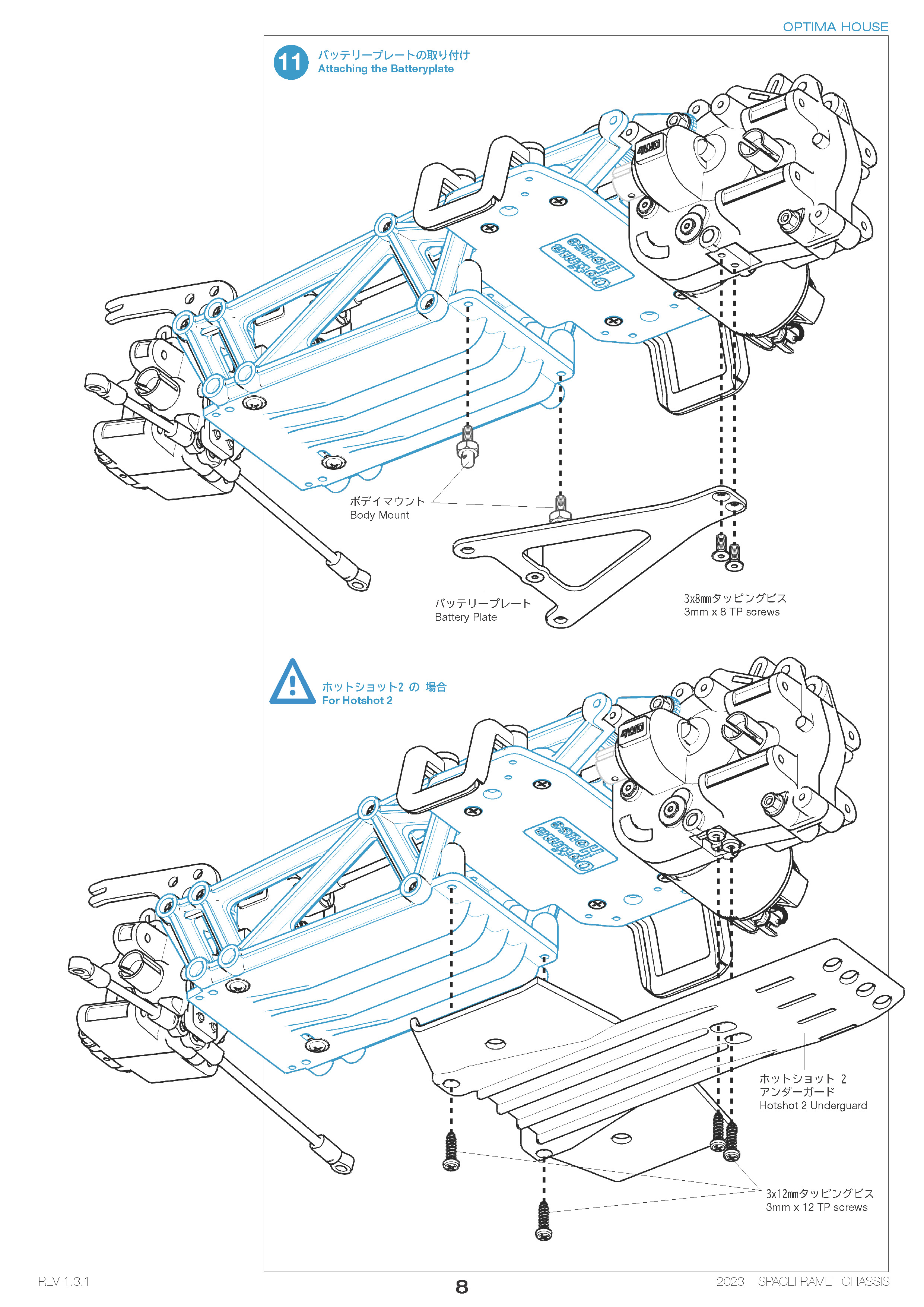

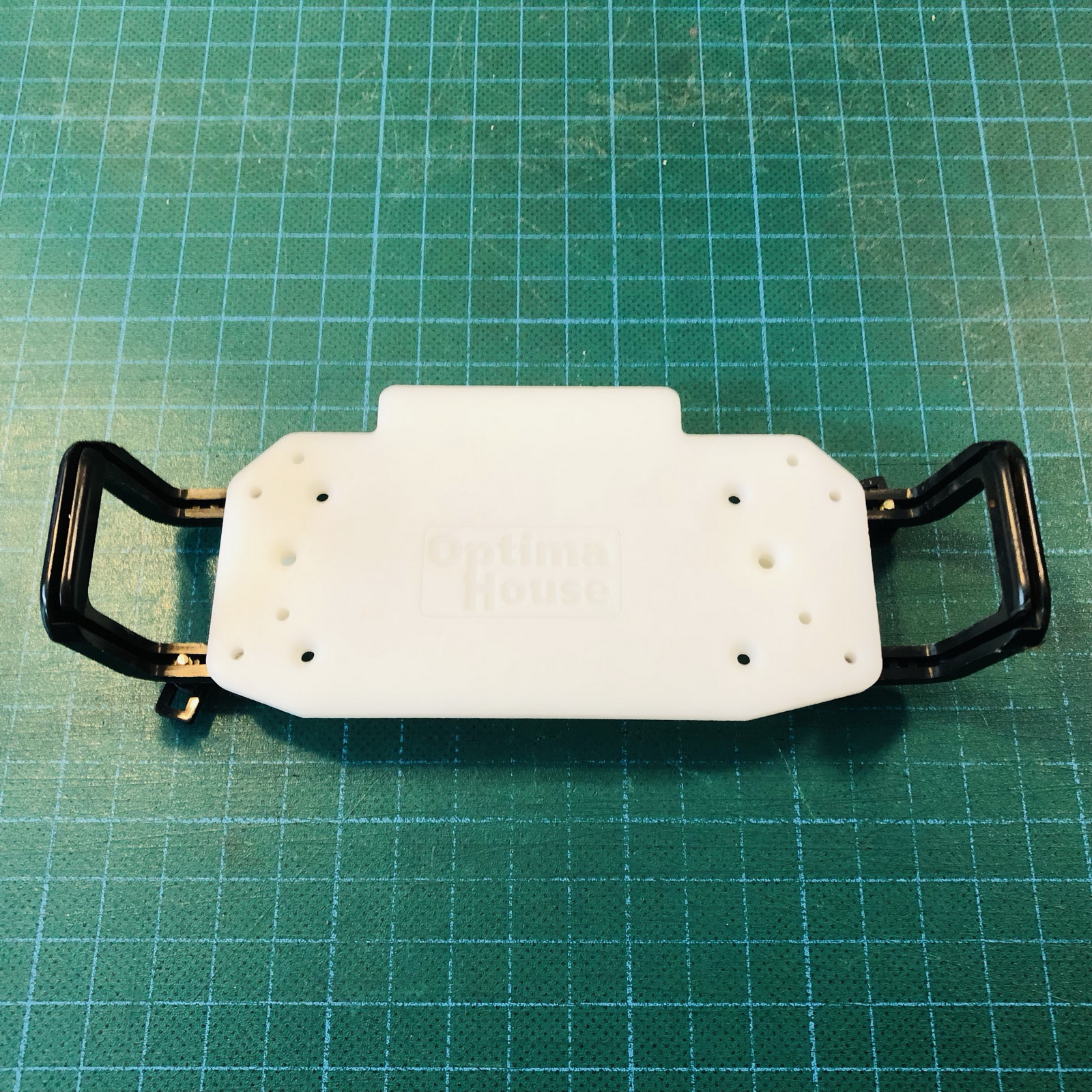

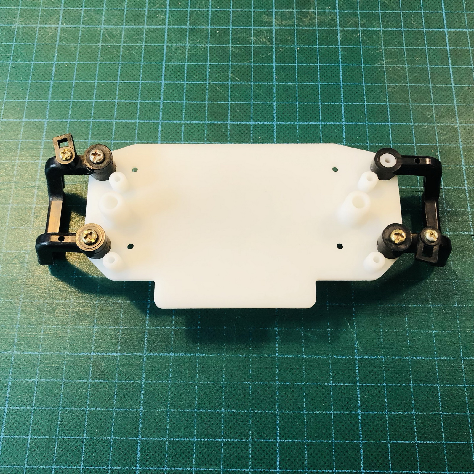

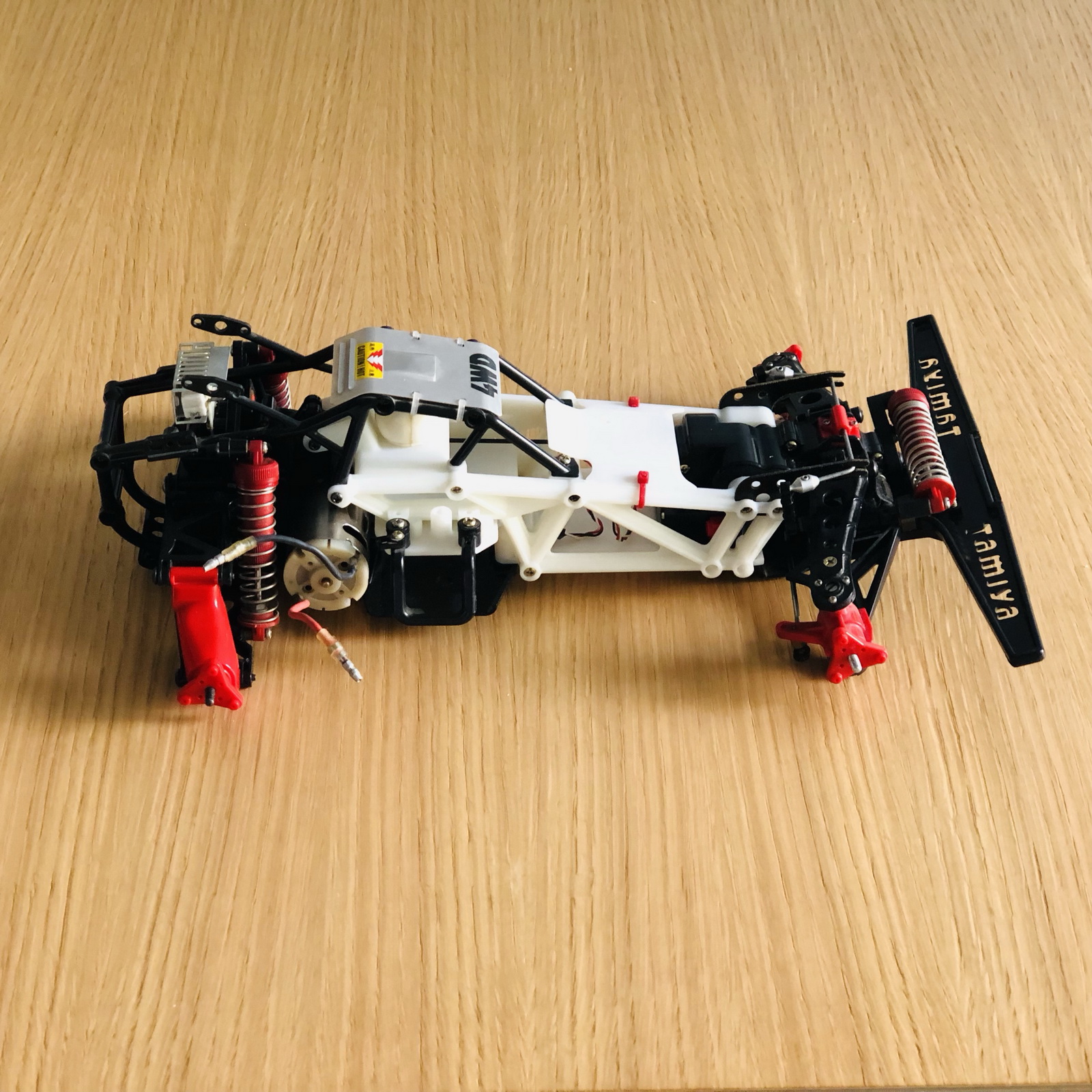

Next is the Batteryplate
I reuse the M3x8 tapping screws of the OG Hotshot.
A bit of Self promo :lol:
optimaforever
Posts: 82
Joined: Tue Jun 30, 2009 1:38 am
Location: brussels, belgium
Has thanked: 10 times
Been thanked: 26 times
Re: Spaceframe Chassis for Hotshot

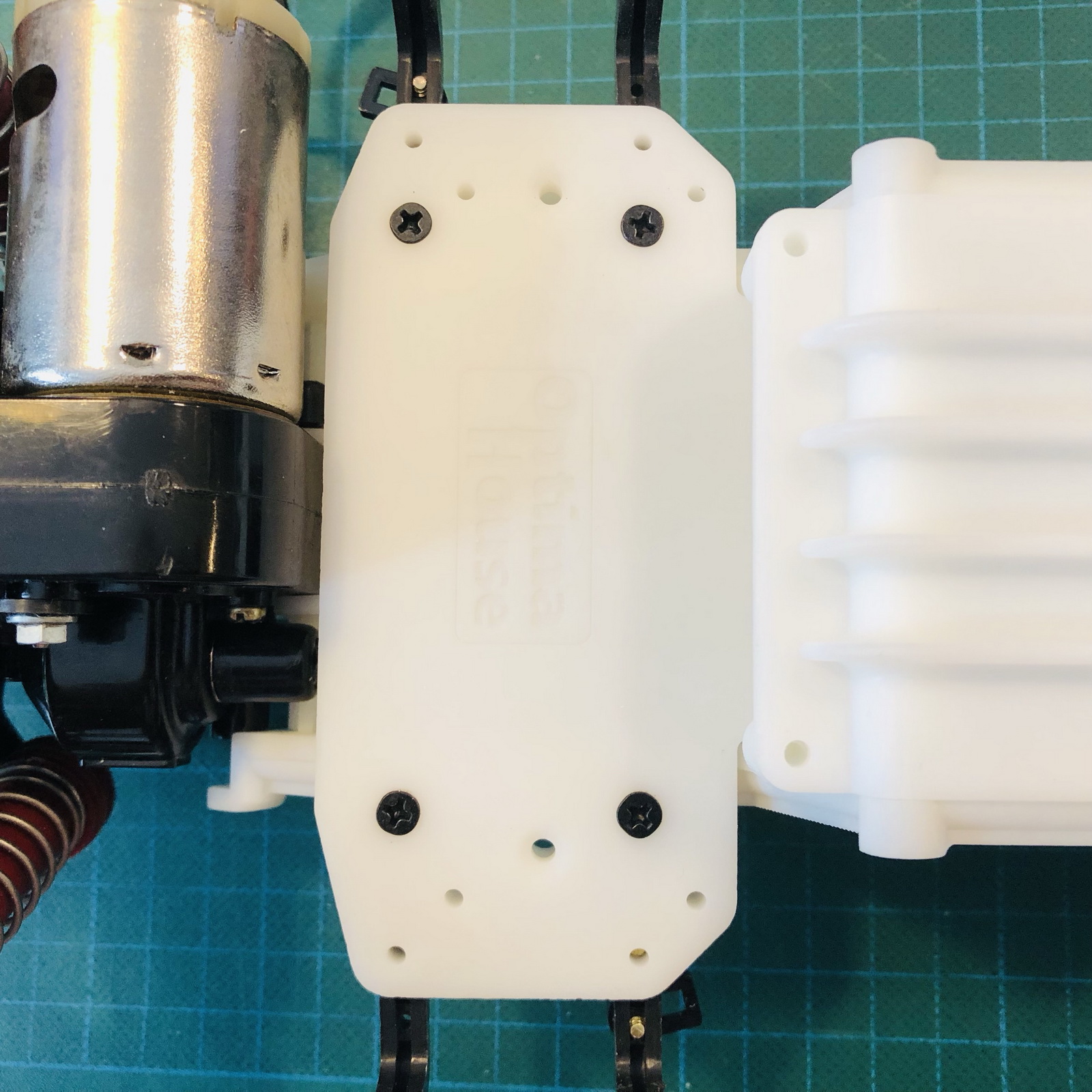

Post by optimaforever »

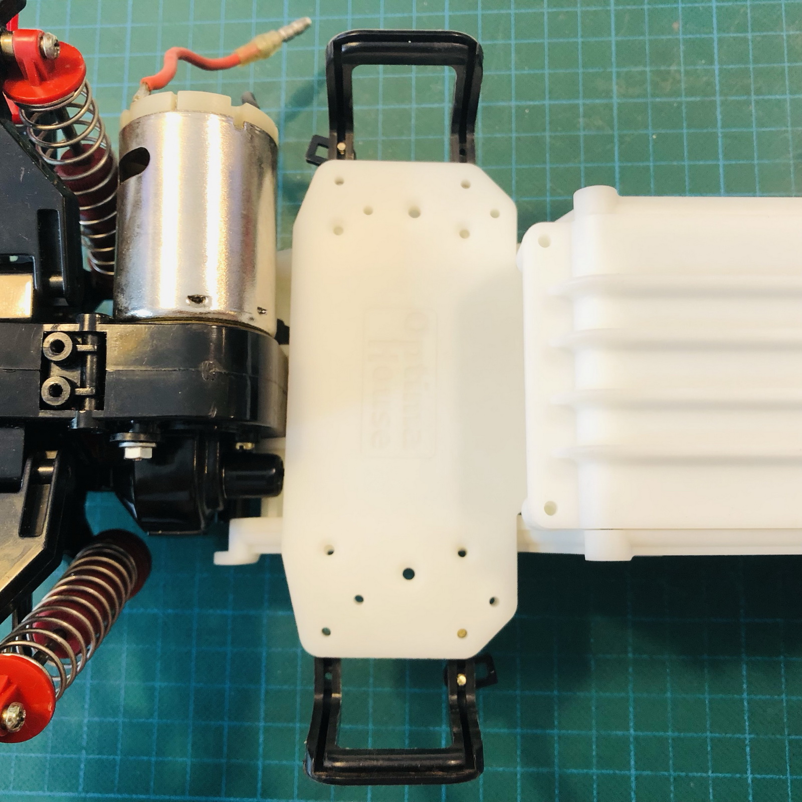

I attach the Batteryplate to the frames with 4 Flathead M3x8 tapping screws...

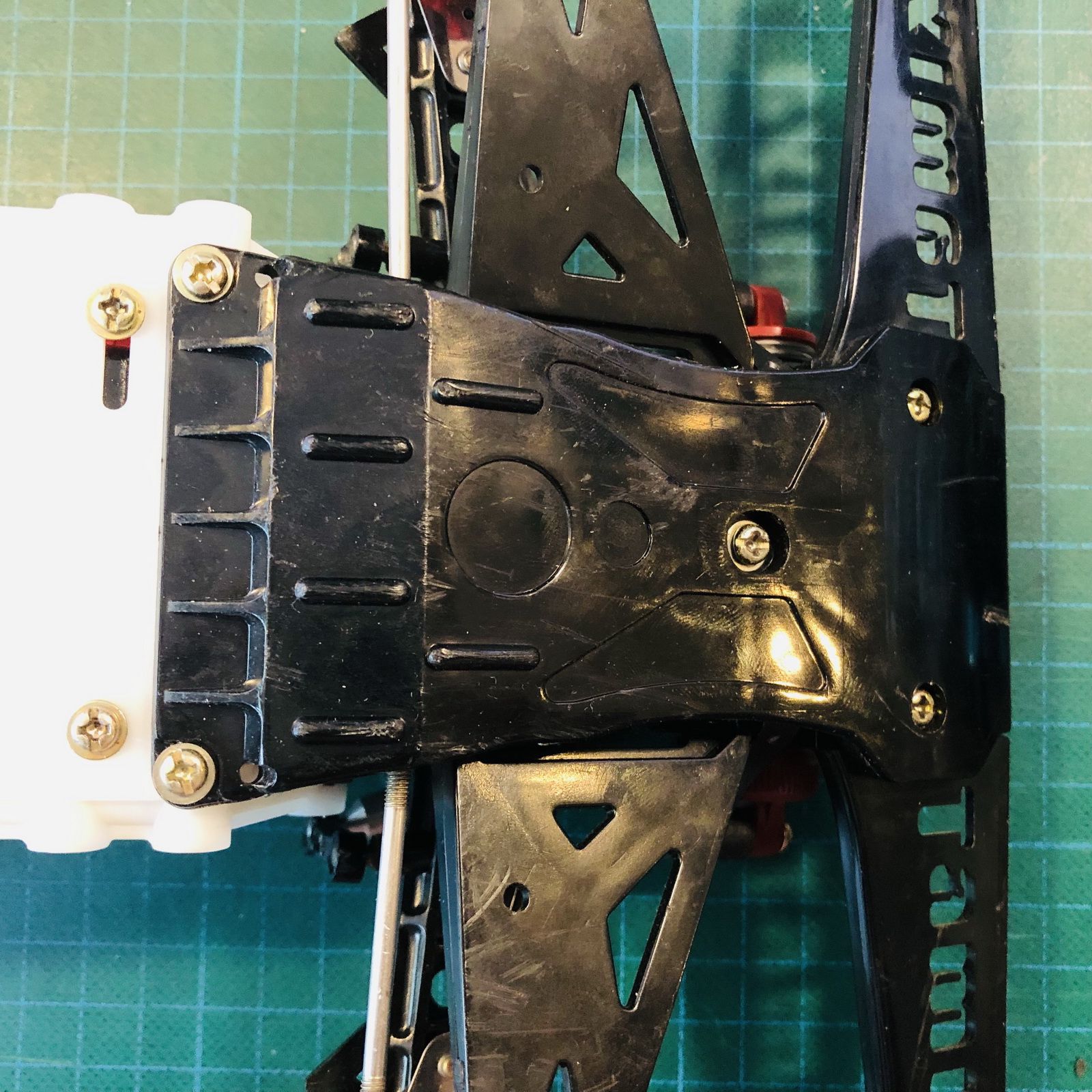

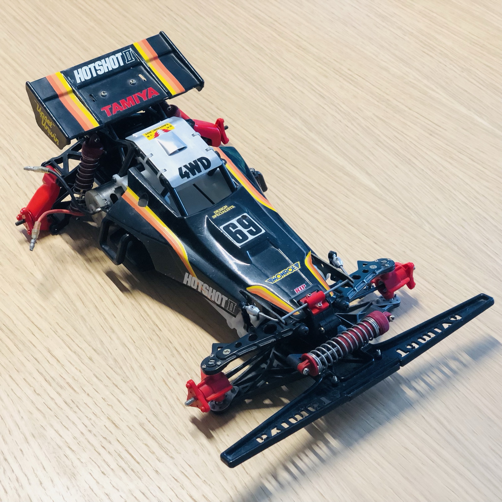

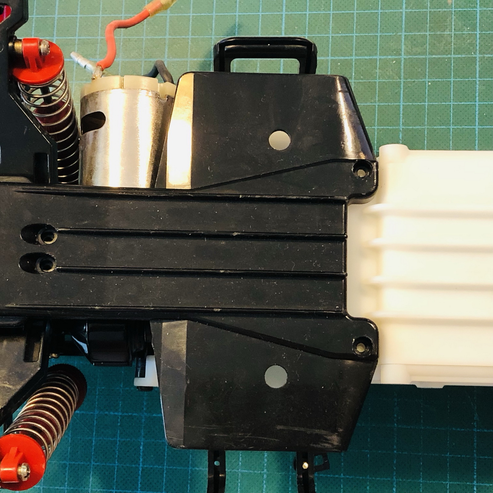

A little check with the Hotshot2 underguard
Yes! good to go

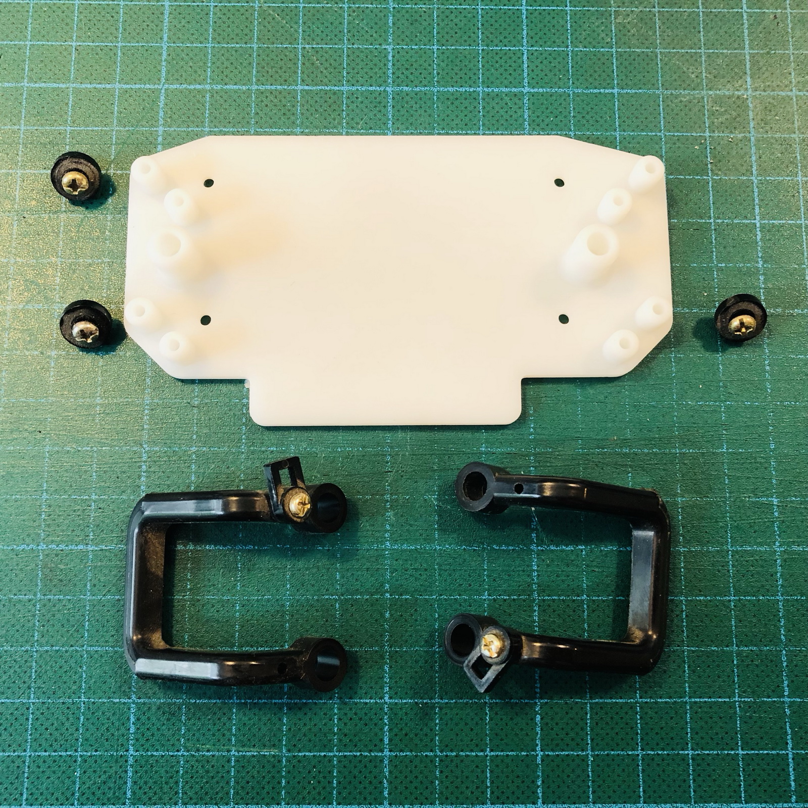

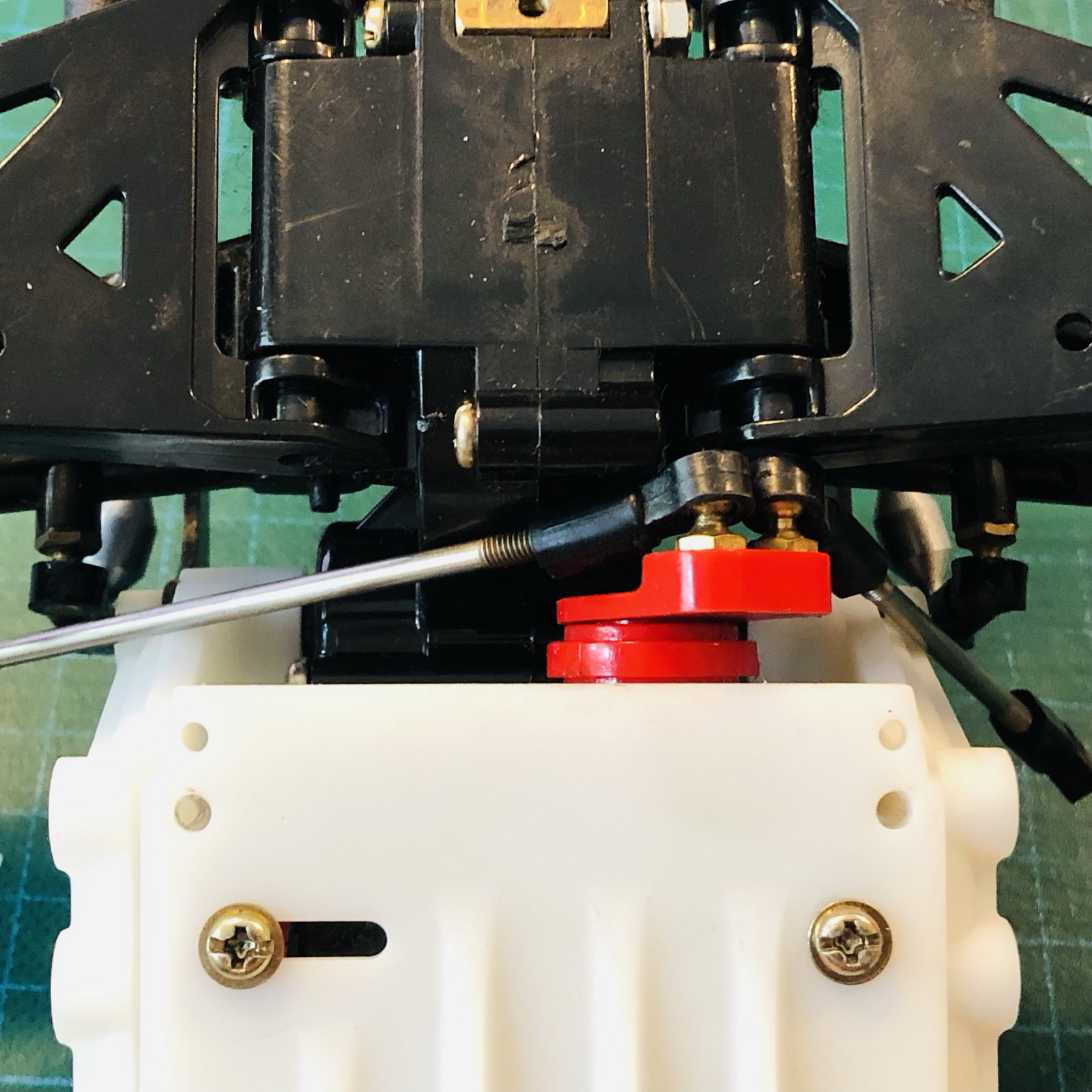

One thing I always forget is the steering rods!!
Now is the time to attach them if you detached them earlier...

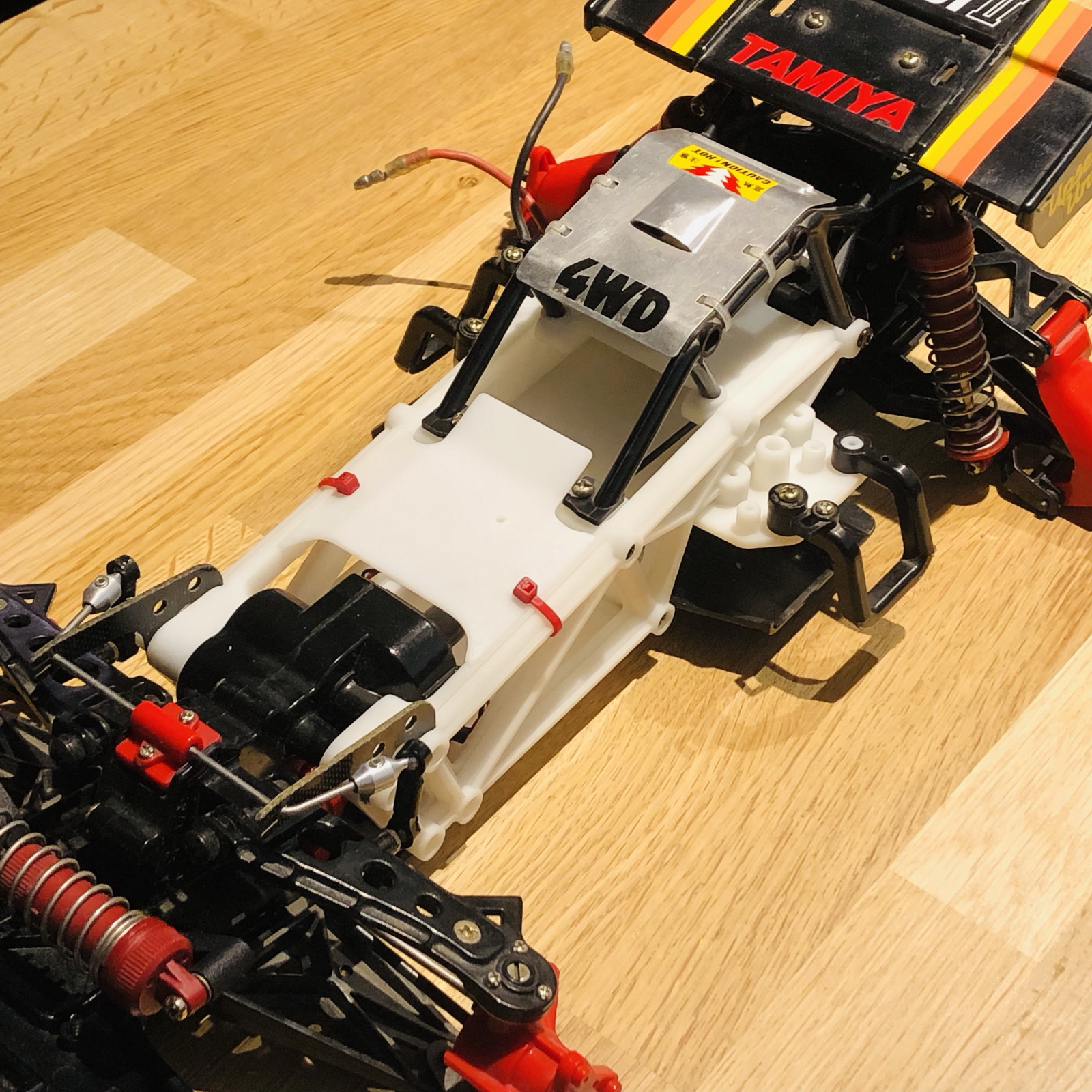

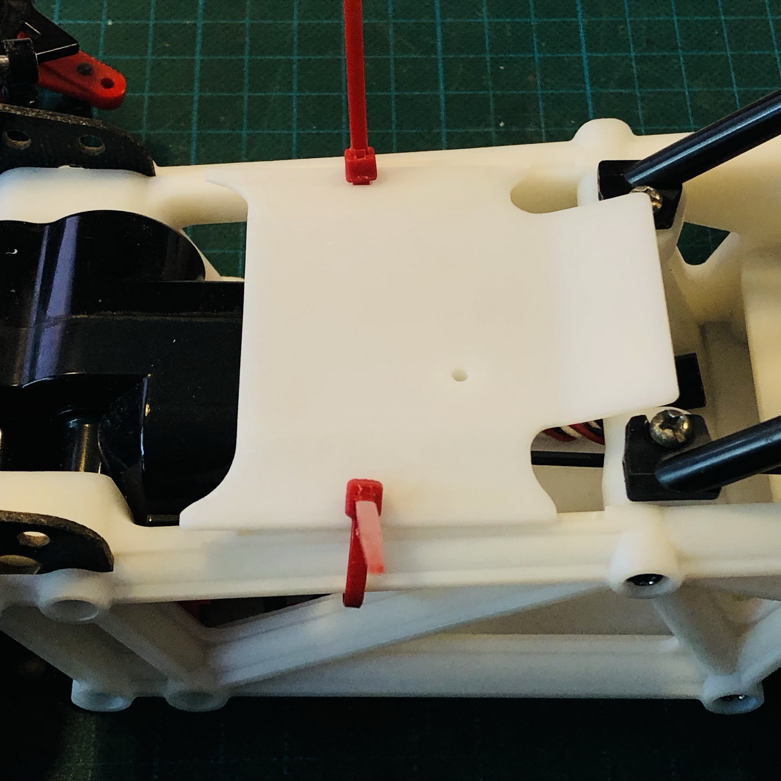

And I can attach the front bumper...
with the OG screws.
optimaforever
Posts: 82

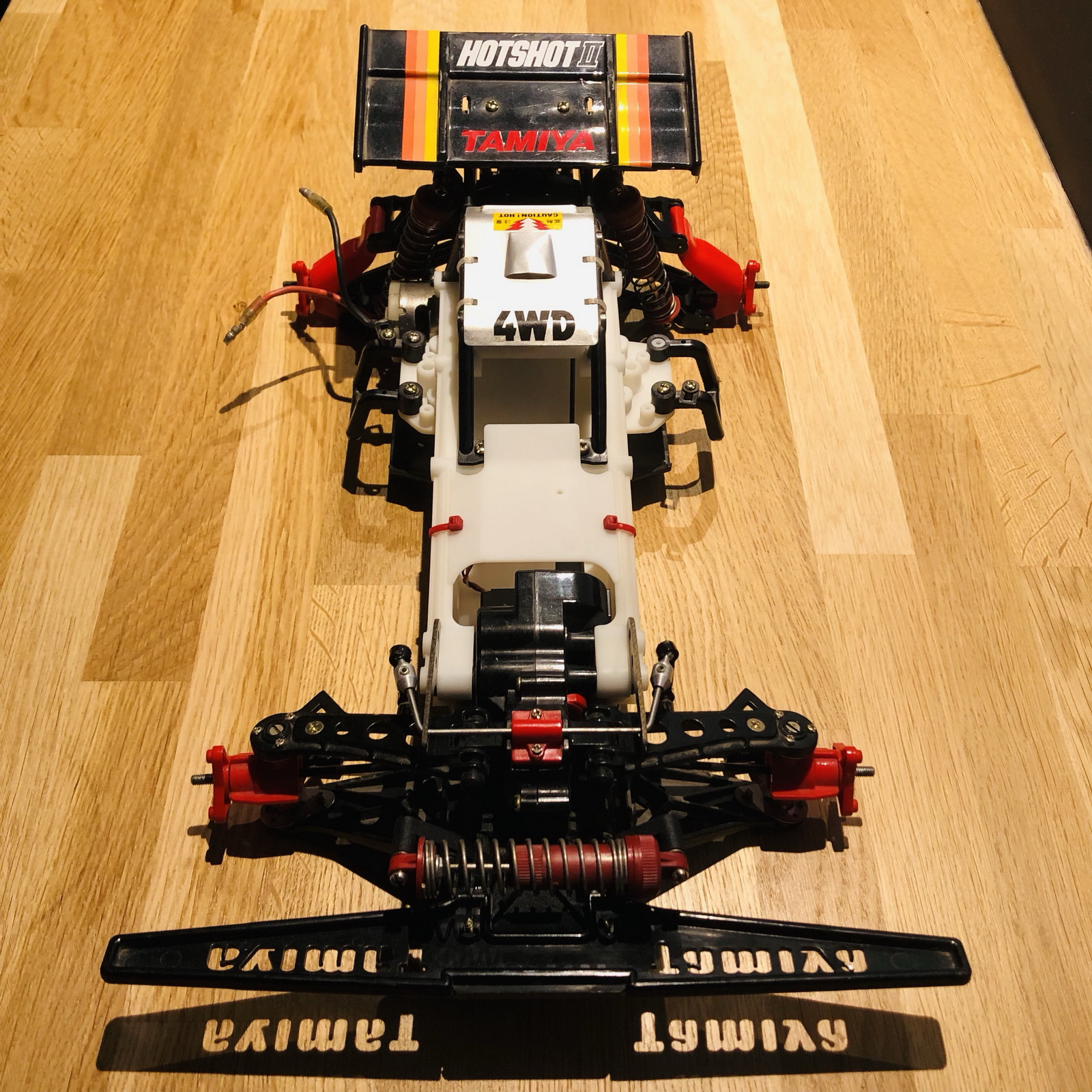

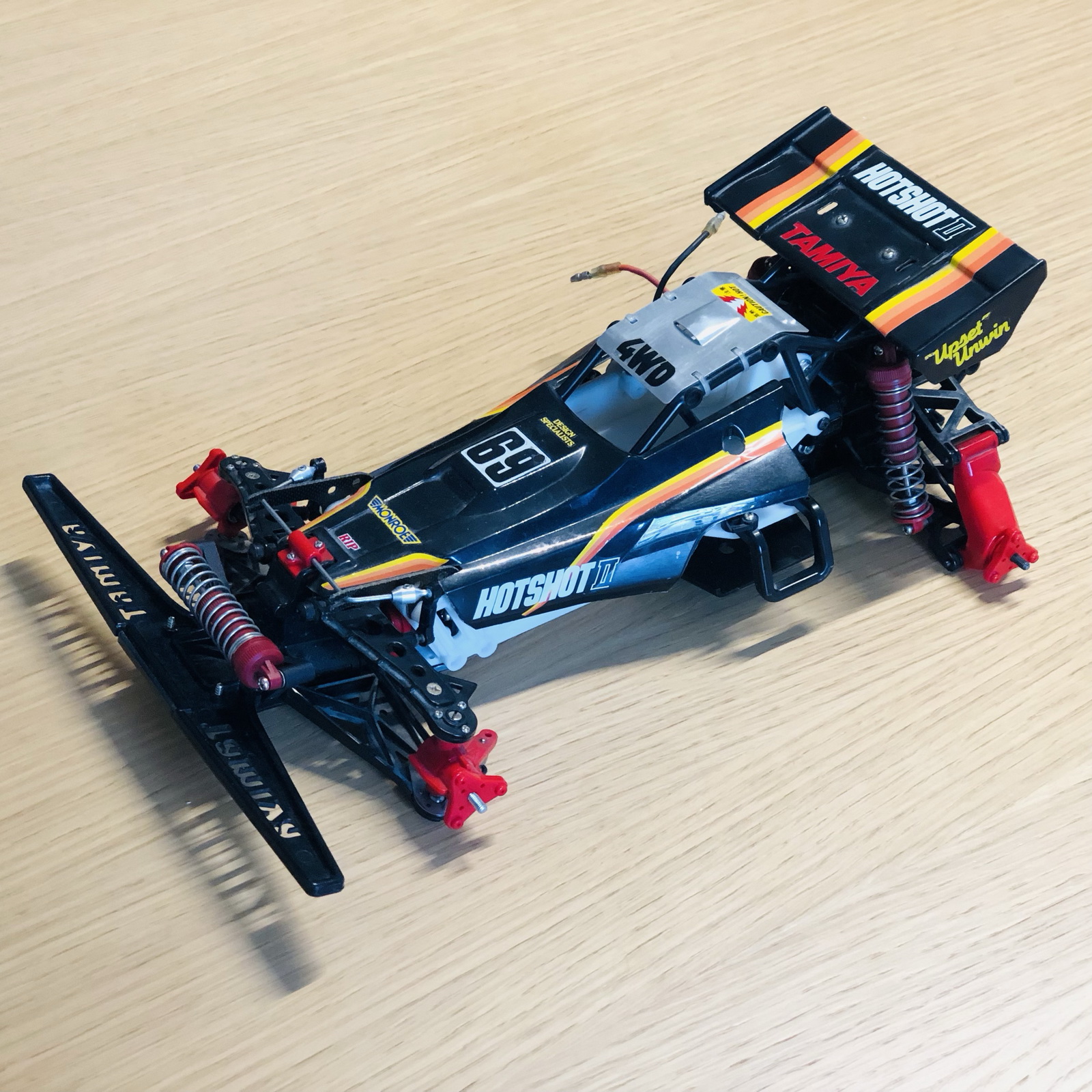

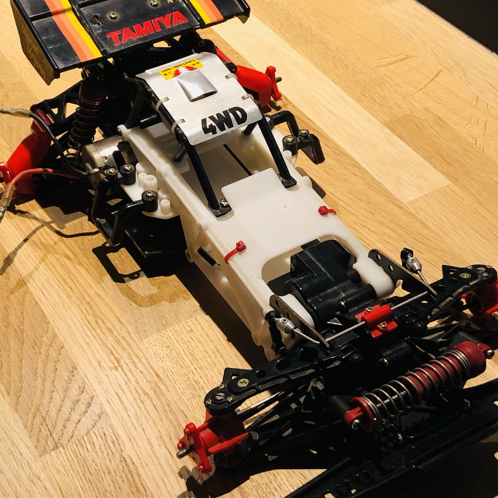

Finally, the Cover takes place on the front top, with nylon straps (vintage obliges) :mrgreen:
optimaforever
Posts: 82

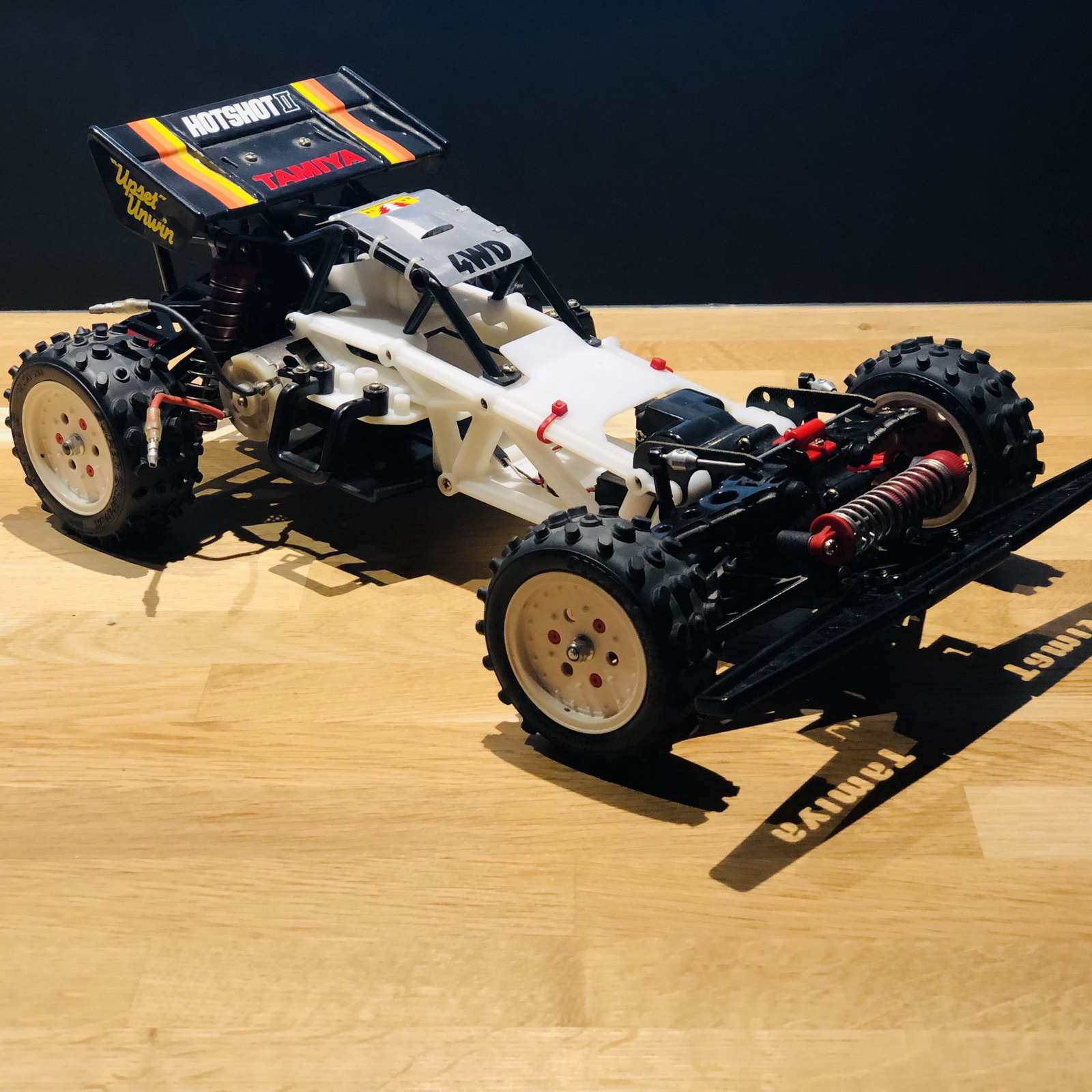

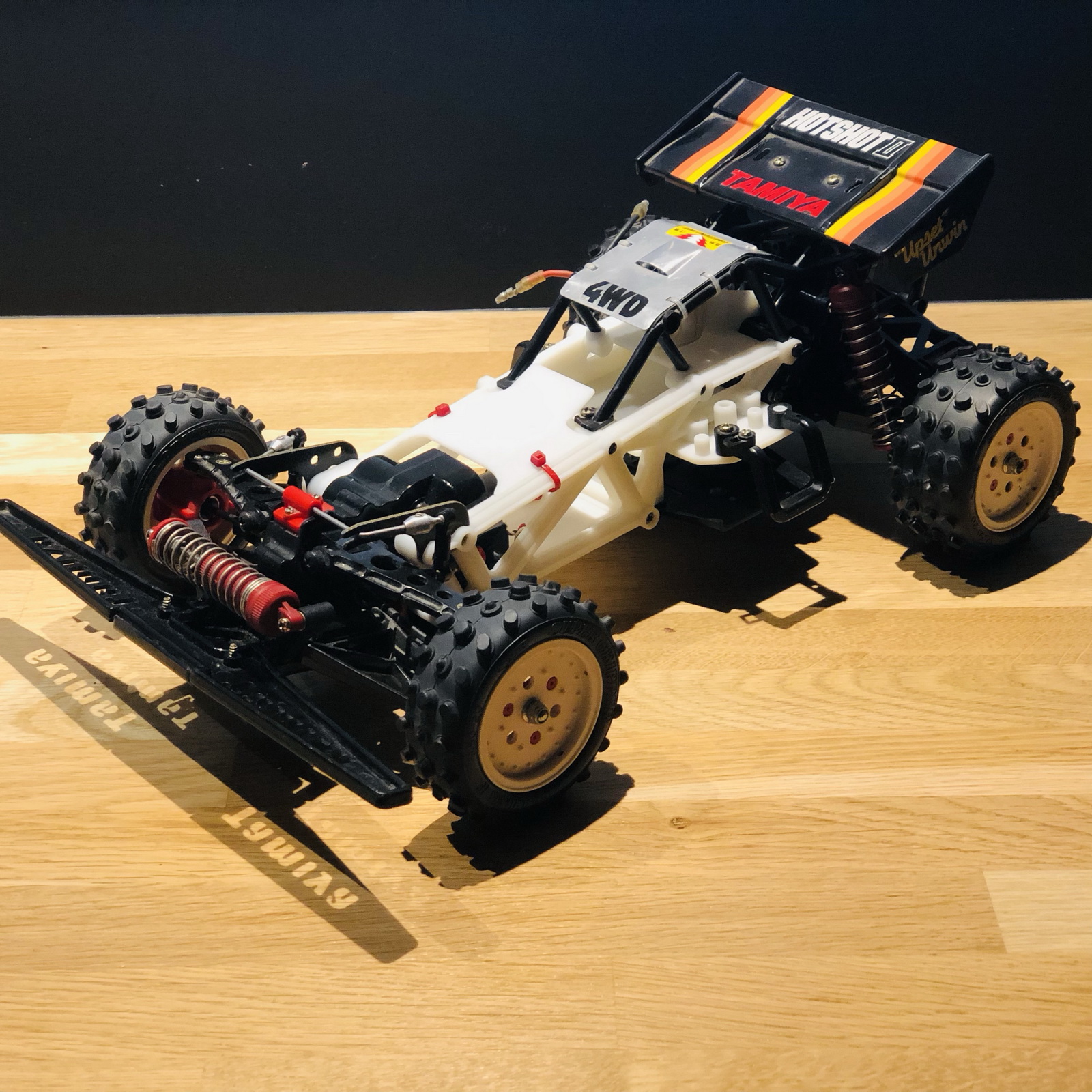

voilà
optimaforever
Posts: 82

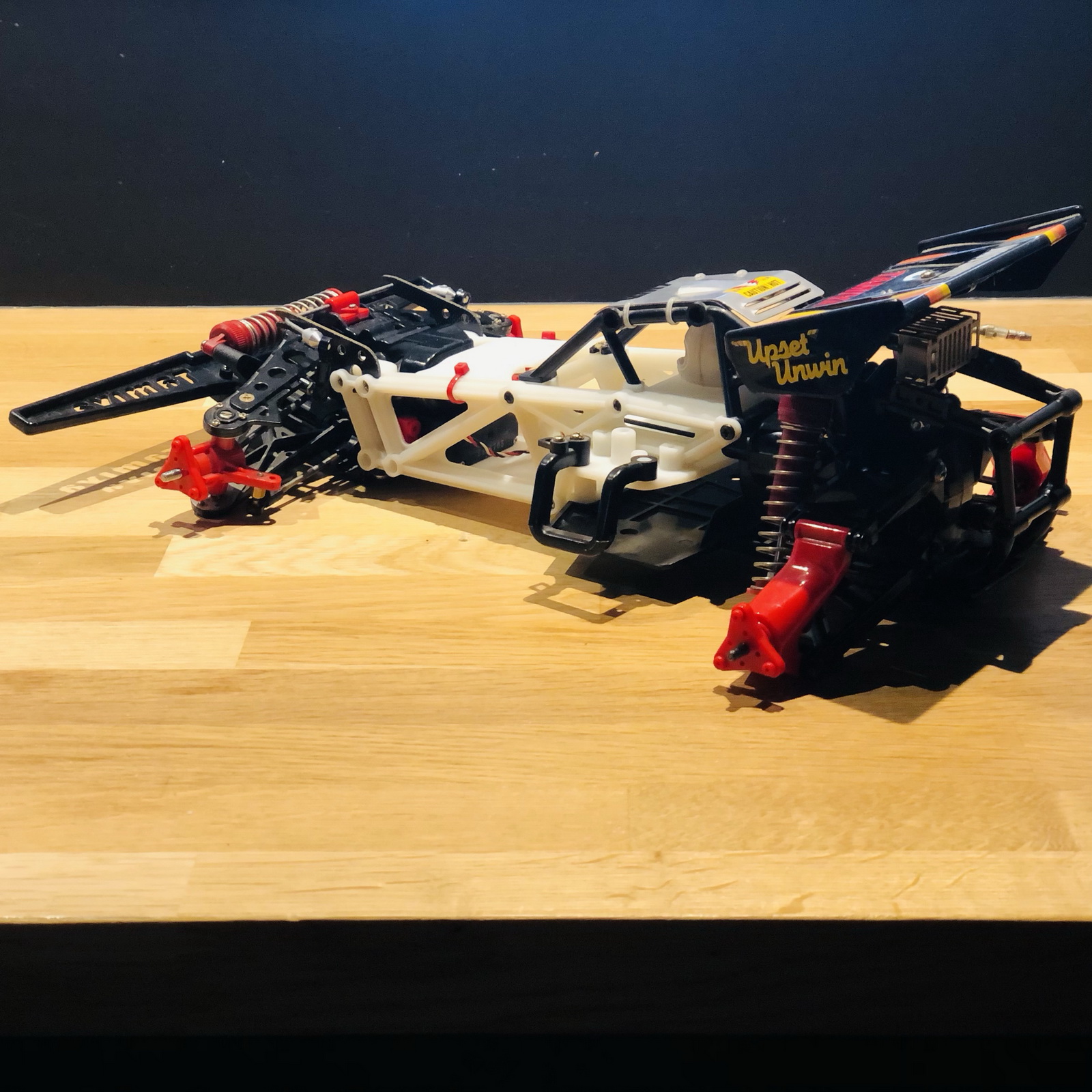

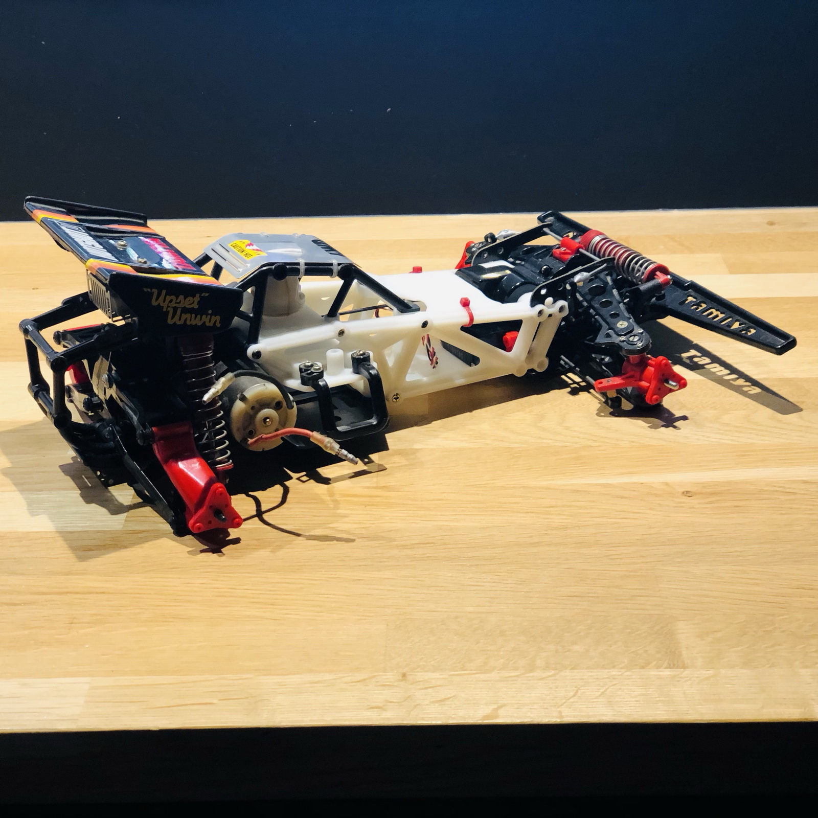

The Hotshot and Supershot bodies don't fit on the chassis but the Hotshot 2 body does.

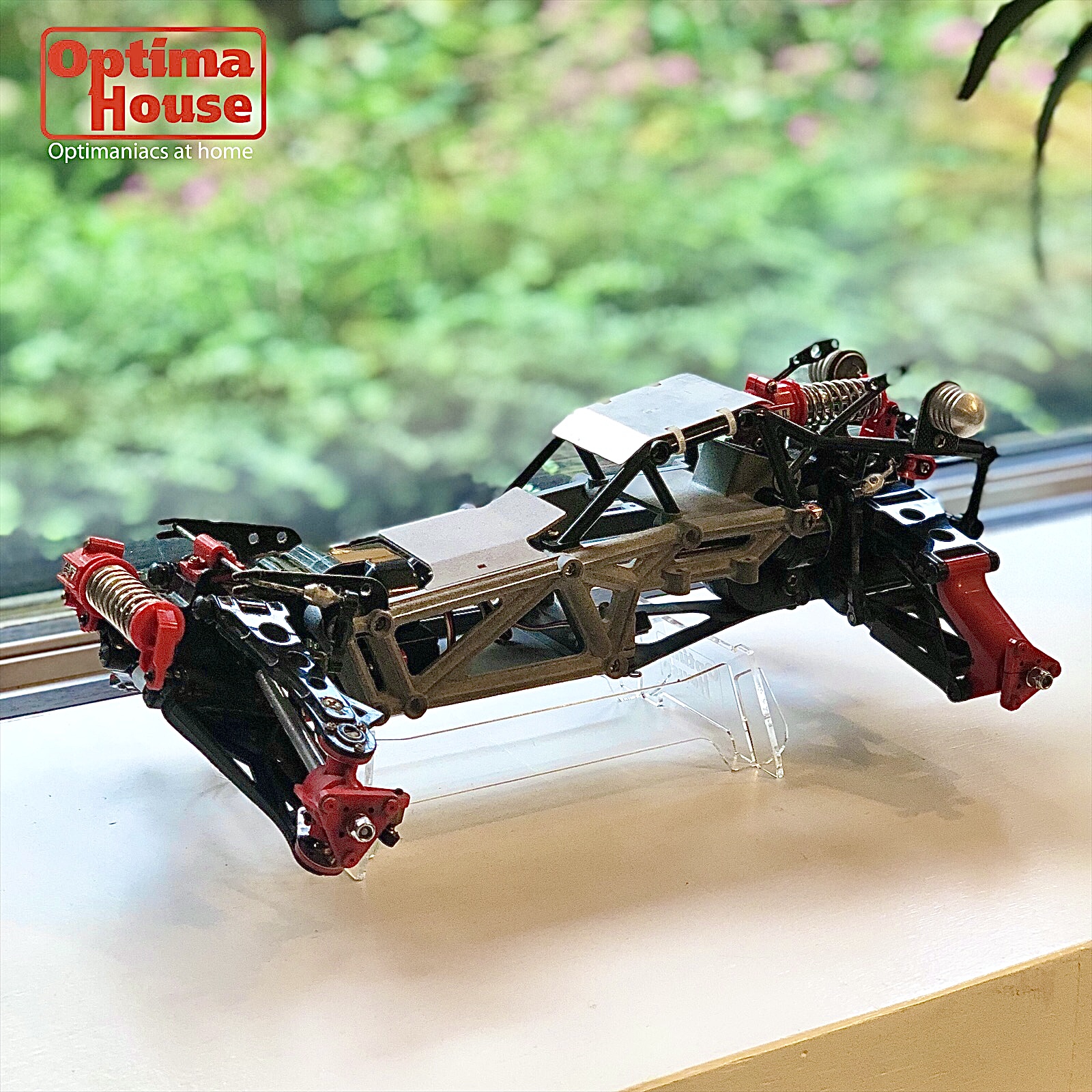

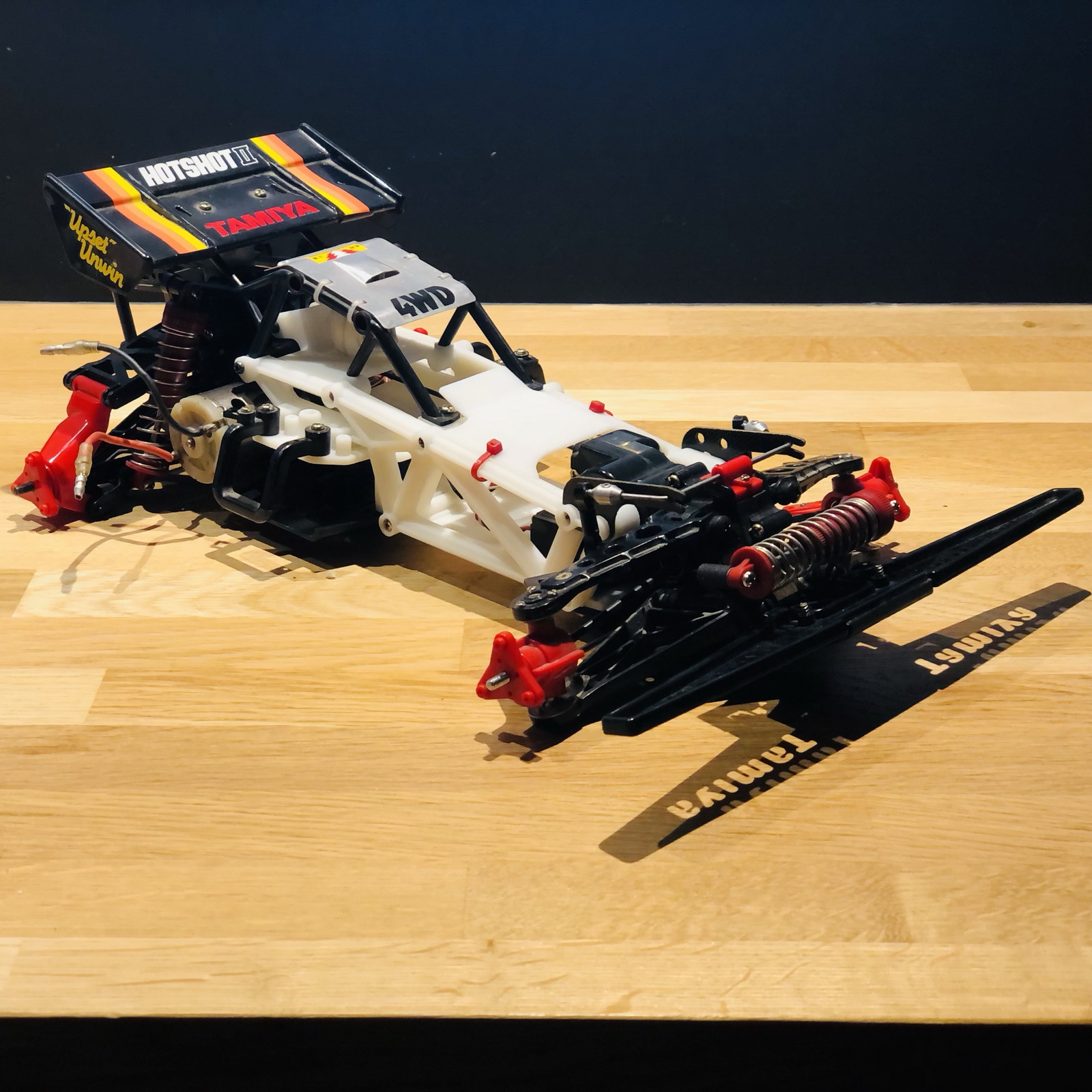

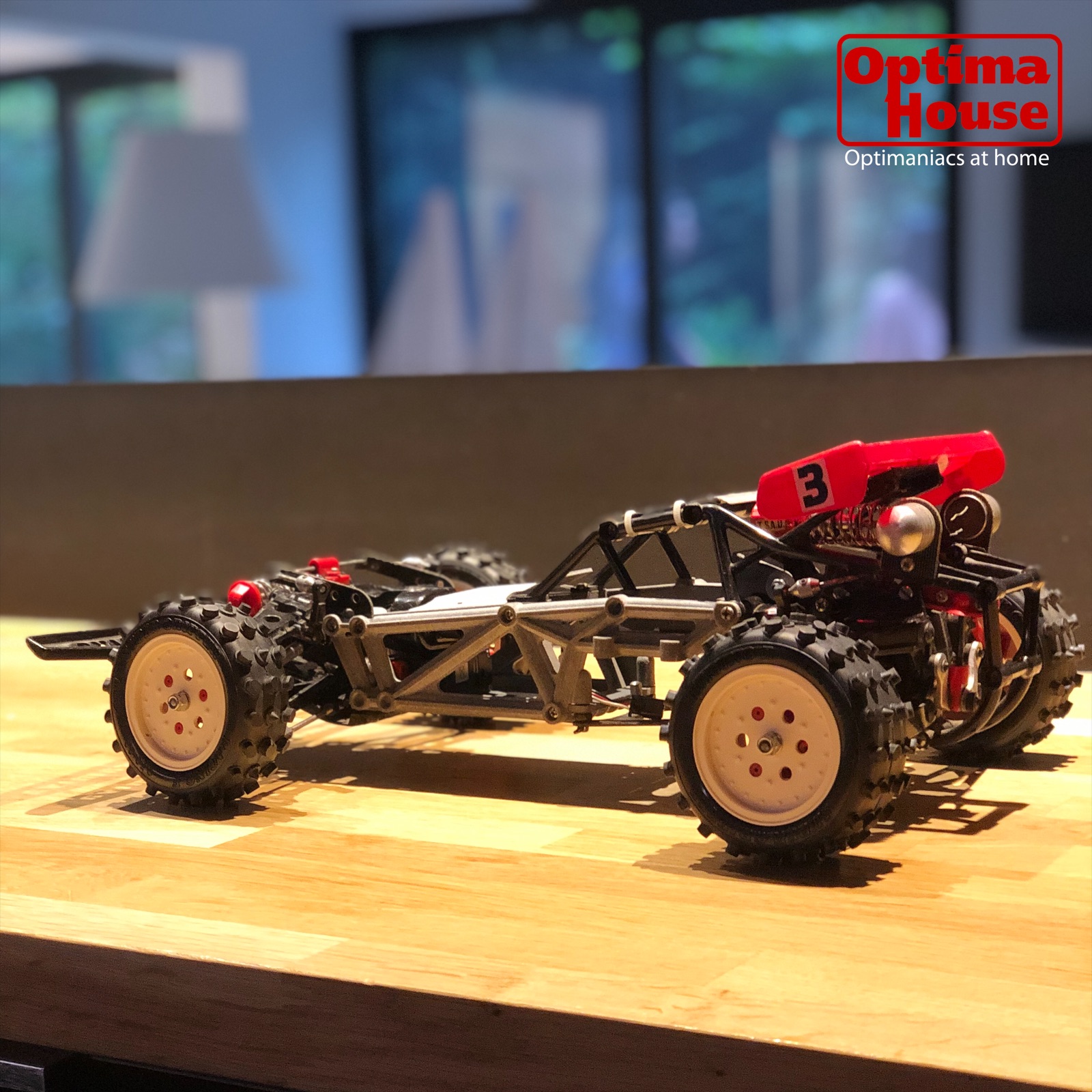

Pics from earlier protos

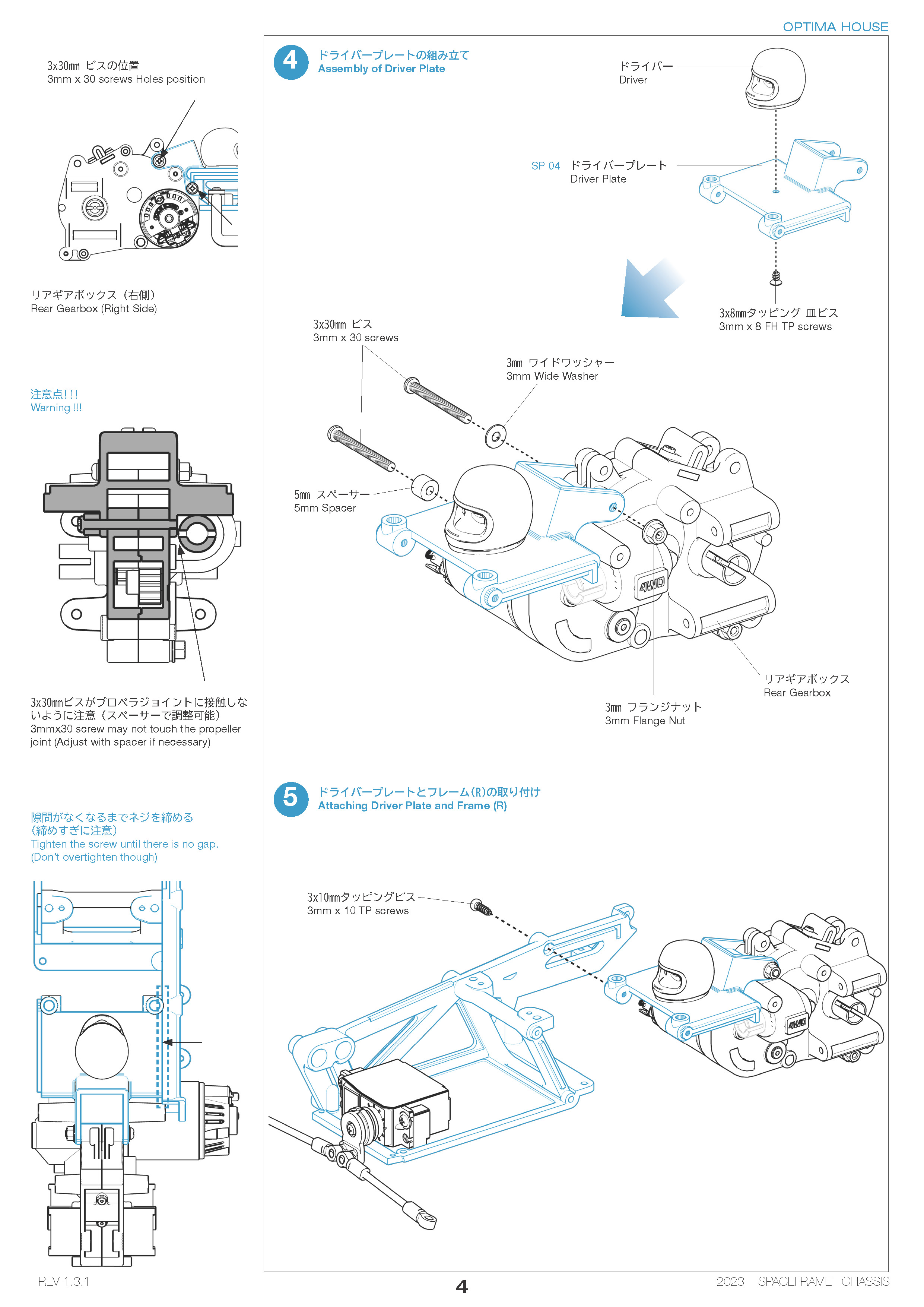

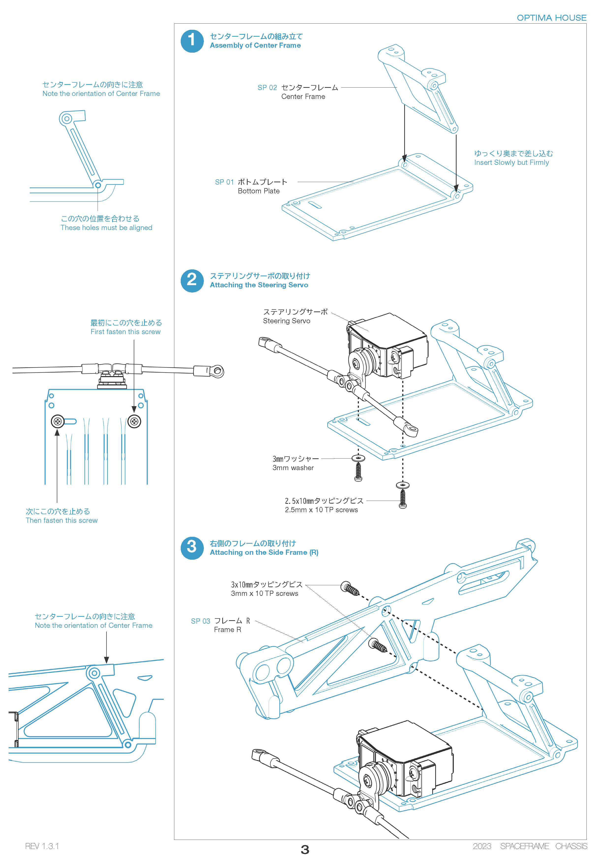

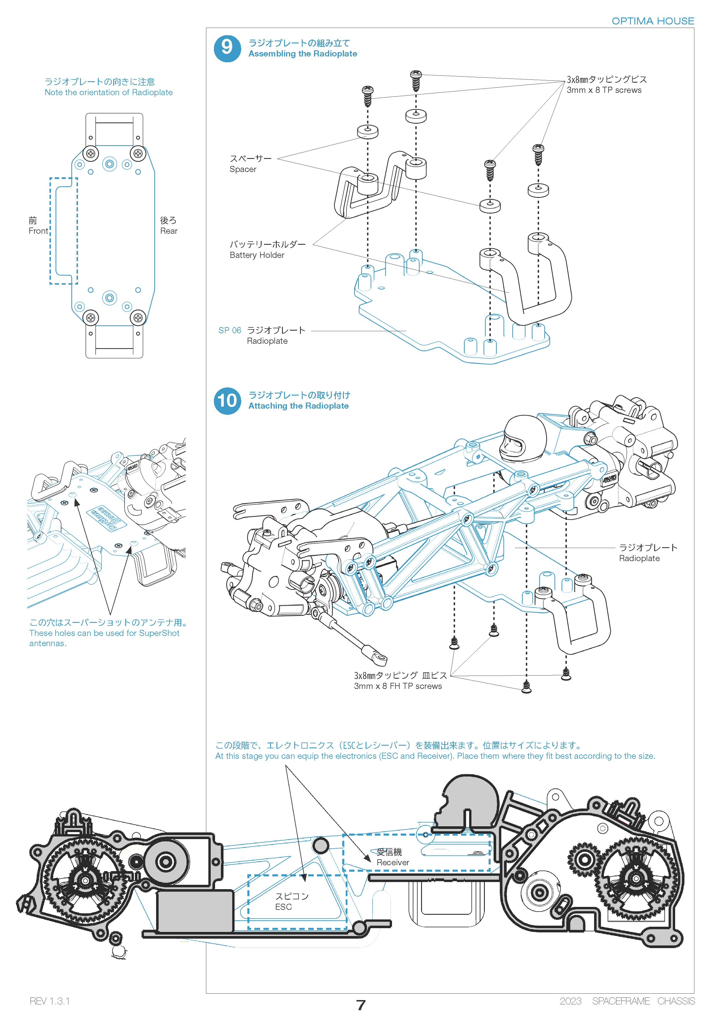

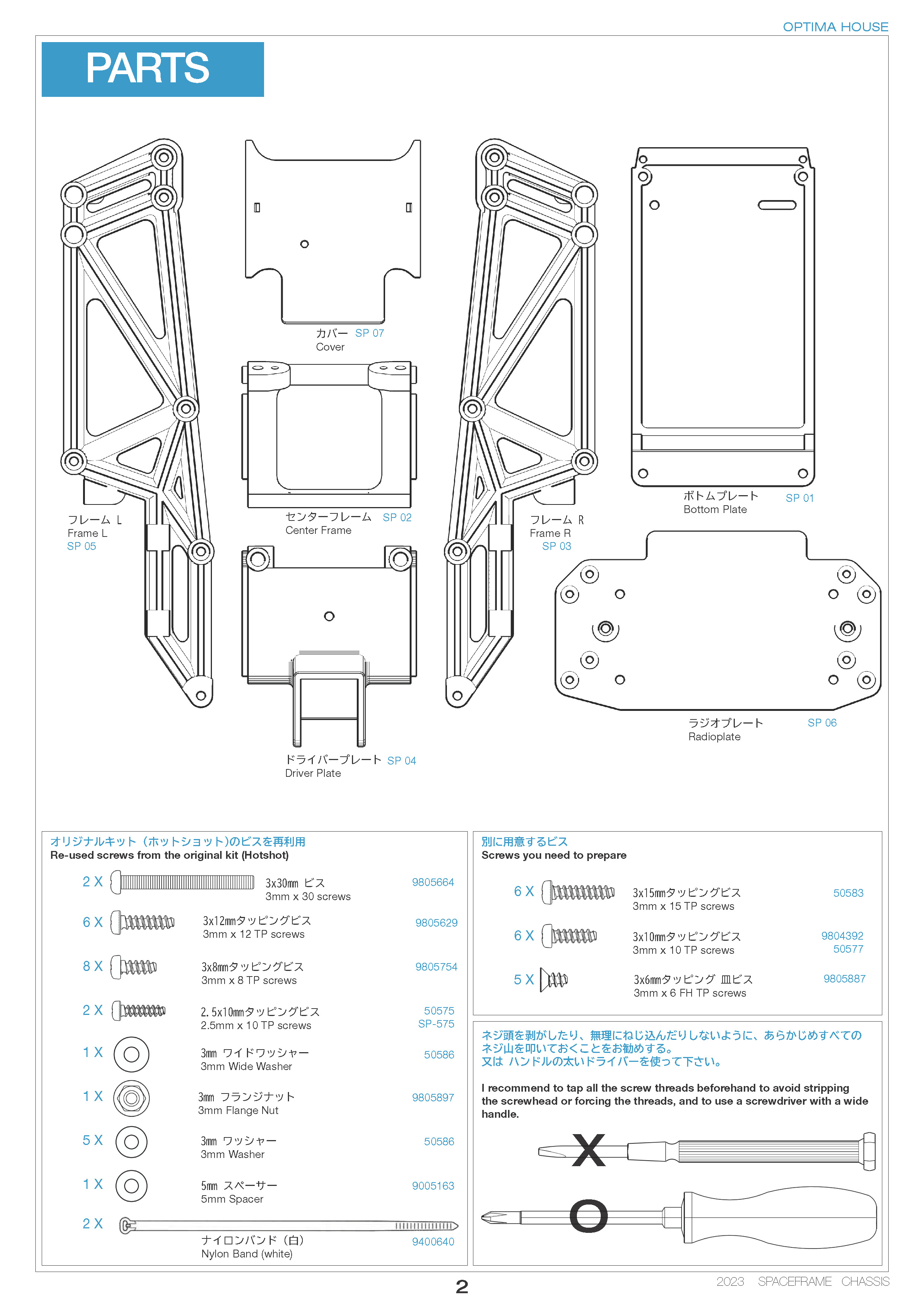

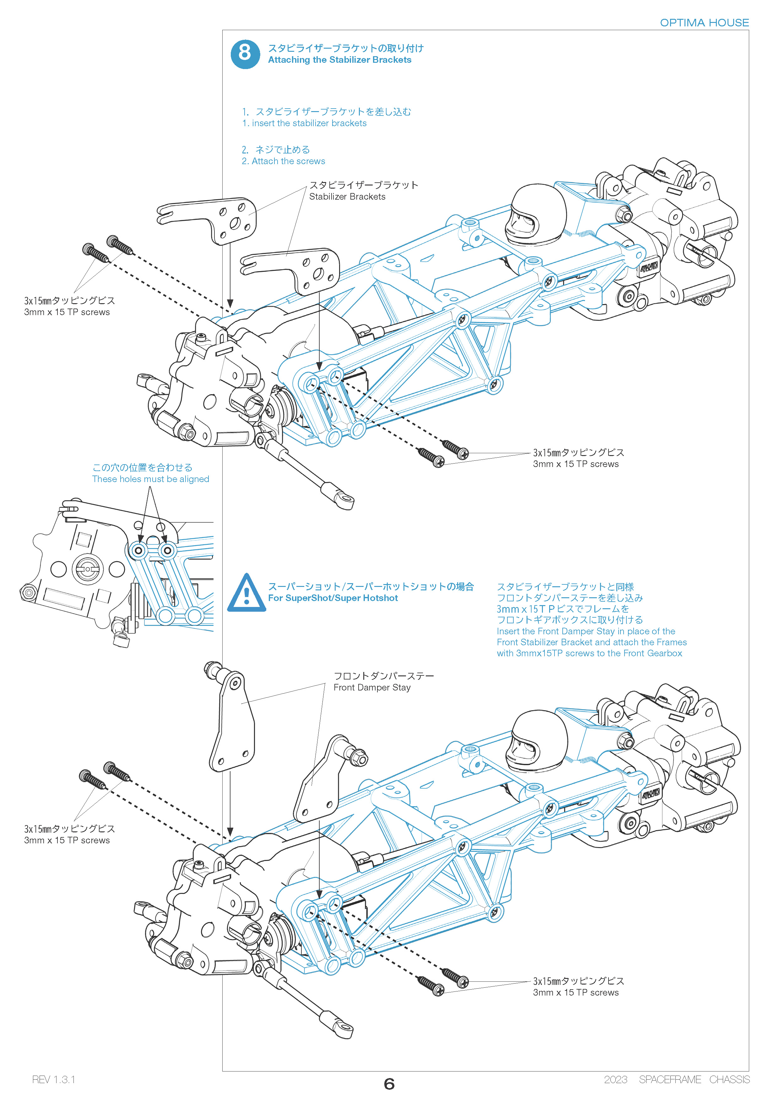

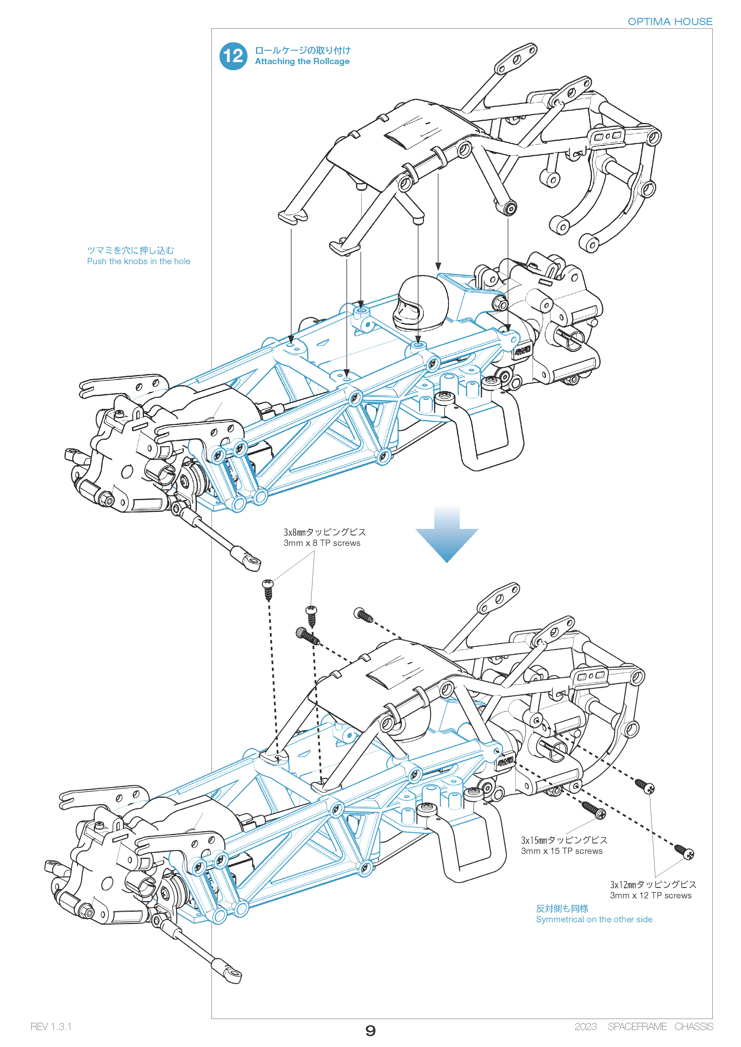

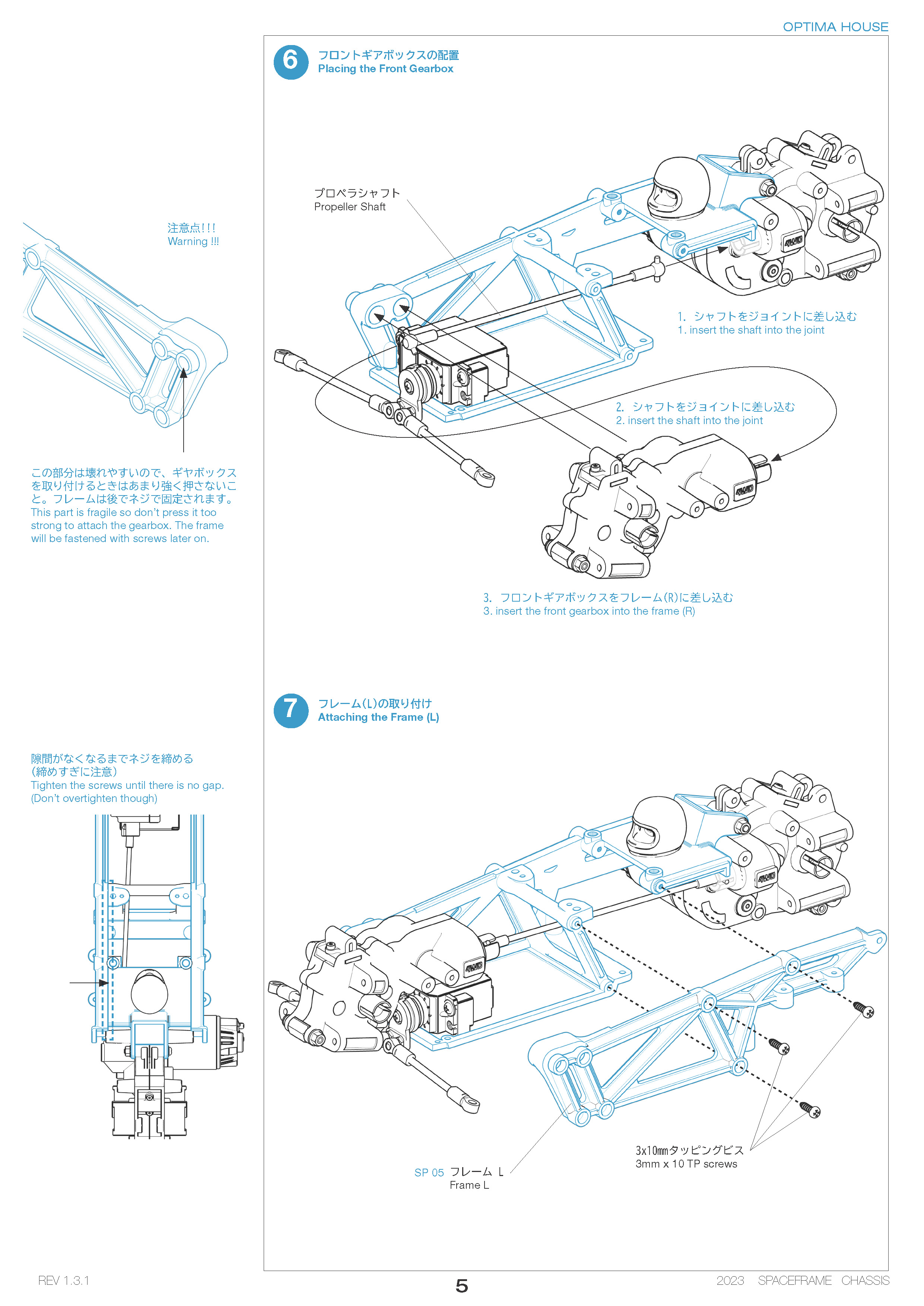

And the Aseembly manual
optimaforever
Posts: 82
