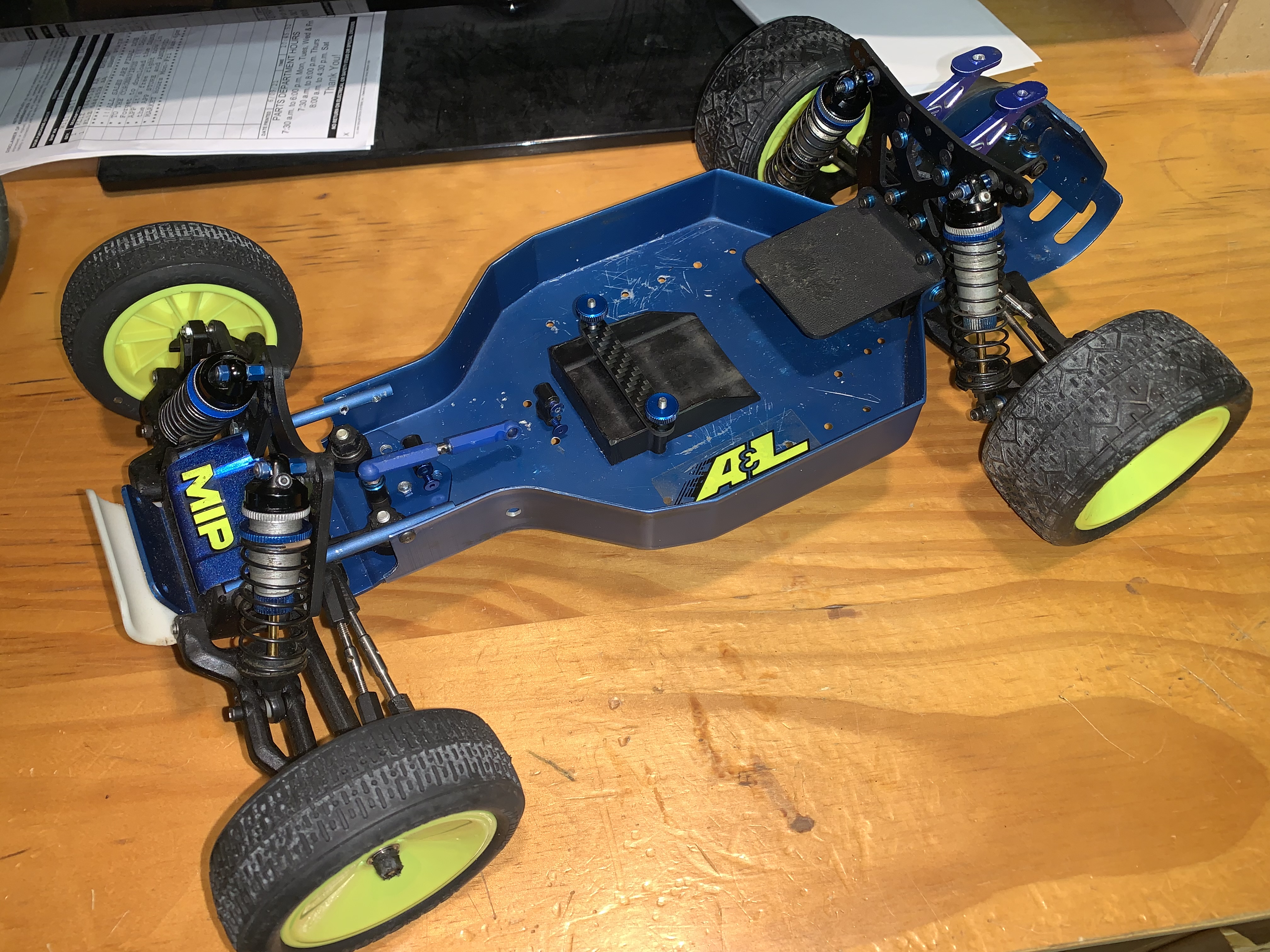

Nice looking buggy! How does it run?

mikea96 wrote: Tue Dec 31, 2024 1:17 am Nice looking buggy! How does it run?
No clue I’ve never used it :lol: hoping to get it loaded up and throw it around a bit eventually though.
Maybe Joey ( JK Racing ) could chime in and let us know. It was previously his.

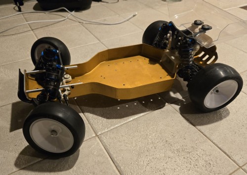

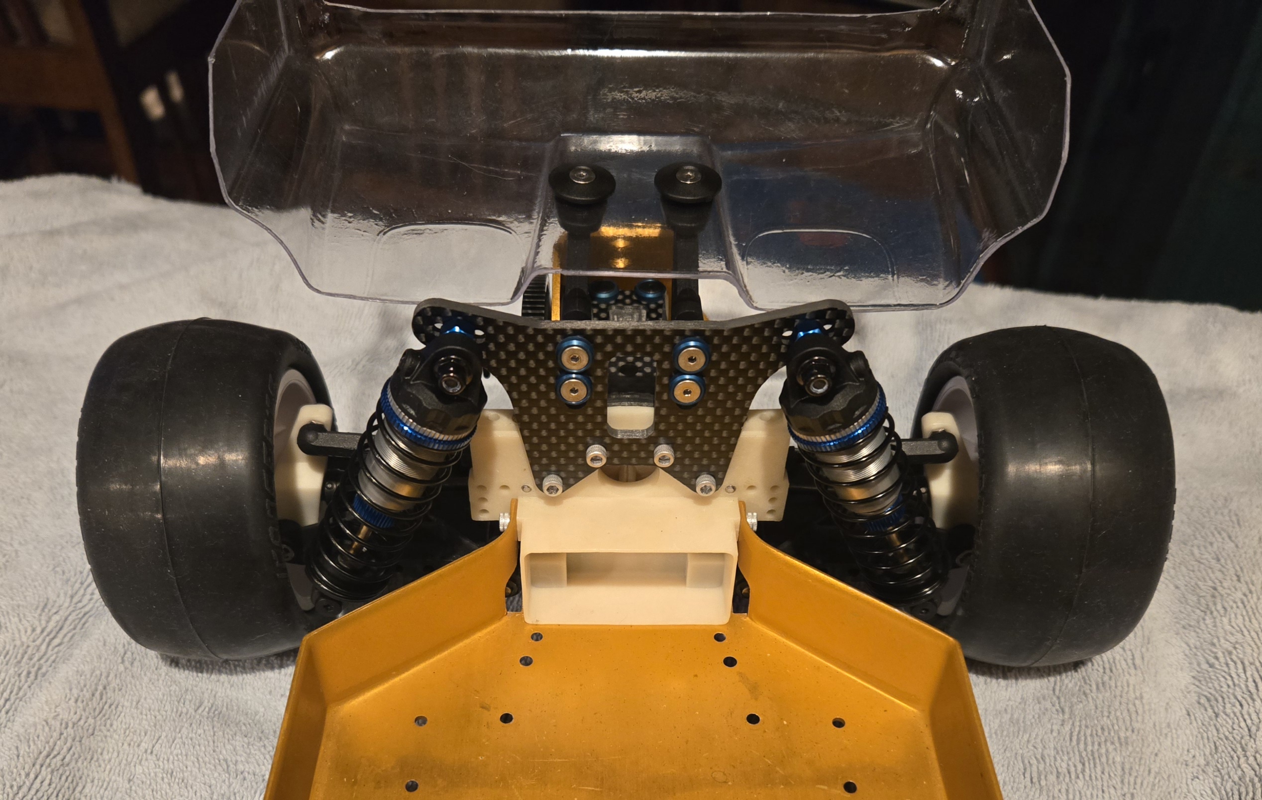

mikea96 wrote: Mon Dec 30, 2024 10:47 pm So for anyone running a car similar to this with big bore shocks are you running them on the front or backside of the rear tower?
I've done them both ways, if you run the back side of the tower you have to add a spacer between the tower and bulkhead (3.5mm) and you'll have to use the spacers on the B6 wing mounts and drill your wing further back on the lexan to get correct wing position.
If you stay at the front of the tower you have to add 3.5mm spacer to the arm to get the right angle, and that's it. They both felt the same on the track honestly

Ok I will just stick with the front side of the tower then. Thanks Reggie

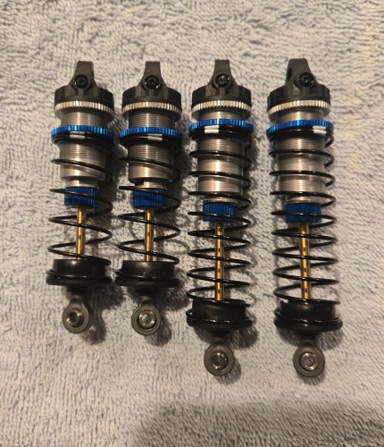

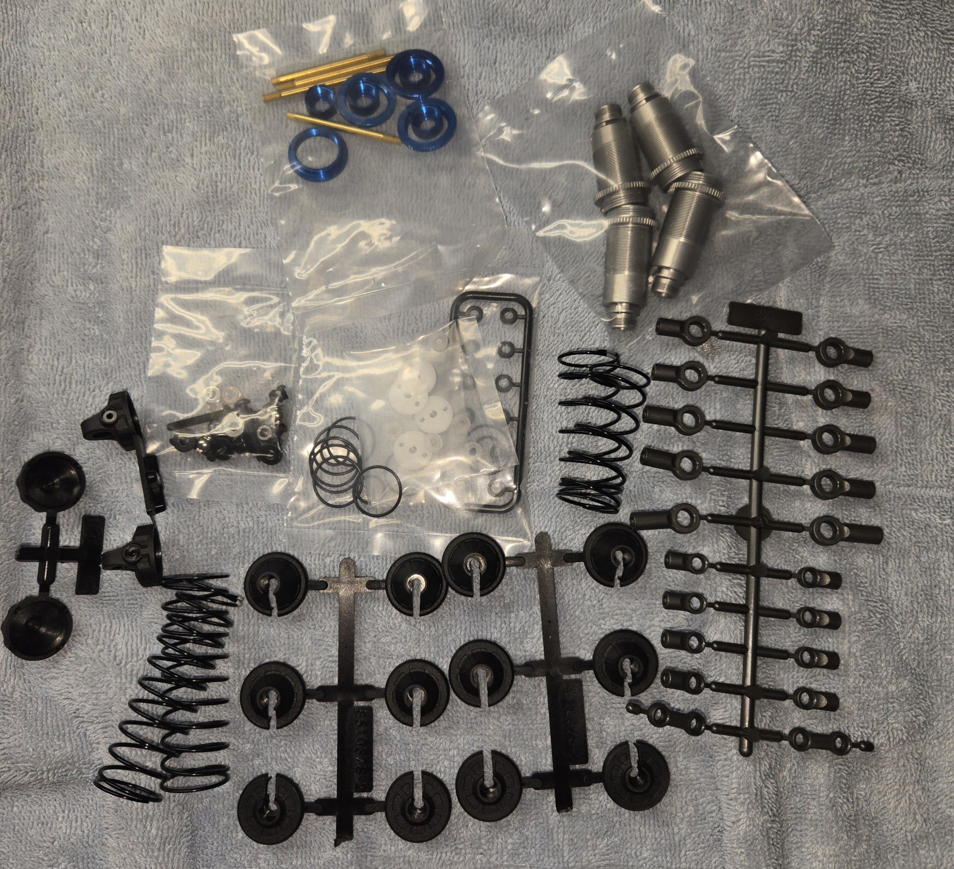

My shocks came on Monday but I've been fighting the flu the last few days and haven't felt like building them.

Hi Mike I am.using 12mm big bores,what type of upper shock mounts are you using?

I'm using associated b74.2 upper mounts.

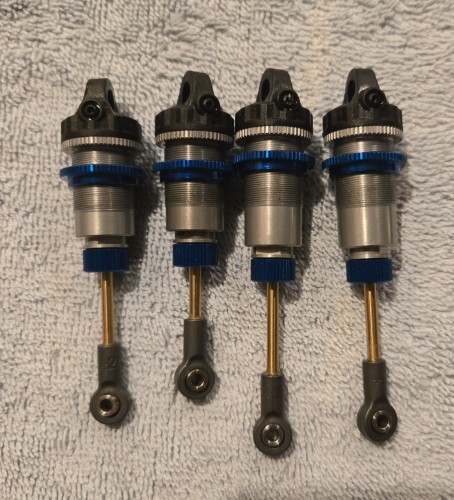

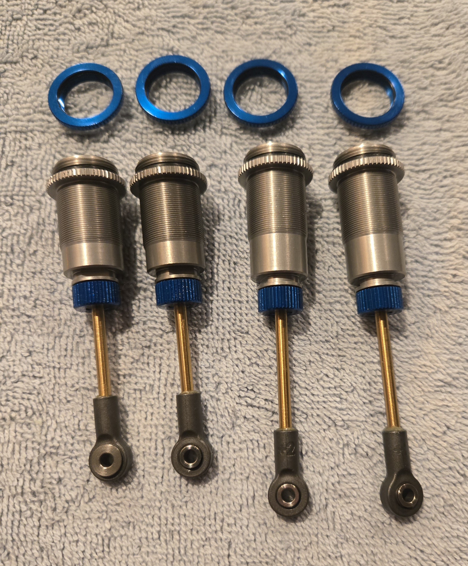

Alright felt good enough today to build the shocks.

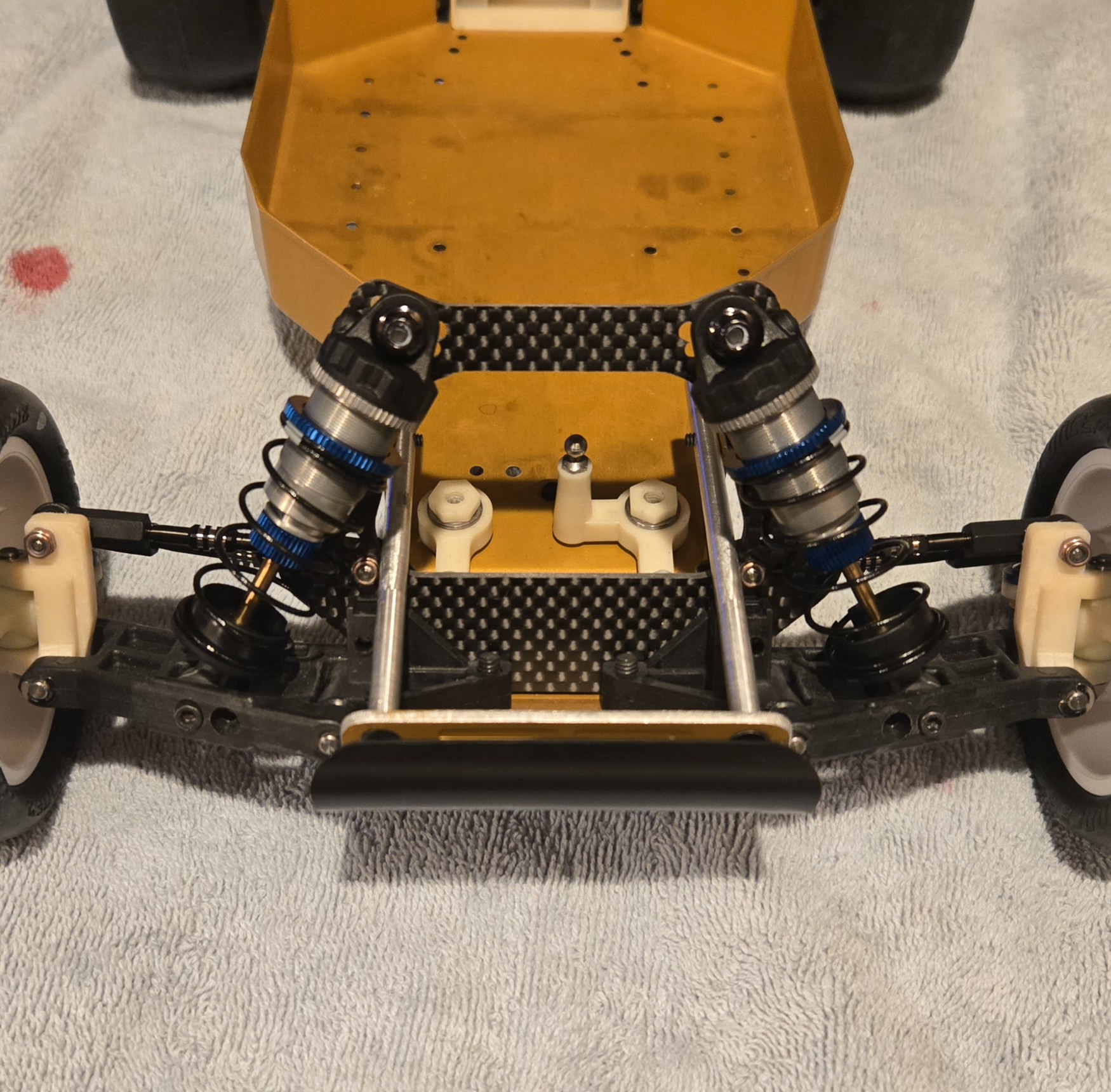

Installed the shocks on the rc10. They feel so nice and smooth. Also swapped out yokomo rear wheels for jconcepts rears to match fronts.
