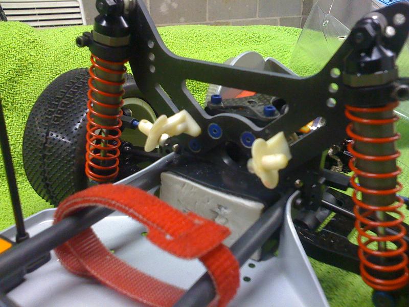

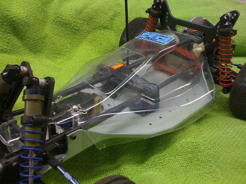

Well, I made a little progress on the car today. I have been working trying to put a Proline B4 body on the car without, using velcro. What I have came up with is, the use or RC10T rear body mounts mounted to the front of the rear shock tower. And I had to machine a front body post to the height I needed. This setup works fairly well. I was going to use vecro at first, but it seemed to deform the shape of the body.

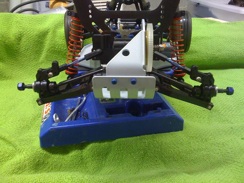

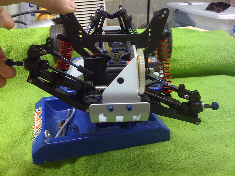

I recieved the Losi hubs yesterday. (Thanks to a01butal for finding them, and DocJ33p for selling them to me) They did fix all of my problems. At full extention, the axles are not touching the arms anymore and at full compression they dont bottom out in the outdrives either. Throughout the full travel, they stay at the same place in the outdrives, and the camber pretty much remains the same also. It is crazy how much suspension travel this thing has.

You may want to change this a little: when the drives go to deep in the cups that's a problem ofcourse, but for handling you'd want the tire to lean in slightly as it travels to full compression.
Without that you'll loose grip in the rrear when cornering.

It changes, just not too much like it did before with the old hubs. I'm not a bench tuner, so tuning will wait till the car is running. I've found out, after about 20 years of racing it's best to test then tune.

Iv tried test fitting a j concepts, and a stock b4 body over cut down chassis and there is not enough space in side pods to go over chassis. Is the Proline body a little longer than the other bodies in the sides or did u have to tweek it a bit to set down the way u have it on chassis in your picture

There is a little extra trimming in a few spots (around the nose mainly) but other than that it fits ok. It is stretched over the forward corner of the sides just a little, but if someone didn't know it they would never pick up on it.Soncho Ponza wrote:Iv tried test fitting a j concepts, and a stock b4 body over cut down chassis and there is not enough space in side pods to go over chassis. Is the Proline body a little longer than the other bodies in the sides or did u have to tweek it a bit to set down the way u have it on chassis in your picture
