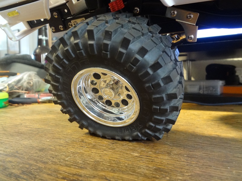

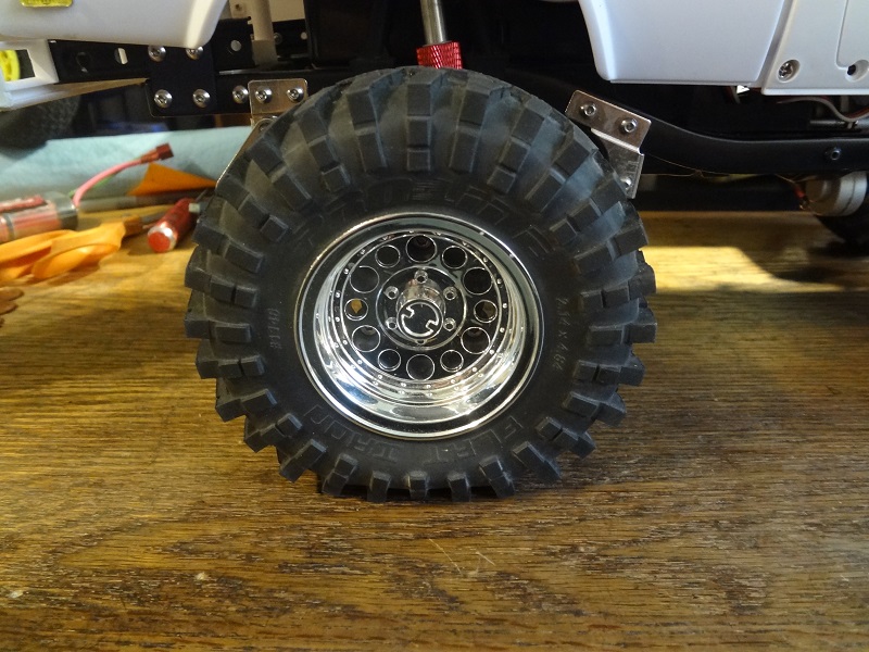

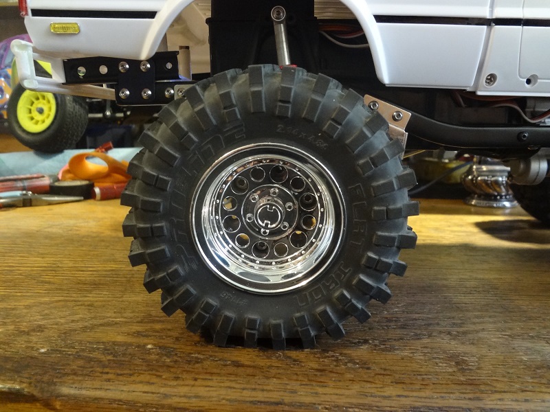

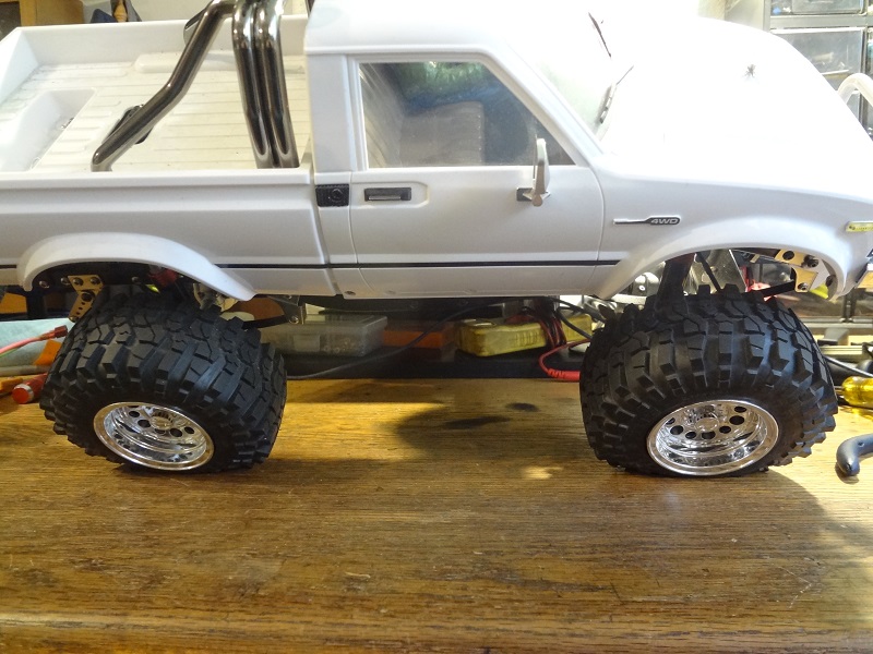

I installed some 2 stage foam inserts today from Crawler Inovations. Prolines come with nice memory foam inserts, but on a heavy truck (Mine weighs in at 8 lb.-6 oz), they are the equivilent of having 4 flat tires. With the stock foams , the truck is pretty much riding on the rim while running on a side hill. The 2 stage foams are a big imrovement. The tread section of the tire is still nice a flexible, but the sidewalls don't just collapse. At the same side angle, they now ride on the sidewall lugs. The pics here really show the difference of the two different foams performance.

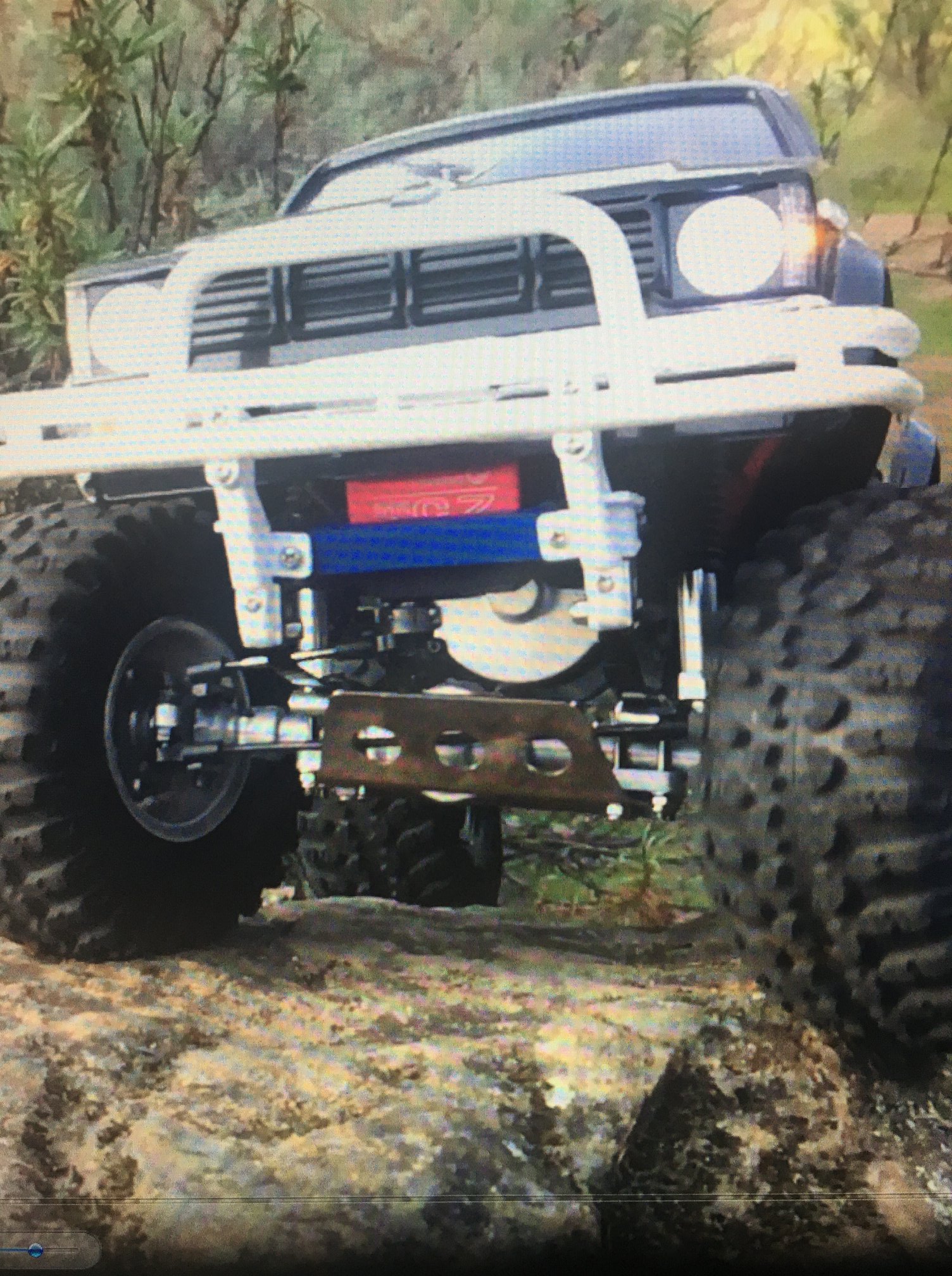

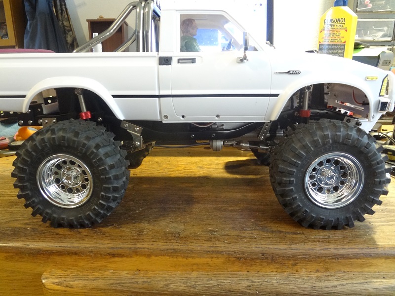

Look forward to sharing ideas. Here's mine prior to few ongoing modifications (bought full bearing kit, but it was missing 3 bearings, so I am waiting on replacements to complete the bearing swap). As pictured, I have front servo mod, changed out to Austar (Hyrax clone) tires, shocks modified using Dennis Dempsey's method, removed small leaf springs from all 4 corners, chino mod, hobbywing 1080 esc, Flysky GT3B and receiver, and light kit installed. I am in the process of removing the cab and installing a rollbar, painting the interior with figure, full bearing change, and adding AMPRO Engineering's front wheel spacer. At some point I need to do something about the wheels as I would like to go smaller 1.9 wheels and add some weight to the front.
Re: HG-P407 "Bruiser Clone" Arrived Today!
Any thoughts on how to add some weight bias to the front? I would love to relocate the battery to the front like this, and maybe add some weights to the wheel area.

Looks good. Sounds like you have all the most popular mods covered. I haven't considered forward battery placement yet but its not a bad idea. Definitely a popular mod for many models in the crawler scene. I haven't done anything to mine in a couple weeks. Too many projects going on at once.

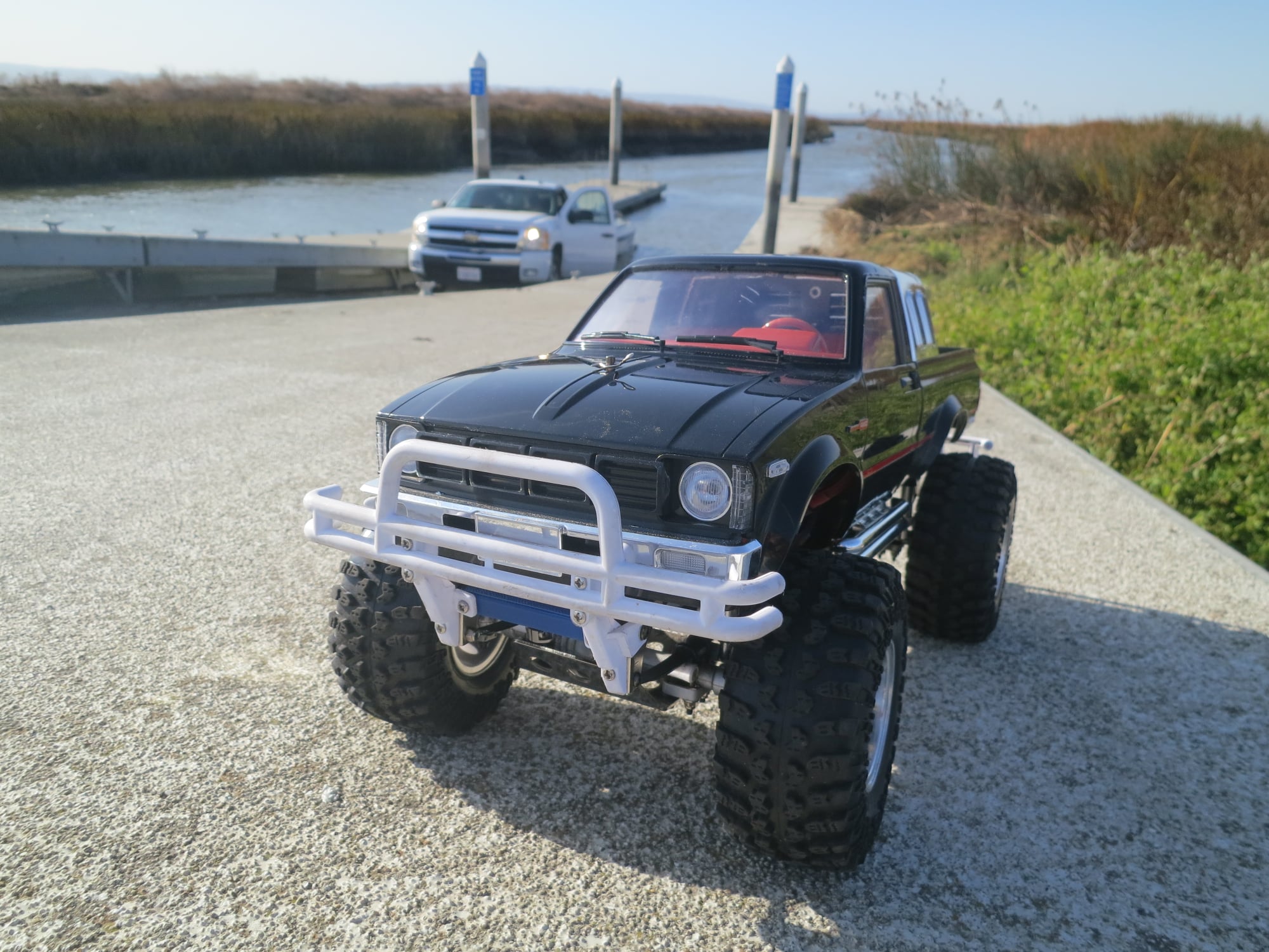

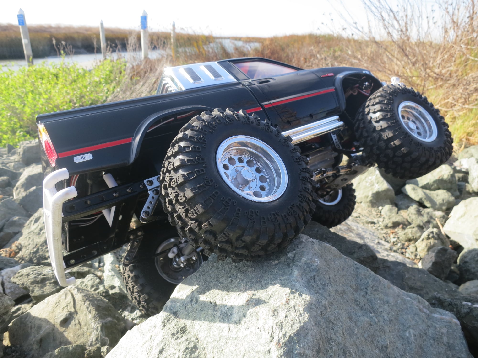

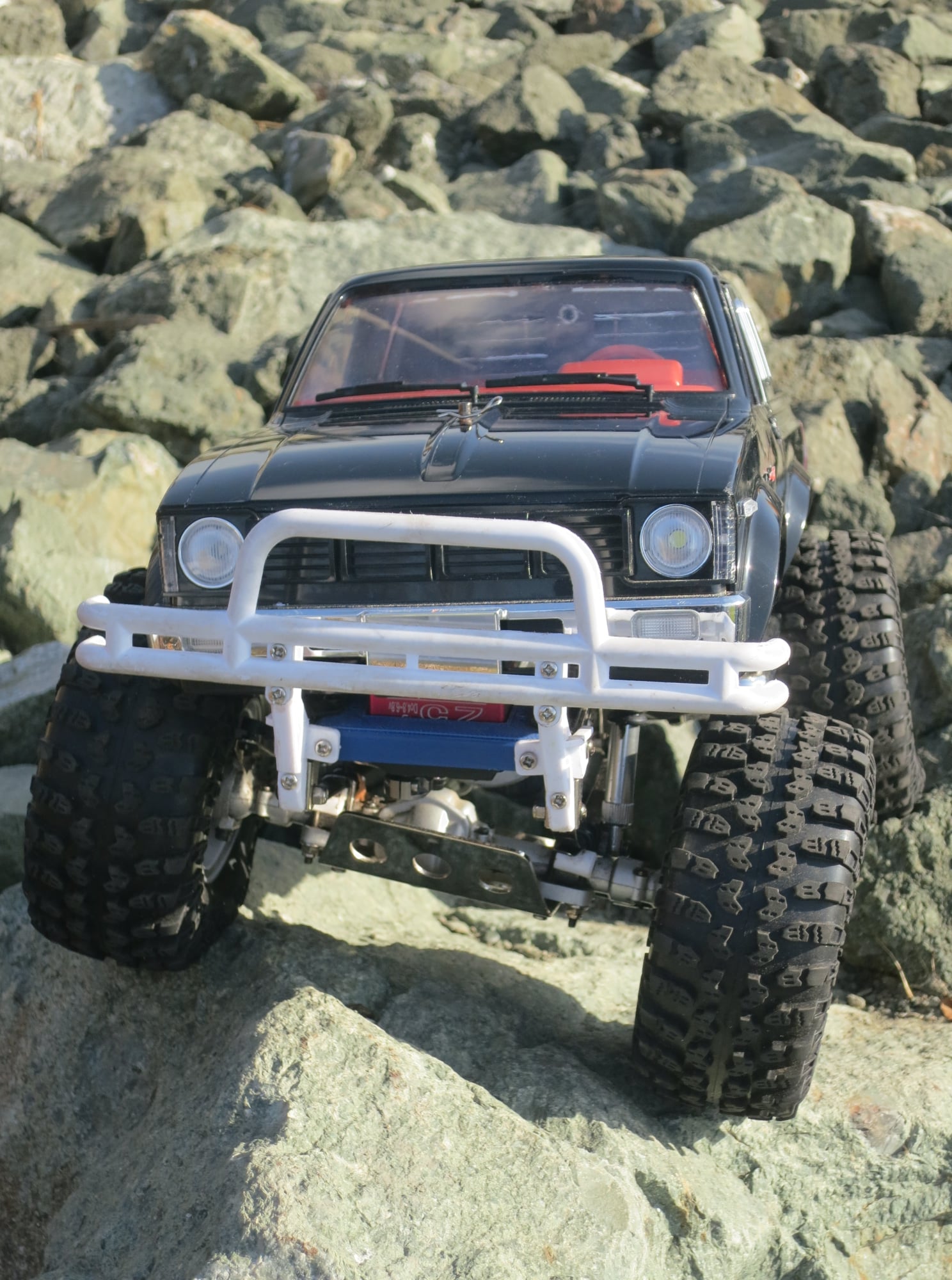

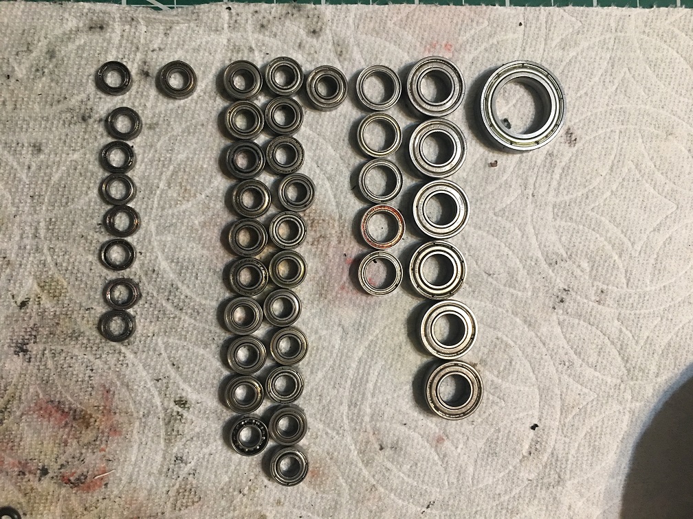

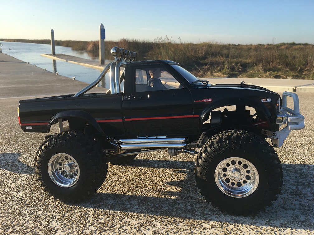

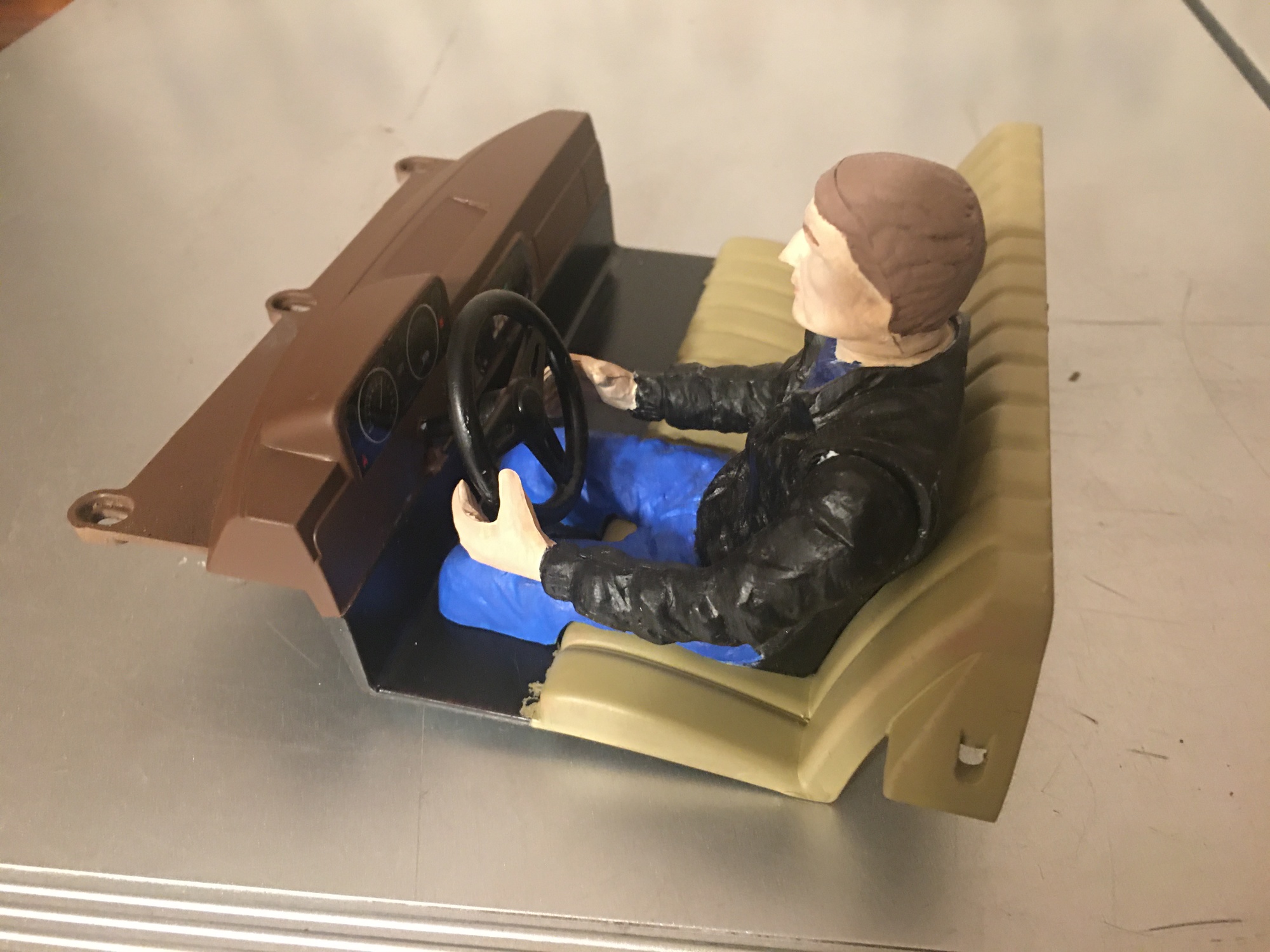

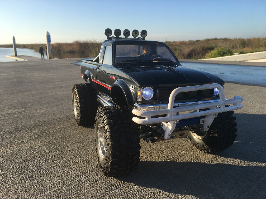

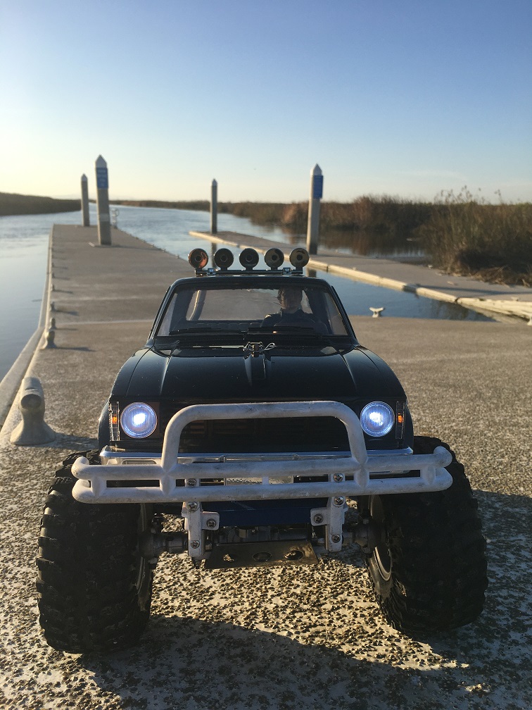

Finally got the parts that I needed to fix up my P407. While replacing the broken axle and knuckle, I decided to replace all the bearings with Fast Eddy bearings. For the most part, the bearings were (thankfully) still in good shape. Also made some additional modifications: 1) removed the cab and added a rollbar, 2) painted the interior and added a figure, 3) added front wheel spacer from AMPRO Engineering to correct the width of tires.
I was able to take it out for a quick test run and a short photoshoot after work today. I am really liking the tire stance now. Additionally one of the benefit of the front spacers was that it alleviated tire rub on the leaf springs when doing a hard left turn under load. There is still a very minor tire rub with back end of wheel well under load though. One thing that is still lacking is low front end weight. On steep climbs, the front lifts too much and it does not provide traction. At some point, I might have to replace the tire/wheel combo and go with 1.9s and add some weight to them.

I 3d printed a set of 1.9" wheels that I found on Thingiverse , completely solved the rubbing but did reduce the ground clearance slightly .

I think I am finally settled on the steering configuration. Now to figure out how to move weight bias a bit to the front as the added weight to the front will improve the traction.

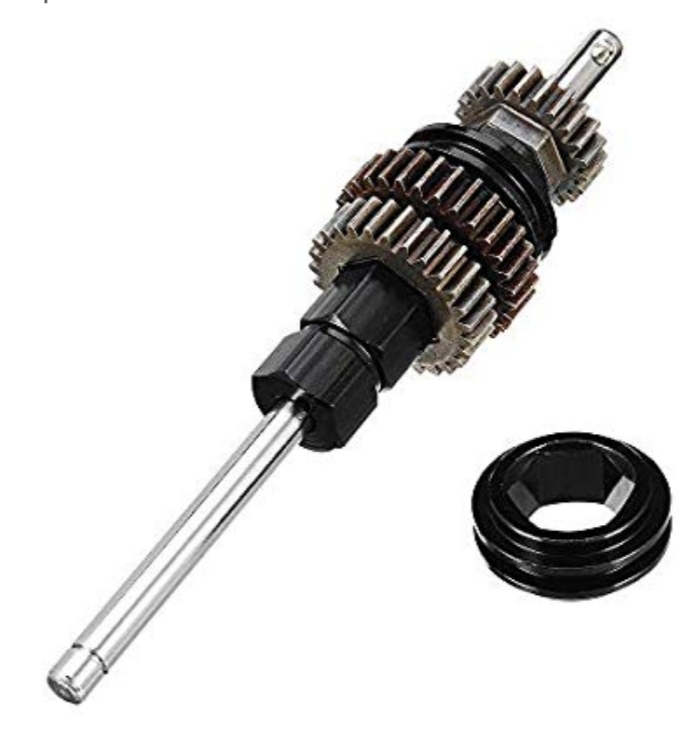

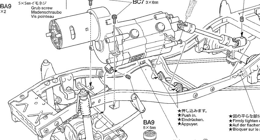

I just dont have the time to read all 22 pages....so can someone tell me if this shaft set from the clone work with the rere tamiya tranny?
Also, will a complete p407 tranny drop right in the rere mountain rider/btruiser chassis?

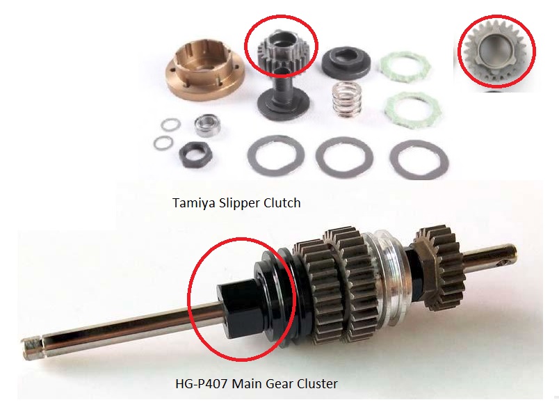

I'm not an expert and I've not actually tried to swap gears but the problem with using HG P407 gears in a Tamiya re-re is the shape of the drive dogs. They're hexagonal in P407 and a proprietary convoluted shape in the Tamiya. It might work if you also had the planetary gear.coxbros1 wrote: ↑Tue Feb 25, 2020 5:27 pm I just dont have the time to read all 22 pages....so can someone tell me if this shaft set from the clone work with the rere tamiya tranny?
My apologies if this topics been covered
Thanks
However, I believe the complete tranny assembly will interchanged between the two models because it doesn't appear that HG has alter the mounts.
Hope this is helpful.
