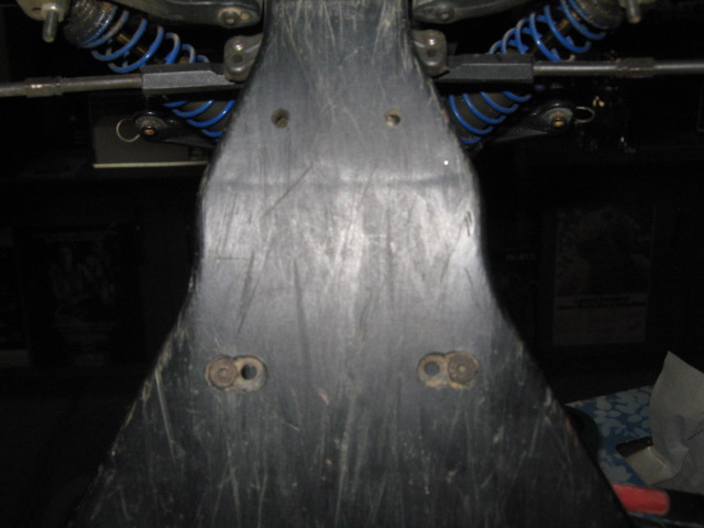

That's funny and cool. I love my skid plates! I hope you make more, it looks like you may have a few new customers!maxmus wrote:I was just browsing on the internet for sc10 parts, and I find this!slotcarrod wrote:
The parts needed for the fix! Got the skid plate on eBay, but I think the guy only made a few. I got two!
All done and I'm happy again!![]()
I was the guy who made that plate for you. eBay'r hyoki_lee. haha crazy, I was curious if I'd see it on a forum one day.
cheers!

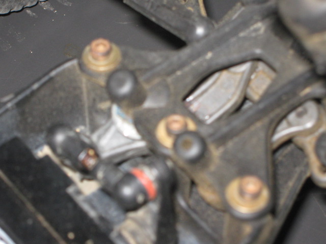

Re: SC10 Factory Team
Mate u wanna run with washers under the head of the screws on the front top plate, helps stop distortion which i suspect is to blame for some of the chassis issues. I got the first basic kit an have not broken anything in 2or3 years except for one front arm. I upgraded mine with the team shocks an gold shafts, cvd's ,ball diff,racers edge 1deg rear hubs an steering bearings. I love my sc10 they rock.
- slotcarrod
- Posts: 4415
- Been thanked: 45 times
Where do those washers go? Not quite understanding where you put them, and what size are the washers?
Rod Littau
- bully
- Posts: 759
- Joined: Mon May 31, 2010 6:08 am
- Location: Perth W.A Australia
- Been thanked: 6 times
Under the screws in the top plate near the st rack, 3of them. Number 4 ally or steel better spreads the load an allows a tighter screw down without deforming the holes in the top plate which split easy around the edge.
I will try this, thanks!
I see what you mean about the washers. I noticed the new AE FT version has blue countersunk washers with flat head screws now, so I got some for mine! Thanks for the tip!
