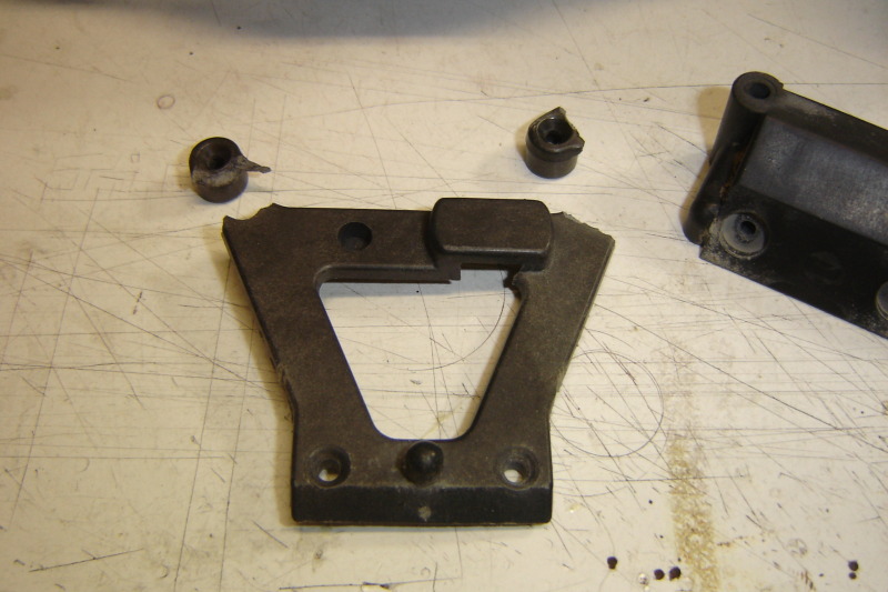

Re: RC10B2 RUNNER BUILD
I've been beating the snot out of my FT B2 the last few weeks! First it was this, an original carbon fiber B2 top plate with out the holes for the sway bar! I could have cried!
All fixed with a B3 top plate! B2 top plate is impossible to find!

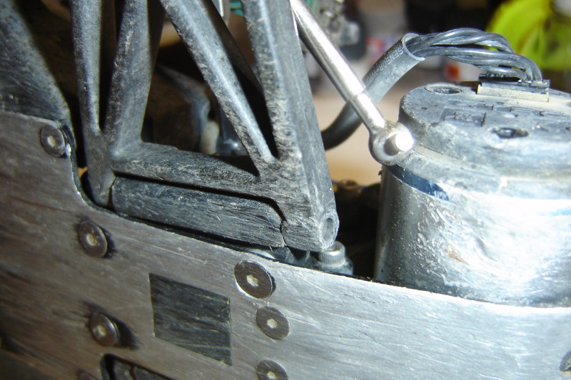

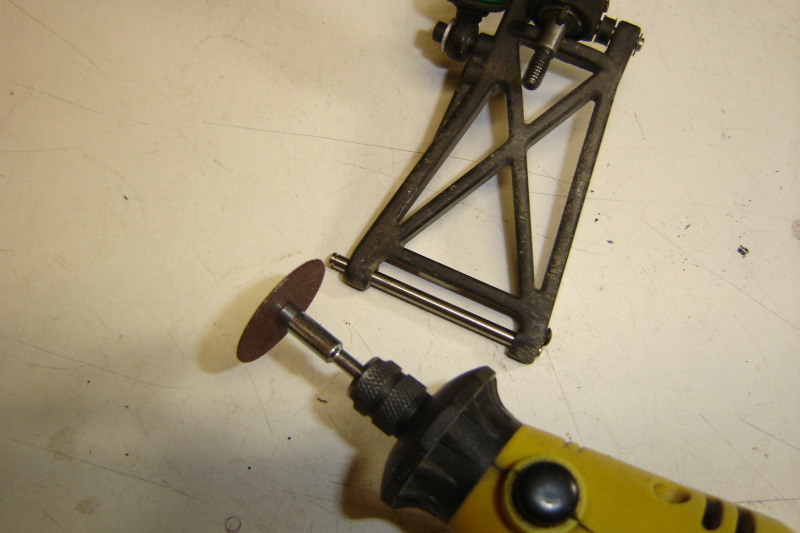

I kept loosing e clips from the rear hinge pins, because the arms and suspension mount are so worn down!
This would cause the pin to move forward and the arm twist and then the bone fall out!
So I drilled holes and used tiny screws to secure the shortened hinge pins! Just like the B4!
Works like a charm! Yes I bag on my runners!!!!!!
Rod Littau
That thing is showing a little wear Rod...how bout som thicker shock oil?
or maybe some up travel limiters..enough so you don't bottom out the chassis.
+1 on using the screws for hinge pin retainers. I have a car I;m working on that I think I may run with that idea...

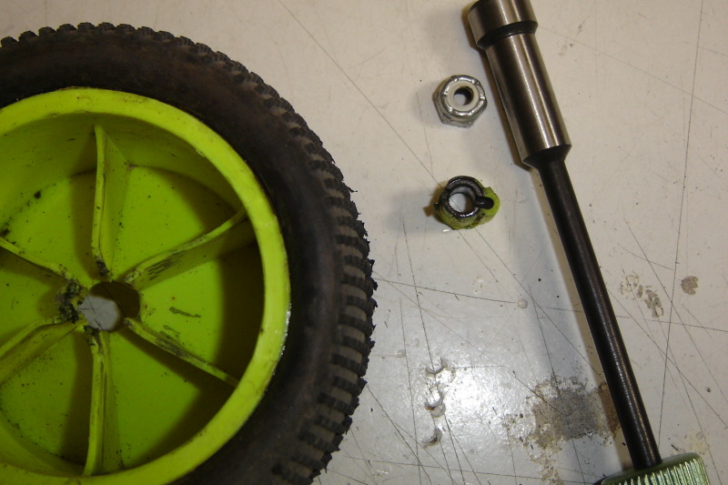

Ever seen this on a 2wd buggy???? The center of the rim has completely ripped out!
And that was a pretty new Hole Shot tire!!!
I ripped the tire off and mounted it on a old wheel. Saved the day!

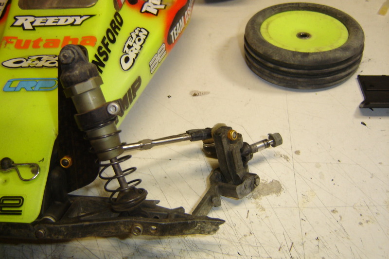

Took it out yesterday for a bag and had a blast, but then this happened!
Rod Littau
