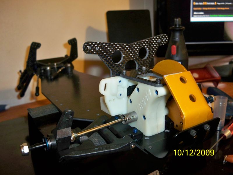

waiting on a few parts. progress 8)

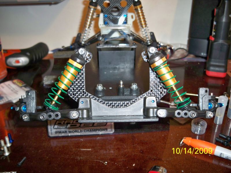

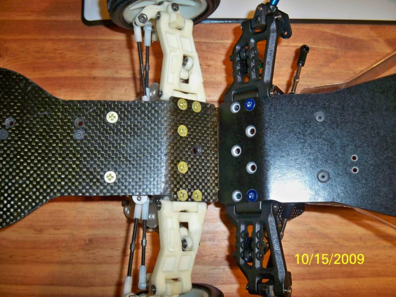

progress. should have track side next sat .
what is the shaft length total for 1.32 shaft rear shocks
should get camberlinks and rear rubber friday night .
just race it

Use 1.02 shafts in the 1.32 bodies for the rear, use the .031 shims to adjust down travel from that point.

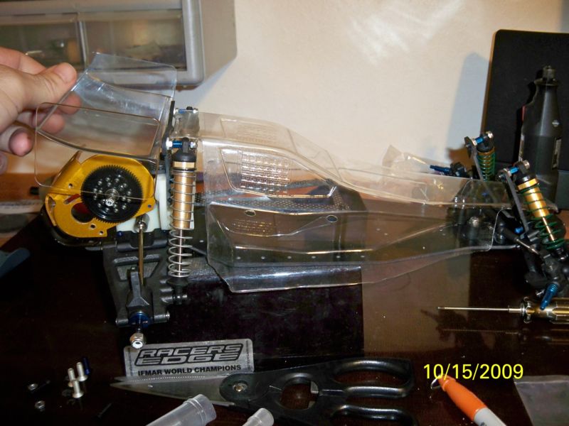

cool im kinda strugling with the set up the front springs are to long and have preload on them and the rear are to long . ahh and the lid does not fit the chassis its a little to wide
just race it

Try using buggy green springs on the front instead of truck springs. :wink:
Once you have all the weight in the chassis (motor, battery, speedo...) the rear will settle down quite a bit. Rear springs are the same length for truck and buggy.

i think it is looking good 8) . How do you like that Kimbrough Molded Wing?
I would wait till you get all the electronics on it before changing springs and making any suspension adjustments.
That’s the way the body fits on the graphite chassis, is normal.

The chassis is wider in the front so the body streaches.
the wing is great hope it works as good as it looks

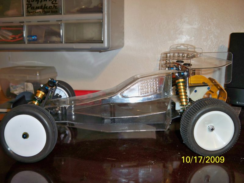

getting close :D
