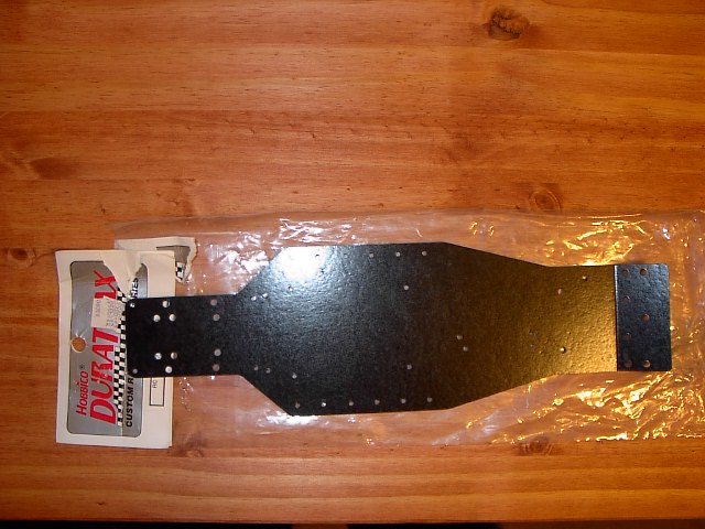

here is the first part mhhh
but it is a six gear chasis going to drill friday night for stealth trans
the plans are to build and run in the indoor winter season here and take it and run at the nats next year . so im getting a way head start . I will do my best to keep it as up to date as i can .

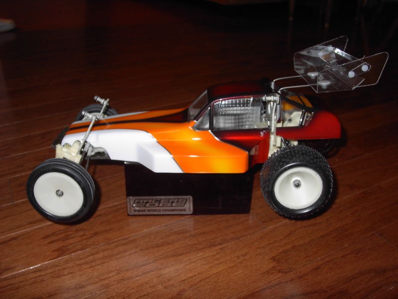

i will post pic of the other stuff as it goes . here is my shelf queen hope you enjoy i do

Pactra candy red (rattle can), about 3 light coats followed behind it with silver. The shading is black airbrushed.SteveK wrote:Did you paint that yourself? What color is that brown/maroon on the back?

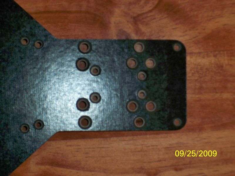

the stealth trans drill went great.
the rpm will not ( more on this when i make it to the trans) .

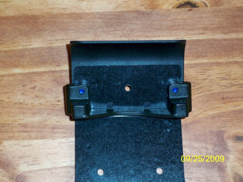

did a little on the front still trying to make my mind on the blue screws or gold

I use the RPM bumpers on my 10T, and to keep it from warping into the countersinks on the chassis, I slip a washer between the chassis and bumper at each screw. Makes me feel a little more secure, like the front end won't move or shift if the bumper flexes.

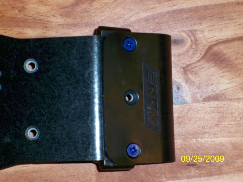

yea i need to counter sink the backones more and fill the front counter sinks.
im going to race it pretty hard core , i was thinking epoxy, washer might knock through have you used washers on a racer. (maybe a pic of this)

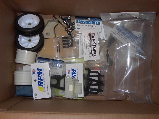

im going to run it on a lot of small tracks . i found this little nugget at brandons
im pretty stoked i just talked to my brother. the story goes , back in the day when i was in the army i sent all my rc stuff to him . His wife threw away the jrxt and the rc10 ,he still has all the parts . I shoud be so lucky i had a lot of parts . and a hydra drive shaft for a stelth what a long shot .

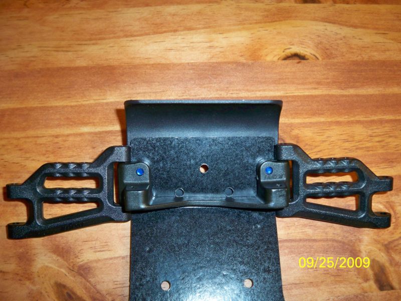

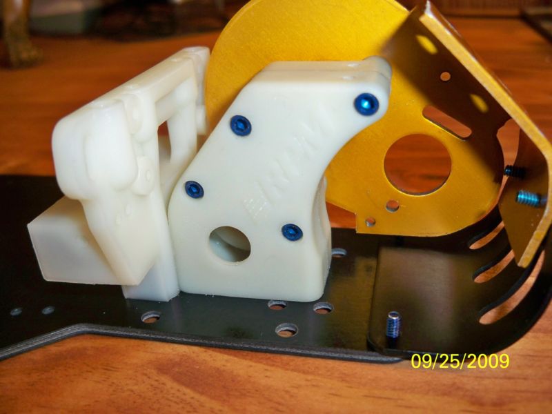

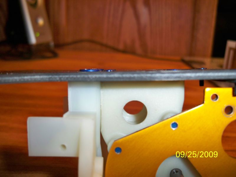

here is the first mock up . stuff to note the trans had to be fit as to not bind bulk head. The motor plate needed the 4th hole .
i will have to counter sink when im done .I will just wait and do all at the endjust race it
