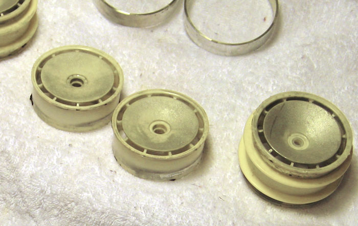

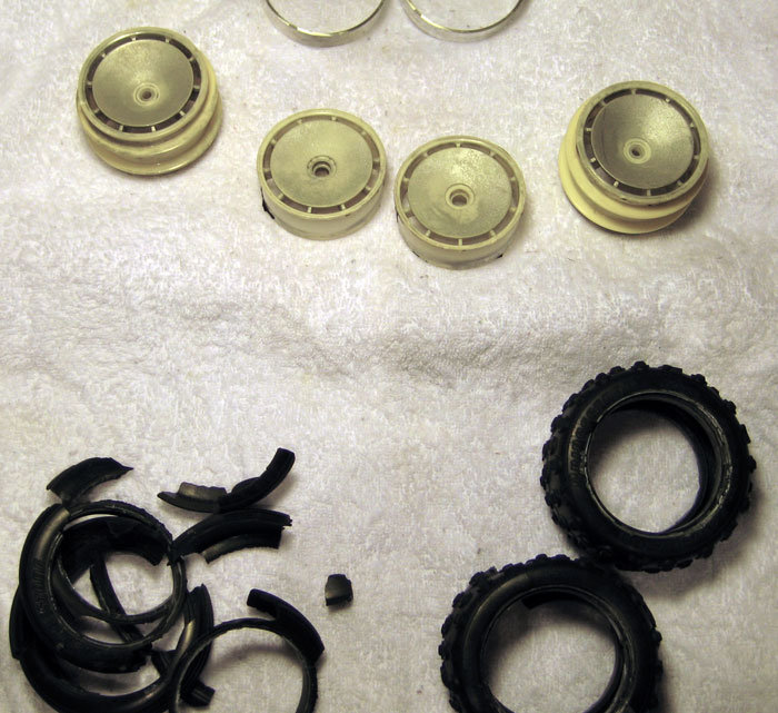

You can’t see it very well on the original photos but the tires on this car where badly cracked and I could not stand it. Decided to boil and remove them today and this is the result.
WARNING: Boiling the Silver wheels of the Turbo Ultima will remove some of the silver on them.
I was planning to give them a light coat of paint anyway so it is ok. Any recommendations on this are welcome. I got some ideas on tires for the rear but no idea for the front. They don’t have to be original Kyosho, any ideas?

Hi, for the paint wheel:
1/ degrease your wheel.
2/ 1 coat of adhesive paint (paint for plastic bumper real car).
3/ degrease again the adhesive coat.
4/ 2 to 3 light coat of the final paint (real car body paint).
5/ You can put a coat of varnish , like you want.
Don't put paint on the lips where you glue the tires.
And for the front tires Scorpion, Tomahawk maybe Raider car...look well...

Thanks guys. Thanks PRP, do you think I should keep them the same color? I was thinking they might look cool on a dark gray instead of silver.

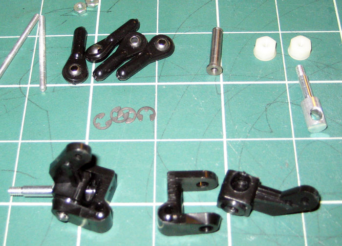

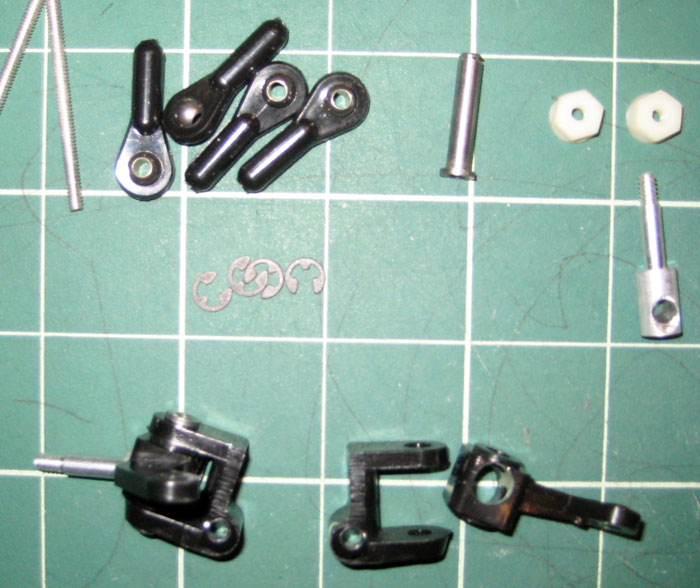

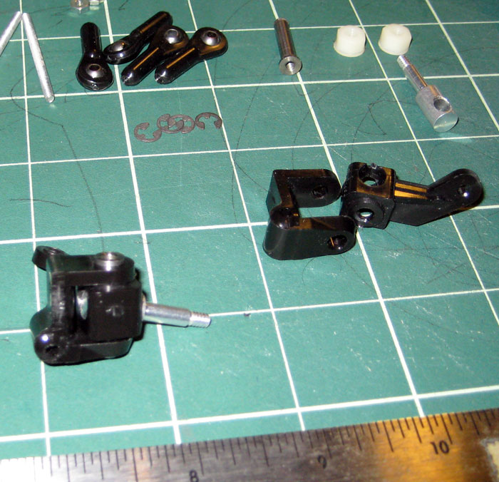

Build this last night. After having a hard time making the steering set up work smoothly I finally got it. Had to make some spacers and add some thread lock and it is working.
I hope to get some rubbers this next week and I’ll take some nicer pics in the sun.
