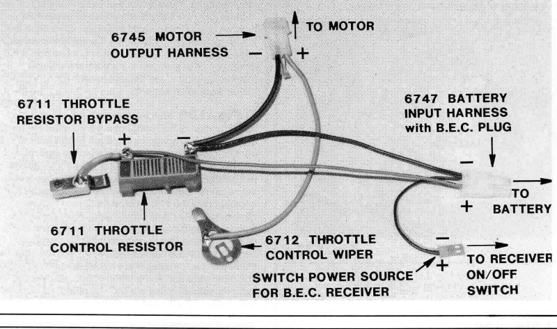

Here is a scan from the manual showing the viper arm and wiring
Hope that can help you find the problem

That resistor doesnt have a reverse. If your wiper is wired per the diagram, then check the motor.
Thats resistor only has forward and brake. So if it is going in reverse, it might be the motor wiring is backwards.

all uguys r helpin me out very much and each of ur post i appreciate... about the speed control the car goes forward when i pull the trigg reverse...but im not worried bout it anymore im jus happy to see it move again and when i get to show pops im sure he will be too... i talked to him earlier and ask about a few details abut what everones said and he insisted that is was all original...the arms are stock i guess the hobby shop in whittier ca sold em that way when he had bought his...but he insisted that the parts on it were never replaced...he did say the motor and that purple gear were changed out later but that everythng else came that way...i kno all the people on here really know there stuff so i beilieve all the lil details u guys speak of but i have to believe my dad also when he says he never broke or changed out anything... im gunna look at all the manuels and parts catalog n stuff n see what it says...i do remember when i was rebuilding it i had to reffer sometimes to the pic diagrams to see how thing went so maybe i can figure out excatly what needs to be changed...u guys have helped tremendously and its much appreciated...i never intended to sell the car i jus wantd to get her to run again and to show my dad that she still ran...after i got it to run but only when i pull reverse i got an itch to make it into a more modern car....but after fiding this site and askin a few dumb questions ive learned its much more than a lil rc car...it really was more about gettn it to run and shown pops but now its about restoring to neam exact and w all ur guys help im sure i can do jus that...now i gotta rean the manuels and look at the pic diagrams and see excatly what it is u guys are reffering to thnak u all and i will be talkn to ya later have a great day everone...thanks

and you should be able to reverse the servo on the transmitter.
Re: My Vintage RC10 Buggy a hole lotta pics
i kno i do believe all u guys and thats y i need to see every lil thing i need to do to it and i will and u all helped me to see what needs to be done... about the radio i can switch the speed from it but then the car wont do anythng...so i switch it to normal and the car takes off when i pull reverse lol and its jus stop or full blast lol and to stop i pull trigg reg lol idk its strange i kno what u mean by switchn the servo... i thnin its jus old lol it use to not work at all about 15yrs ago then i pulled it out and messed w it and got to work that way but only by pullin reverse...idk lol
