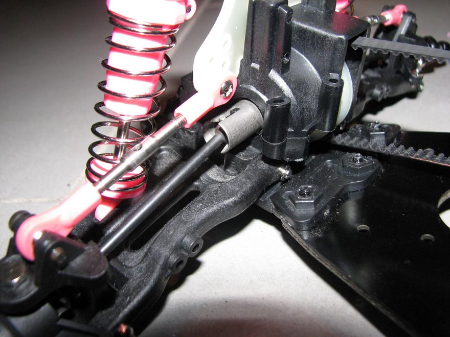

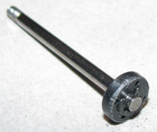

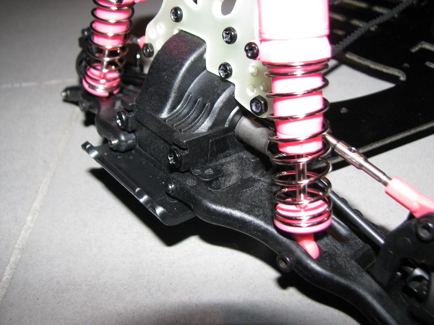

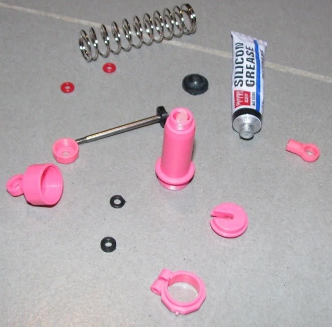

I don't know if it's on purpose, or just a mould flash, but that little ridge on the pistons had to go. It was causing friction with the shockhousing and slip-stick.
(Might have gone with oil, but I didn't think of that till later)
Some scraping with a scalpel: Nothing special here: And mounted up:

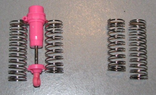

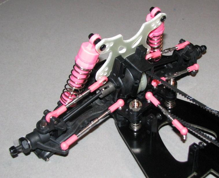

The pink shows lighter than it is because of the flash light. But I'm thinking of mixing some black parts in and make 2-tone shocks.
I've already used some Kyosho parts on the front shocks; pics and story will follow as fit in the story line..

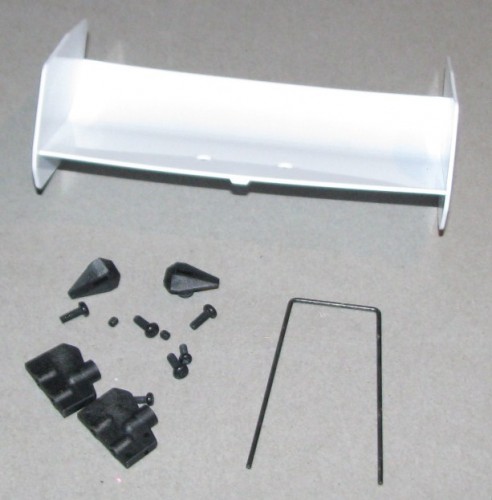

They did make different colour wings: white for the wyvern, blue for the wyvern EX, a yellow one on the griffin pro which is further identical. They also did blue white and green wheels of the wyvern style. But a pink wing and wheels I haven't seen yet I think.

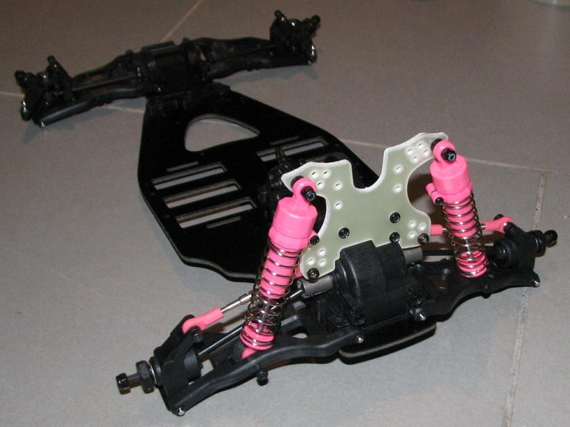

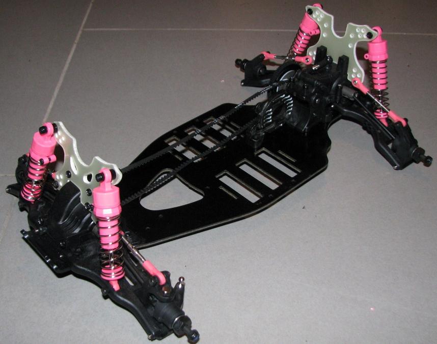

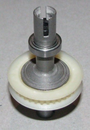

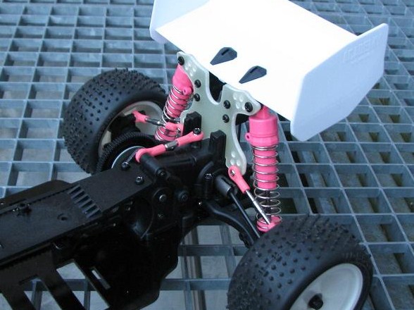

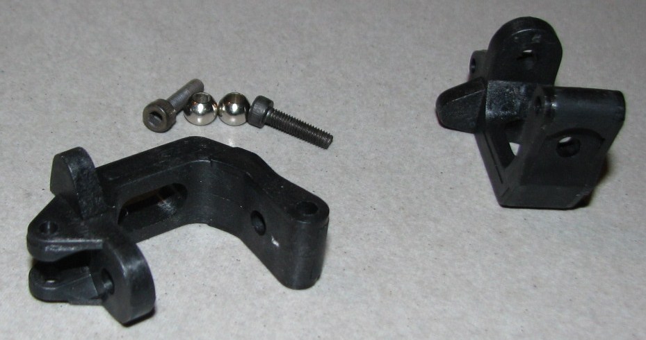

On with the build; time to work on the front.

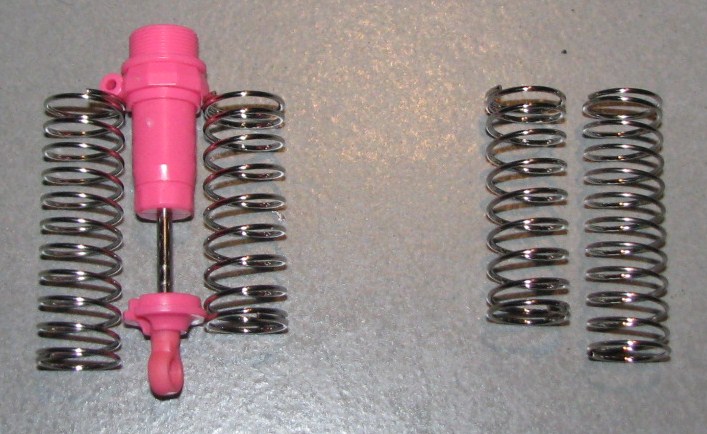

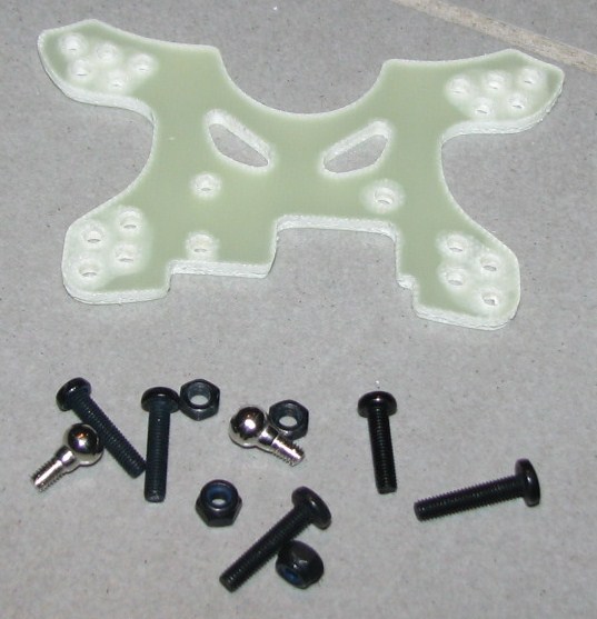

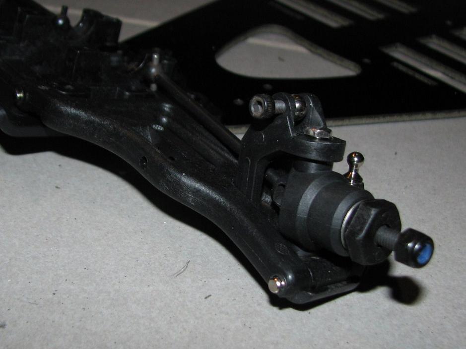

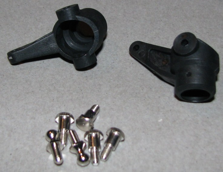

The steering knuckles look identic to yok's and pretty much the same as the lazer ones: I added the optional U-J's (same length as in the rear) and four 10x5 bearings: A colourless GF10 front shock tower to match the one in the back: I mentioned earlier I only have one set of front shock shafts. Well the same bag also contained the front shock springs: shown on the left of the shock. The shorter spring on the right is what I decided to use and came out of this package (about time those 18euro invested see some use) I decided to build the front diff from about 9 individual packs rather than to break open another ball diff kit. It's identical to the rear one, except it's natural coloured nylon. Set up a little tighter than the rear it's another succes. happy-happy joy-joy With the diff and shocks in place it's starting to look near ready Note the single lower shock mount hole, and placeholder for an anti-roll bar right behind the screws that hold the top of the gearbox on the bottom part.

Re: Academy Wyvern, 3 Sept 2012 update: building time!

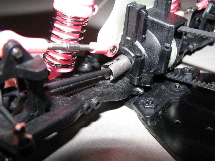

And the 2 mounting location for the roll-bar on the back of the front arm... An option that never came out for the public.

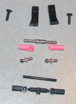

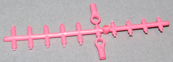

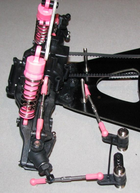

Note that there's no option to put bearings, nor need for them truely No servo horns in the kit nor spare parts, but plenty servo mounts. In the bottom the original rod and black plastic ball cups. The foundations are laid And on goes the rest
why do I have 2 of these left
oh, right; I used the included black ones for the rod that sets the tension on the rear belt. Let's mend that for "style" sake

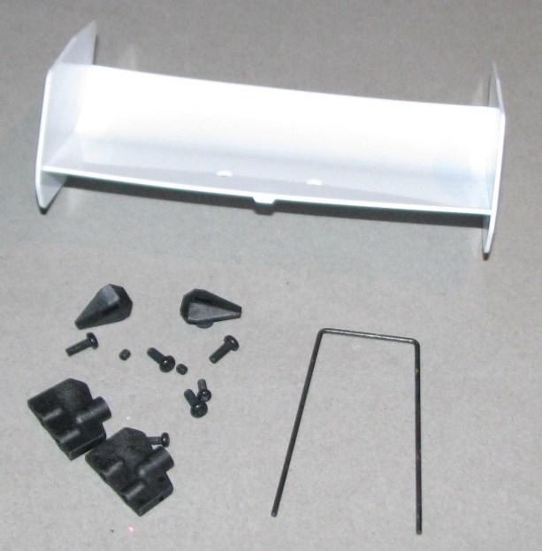

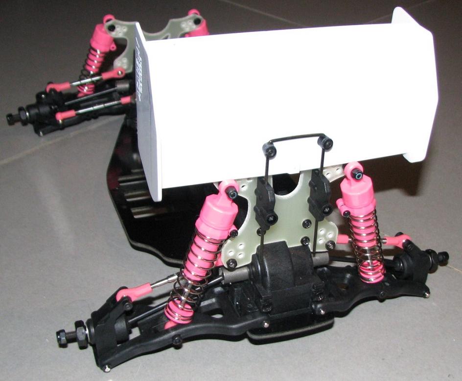

The wing is wire-mounted, not my favourite but will do for now. Nearly nearly there now
but I forgot to mount 1 more thing and it's bed time for me. So the last build steps and the remaining pics are for tomorrow.
(That's provided I find time as I'm running the day after tomorrow with my ultima and vaguely remeber something broke in its last finale)
Plenty of clearance for the diff outdrives with compressed suspension now. Thankyou Dremel.

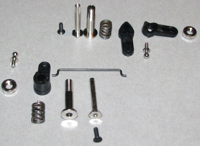

The steering unit is smartly done and rotates freely, al be it with a bit too much play perhaps. Here are the components.Note that there's no option to put bearings, nor need for them truely No servo horns in the kit nor spare parts, but plenty servo mounts. In the bottom the original rod and black plastic ball cups. The foundations are laid And on goes the rest

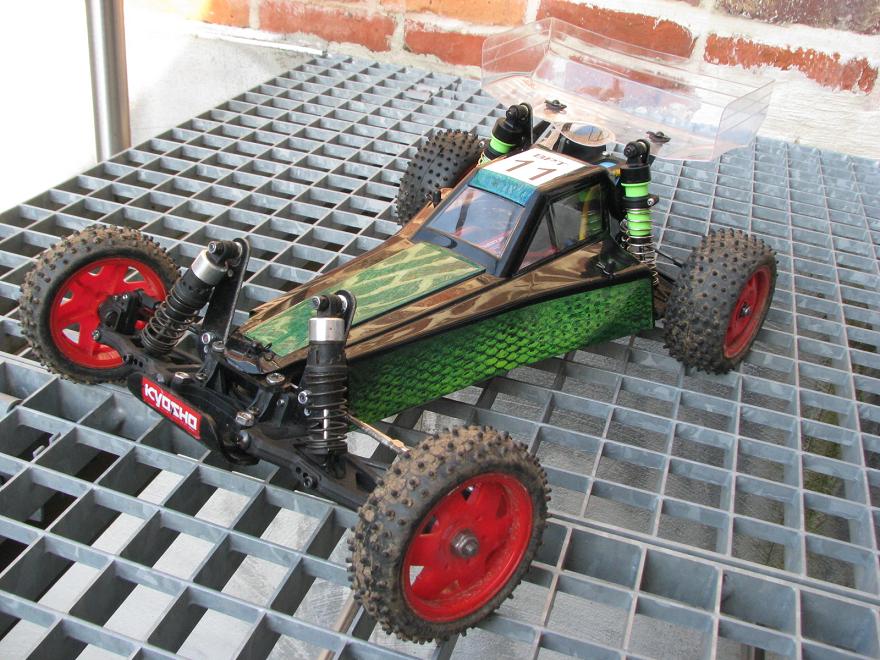

During the spare time between heats I built a mixed shock at the race: with green and black parts. It looks way better, so I'll probably do the same with these pink shocks. But for today I've had enough rc

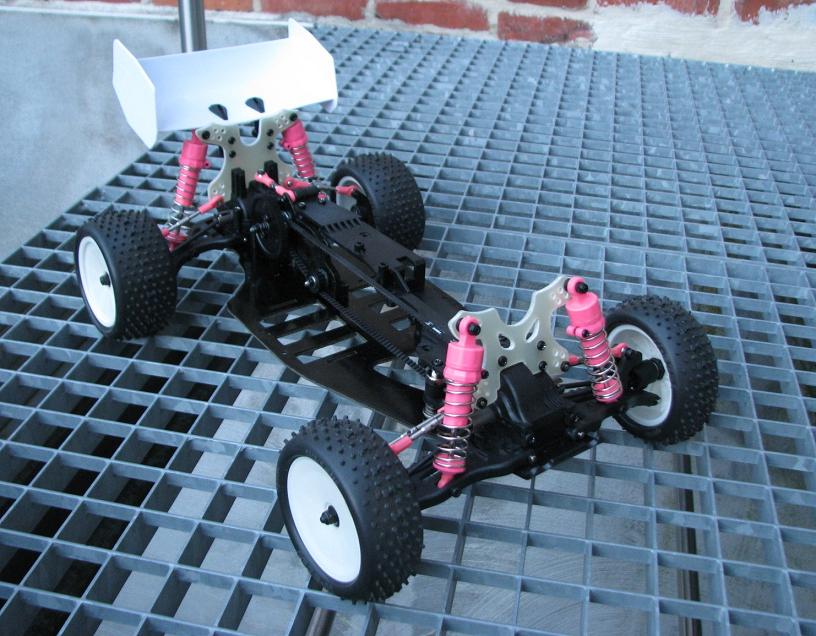

Re: Academy Wyvern, 13 Sept 2012 update: build "READY"

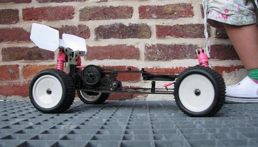

It's done, well almost: got to mount a body still.

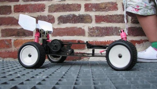

Please a little applause for my girl taking the car to the stage You can't miss the added topdeck. Fuggly but functional as it offers a position to mount the servo for the MSC.
(No , I'm not even going to mount that for the pics.) As well as a lowered position for the receiver: right on top of the steering servo.

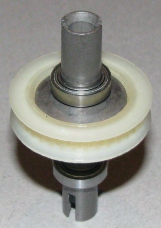

The belt tensioner is on the motermount , just in front of the pinion, and runs on 2 8X5 bearings. This shot shows the massive ride height. The rear might settle with the moter and battery weight on, but the front is going to need working on, no doubt. The rear belt tension adjuster; now in pink The wheels are the original ZX5 ones for the rear, and RB5 fronts. But that's just for the pics; once I'll be running it, the tires will dictate which wheels get mounted.
