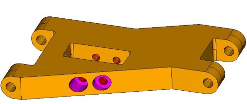

Any interest in the original style short RC10 rear arms?

There's no reason why it couldn't be done. I've thought about this too. My way of thinking is that you make some arms that are wider that pushes the stock hubs outwards to the desired location. Change the rear hub bearings and use a B4 or B44 (depending on what you did) cvd and be done with it. No custom works spacers in the rear. No B4 steering and wide axles up front. Simple. I am currently working on getting my garage shop setup the way I want it and have a 3 axis cnc router that is waiting to be setup. I plan to try it when I get everything finished which will hopefully be sometime this summer.

Re: Any interest in the original style short RC10 rear arms?
guess you guys didn't see jake's arms.....
http://www.rc10talk.com/viewtopic.php?f=6&t=25317
there's also 2 versions of longer front a-arms for the standard buggy nose plate too. both in the design/prototype stage, but i don't know if either one will be made for mass production. this one is mine.

I saw bigjeepzz's arms but as I understand it, he's not making them anymore.
Something for the stock buggy nose is what I had in mind, but my real question is can it be taken a step further than just extending the arms...can new arms actually change the geometry to improve the RC10's handling?
Now being upfront I have only a vague understanding of suspension geometry but to give an example of what I'm asking about...
When I look at modern buggies I notice that the front arms aren't swept back anymore like they were on older buggies. Some of Masami's RC10 were actually that way too. Could designing a set of arms that weren't swept back improve an RC10's handling?
If the arms are longer and therefore the camber links longer as well, by default that changes the suspension geometry to bring it closer to the modern buggies.

My Rc-10 has Jake's arms with custom works spacers in the rear and GT wide axles in the front. The width is almost an exact match to the B4. It handles great, and I am sure in the hands of someone who could drive it would be able to compete.

that would be the other arm i was talking about.Phin wrote:When I look at modern buggies I notice that the front arms aren't swept back anymore like they were on older buggies. Some of Masami's RC10 were actually that way too. Could designing a set of arms that weren't swept back improve an RC10's handling?

The party working on it can mark me down as hoping more than one set is made.scr8p wrote:...
I have a trailing arm chassis with a kickup that's extended, forward of the bellcrank holes, about 5mm longer than stock....and I'd like to accentuate the builds differences by using something new at the front end. The DT carpet arms are in consideration but I'd prefer not to cut those nose on the chassis.
