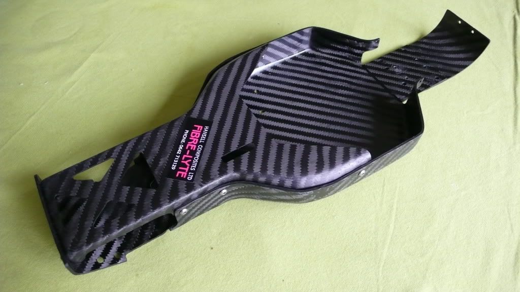

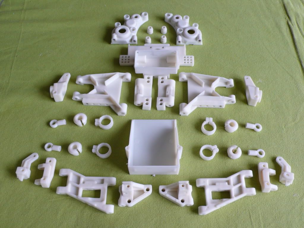

The chassis has now been stripped to the very last nut and all the parts were cleaned, degreased, lubed and even had to trim some left over flashing from the palstic parts. The car was generally in bad need of love, but in the end it cleaned up quite good. The plastic parts were first degreased and scrubbed, then they went for a 48h peroxide bath in order to get them back to somewhat whiter appearance. I have decided to change just a few details to this build: all screws will be replaced by stainless steel ones and I may also ditch the stock turnbuckles for some Tecnacraft ones. Ballcups will also have to be replaced as most of them are shot or in too bad shape. Tires were dry and will have to be replaced too. Otherwise all the original parts will be kept.
I really had to pinch myself not to dye the nylon parts with a hot pink dye. I think it would look great, but in the end I don't want to change it too much.

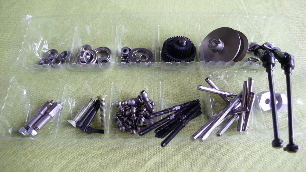

Here are the plastic parts after a thorough cleaning:
Steel parts also received a renewal treatment:
The chassis on its own:

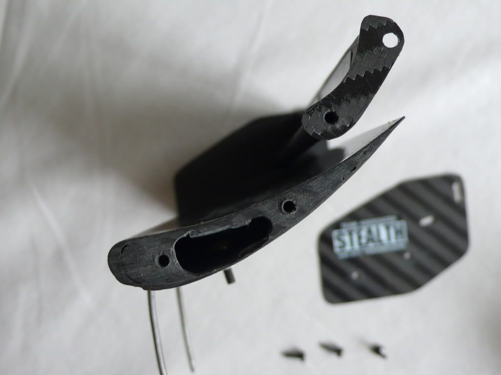

I thought the upper deck could be removed to access the servo and install the front parts but it it in fact bolted and glued which gave me a hard time to dismantle the front end as the only way to remove the front bulkhead parts is to isolate the front shock tower, remove all the parts and then only slide and put the tower at an angle so that it can be removed. Not really race-friendly...
Funny little detail:
And I also realised they glued a piece of carbon underneath the Stealth and the rear bulkhead, most probably because the 2 side chassis holes that hold the the bulkhead were too high like it was already the case on some production chassis. Nevertheless, said holes are here flush with the bulkhead where some production chassies from Fibre-Lyte were delivered with 2 tabs in order to compensate for the remote holes.

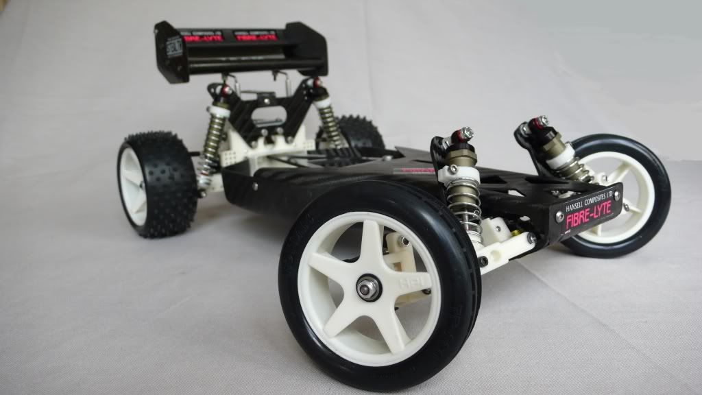

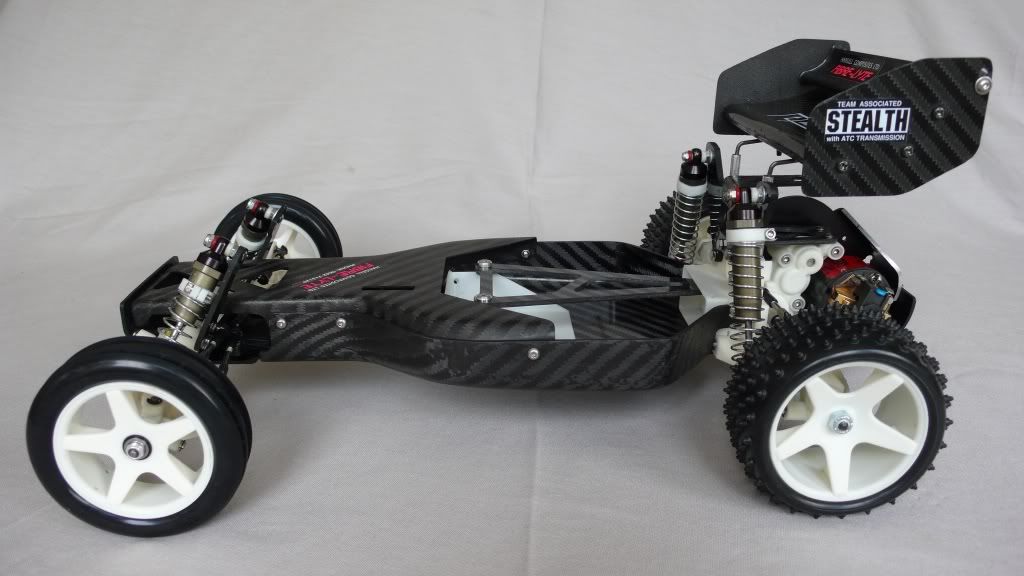

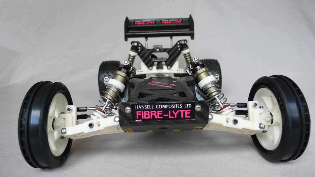

Thanks for the nice comments gents, much appreciated! I love this thing, and I really have a weak point when it comes to carbon tubs, I just love them, especially for all the engineering work that is behind them.
Anyway, it is not finished but I made some good progress last week but forgot to take pictures while reassembling as I was so anxious so see it on wheels, lol.
So, most of the original car is still there, I just replaced the following stuff:
- new stainless steel screws all around
- white RPM shock ballstuds
- RCPS turnbuckles
- black AE ballcups
- MIP zero maintainance steering assembly
- Proline rear tires / Yokomo fronts (original tires were cracked, but I might revert to Schumacher tires all around as this is a typical British car)
- Fibre-Lyte battery holder (original one was missing)
- rear shock caps were replaced with some better ones
- DEMON motor was included in the RC10 box, so I just put it back in place. I like the fact that this is also a typical British item.

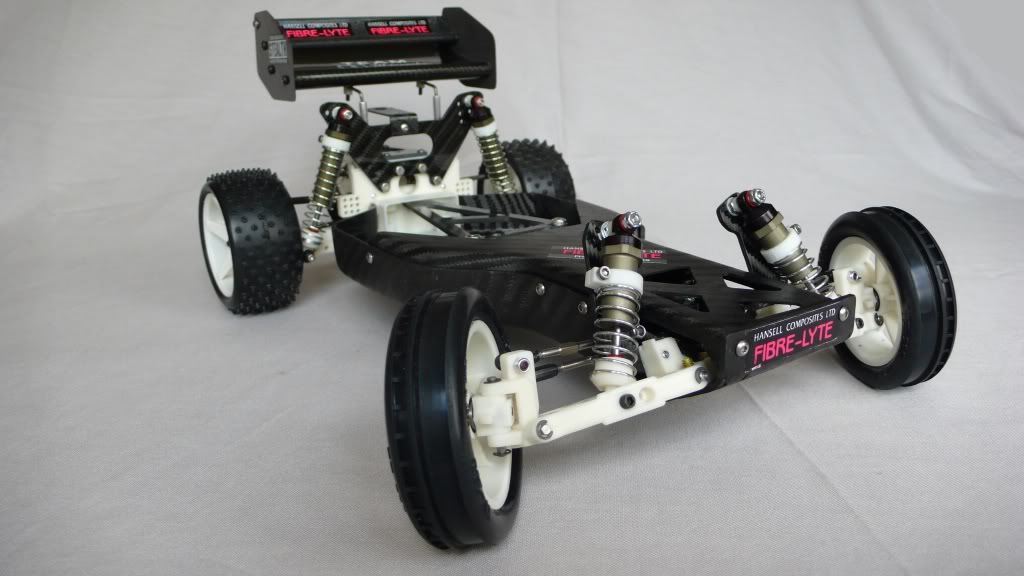

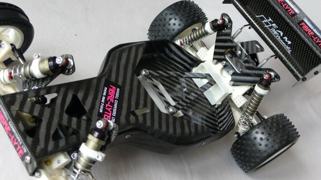

I also wanted to show you guys the amount of work that went into this wing, it's just amazing...
Here it is back in all its glory:

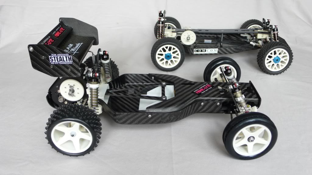

The car with its Yokomo counterpart in the background:

Thanks Dan! I also have its Kyosho Lazer and Schumacher Cougar 2000counterparts in fact, but these still need to be restored. Let's not forget the crazy MIP Legend versiontoo!
