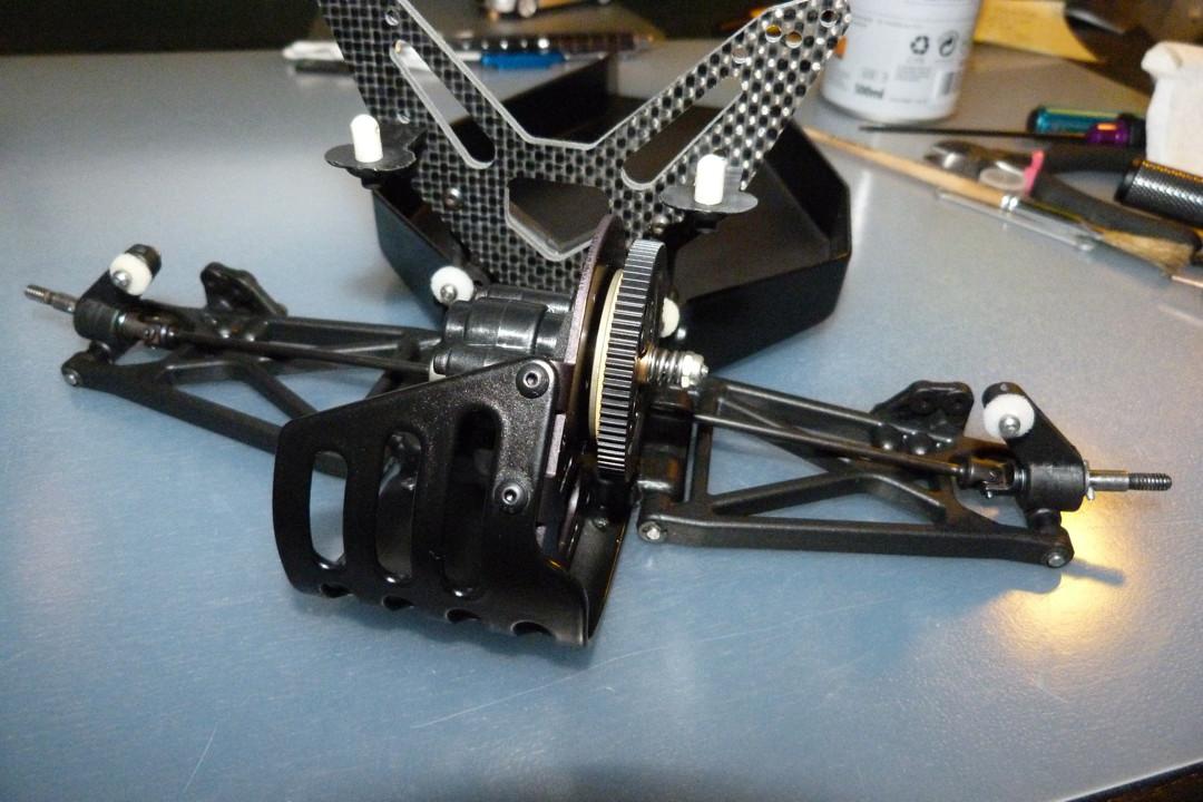

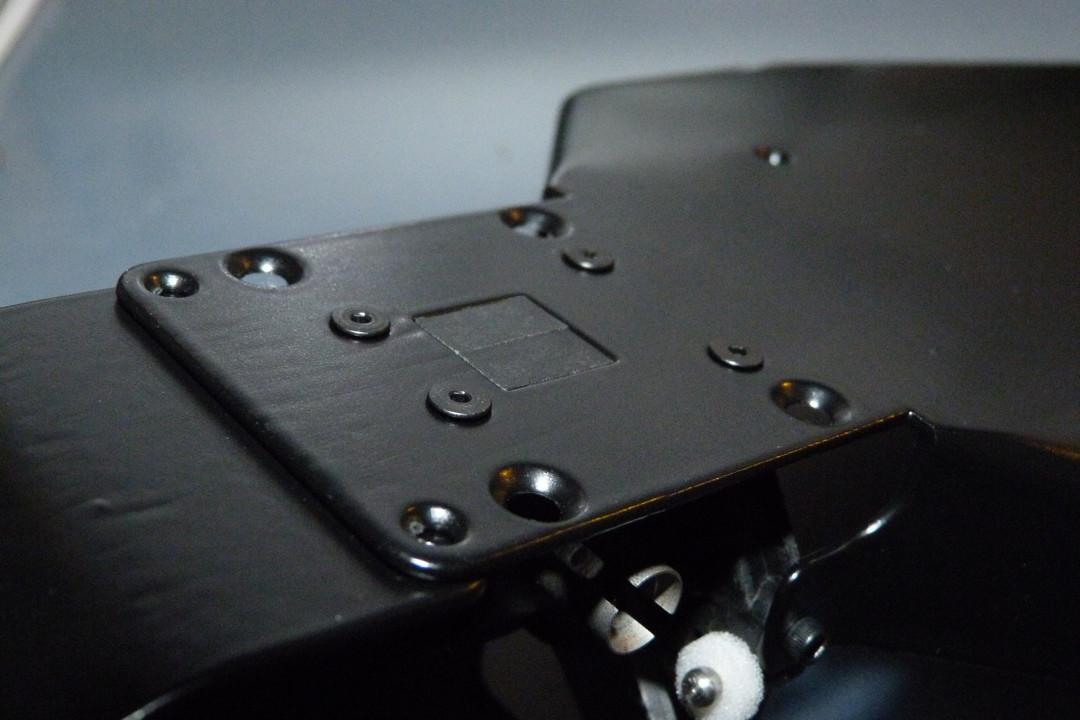

Re: Restoring an old RC10T2
I've made some progress today....
Unfortunately I noticed that screws heads look out of place, hanging down on the chassis...
Now I have to wait for the last spare parts. I got from liquid rc still no shipping confirmation :-/
I used a lot of new parts because I decided to use the old one for a second T2 project.
New diff case, new towers, new suspension mounts...take a look
these are the parts you powder coated right? that could be why your screws are hanging. try using a countersink bit to remove some of that powder coat. that should make your screws more flush with your chassis. i had the same problem with all the screws on my t2 tub too.
Yes, these are the powder coated parts.
Just have to find the right tool to do it
