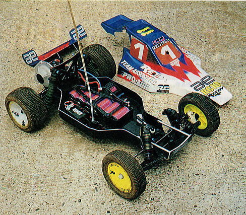

This should be my last Worlds build. Should..... :lol:

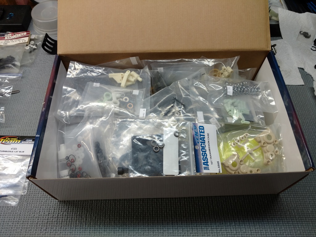

So, this one is going to be a modern replica of the rc10 Mark Pavidis used to win the '95 Reedy International race. Since I am starting off with a new kit, I probably won't take all that long to build. But, there is a lot of cool chassis mods that I am looking forward to getting into on this, and that will surely slow it down.
And the 'ole box-o-parts......

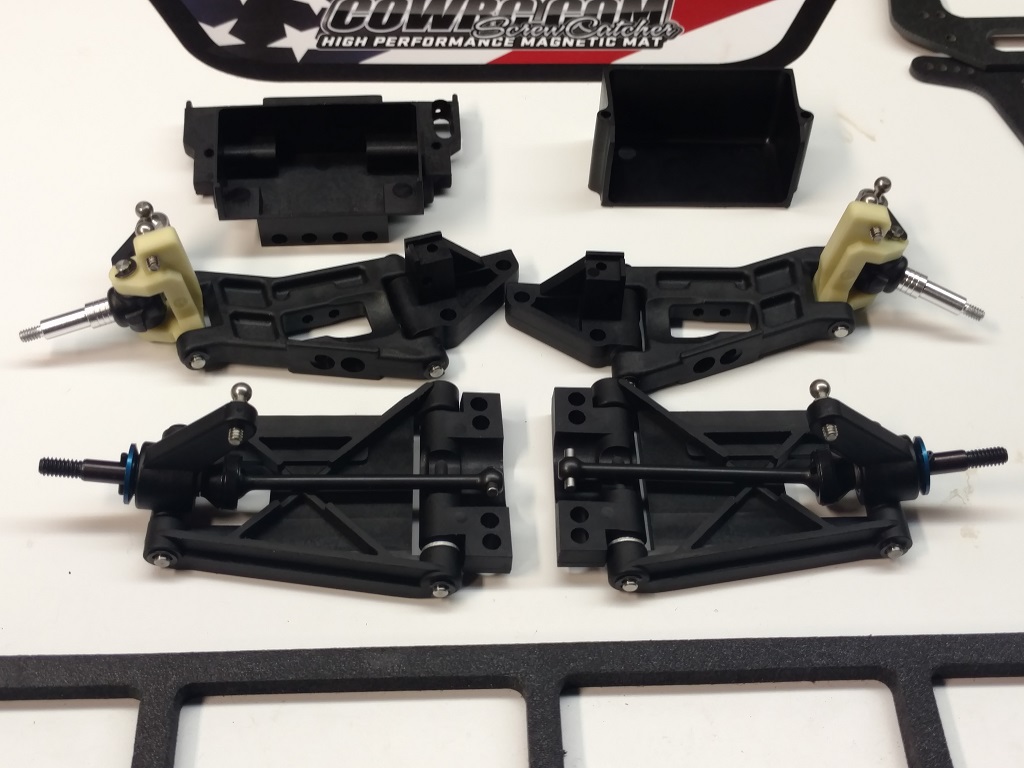

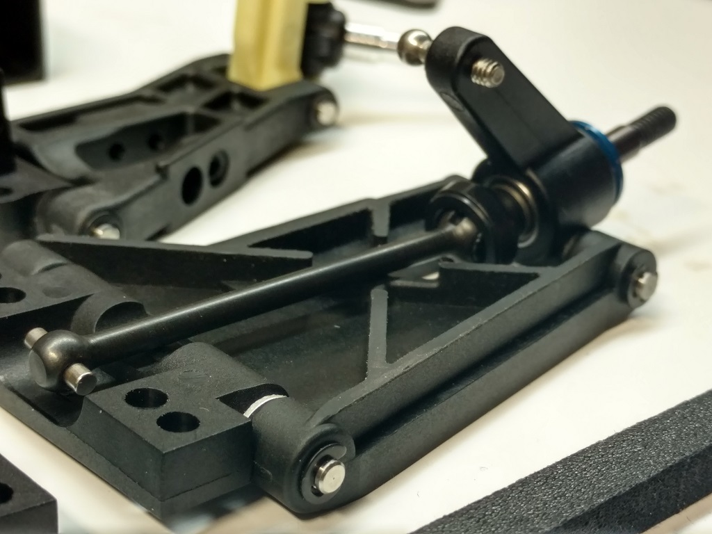

Held up on other builds, so I figured I'd get rolling on this one. Shortened the battery box, shaved down the rear arms, did the alterations to the rear bulkhead, and dyed a bunch of it black. I'm not super happy with how the bulkhead came out, so I may get another and redo it. On the original, Mark opened the bulkhead up along side of the wing tube so the motor wires could pass through it. Well, I wanted to do the same thing, but running brushless, I now have (3) 12g wires to deal with. Because of the added length of the slot, the wires are gonna be very close to the ballstud/ballcup and I worry about them touching when the suspension compresses. But, I guess we will see.
I also got the trans assembled. Not pictured though. It's currently going through a 3,000 rpm break in period on the drill press. Should have just used the US case. :roll: :lol:

I've wondered what it meant by "shaving down the rear arms". Looking good!

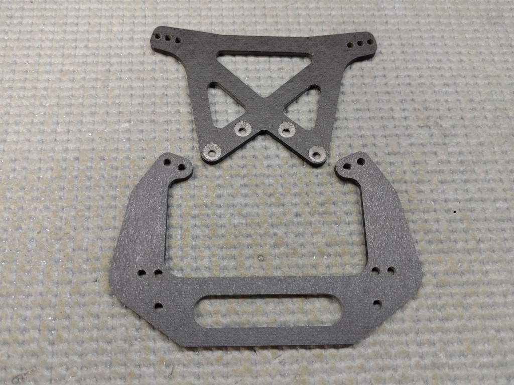

Got the tower mods done. Countersunk the rear mounting holes and removed the outer upper mounting holes front and rear.
And then, started rolling on the chassis mods. More to come on that later. :wink:

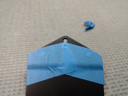

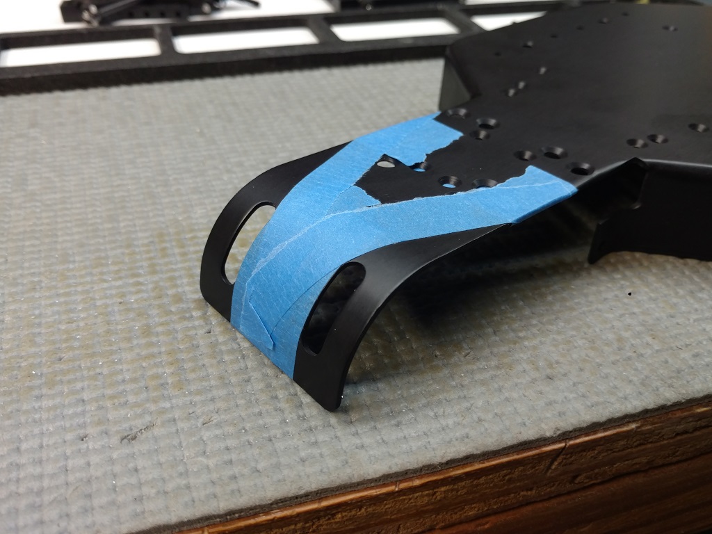

Yeah, this one gets cut up quite a bit........ and I just got started and already slipped once. :roll:
It's not horrible, but it still bugs me. Gonna try touching it up. But first we'll see if I slip anywhere else. :lol:

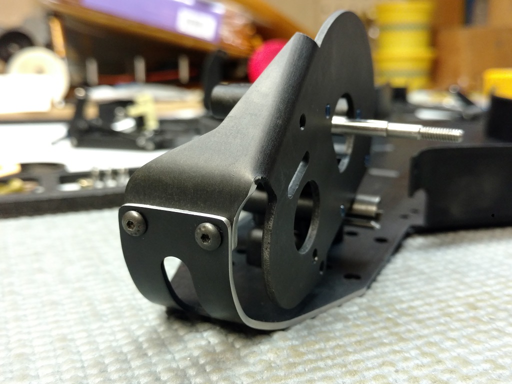

Spending more time with Mr. Dremel tonight. Got the motor plate finished up.

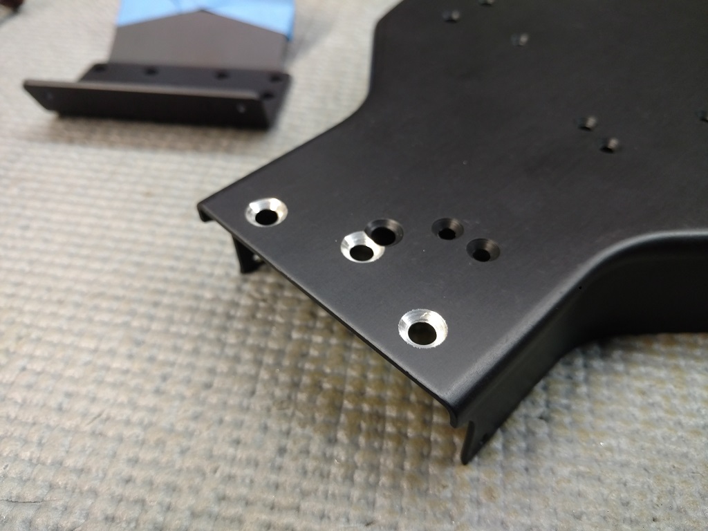

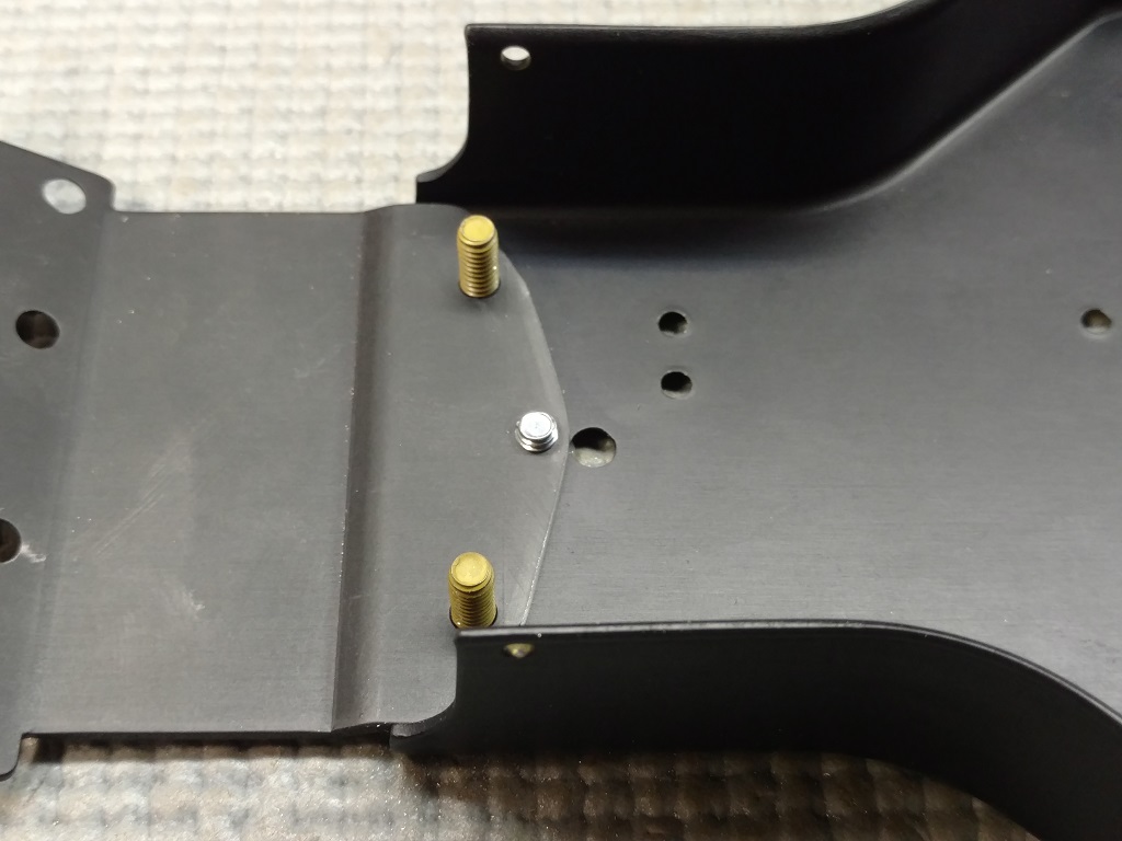

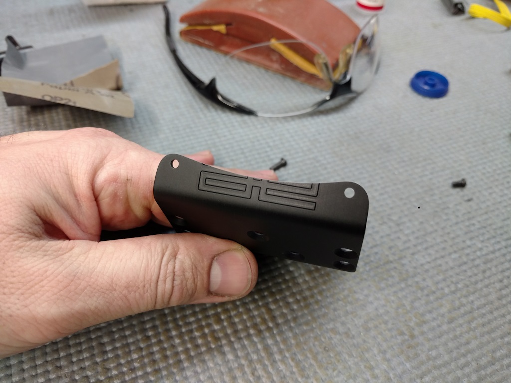

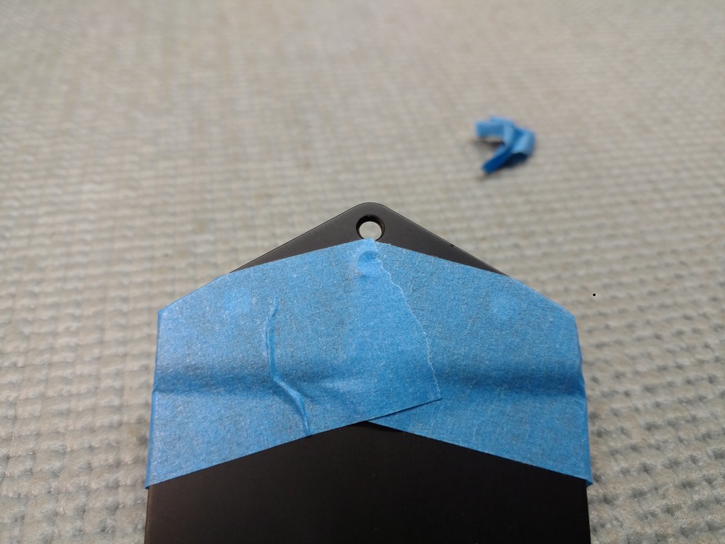

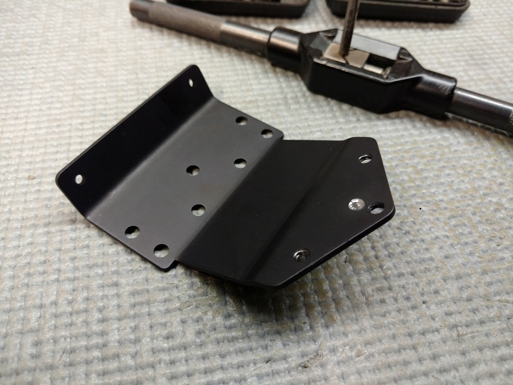

Then I moved on to the front of the tub and nose plate. On the original car, Mark moved the center screw in the nose plate forward so he could push the servo further forward and shortened the back of the plate. So I drilled and tapped a new center hole in the plate and counter sunk the hole in the tub. Hit the other 2 a little harder while I was at it.
And then made the cuts to the back edge.
Now I can move on to the front of the nose plate...........
Posts: 16805
Re: Scr8p's Worlds Rere #6 / Modern Pavidis Replica - '95 Reedy International
OK, nose plate is done...... and so am I. Tomorrow is another day.

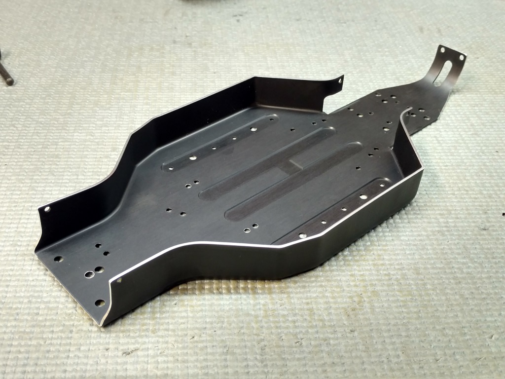

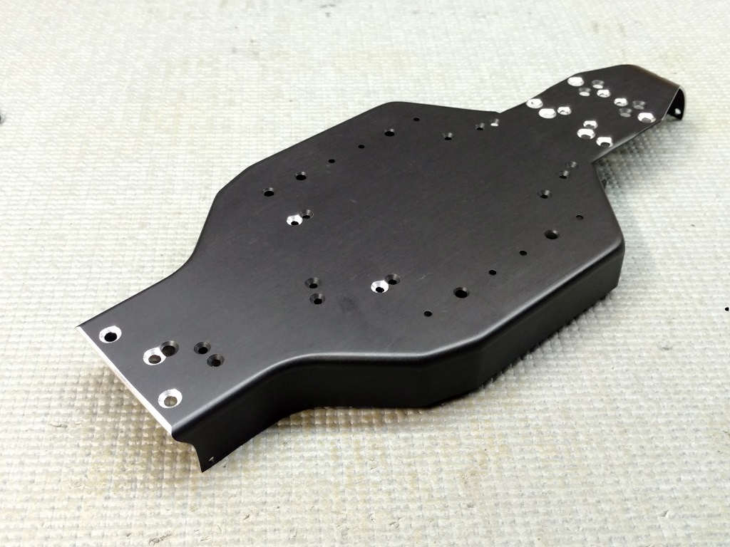

Alright, tub mods are done. Took an 1/8" off the sides, rounded off the front edge, and moved the battery box ahead. Now if i had some blue 8-32 screws I could start throwing parts on it. :mrgreen:
