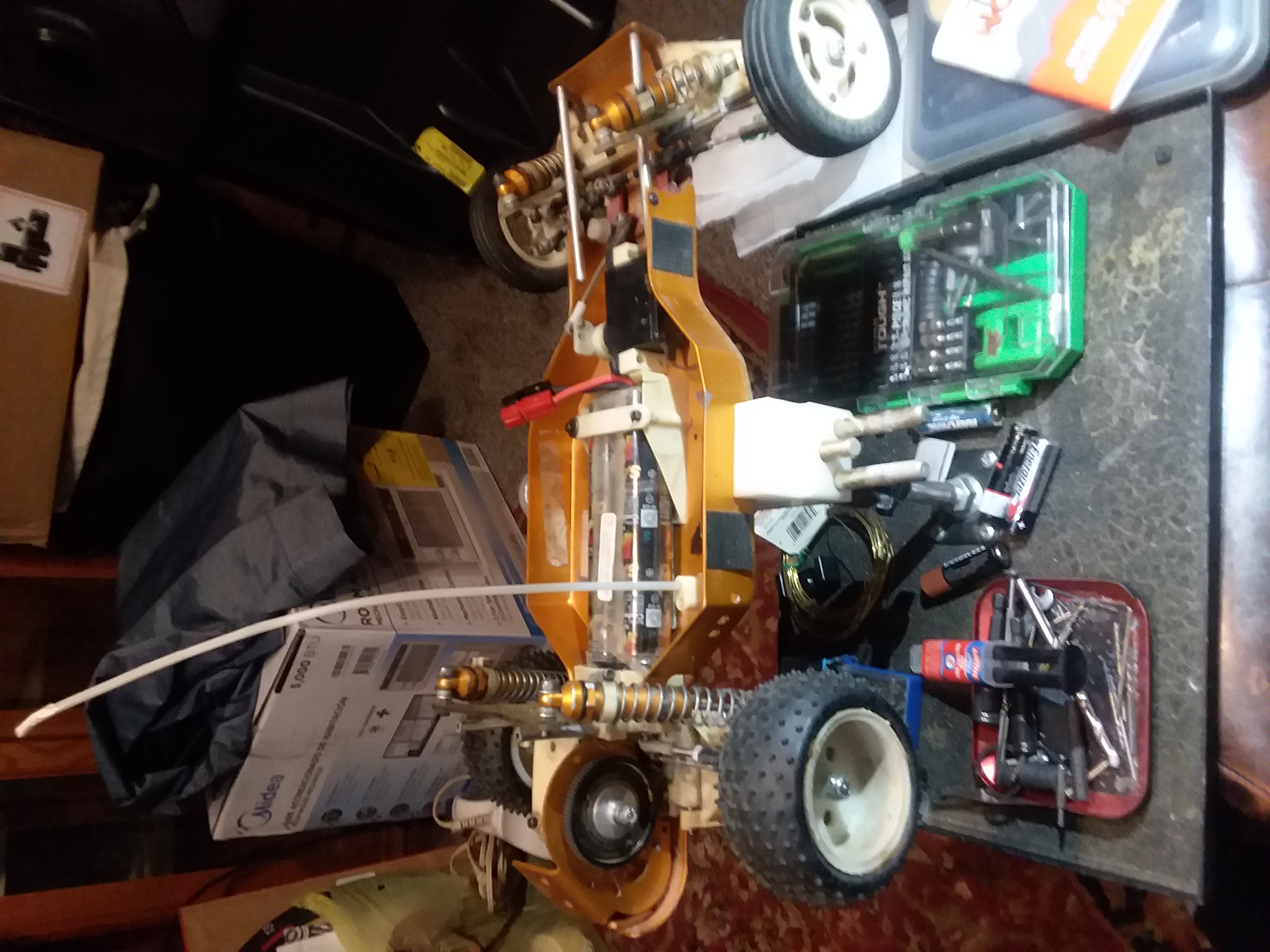

1300GT wrote:Just finished the RCCA outdrive mod. I thought I'd post some photos for anyone who isn't sure about how it's done. I've already fitted the flanged bearings and circlips in the outdrive gears. Don't fit the unflanged bearings. The outdrive hole in each of the gearbox halves is drilled out to 1/2 an inch. The brass rings have an inner diameter of 3/8 of an inch and slide over the outdrives and stop the outdrive gears from floating sideways. You only want them wide enough to let the 3/8 by 5/8 outdrive bearing seat properly and allow a minimal amount of sideways clearance. The 2/56 screw in the left gearbox half stops the outdrive bearing from working loose. The right hand bearing is held in by the motor plate. Any questions just ask.

  • Orangemazda, 2.55mm = .100". I bought the brass tubing from the K&S stand at a hobby shop. The stock number is #136. It's 13/32 outer diameter with a wall thickness of .014". Take an outdrive with you to make sure that it fits inside the tubing.
  • SnoopMax, I rechecked the brass ring width and mine are 2.55mm. I am using outdrive bearings that are 10/51 or .196" or 5mm wide. If you are using 5/32 wide bearings that would account for the 3.55mm width of yours.
  • Chris, the brass ring does exactly that. It stops the outdrive from moving outwards because it butts up against the inner part of the outdrive bearing. I didn't use the button head screws inside the outdrives.
I hope this helps.
