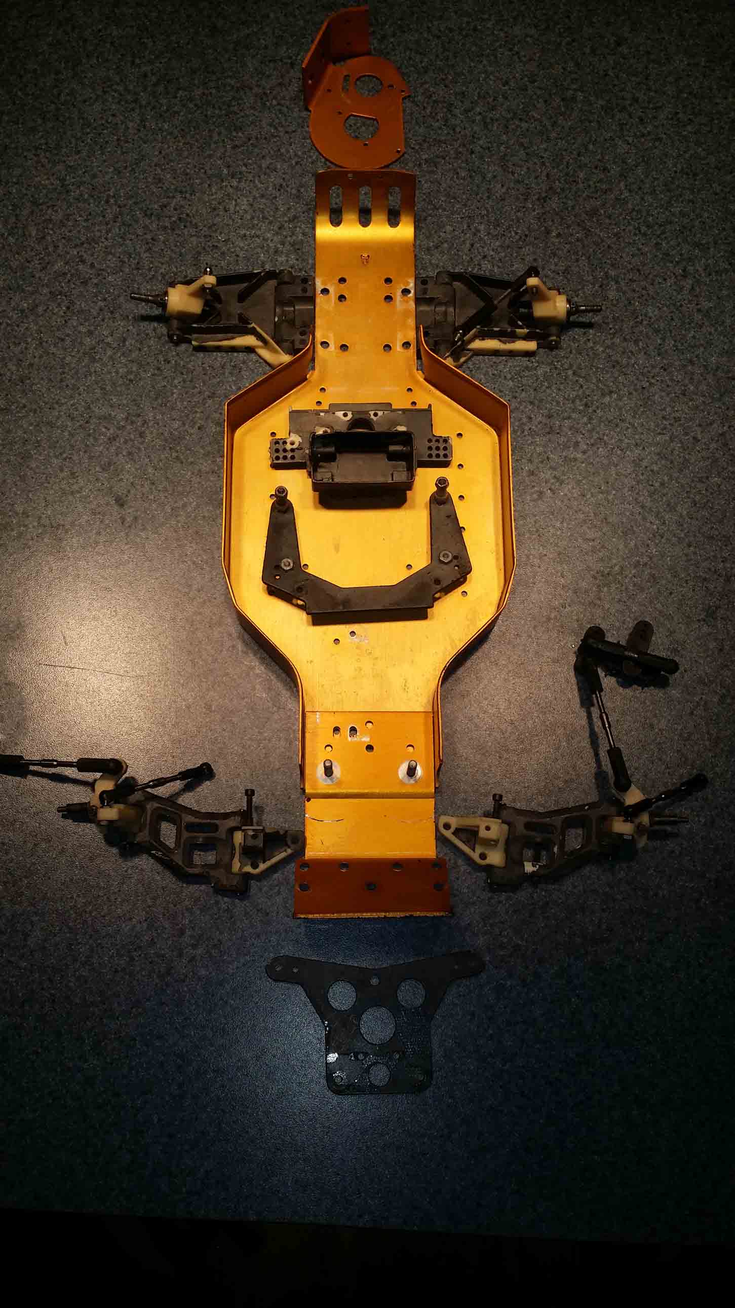

Ok so a friend gave me his old A stamp car to get running. I would like to update it so that i can get parts that are more available. What i think i have as follows.
A stamp w/6 gear
Looks like Andys front a arms

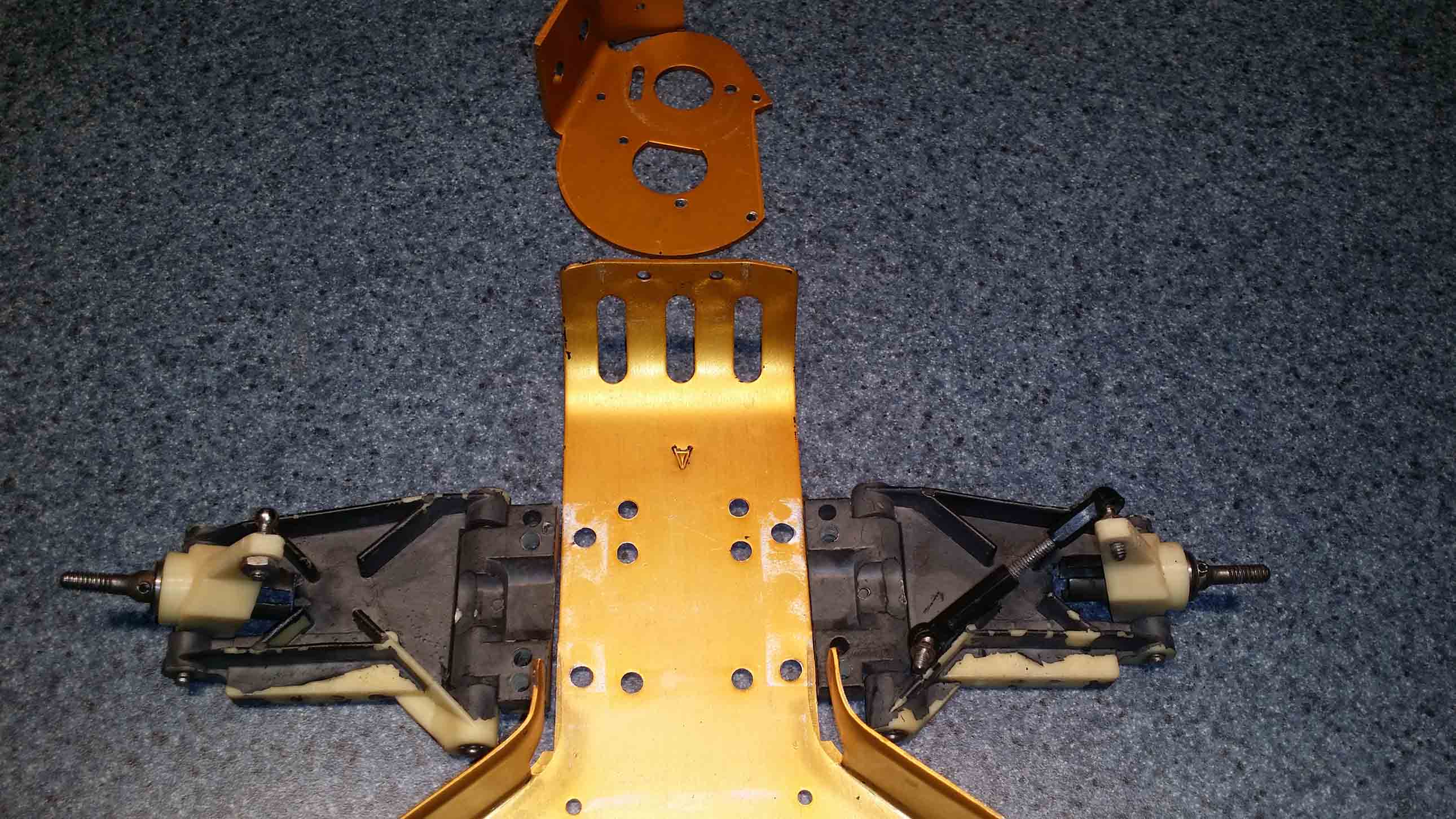

Possibly stock rear a arms?

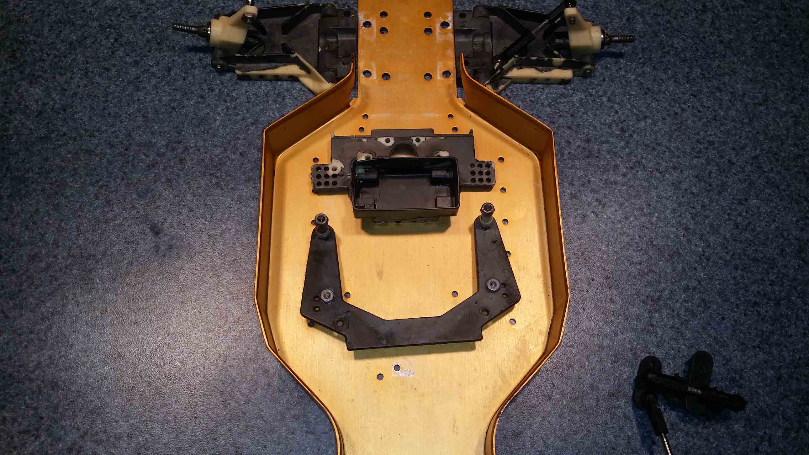

Nose piece i have no clue?

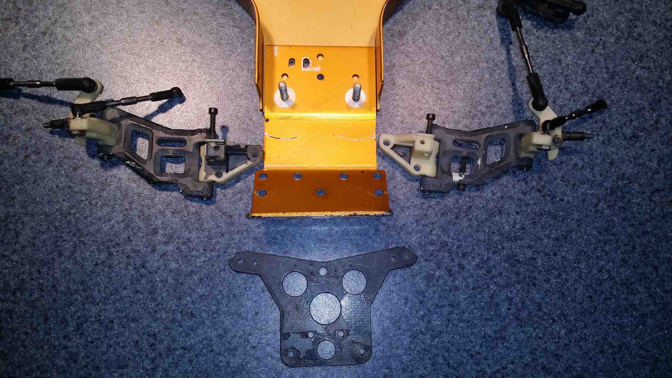

Shock towers i have no clue.

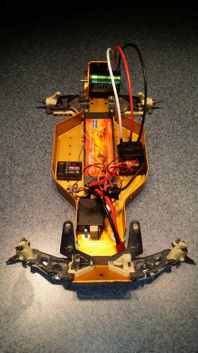

3800kv castle crea motor and speed control (may not be best but will have to work for now).

A stamp w/6 gear

Since the RC10 Classic was released, you really could have kept it as-is and still had an ample parts supply of pretty much anything that car would need. No need to dump a lot of money into it.

If i build the worlds car front end what do i do about shocks and shock towers?

bully and bottomfeeder are correct. Associated re-released both the classic rc10, which will be extremely similar to your A stamp; and the worlds car, which has some updated stuff.
with the classic re-release, you can get new tires that fit the original wheels, or you could update to the worlds wheels which are 2.2" for modern rubber. these are RC10B2-like that fit on 3/16" axles, and the fronts are B4 style, which use a longer axle. Both conversions are available.
either way, all the parts you need should be in stock at places like amain hobbies or tower hobbies to get the A stamp up and running.

OK, looks like you have a decent start. With absolutely no trans and the mention of going to a brushless system, going to a stealth is a good option. You will likely need to drill and tap another hole in the motor plate for the stealth.
the shock towers are stock, and not a problem to run. The front arms are andy's and are the same length as the 'team' arms which are the widest bolt on arms available.

I do have the 6 gear that came with it and it need idler gears. Just going brushless i figured i would need the stealth. I also ordered the carbon drill plate template so i could drill the new holes for it.

This is the electronic setup i have for now, if it's to much i can either turn it down in the controller are the esc. Any thoughts on pinion size with the 81t spur slipper clutch i guess?

Those new Worlds shocks will be too long for those Andy's front arms which only have the inner mount for the shorter .56 shocks. You'd be better off spending $5 for some new Worlds front arms instead of trying to make the shocks shorter with spacers or whatever.
The original shock towers you have are fine for the Worlds shocks. No need to replace them if they aren't broken. Save your money unless you really want the carbon bling.
The bottom of the rear bulkhead will probably need to be trimmed to fit modern hard-case Lipo batteries. The front battery cup will need to be moved forward unless you're planning on using shorty packs.
A Stealth is always a fine upgrade but don't assume it's necessary. A six-gear transmission will live behind a mild brushless motor as long as it's in good shape. If all the six-gear needs is idler gears and a rebuild, the re-released and supposedly improved idlers are available. Basically EVERYTHING for a gold pan RC10 is available again thanks to the Classic kit reissue.
The rear axle conversion kit would not be necessary if you bought those CVA shafts, but you would still need the rear hubs and 3/16 x 3/8 bearings. On the other hand, buy both and the only thing you'll have left over is the new 3/16 axles and the original dogbones.
