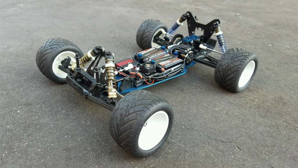

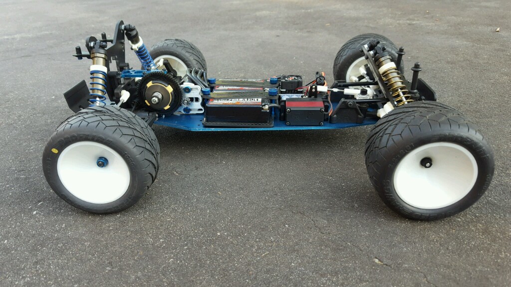

Pretty much at the tail end of this. I got my shocks and mounted them up. I am going to dye the white shock parts black as it fits the era of the truck better. I thought I'd try the white shock accessories to compliment the white ball cups but meh, black they will become.
Everything on this chassis sits low, at an arms level ride height everything except the shock towers are below the tops of the tires.
I've got the body painted but just need decals to finish it off. I will also likely order Fiber-Lyte shock towers for this then I can call it done.

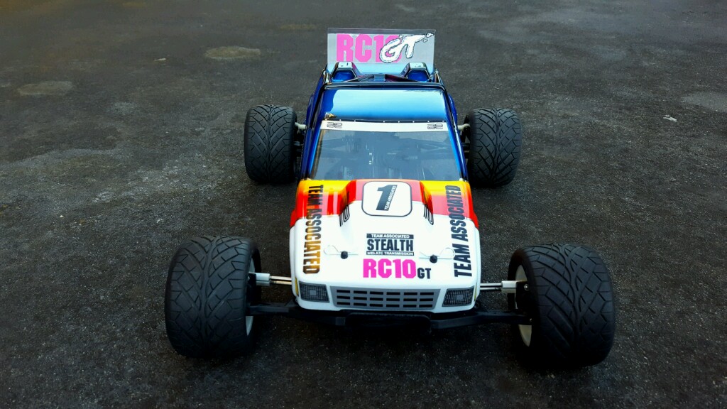

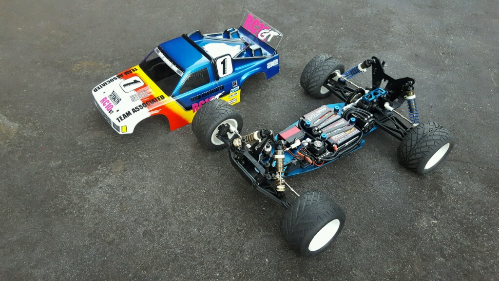

I can nearly call this done, just need shock towers. The body came out fairly good as there are a few things I'd change next time. It's a bit of a mash up of the different AE schemes and is fairly fitting I think considering the truck is a mash up.
I was planning on running this truck on the track a fair bit (like most of the other trucks I put together
) but I'll probably just end up running it up and down the driveway a couple of times and put it away.
