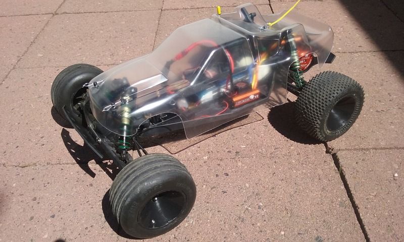

So I wanted to put something together for my brother and his family to have fun with.
I repaired the old T3 and went all the way through it. Checked and adjusted shocks, replaced arms, c-clips, went through the stealth, diff, upgraded the slipper to T4, installed a 9T brushless setup with program card, 2.4hz rx/tx, re glued the tires, cut out a new body and added front and rear TBoneracing bumpers.
I put in a 20T pinion and 81T spur and, Oh my, it is a bit of a monster. I had the timing low and punch up and it was violent from a stop, after some adjusting it is pretty smooth and very controllable.
I'm a little jealous as I recently hurt something in my new SC10 transmission in my T4 basher, and this T3 runs and drives like a dream.... while I stare at my new, upgraded, transmission in the T4 making a thumping noise.
I'm unsure about the paint so far, I was thinking maybe a bright orange with a checkered flag. Give him something flashy.

Jimbo302 wrote:I'm unsure about the paint so far, I was thinking maybe a bright orange with a checkered flag. Give him something flashy.
Depending on skill levels a nice tongue in cheek this end up painted across the top lol
