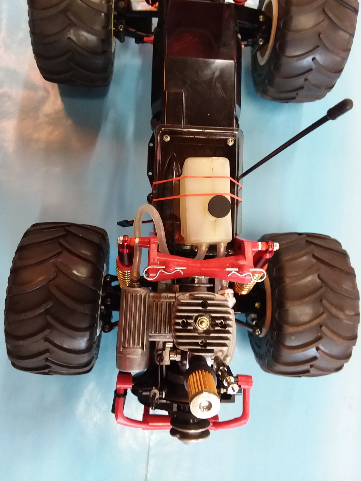

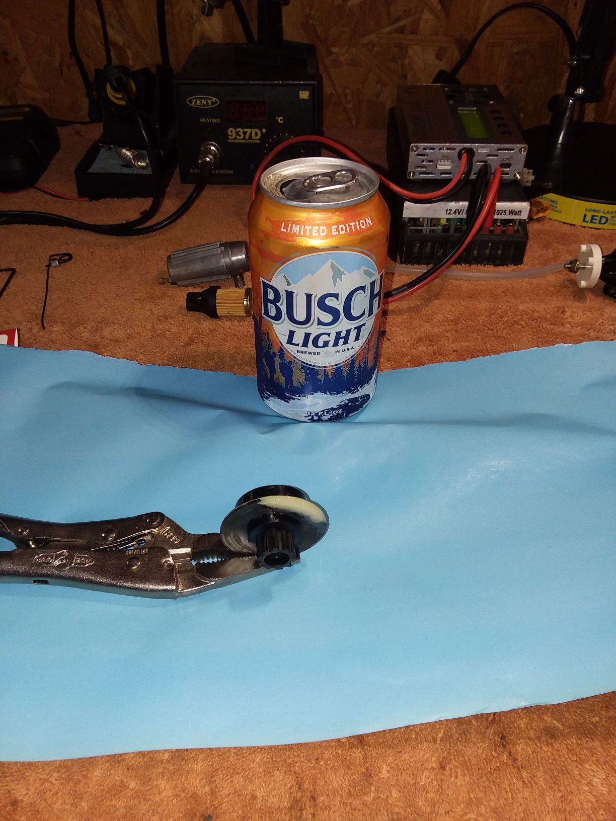

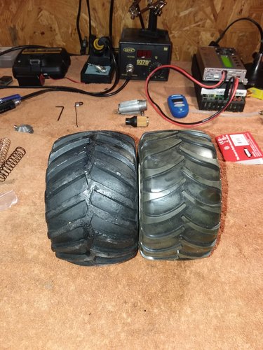

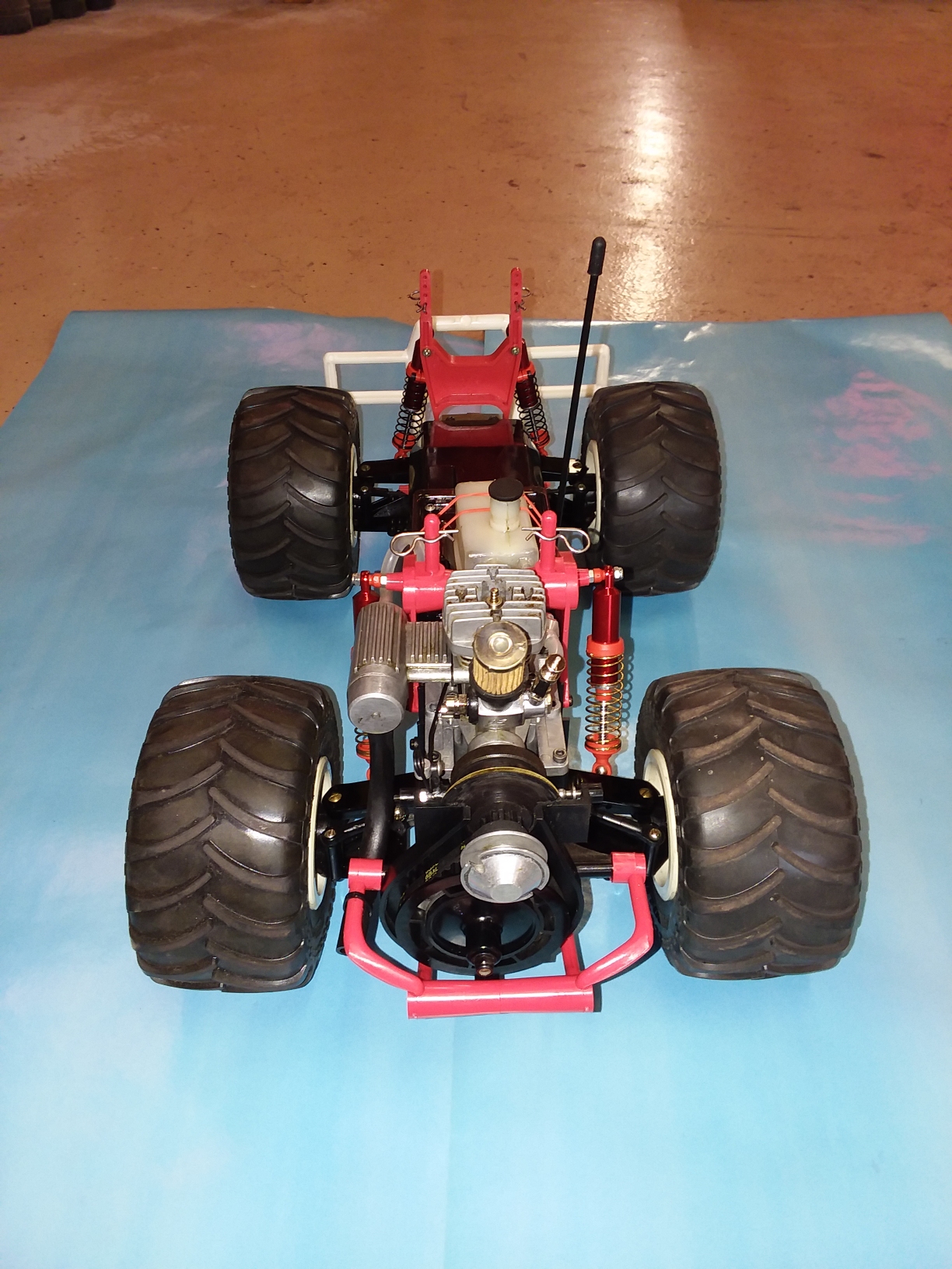

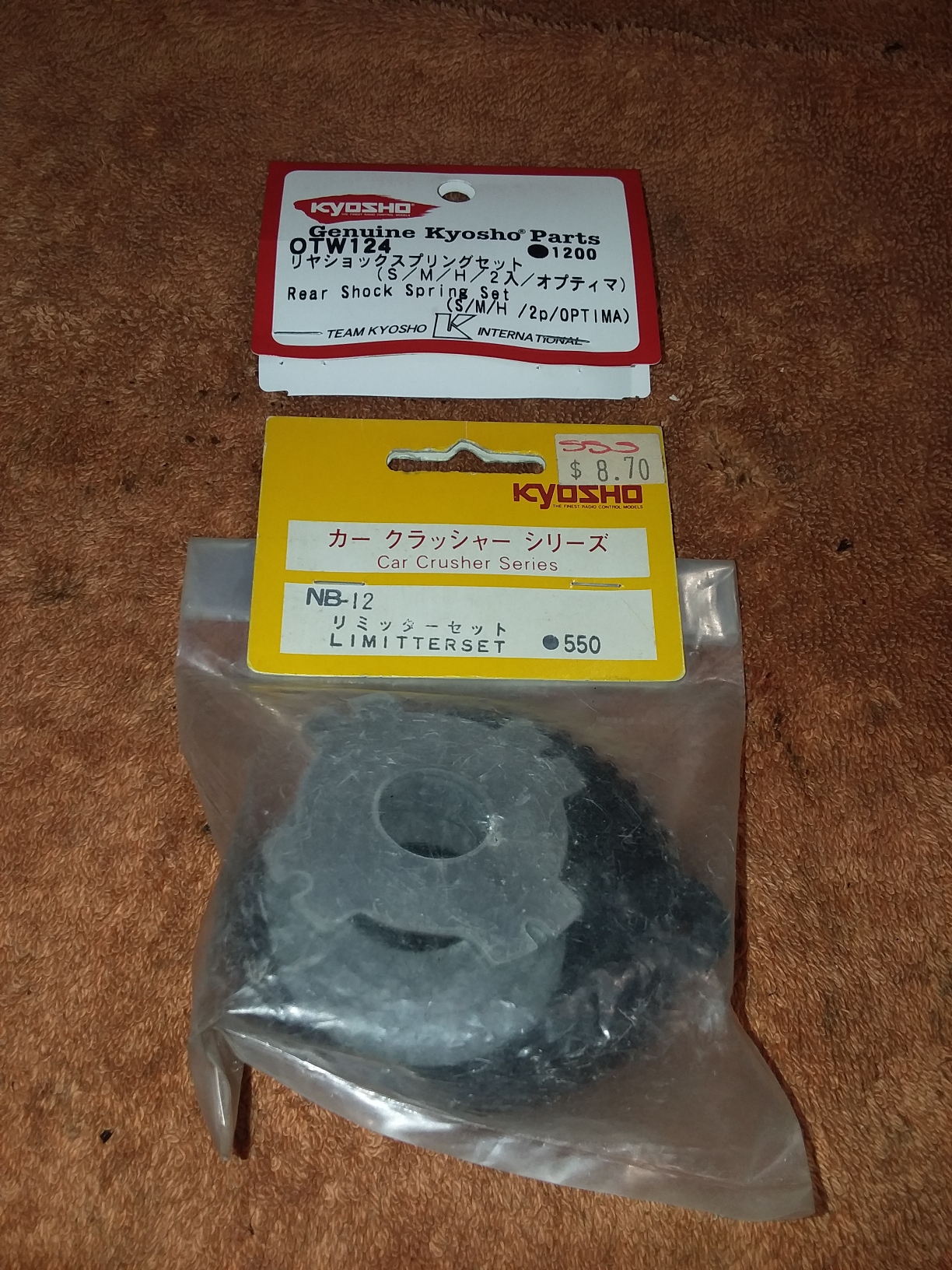

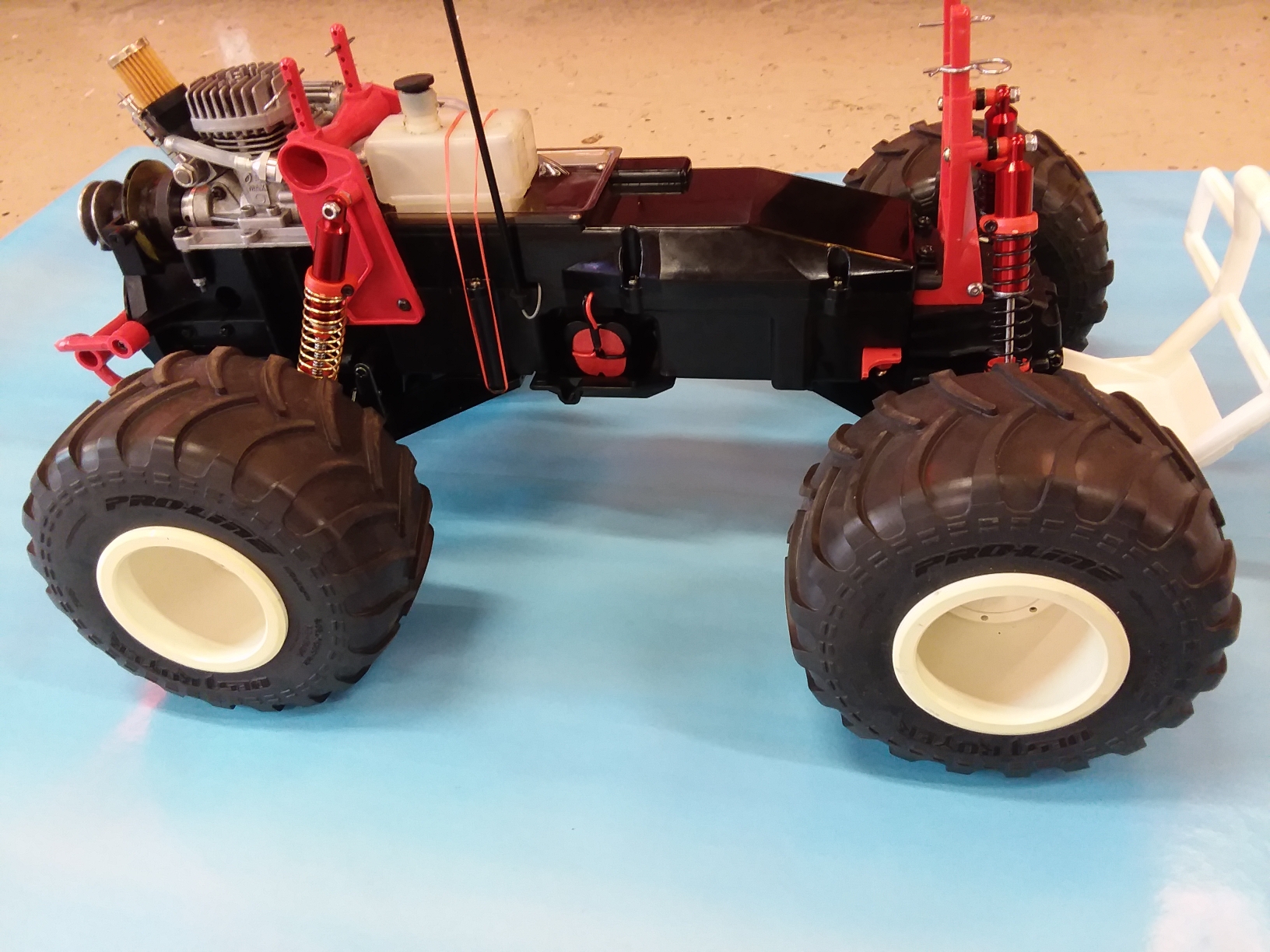

New tire right, original left
NIB slipper

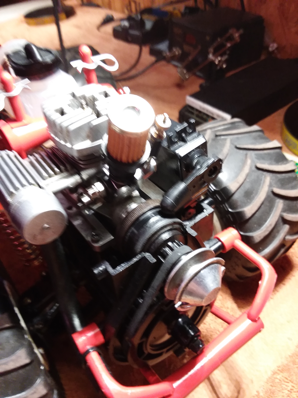

2nd try at repairing brake side of clutch bell

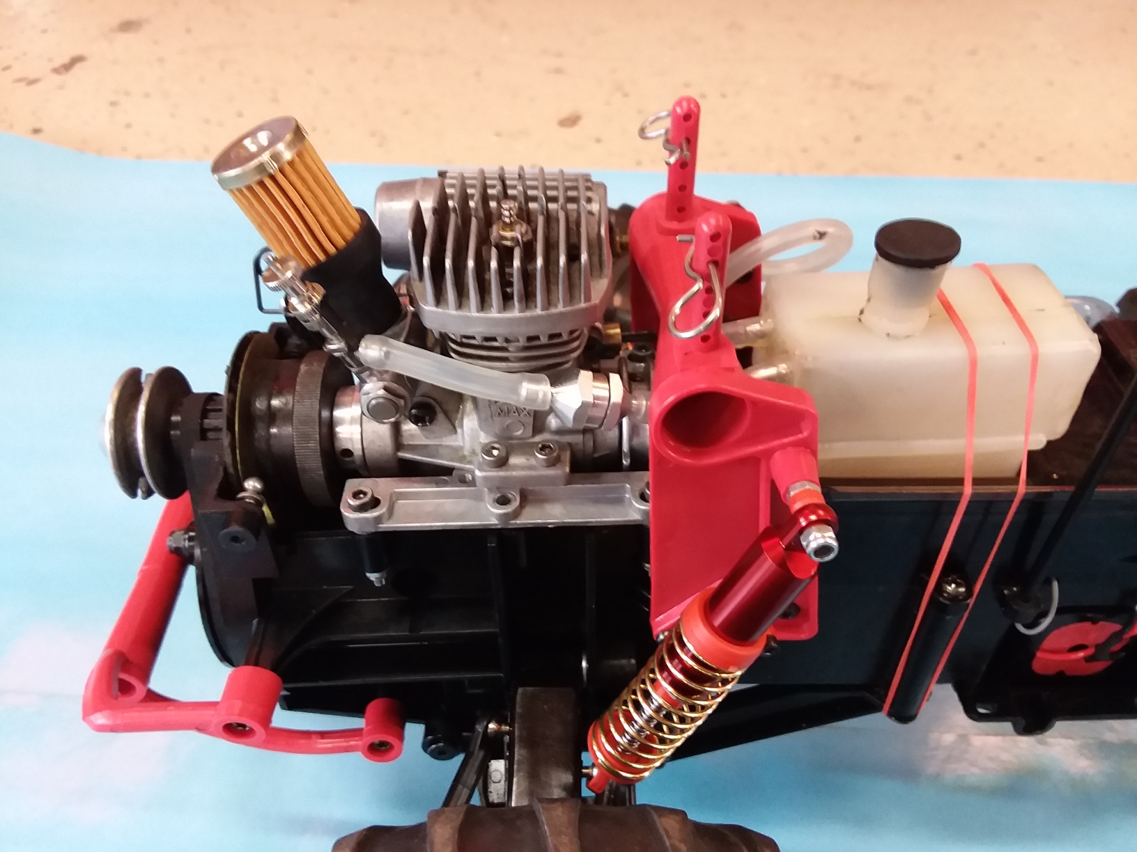

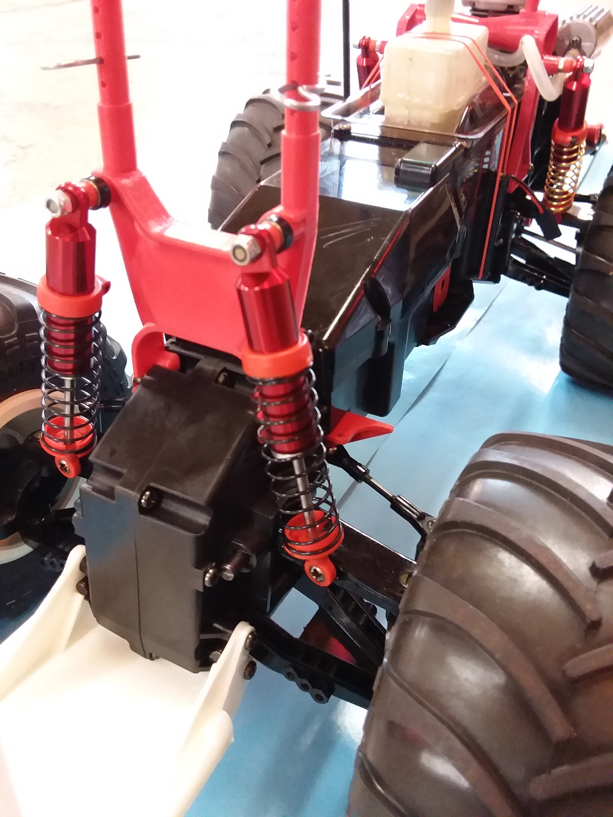

Gold springs/50wt oil rear. Black springs/40wt front

Could you glue some washers either side on the brake disk as a repair ?
coxbros1
Posts: 2495
Location: Energy, Illinois
Has thanked: 2758 times
Been thanked: 2407 times
Re: Kyosho Nitro Brute Restoration
Post by coxbros1 »
Yes,but they would have to be super thin, only a few thousands to play with before it rubs the chassis on the back side and wont turn freely

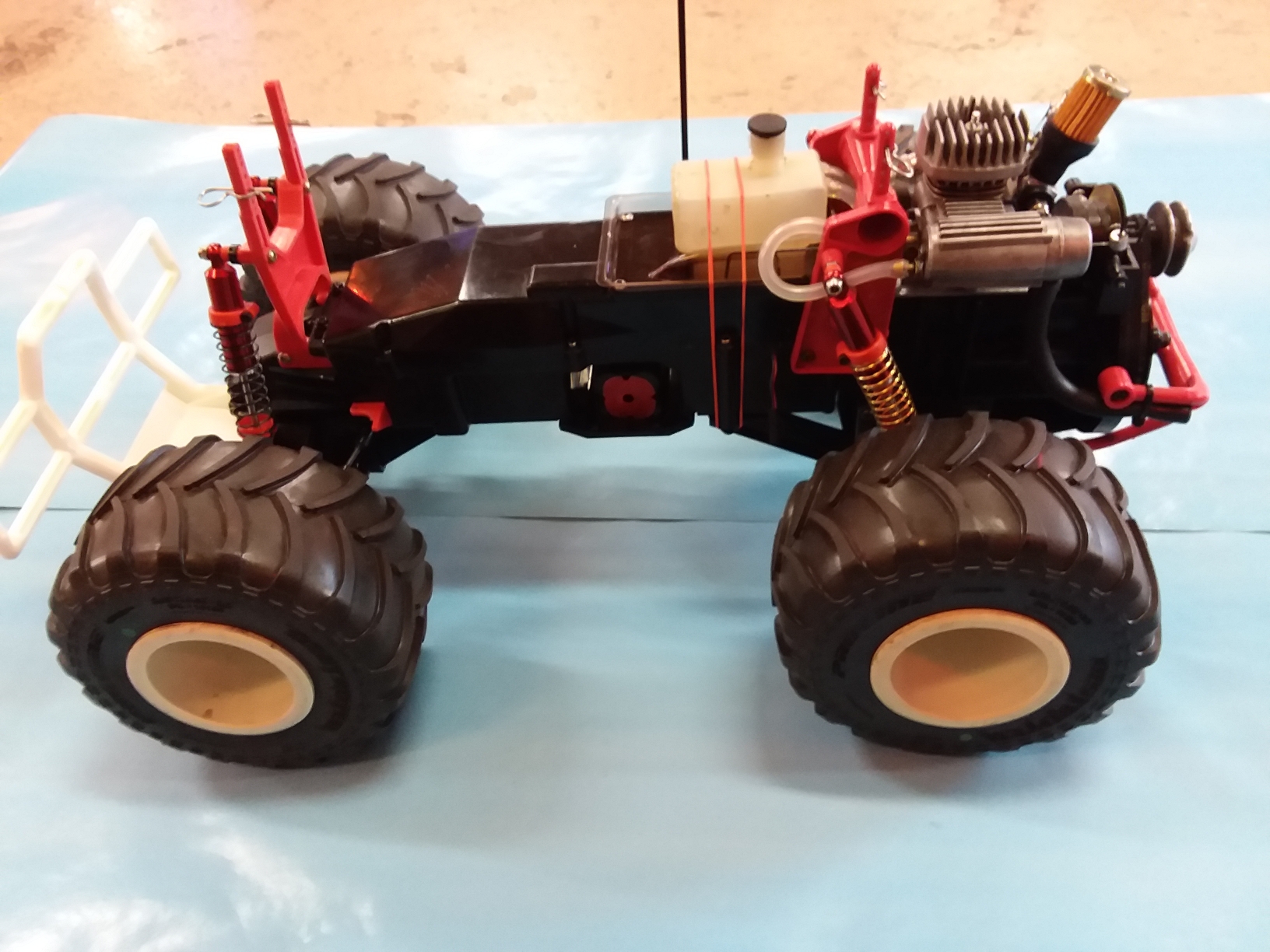

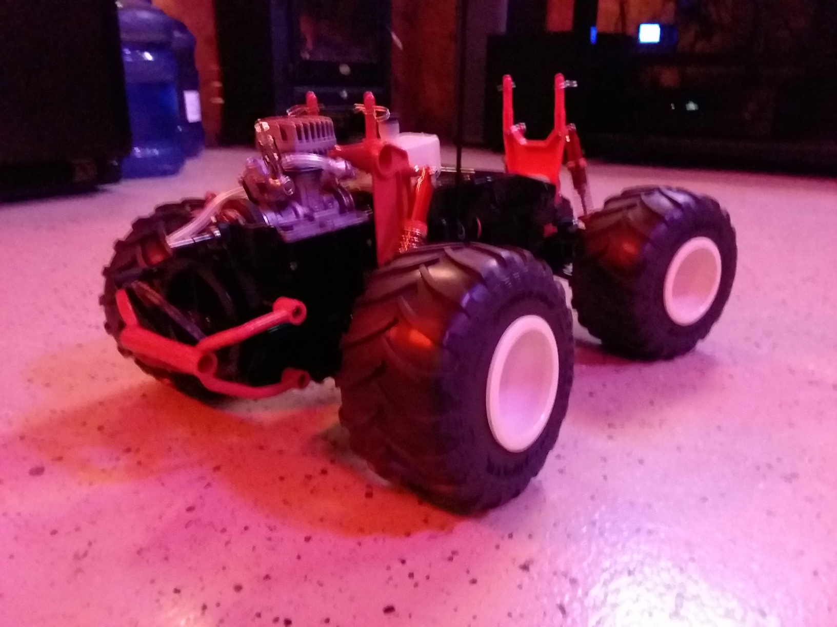

It is alive!!!!

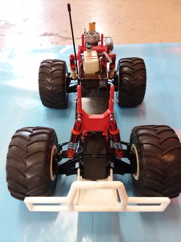

Waitn on a new body from Canada
Runs and drives real nice, actually corners on a dime

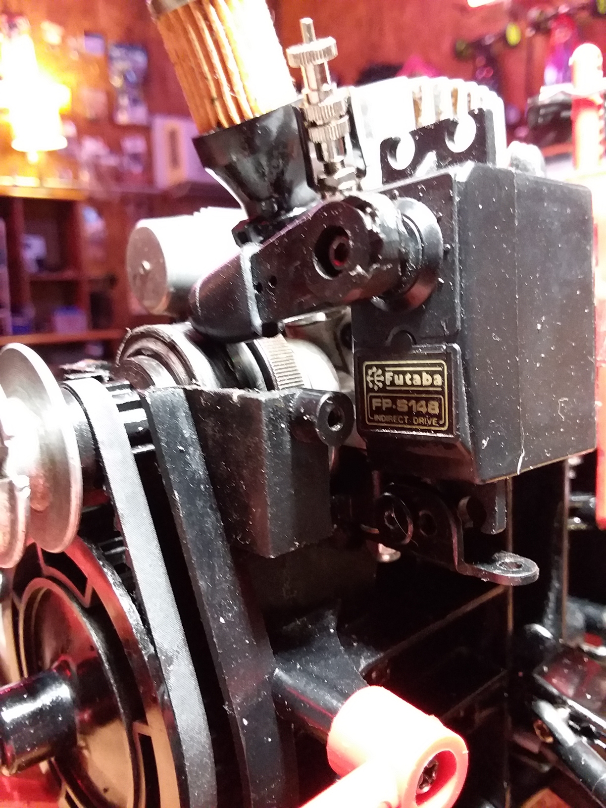

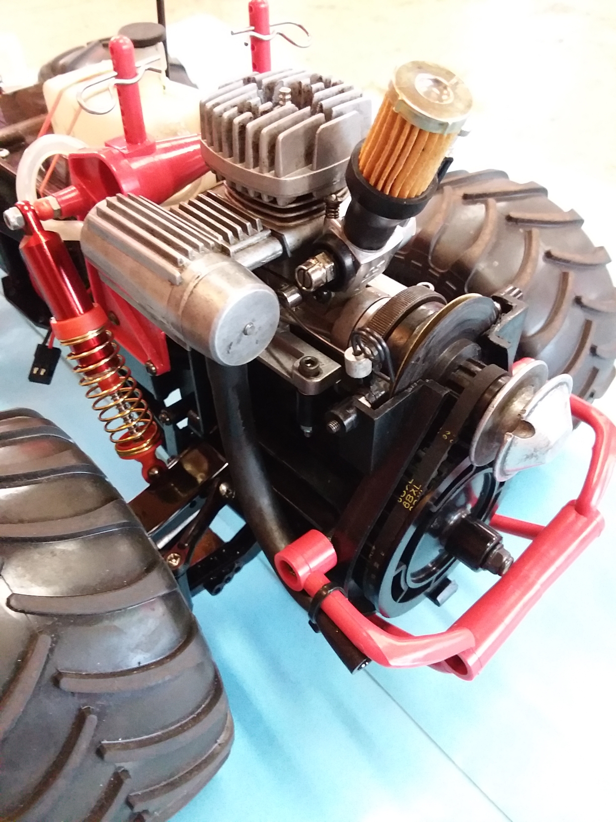

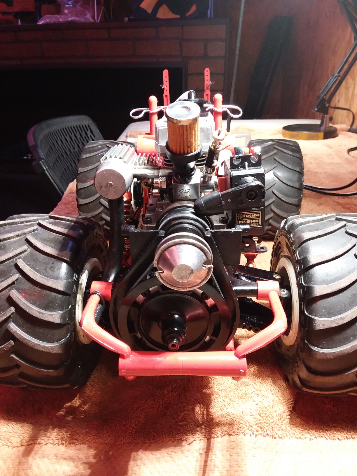

I know only a few are familiar with a Nitro Brute, and these people know what a joke the brake setup is.....well, i fixed that. Thanks to Spektrum for the ability to servo mix. Now when u apply the brakes, this arm (with a rubber boot) comes down off a 3rd servo and pushes on the clutch bell, totally adjustable to dial the brakes in perfectly. The throttle servo no longer moves in reverse either....offering a very free spinning drivetrain when the brakes are not applied.
