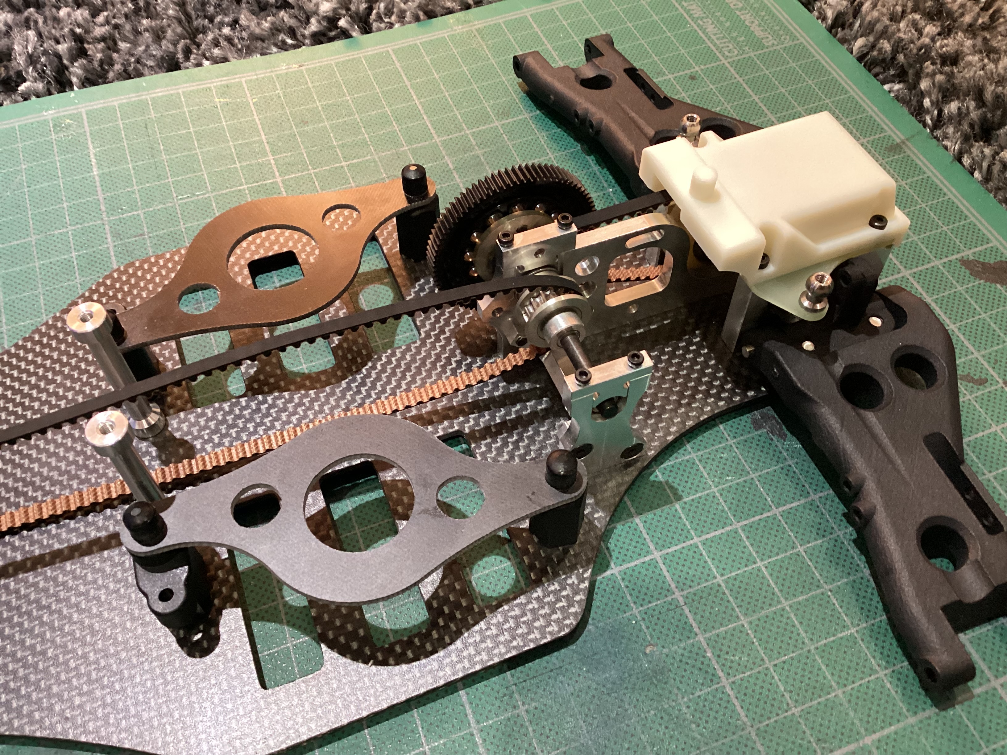

Well RUBRIX came through and sent me a package allowing me to take another step forward. The rear 3d printed diff cap/cover was getting dirty from laying around and Fan RC is making some great repo injection molded (? Is that what is is called?) replacements so it allowed me to do some minor updates to the backend.
Also received the correct kingpins and not only do they look better and closer to the original car but they actually fit correctly too lol
Finally also via RUBRIX and and Fan RC I picked up the correct black coloured battery posts, again a little better than the white 3d printed versions I started with BUT I did notice a small issue with them….no holes! Guess I’ll be doing some drilling later.

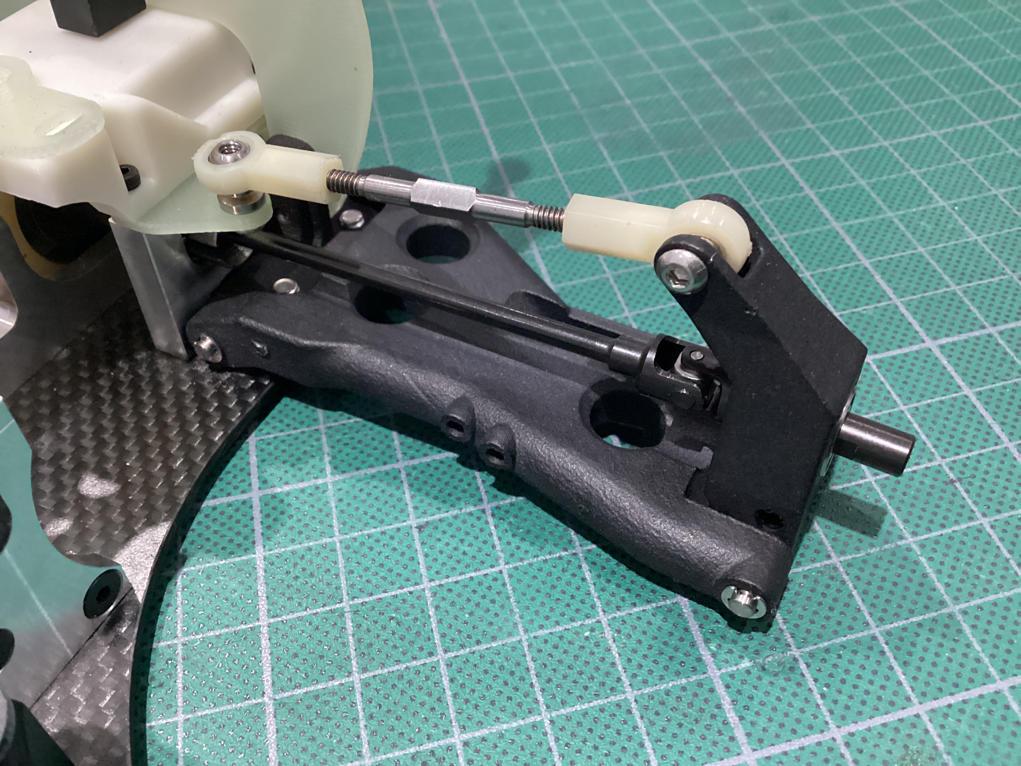

More of a night of test fitting things but made some progress nonetheless, front and rear turnbuckle setups complete, top deck partially mounted, front diff upper assembly mounted (had to drill them out a bit using a 1/8 drill bit for the upper arm assemblies that the hinge pins would slot into (these are the 3d print bits and has been a constant in terms of needing a bit of ‘massaging’)).

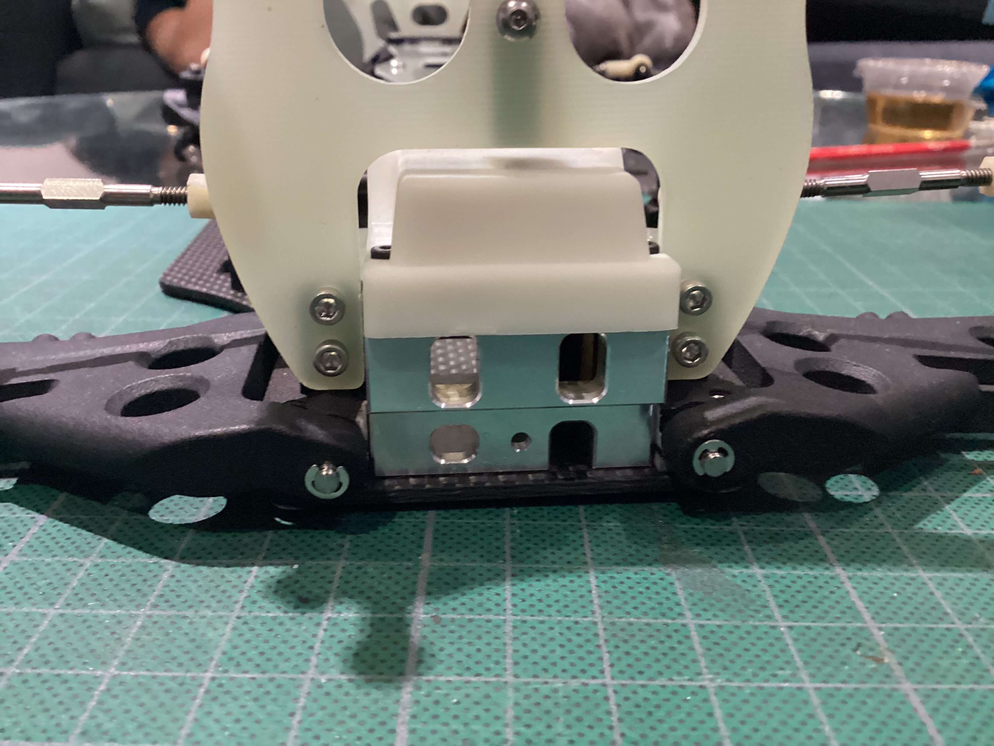

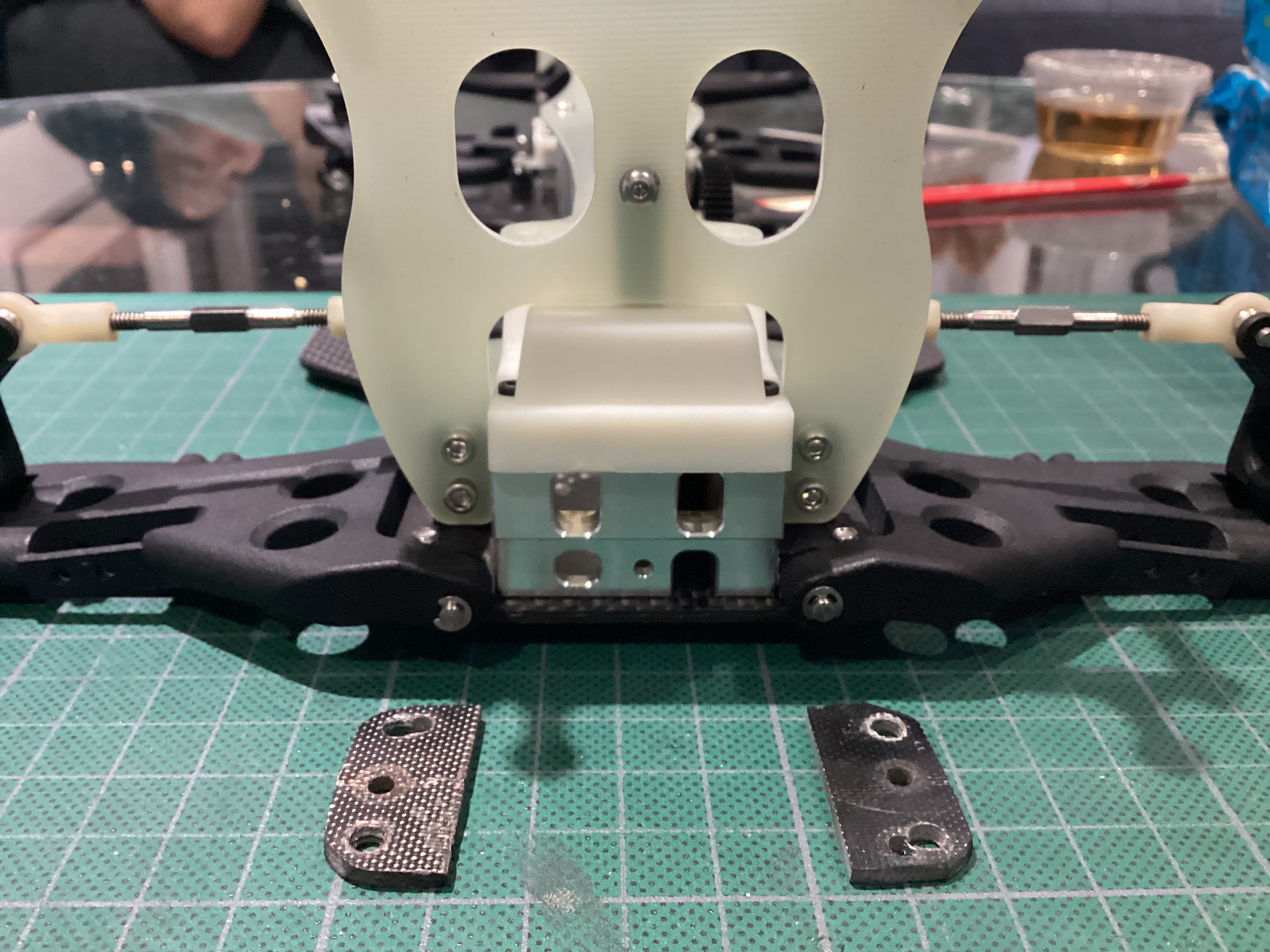

With the new rear diff housing it became apparent that I no longer needed the spacers that I built to raise the height of the rear shock tower so it would clear the rear diff cap…..hopefully that made some sort of sense, pictures explain better….

Re rear bulkhead:
I had the same issue when I put together my WCS. I had originally used a modified works aluminium bulkhead which I had chopped down - it sits about 3mm higher than the correct part which I understand was milled down by Yokomo because of that very issue. I managed to pick up the correct magnesium part from ebay a little while later for, at the time, a bargain... which solved my issue.
Where did you get that bulkhead from?

Ah yes, one of the nicest machined pieces I have ever purchased, our friends in Thailand (RC Plus /thai-town). Here is a link to it on the bay but I think they are also active on Facebook and it might be cheaper there:
https://www.ebay.ca/itm/295567383940?itmmeta=01HVZ45VX49QW7ZX2J9GJF6TCS&hash=item44d1305d84:g:x18AAOSwYrZkEWDe&itmprp=enc%3AAQAJAAAAwIA2KI9PJrSpgGuJP5IEL1%2FZZV5hnwt3hkFb9hotw57reBg1YqBHn3N%2FCDUEP3C7ii7DQVvMGqPaRpcDh6LkSXf2exRHV%2BO5ziYq9%2B9UD0DuyL80uE50YGkT9BcVtFHNZhb4swwcMZQAUrbu1QwMvuXJ8xenaLar23fstf8oQ7Ba%2Bcx7N78kmVfbTOxst%2B8uhk93qeWCipHf8waBX%2FX5dBR6Rudggg7QnB7G31JLOJuuS45sQtnWiWXa7QtSm7Azbw%3D%3D%7Ctkp%3ABk9SR9K-l-TfYw

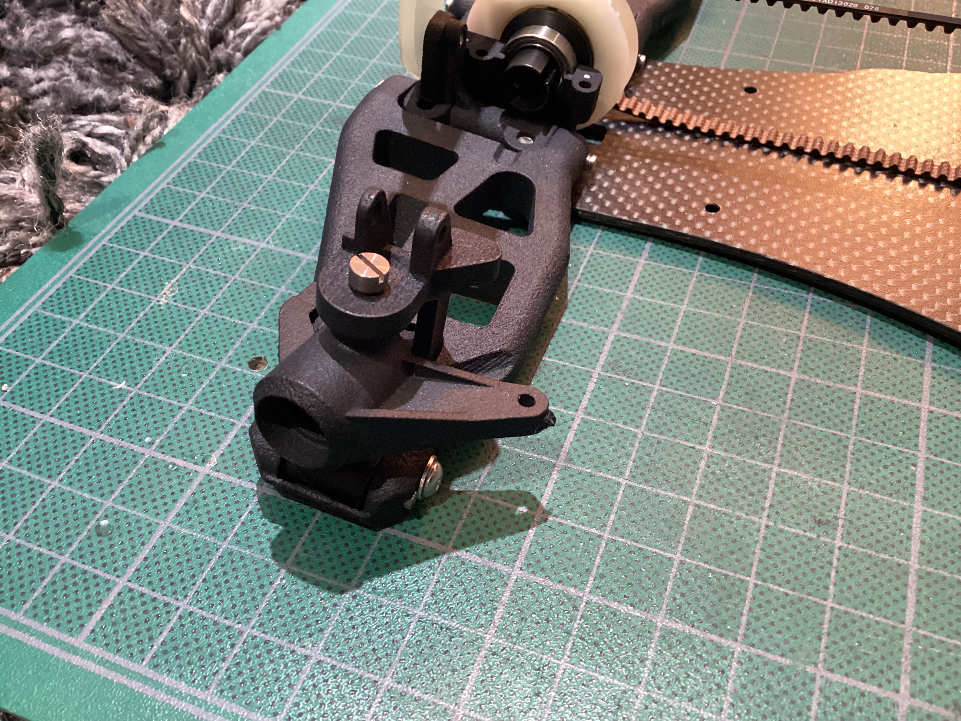

Finally got a package from JC Racing and as expected the quality of the cvd’s are excellent. Bearings are just generic ones, not like this thing will ever see the track (I have another project for that partially on the go lol)
In full transparency the front steering knuckles from VRS, the bearings fit perfectly but the rear uprights were a bit more of a tight fit, required some ‘persuasion’ using a blunt object lol
