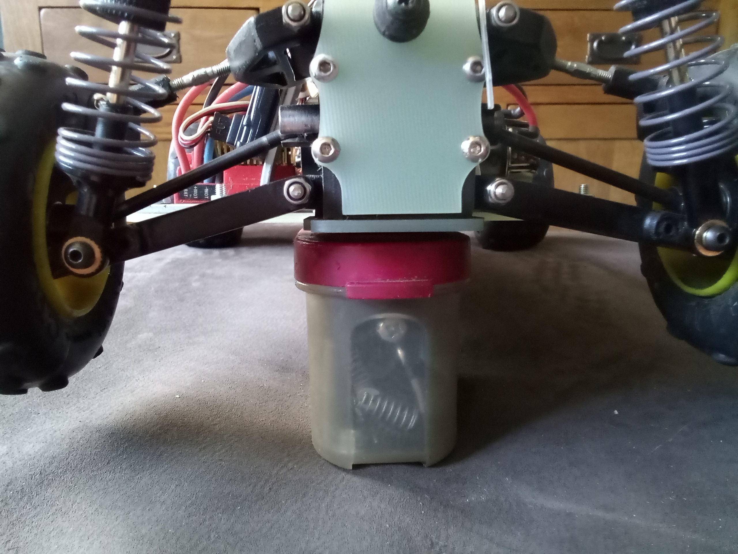

I did a little more minor refining of the rear suspension to give it 1° toe in on each side , I was going to add 1.5° but when I looked at it it seemed too much , running it today it's much more stable under acceleration and at speed , it's not too clear but might be able to see the angle in the suspension mounts .
Also added wing wire mounting points ,you can just see the hole for a locking screw in front of the diff out drive and the holes for the wire can be seen in the first picture .

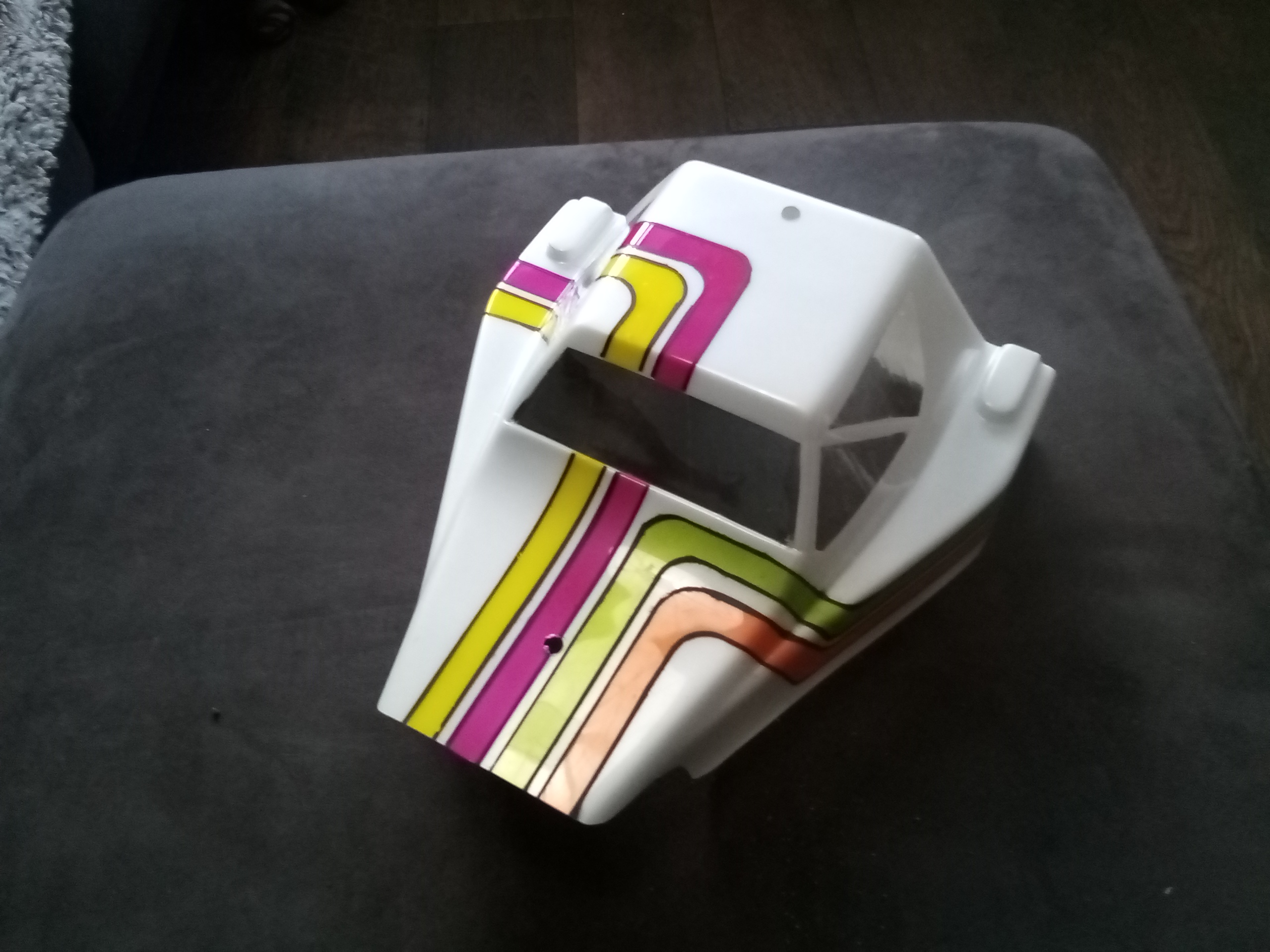

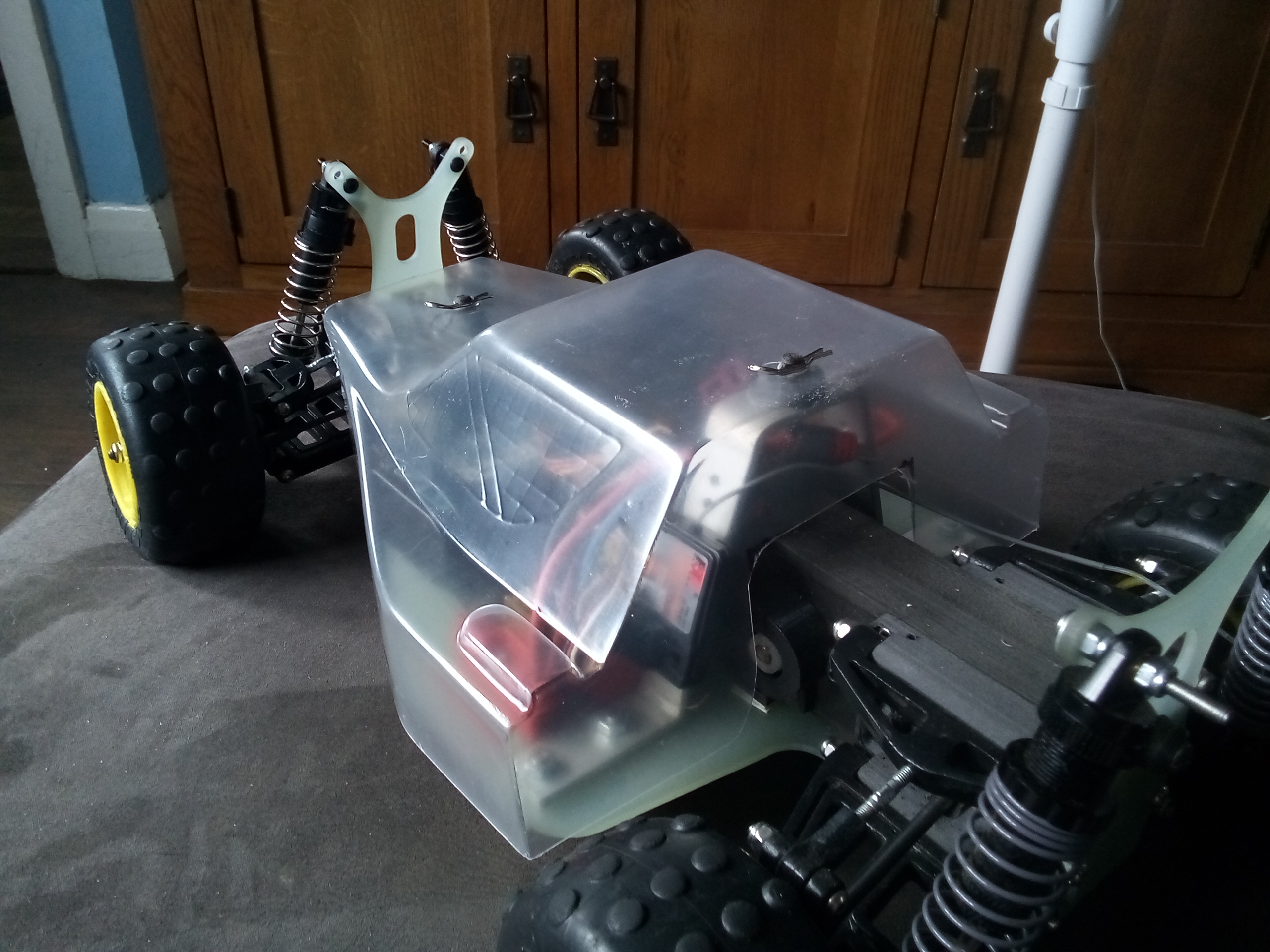

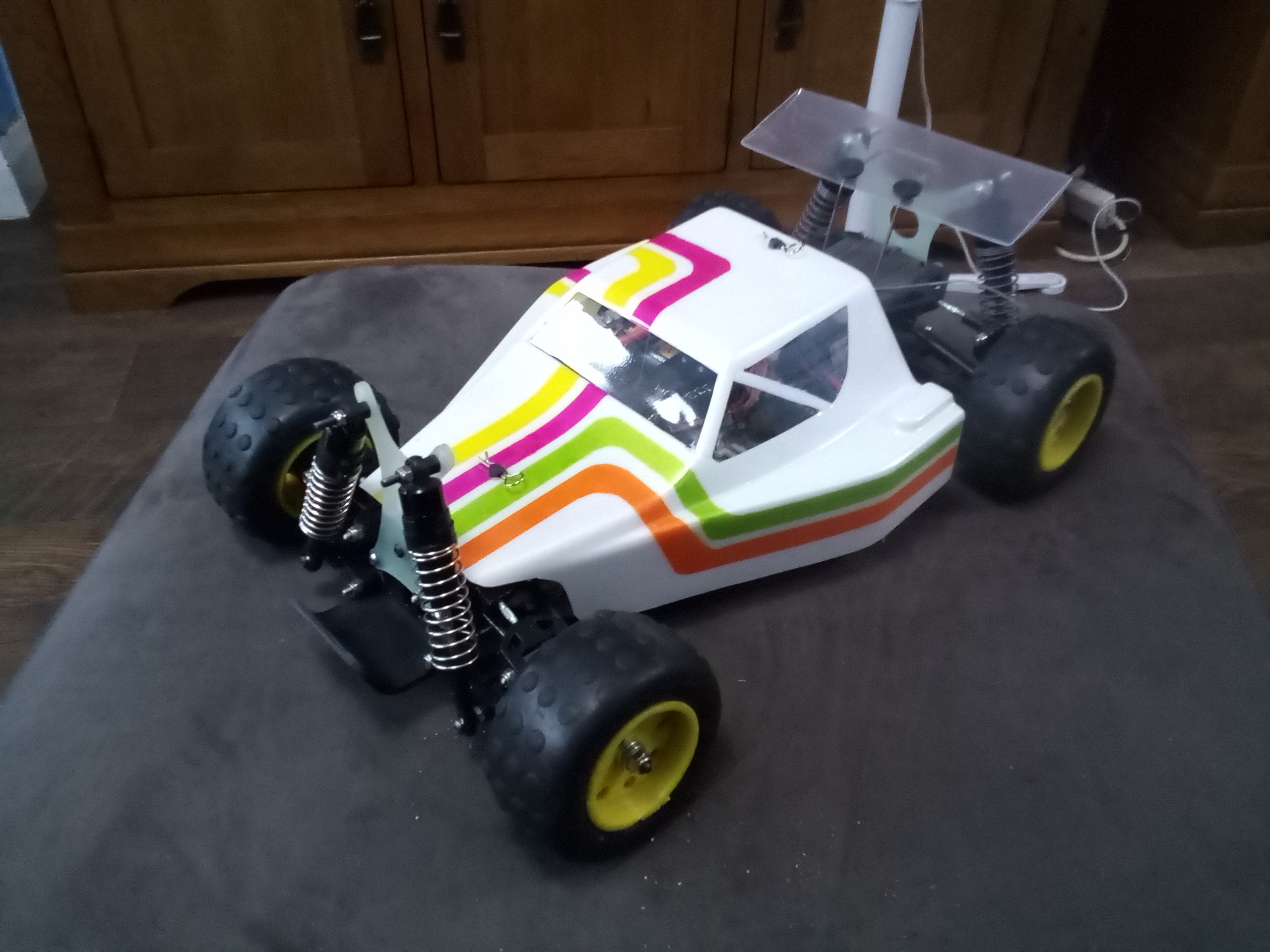

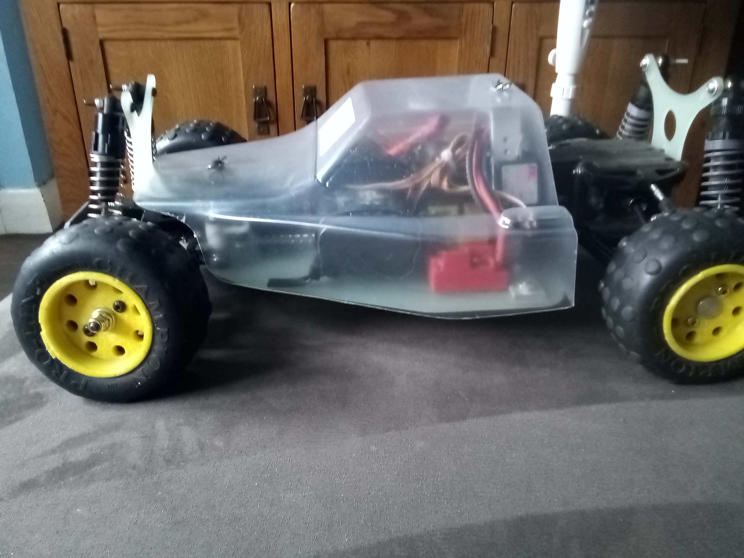

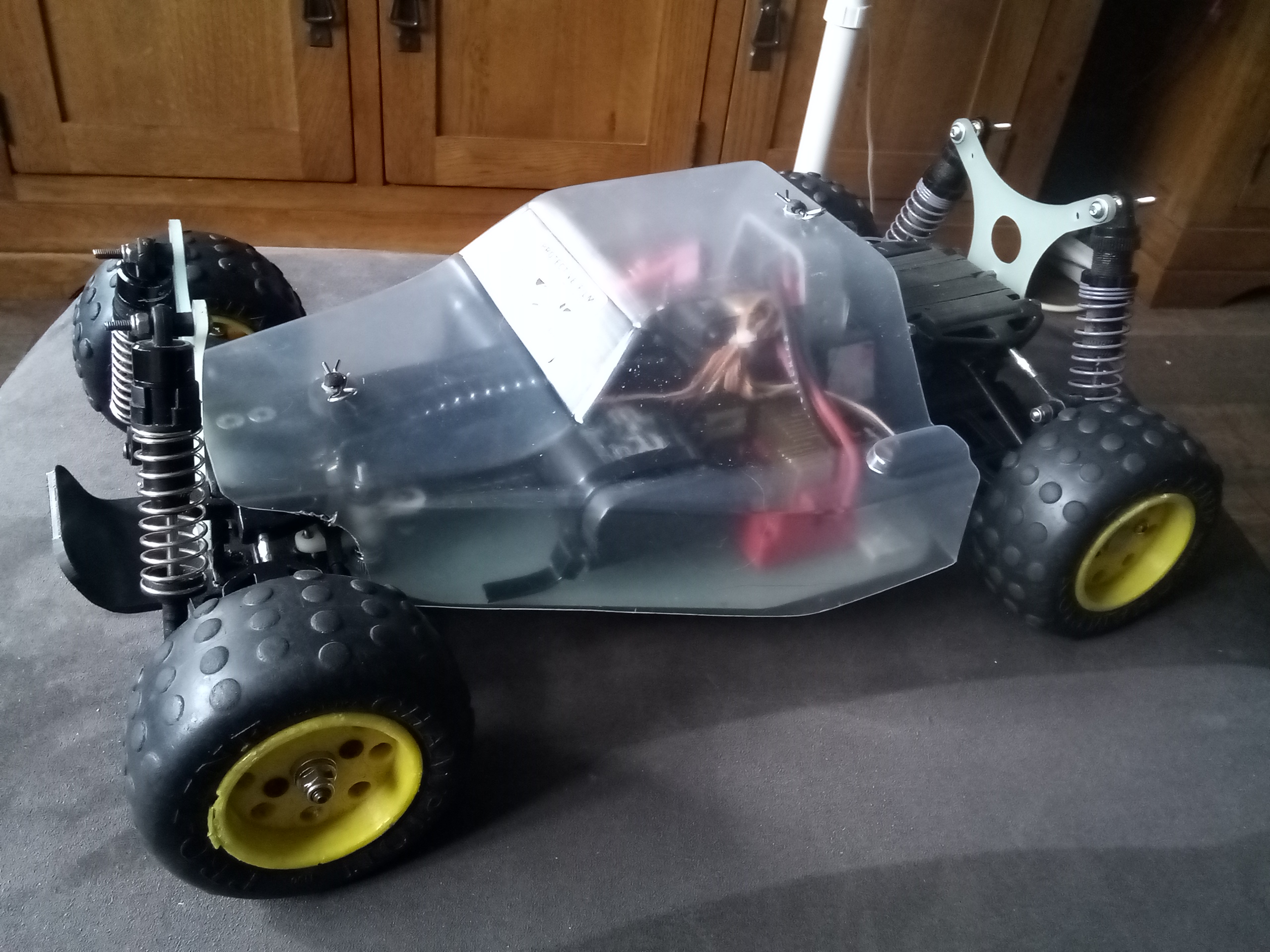

Finally got a body cut and fitted , still thinking of paint but I recon I know what I'm going to do .
Dadio
Posts: 4058
Location: Guildford UK
Has thanked: 2714 times
Been thanked: 2240 times
Re: What If ?
Post by Dadio »
This didn't go as well as I'd hoped , had a nightmare with the masking , I like the concept and think it could look good but I'll have to get another body to have another go .

Post by Dadio »

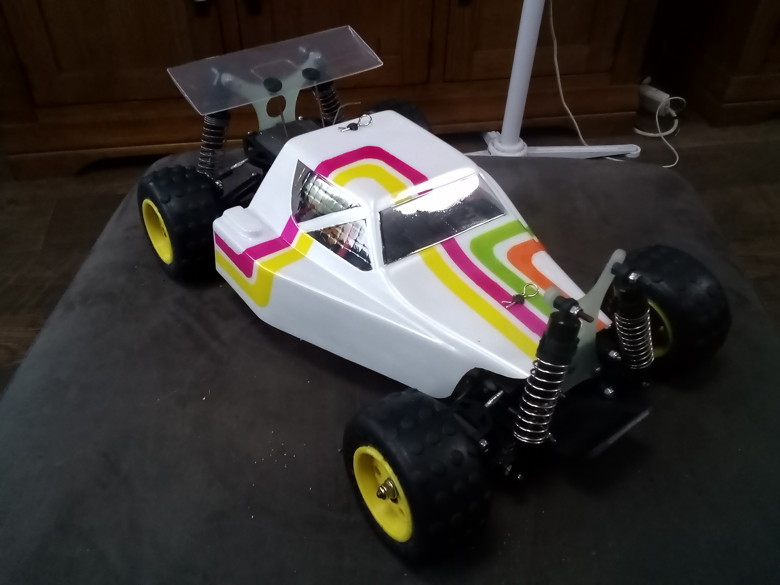

Not perfect but a save I think :? Took a tedious amount of masking .
