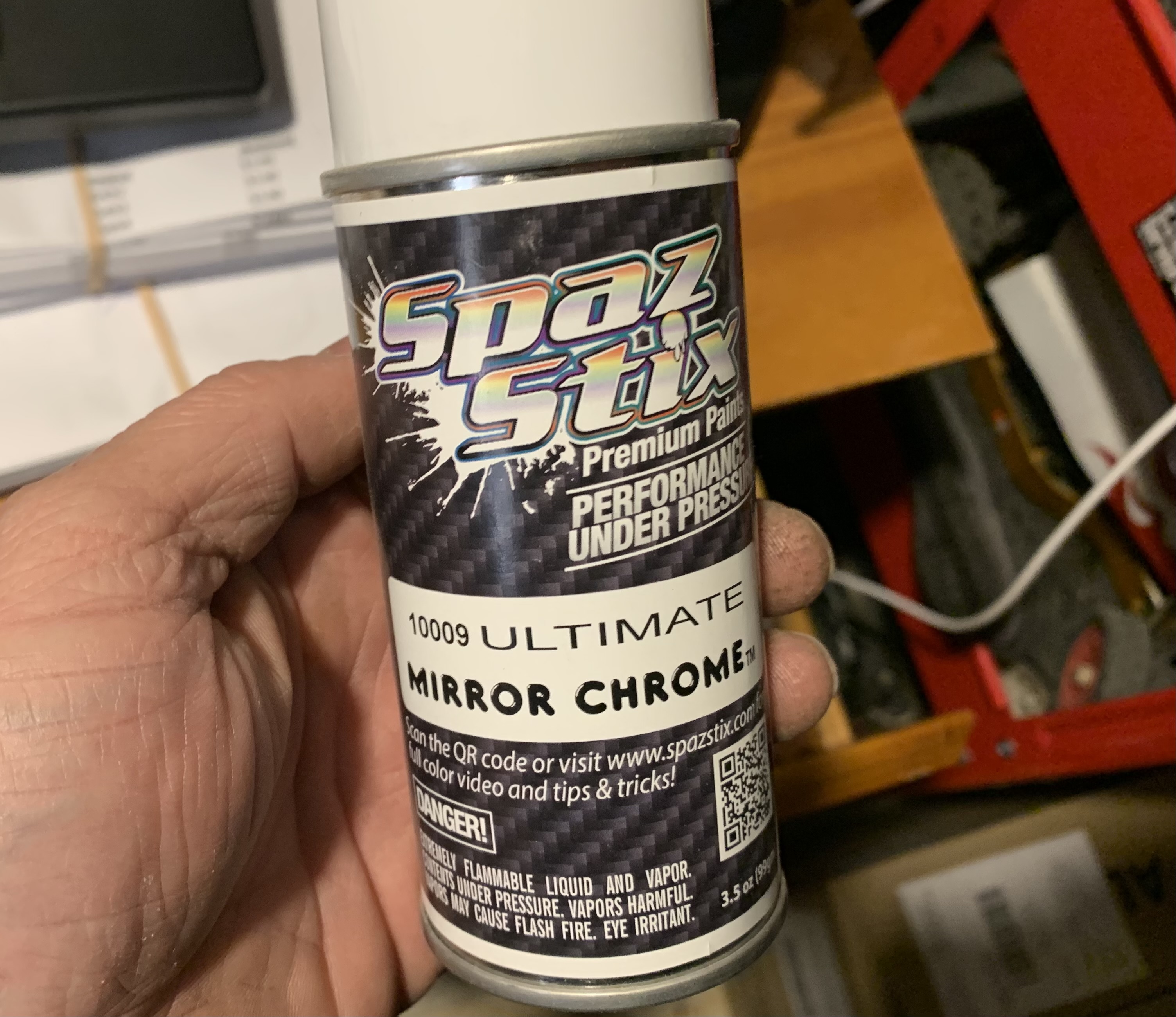

You want chrome this stuffs CHROME 8)
Hard to tell because of how dirty/dusty and unfortunately the only picture I have of one of the bodies I used it on but it’s straight up chrome on the Z/28 windows and stripes. Worked great with the candy blue as well. Came out like blue ano. It gets backed with black.
Hey Cru ! Go balls out 8)

Spaz Stix Mirror Chrome does look good! I'll have to give that a try at some point, thanks!
