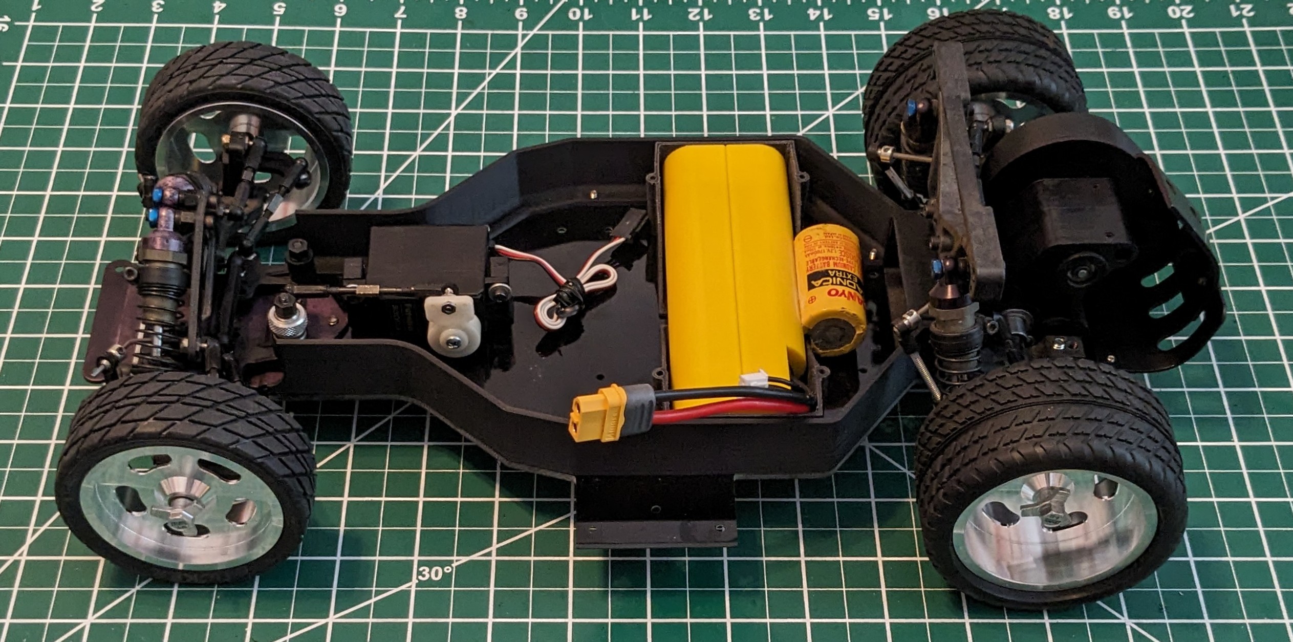

I'm really not interested is trying to make a faithful replica of anyone else's car, but the Dead Pool RC10 is a street based RC10 with my favorite Corvette body so I definitely need one as a runner (probably without real explosive charge, even though that would be so cool!). This is kind of a perfect RC for me because I love to chase cars down my street when they go past my driveway. I guess the bomb part is definitely a hard NO, even though it would be so cool....
I've been collecting parts fof a while and I think I'm going to use a DS for at least 50% of the build.
First off, starting with a Factory Works chassis plate, 3D printed 'pan' sidewalls, RC10DS nose plate, 6 gear trans with bearing outdrive bearing mod, RPM rear motor guard, custom D Hawk 5 slot wheels, D Hawk knock off style wheel nuts, Schumacher rear street tires and Custom Works front street tires (I wanted to try them out).

Just noticed you’ve incorporated your side body mounting into the chassis plate, smooth 8)
Hey Cru ! Go balls out 8)

Some slow progress. The DS suspension I want to use are from a car that sat in high humidity way too long. The hinge pins are all seized in place. Hopefully a CLR treatment will free things up so I can give them a good cleaning.
Working on a dummy battery using a material that I infrequently use. Another iteration is needed with a few tweaks but it will work fine after that.
I'm all set for motor. Plenty of nice replacement armatures if I get really stupid.

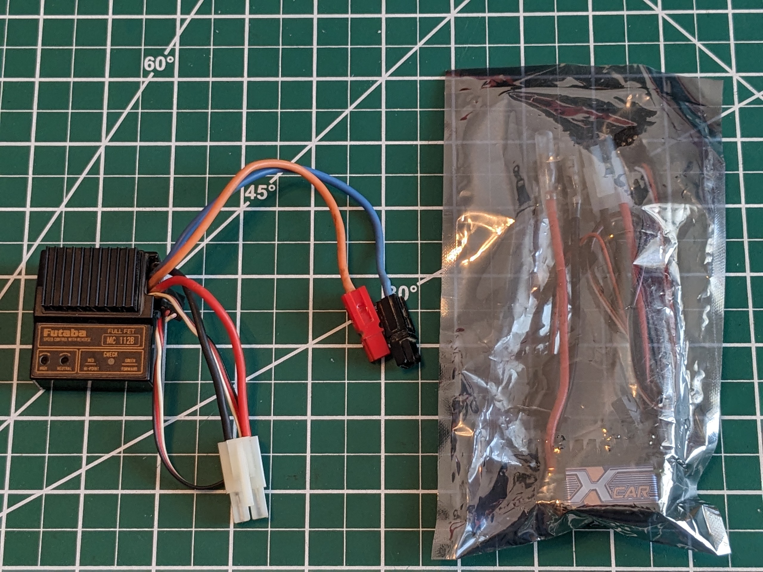

Another baby step. I thought about using a Futaba fwd/rev ESC like the movie car. I had one left that came with another project car. I plugged in a battery to try it out and it immediately started smoking. The battery connectors did immediately fuse together so bursting into flames was able to be avoided. 🔥🔥🔥🎇🧯🚒
This is the second Futaba ESC that I've had this happen. I think I'm done with them. Since it didn't get to total meltdown, I was about to repurpose the case around a Hobbyking ESC.

Frankentruck wrote: Thu May 09, 2024 5:02 pm Another baby step. I thought about using a Futaba fwd/rev ESC like the movie car. I had one left that came with another project car. I plugged in a battery to try it out and it immediately started smoking. The battery connectors did immediately fuse together so bursting into flames was able to be avoided. 🔥🔥🔥🎇🧯🚒
That's not good. Just received my Futaba MC 112B today, only to hear they are troublesome or faulty.
Do you know how they are having this issue? Were you using a NiMh battery?

I was using 6 cell NiMh to test. I fried in the middle of testing (last year) and this one immediately when battery plugged was plugged in.

I've got 7 or 8 Futaba esc's. The only problem that I've had was a bad potentiometer on one.

Frankentruck wrote: Thu May 09, 2024 7:53 pm I was using 6 cell NiMh to test. I fried in the middle of testing (last year) and this one immediately when battery plugged was plugged in.
6-cell NiMh is also what I was planning on using to test it. Now I'm wondering if I should do this out in the street, instead of indoors.

juicedcoupe wrote: Thu May 09, 2024 8:51 pm I've got 7 or 8 Futaba esc's. The only problem that I've had was a bad potentiometer on one.
I'm probably just a magnet for the bad ones.

So that Futaba ESC that went up in smoke was 100% my fault. Reverse polarity is a bad thing. Oops. That's ok though, I really don't like the single speed reverse and wanted Lipo protection.
The DS chassis setup is working pretty well...
... until I see that it gives me too long of a wheelbase for this body. That will take a little more thought.

Frankentruck wrote: Sun May 19, 2024 5:14 pm So that Futaba ESC that went up in smoke was 100% my fault. Reverse polarity is a bad thing. Oops. That's ok though, I really don't like the single speed reverse and wanted Lipo protection.
You should be able to move the rear arm mounts forward to shorten the wheelbase. Looks like you're in long wheelbase setup right now.

RogueIV wrote: Sun May 19, 2024 5:48 pm You should be able to move the rear arm mounts forward to shorten the wheelbase. Looks like you're in long wheelbase setup right now.
I hadn't even noticed that was where I had the rear arm mounts. Thanks for spotting it. 👍
I'm also noticing the front is a bit narrow. A set of GT long front axles is helping that situation.
