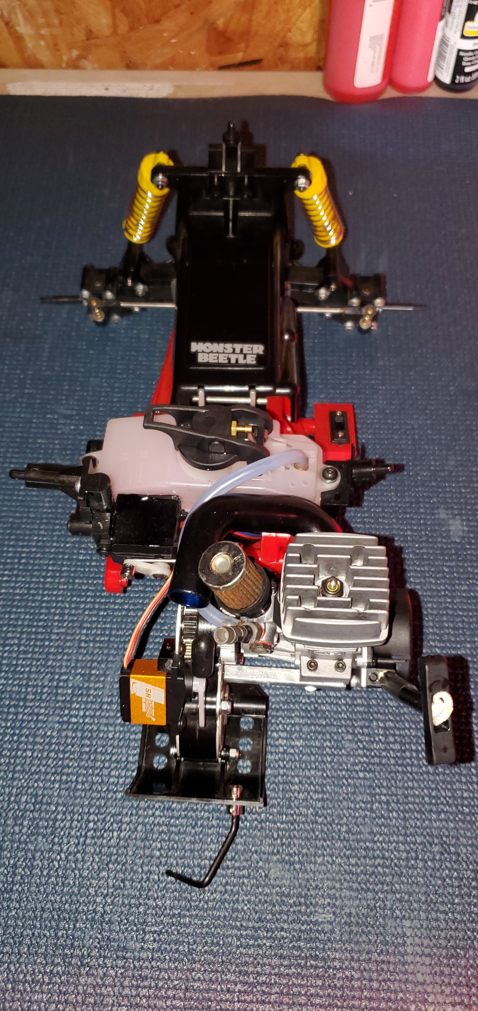

....and it starts
I didn't want to spend any money on this one...but I am going for a certain look (that I can run hard)...that look is all factory, no flash, just the way Tamiya would have released it...the current engine with black case and blue head runs amazing..but it doesn't look right...so I dropped some coin on an authentic unit, a .18 K&B

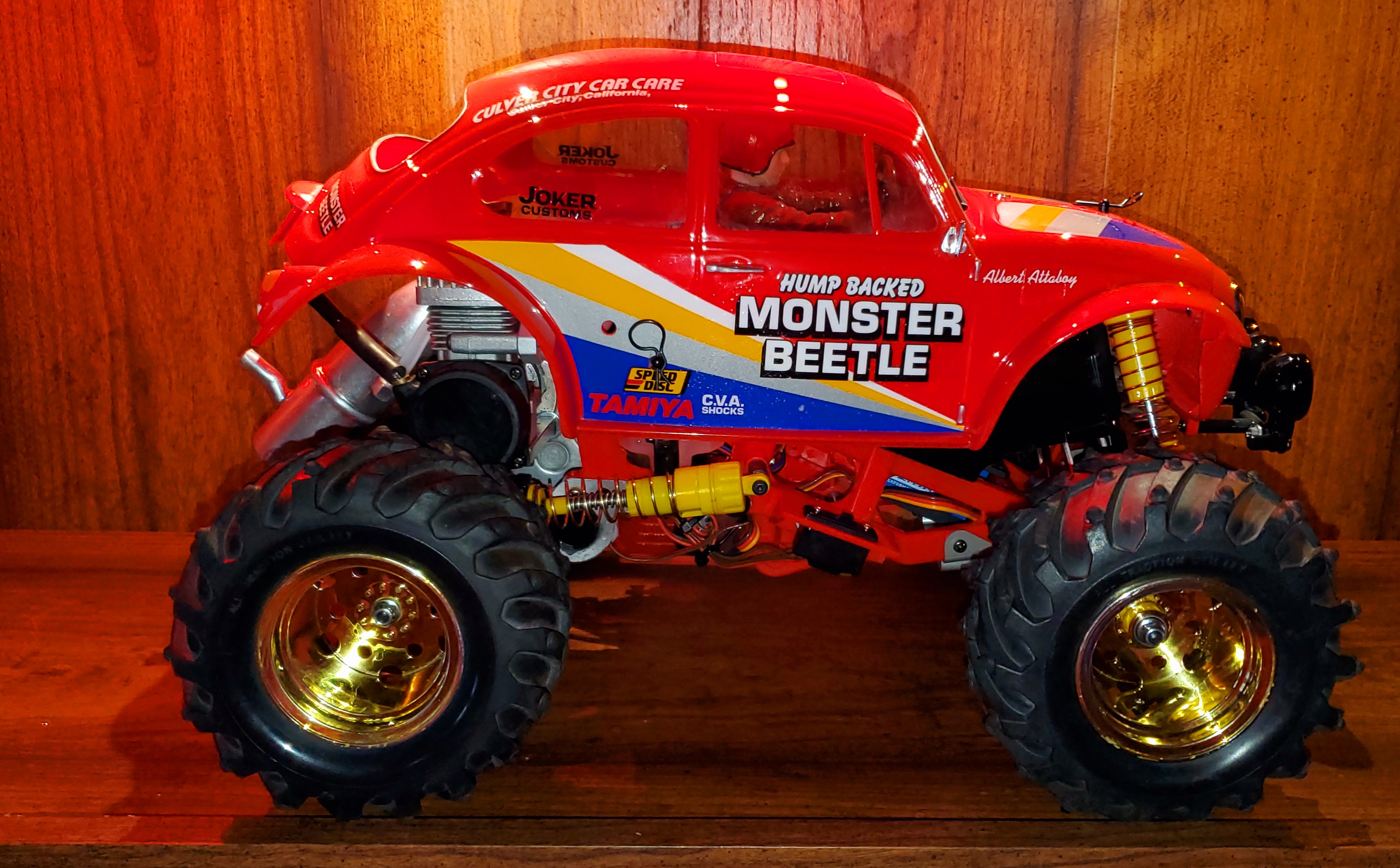

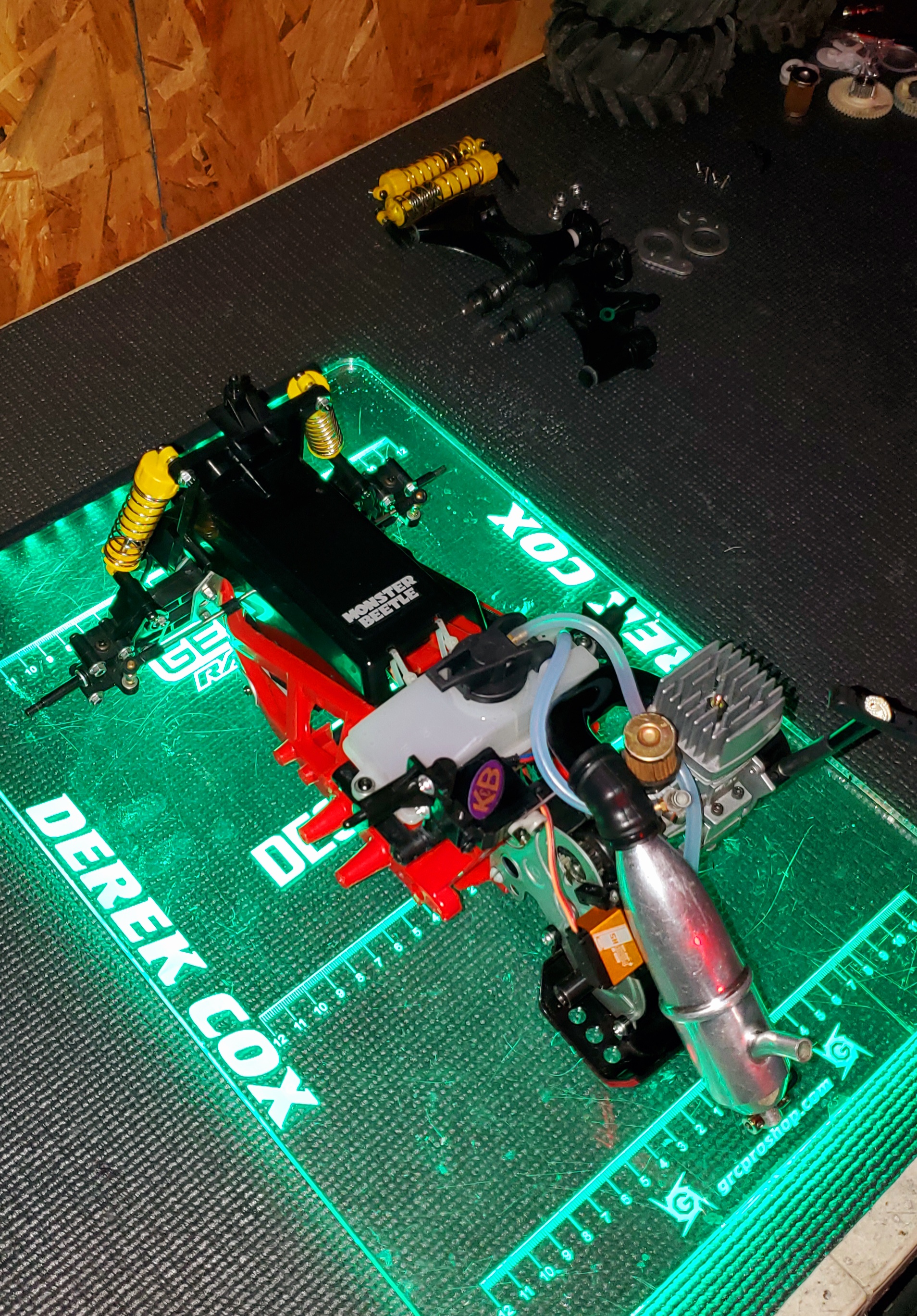

Got a few things done:
-bulletproof tranny (steel counter gear/MIP diff)
-new Savox brake servo
-new K&B .18 (haven't fired it)
-painted header black
Now it's starting to look like a proper vintage piece

Stick a 🍴 in it!...this one's done and "Fest" ready
Runs perfect 41mph so far but it was really windy, I couldn't hang the guts out of it...10% nitro...always starts on the 1st pull
