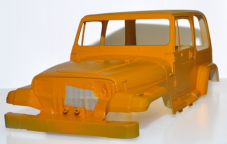

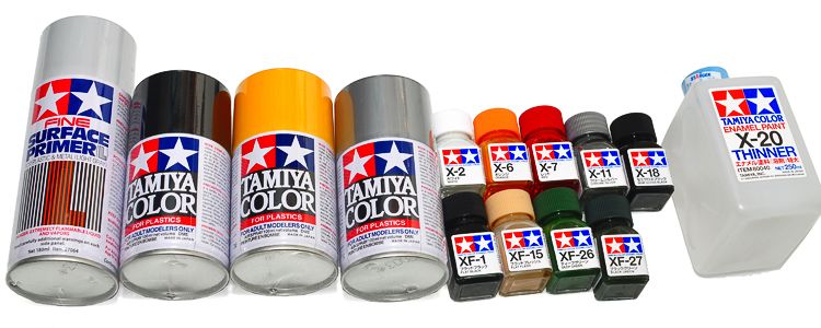

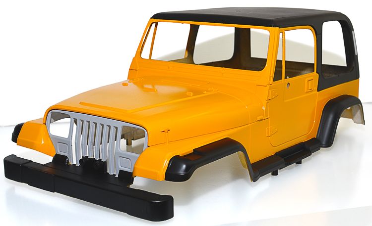

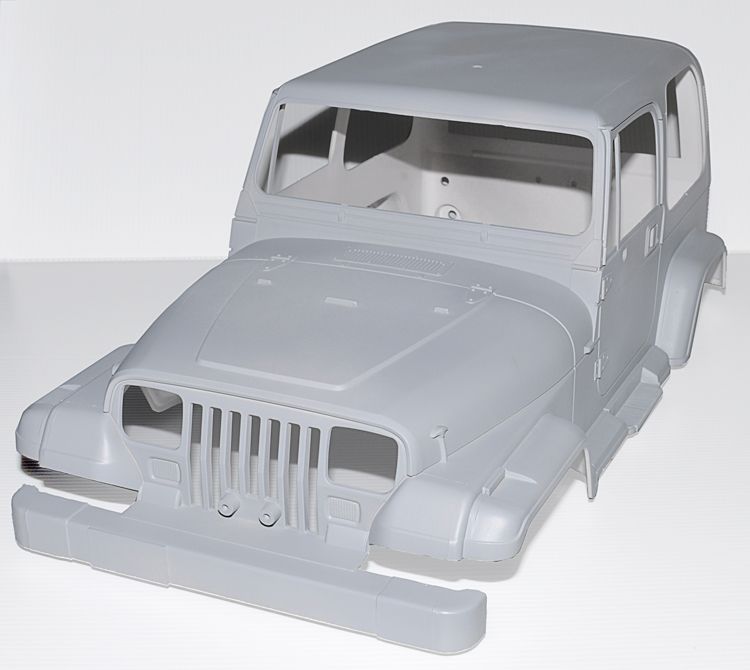

Started to paint the body!
Read a few articles on how to paint hard body shell which some I did not follow :lol:
1. wash with soap and warm water (done)
NOTE: "warm the cans of spray up so that they spray better. Use mug filled
with hot water and I soak the can until it’s warm to the touch. It goes with out saying;
make sure you shake the can up so that the contents will be thoroughly mixed before
spraying (writter Shodog)".
2. apply primer (done)
3. lightly sand the body and apply primer again (2 to 3 times) :roll: (i applied 3 times without sanding, too lazy and no time to do that :lol: )
4. apply masking tape, then paint with dark color first (or the other way around, I forgot, painting is not my cup of tea :) ), sand and wash the body shell then apply paint again (sigh! thats too much time and I do not have that, I stop reading and paint the body the fastest way I can :twisted: )
The paint Im intended to use.
Primer paint applied 3x
Camel Yellow applied
Matt Black applied
Done without sanding the body (hope I will not regret it =)
Next silver color for the grill (next week)

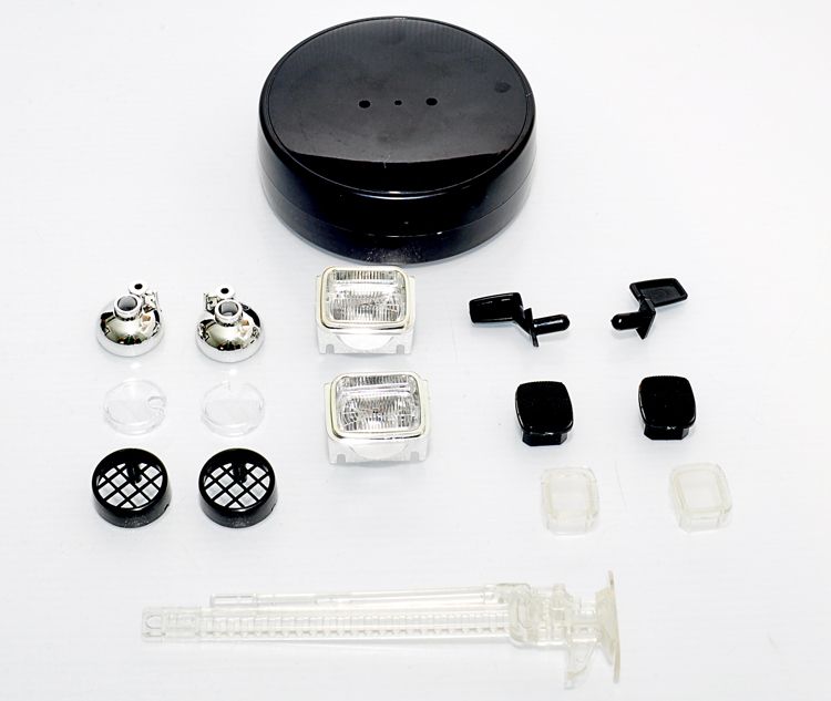

@ dldiaz : thanks for the info :D

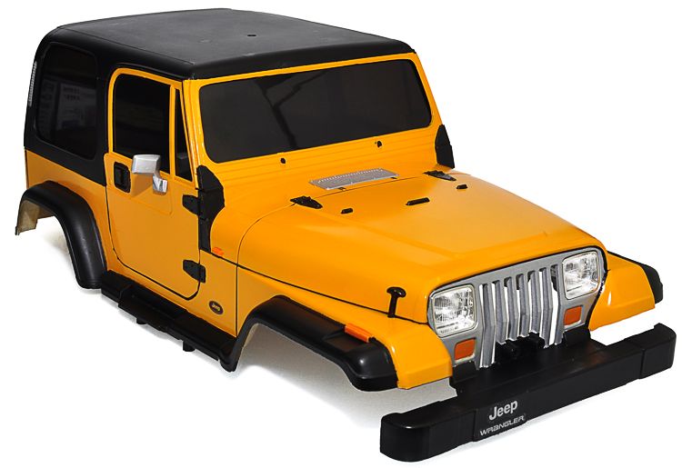

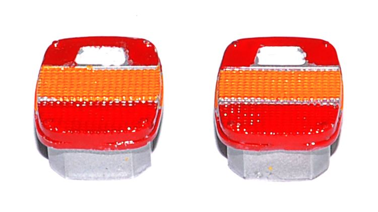

Some photos update of the CC01 build.
Head/back light, jack , side mirror, spare tire case and etc.
I've painted silver for the side mirror, red in jack, while back light in silver, white, red and orange.
ireg
Posts: 510
Joined: Fri Dec 24, 2010 10:59 pm
Location: Singapore/Philippines/LV Nevada

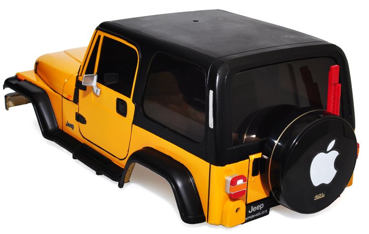

Re: CC-01 Jeep Wrangler - Build
Post by ireg »
The font side view showing the head lights installed.
The back side view showing the back light, spare tire case and jack
I've placed the Iphone sticker on the tire case (sticker from the Nano Watch) :D
