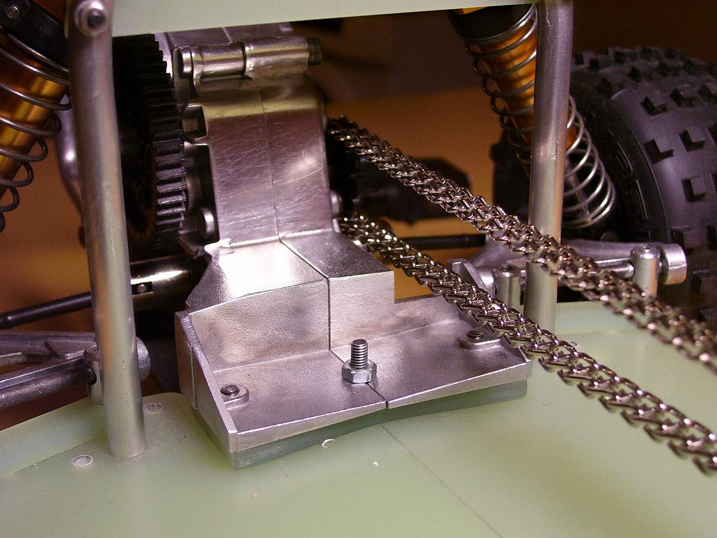

Finally sorted the chain out. Made a cutout in the gearbox for the chain to pass through. I'll be running a shorter lipo in parallel with the chain, so no worries about the chain having to move over the battery.

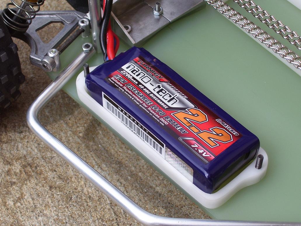

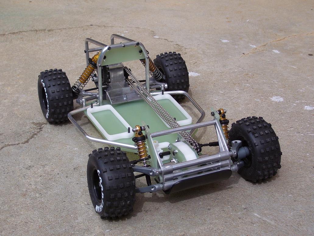

Made battery cradles from the same Acetal/Delrin as the front gearbox. I'll be running two Turnigy 2200mah 2s lipos in parallel in a saddle pack configuration. I still have to make two G10 battery straps to retain them. Also made two single rail nerf bars to add protection for the lipos.
Overall view.
Slowly getting there. :D

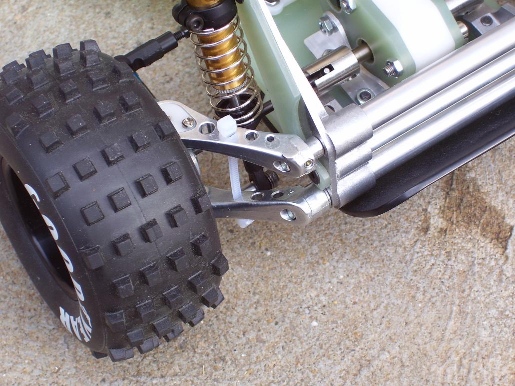

Here's another mod from the early days of racing if you didn't have RCH or Thorp ball cups.
The zip tie passes through both arms and helps stop the bottom ball stud separating from its ball cup as it wears out or after hard landings.

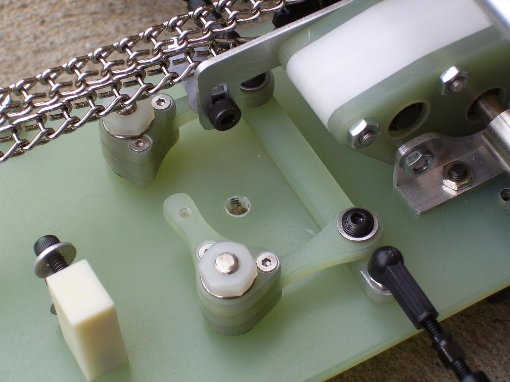

Finished making a new steering setup today. I wasn't 100% happy with the RC10 steering. I noticed while pushing the buggy in circles on the kitchen floor that the ackerman wasn't quite right. I could feel a lot of rolling resistance as the inner wheel was at full lock and the outer wheel moved only a few degrees. The RC10 steering needs to be a lot further forwards to make proper use of it's design. Which is impossible as there's a gearbox in front of it. What to do? I had a look at A&L's steering and whipped out the G10.
The bellcranks are slightly longer than the previous setup. Which moves the steering ballstuds 3.5mm further forwards giving a much better degree of ackerman during turns.
The chain still clears the new steering.
The end result: WOO HOO! :D

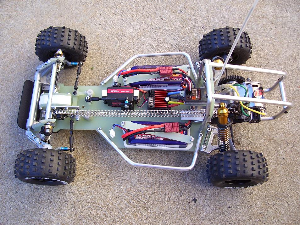

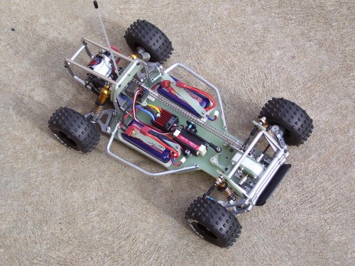

I've trial fitted the electrics.
  • Power HD low profile servo
  • Hobbywing Quicrun ESC
  • Turnigy 2S lipos in parallel
  • Spektrum receiver
  • Tamiya GT tuned 25T motor
I've added a lower chain guard which bolts to the rear gearbox and protects the left hand battery wires from being sawn in half.
The receiver sits above the motor and battery wires on its own shelf.
Not much more to go now. I can't wait to run this.
Chris.
