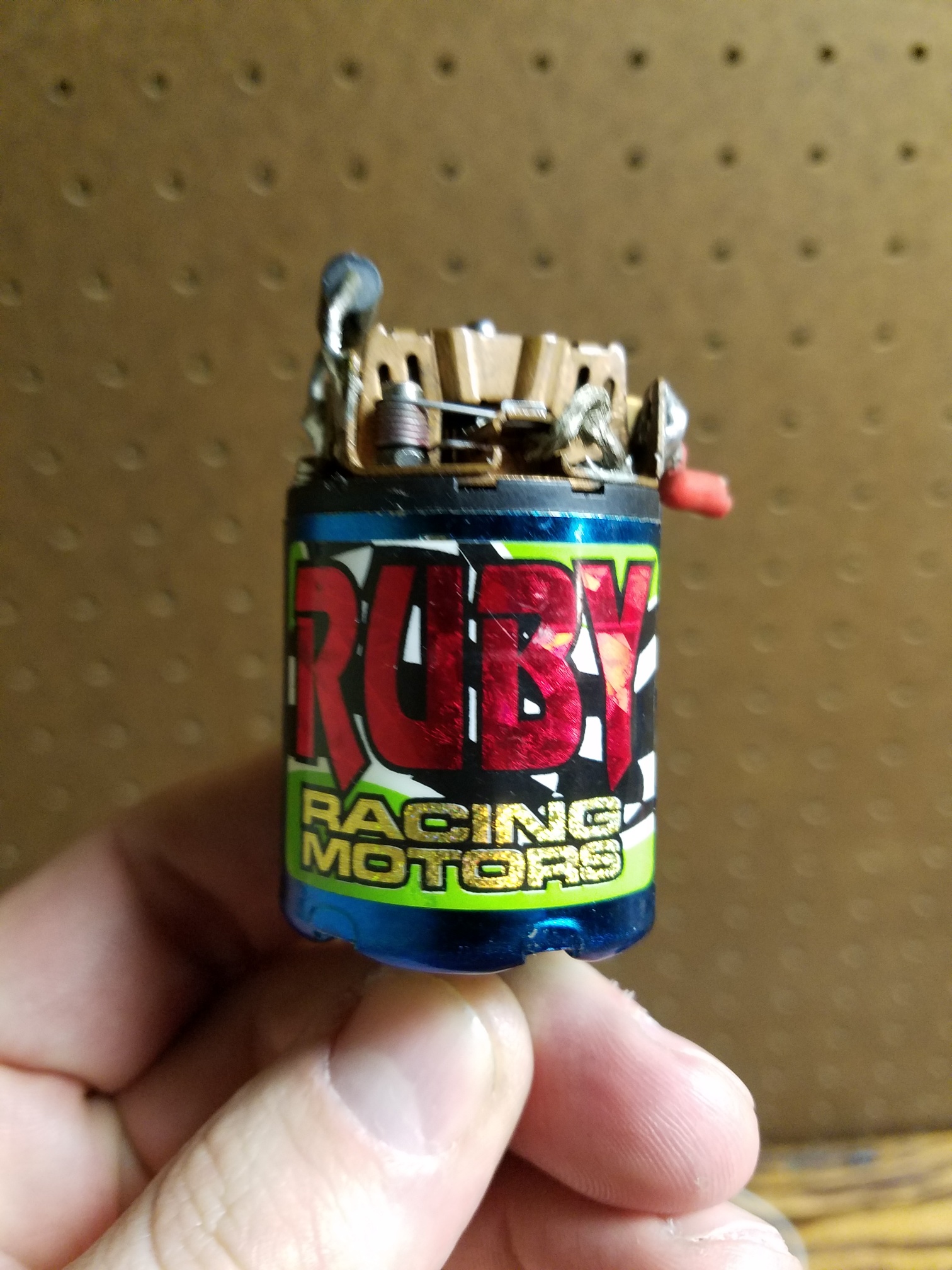

And holy moses did the mystery Ruby Racing motor sounded like it had some crazy high rpm compared to most of them.
This guy, can't find a single thing online about this motor.

We'll, the brush holders definitely look like Trinity.
They are the same design as those of the P2K, Revenge of the Monster, and Green Machine 3. I also have a Speed Gems Pro that uses the same type.
Open it up and see if anything stands out. It might have information written on the armature.
