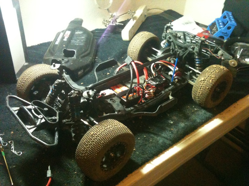

I had terrible luck with the "Thunder Tiger" SC10 team kit, I ended up selling it; spent more time in the shop then it did on the track :(.
Went traxxas slash 4X4 for 2 seasons, beat on it like it was an old associated :), held up great.
This year I'm on the SC10 4X4 which was actually given to me by my race club, and after testing I was amazed of how tough it's been. It's a bit tricky to work on but you get the hang of it, and it knocked 3 seconds off my lap times!
And it's got a cool 6-gear style top shaft slipper diff that controls the 2 stealth trannies! :)
It's cool to roll AE colors again weekly.

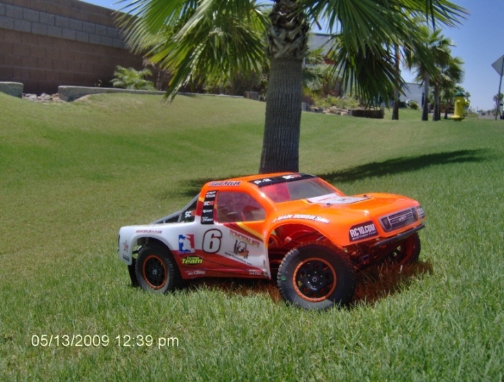

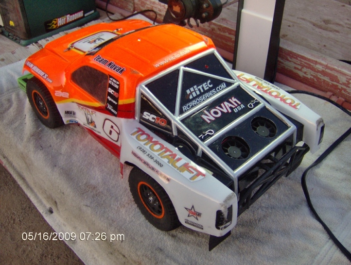

awesomeness
awesomeness
functional fans!
functional fans!
Best it ever looked; parked

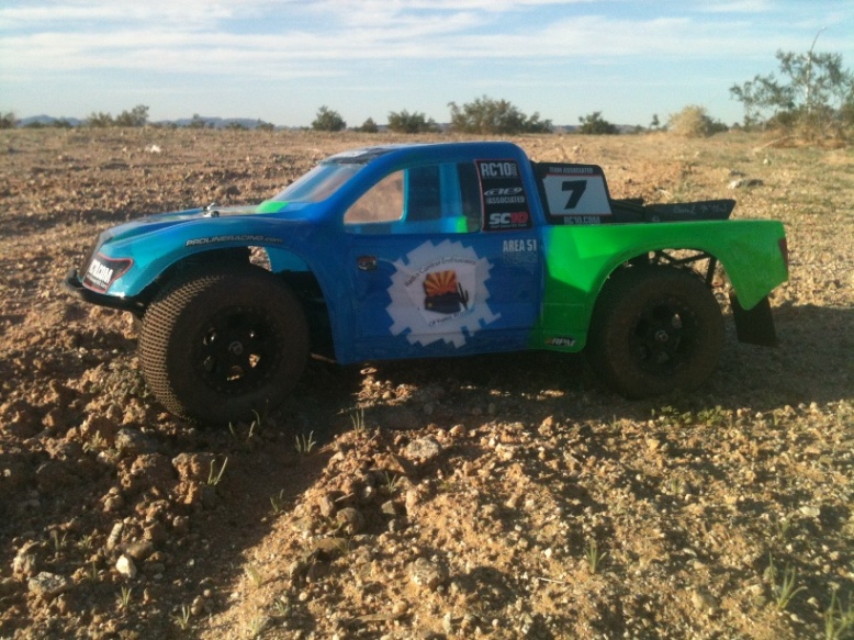

Here are the pictures I finally uploaded my from my phone! The Tundra was painted by VintageAE! 8)
