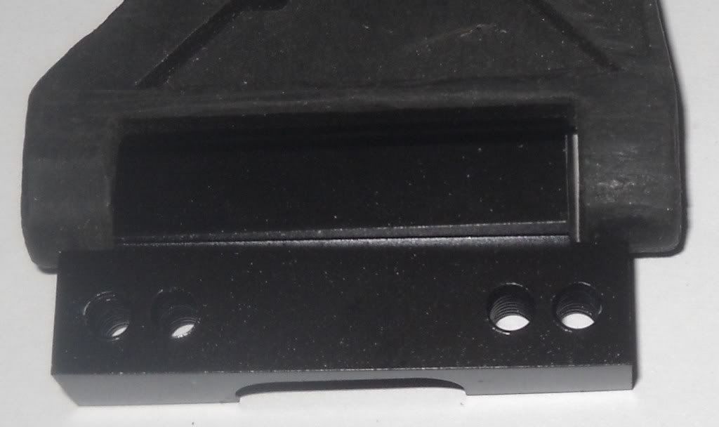

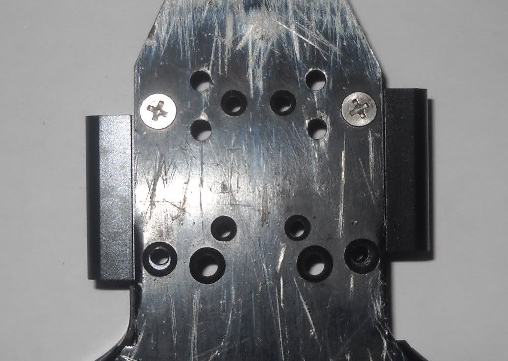

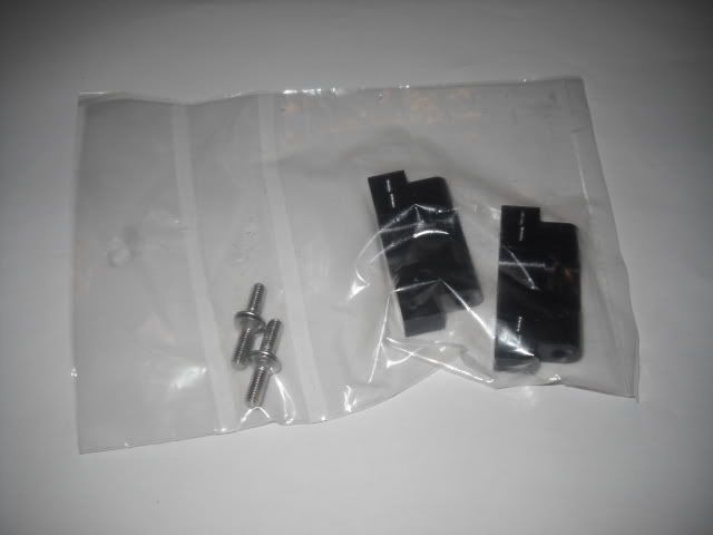

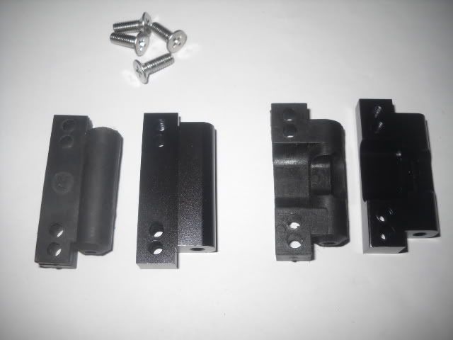

I got the alloy mounts from Pargu Store today
Nicely packed with 4 stainless screws
Compared to stock 1,5 plastic mount
Machining and black anno is of good quality
0,8mm gap....acceptable
But here's were I had trouble, I spend almost an hour test fitting and comparing measurements
The center to center hole placement if OFF by 0,5mm ....0.5 MILLIMETRE !!!!!
And the threaded holes need to be countersunk in order to make the screw tighten down properly
Morten Max

Thanks for the follow-up post and pictures. Looks like you could use a couple shims over the hinge pin (0.8 mm gap)

Are they a 0 toe, 0 anti squat or is that just how they look in the pic?

Looks like anti squat is built in to me.

They have the same squat as standard :wink:
One last thing I noticed was that the hinge pin hole is 3,4mm and not 1/8" (3,17mm) :?
so the hinge pin is a bit wobbly
One solution would be to drill and tap for a set screw, got the idea from my TC3 hub
Morten

At first, It was only to judge machine quality and precision for you guys
I had hoped to use this mount on a runner, but I'll use it on a shelfer instead, I 'd rather have a white nylon 6-6 mount like the 10T mount I have on my runner, but with only two mounting holes....like the ones on my Traxxas TRX-3 #2798 with -1° degree and #1934 Caster Wedge 1.5 & 3 Degree
The machine quality of this alloy mount from Pargu is very high but there are a few bugs with precision, as I explained
-Morten
