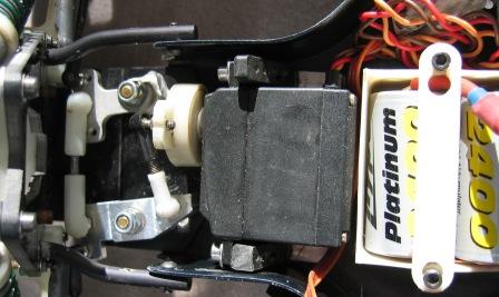

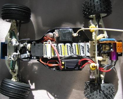

After modifiying my RC10T to fit 7 cell Packs (see pics) I wanted the same for my buggy. BUT I couldn't do that the same way due to the longer wheel base of the Truck. Instead I installed a GT sevo saver, and a low profile servo standing up. That way I gained the needed space.
I am not saying you should race with 7 cells, but it would give you more options to position the battery pack for weight distribution.
My Buggy is currently in my cellar, and I don't have any pics of the conversion, only from the truck.
Hope this can help for future races.

- close up of the modern servo position
- servo.JPG (27.11 KiB) Viewed 2096 times

- total of 7 cell RC10T
- 7cell.JPG (31.59 KiB) Viewed 2093 times

Hello Chewbacca!
What you did is crazy! 7 cells with BL-power!!! Nice high speed truck!
Your steering is interesting. I always search for the Masami hirosaka-Steering. I think, it´s from a Yokomo-car with a hand-made steering plate.
You bended the tubes to get space for the steering, right?
I own the RPM-RC10T front end, but I dont want use them. I want to keep the original-style.
If I make the steering, like Masami, I can put the battery much more forward. That will be my next step!
Thanks!
Michael

Hey Siebenelch nice that you like my "crazy" setup
This link shows the setup above in an early stage doing a
BACKFLIP
hope you like...
Now, back to steering setups. Yes you are right, I had to bend the nose tubes to make that steering work.
You can leave your current steering setup the way it is, just use a low profile servo standing up (aufrecht stehend) as close to the steering as possible. That way the servo itself is a bit more foreward, and you gail a 7-cell space for better weight positioning. I just used the GT steering, 'cause it's a perfect fit and I prefer those kind of servo savers over the kind mounted directly on the servo.
BACKFLIP
hope you like...

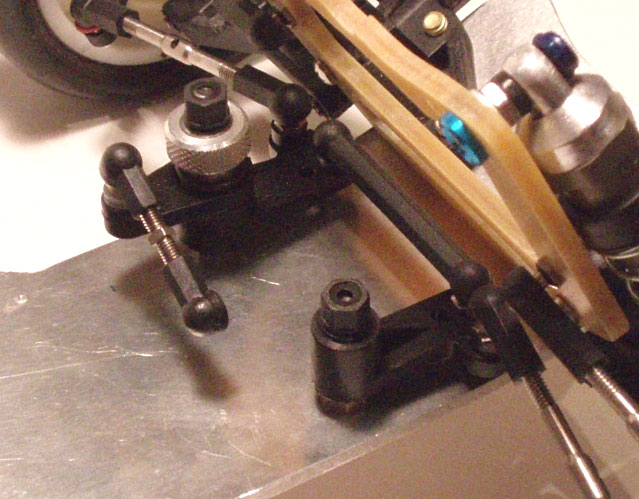

if you can find a set of aluminum sassy chassy belcranks they have the rod mount straight out the back instead of out the side. this would allow you to mount the servo sideways, i recently got a set from skunk werks and plan on doing the same thing on a future build. here is what they look like http://www.rc10talk.com/viewtopic.php?f=6&t=4451&p=42420&hilit=sassy+chassy#p42420

Actually, A&L made a set of bellcranks with the same setup but I think it was for a Yokomo...?
Michael: What steering arms (spindles?) are you using on your car? Thanks!

Hey Michael you could also use the RC10T or RC10GT steering screws and a B2 or B3 steering Servo Saver Kit, you will probable need to cut the chassis tubes. I haven’t mounted it on a tub but yes on a flat chassis.
- Attachments
- steering-setup.jpg (79.23 KiB) Viewed 1955 times

that is my standing low profile 7-cell conversion that I mentioned before.
It might be interesting for you racers for better weight distribution WITHOUT adding extra weight.
