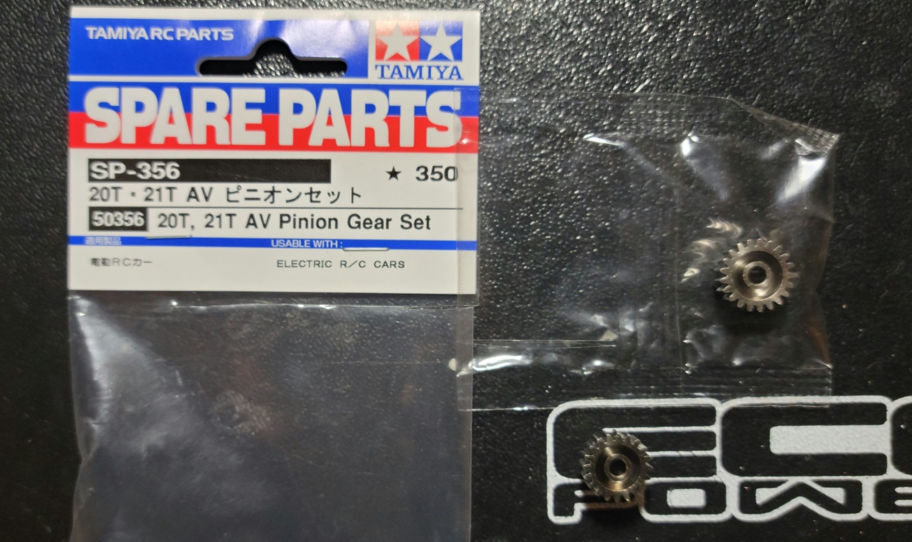

I had a strong suspension that's what they were. I took a gamble and bought the Tamiya 50356 pinion set. It is 20 and 21T, .6 mod.
The Futaba pinion set from the manual allows happens to be 20 and 21T, also lightened. Seemed like a good bet.
I read that .6 mod works out to about 42P.

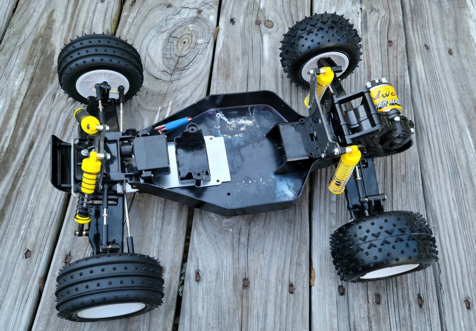

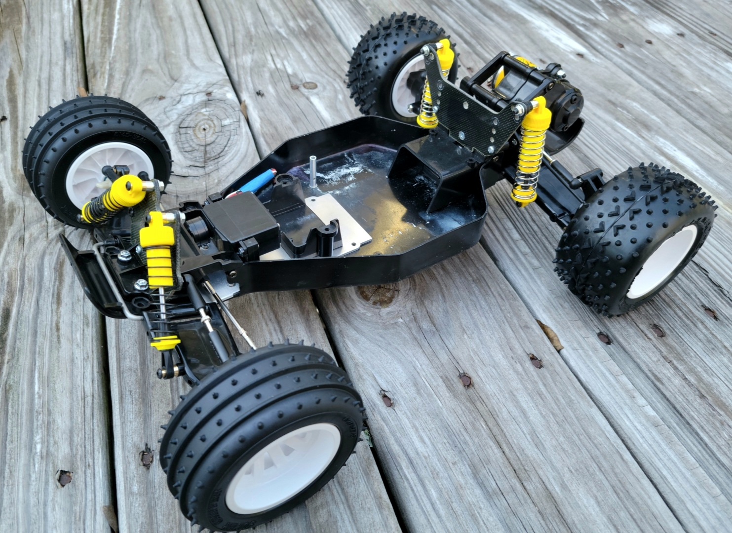

Got mine sitting on it's own weight.
Since many FXT specific parts are nearly impossible to find, I decided to take a few liberties and make some upgrades as well.
The yellow shocks are obvious. They are for a Terra Scorcher but the fronts have different shafts, ends, and springs. The rears worked fine with some limiters.
The white Stadium Blitzer wheels are also obvious. Blitzer front tires and Schumacher Vee-2 rears.
Also got new Blitzer arms, carriers, and C hubs. They were cheap enough and I have five other vehicles that share the same pieces.
I used Traxxas turnbuckles and mostly Tamiya ball cups. There are also RPM (servo saver) and Kyosho (inside rear links) mixed in to adjust length.
I had some 3mm Schumacher silicone nitride diff balls from a miss-shipment, this seemed like a good place to use them. Also used new Tamiya bearings in the transmission.
Even though the axles and dogbones were in good shape, I used some Tamiya (53791) cvd's.
I didn't have the original antenna holder, so I made a new one (Parma style). It isn't exactly like the original but looks the part.

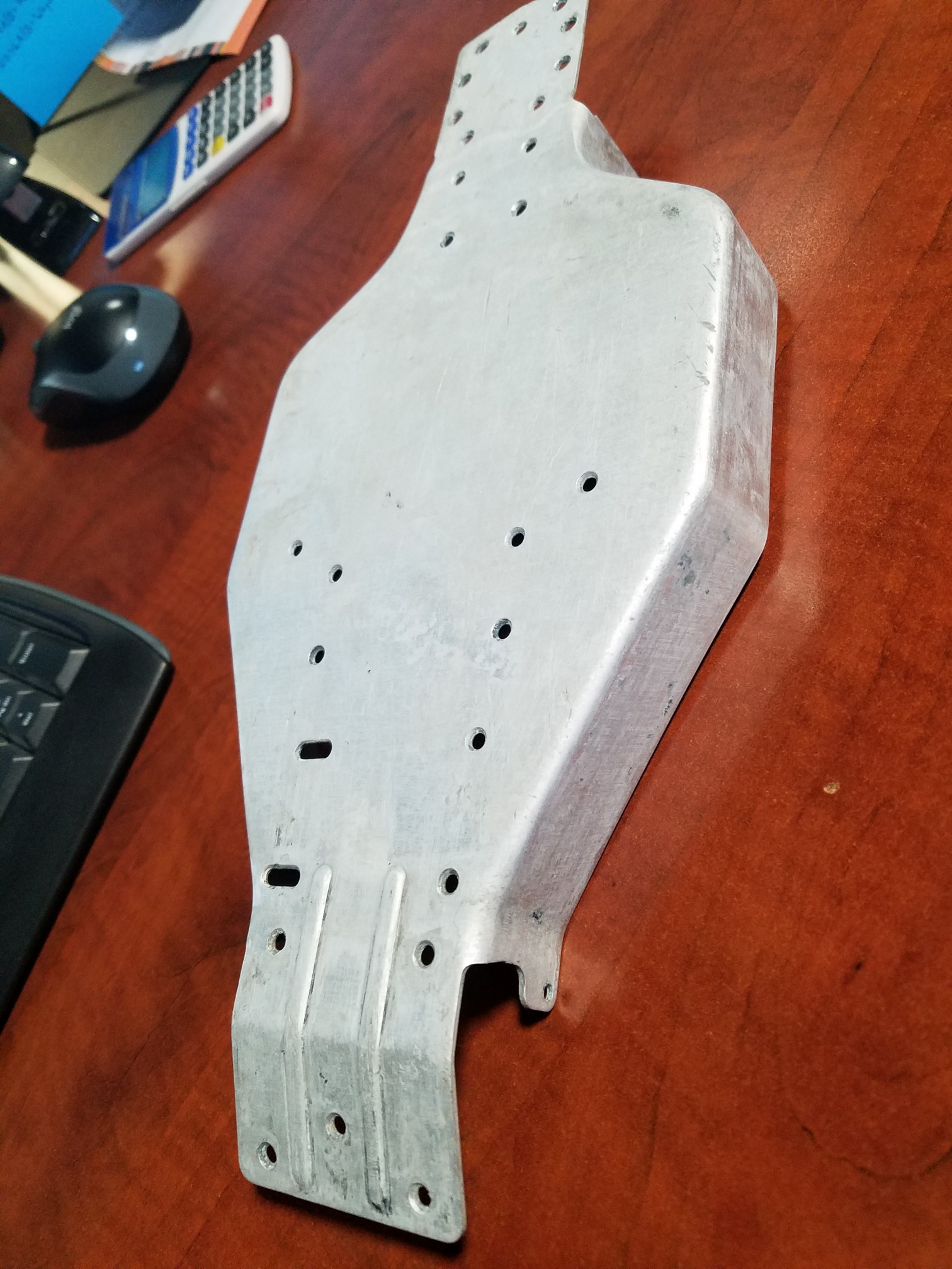

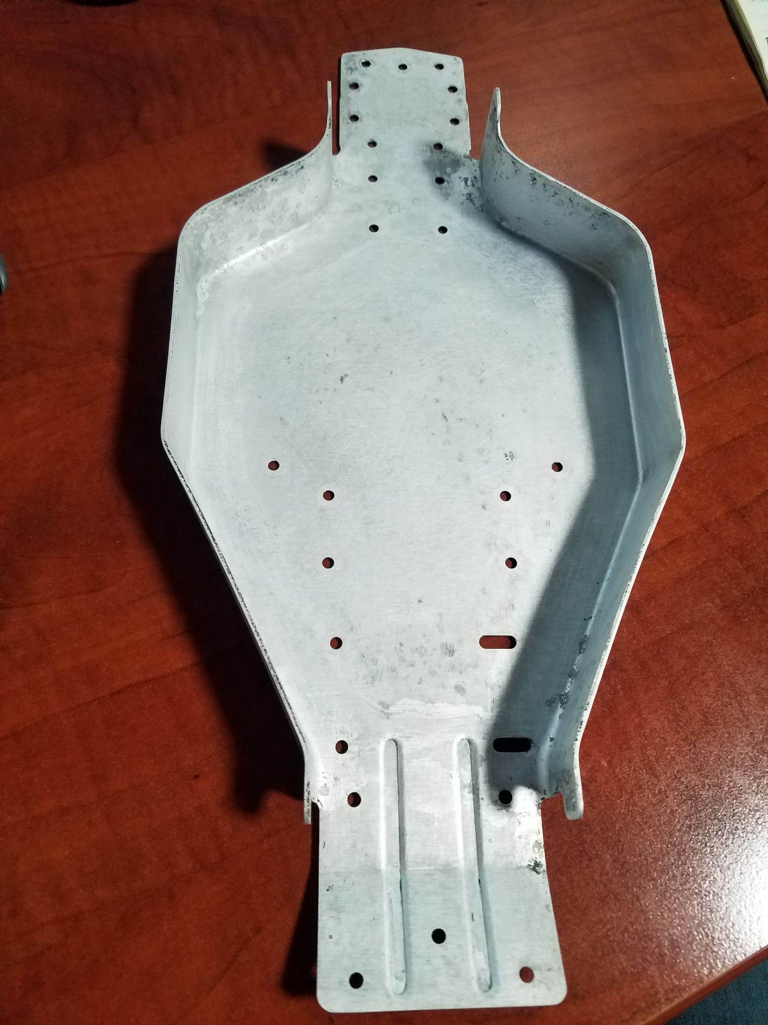

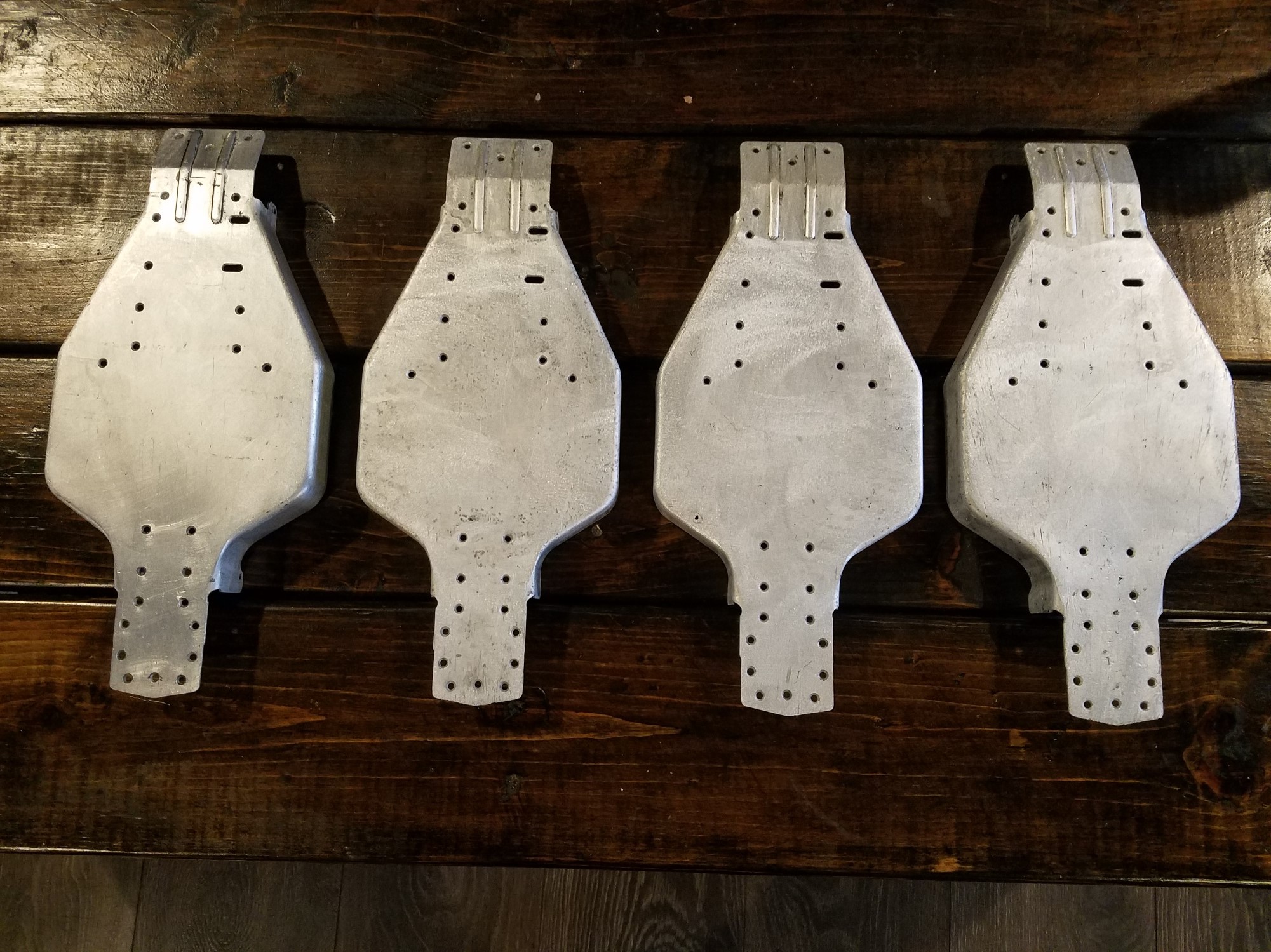

Indeed heavy duty Easy-Off oven cleaner (the yellow cap can) really does the trick removing anodizing. Here's a couple pictures of the chassis after spraying with Easy-off, sit for 15-20 minutes at a time, whipping off and rinsing with water. Did this process a few times on different areas as needed. Now going to scrub it with a scotch-brite pad, wash with soapy water and have my brother take it to work to powder coat it black.
-Jerry-

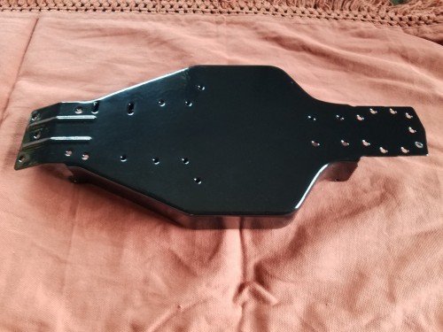

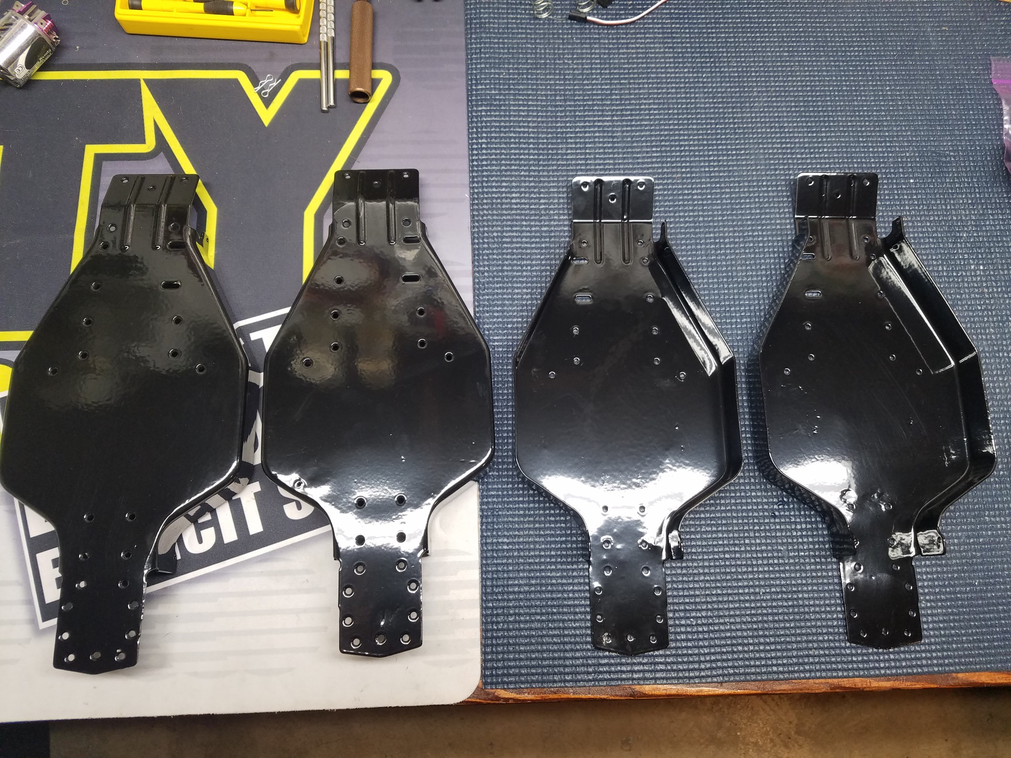

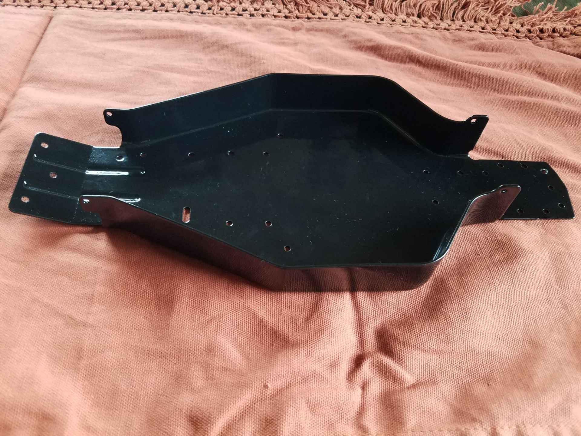

Post by R6cowboy »
Got the first above chassis powder coated.
-Jerry-

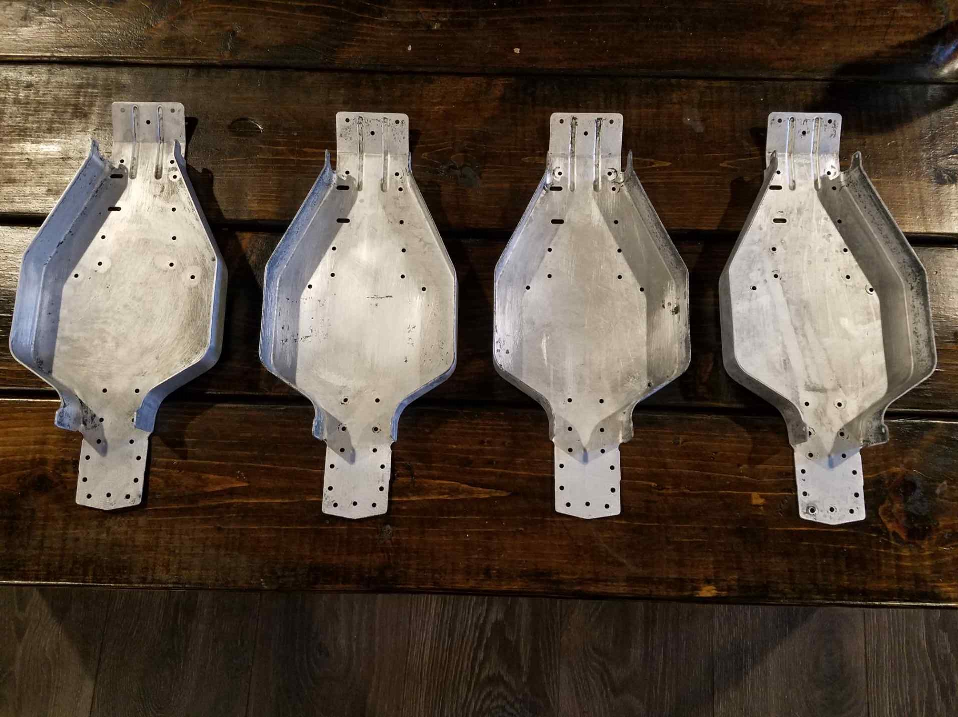

Post by R6cowboy »
Other four are stripped and off to powder coat. Only 1 of 6 factory chassis' that was still nice enough to keep as is.
-Jerry-

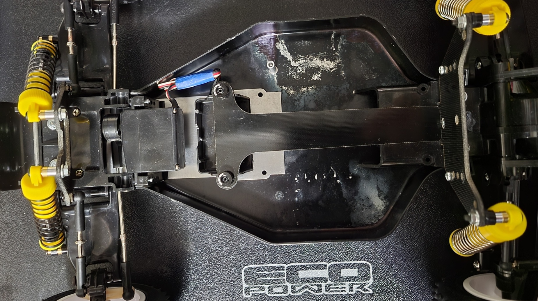

New battery strap from Factory Works. The current material is a pretty close match for the original FRP towers.
Even though I have the original posts, I wanted thumb-nuts. M3 helicoils, 20mm studs (with jam-nuts), and Exotech twist nuts.
