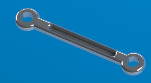

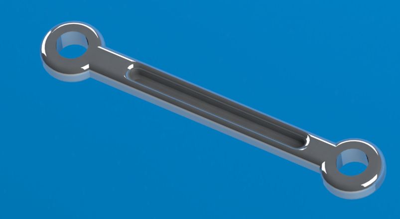

While looking at those pics of the wing and bulk heads made me think about that drag link. So I drew some thing up. It be cool to have some one make one of these up. Its not scaled correctly just an idea for one.

the replica bulkhead was made by chophead. its for another alloy build. so many testing parts resulted in almost another car.
the modified bulkhead was made by jwscab. It is for this car.
I figured out how to do the drag link. The rod ends I'm using are threaded so deep that I just cut down the ends until they fitted together ok.
on a side note, that linkage you see works in 5 places. I just adjust which holes I mount too but just the basic rod ends with a 1/2" spacer between and im golden on all camber linkage. My steering used like a 3/4" or maybe 1" spacer. I'm still gonna add washer into it until I'm happy with the steering.
