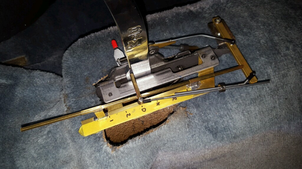

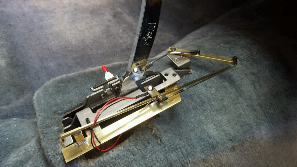

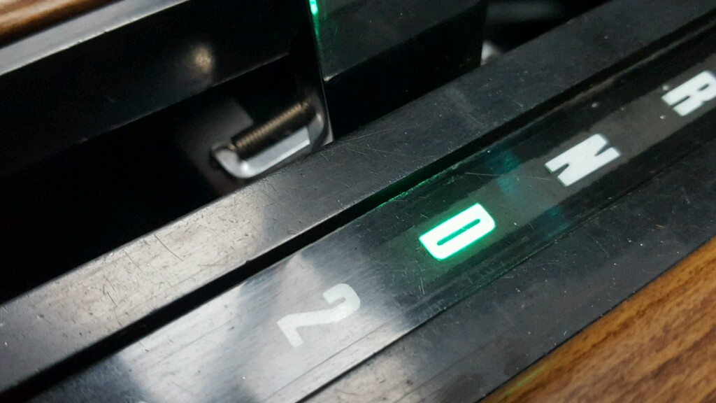

After a LOT of messing around, measuring of unmeasurable angles, a couple of styrene models, cutting, drilling, soldering, cursing and test fitting it a million times and some luck I'm finally nearly over one of the biggest hurdles.
I finally got the light indicator working well, surprisingly well actually. The pivot arm is bearing supported and the whole thing operates smoothly. I just need to make an LED holder and make a nice one piece linkage rod instead of the collar arrangement.
This will allow me to use the factory indicator bar in the console using a left hand drive shifter in a right hand drive car, and no modifications have been made to the console, no ugly aftermarket plates etc...

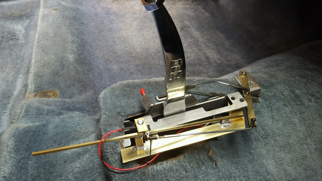

Here it is all finished with console bolted in the car. I also put the passenger seat in with only the sill plates still to go, then I can call it quits on the interior.
Next up - the engine pull.....

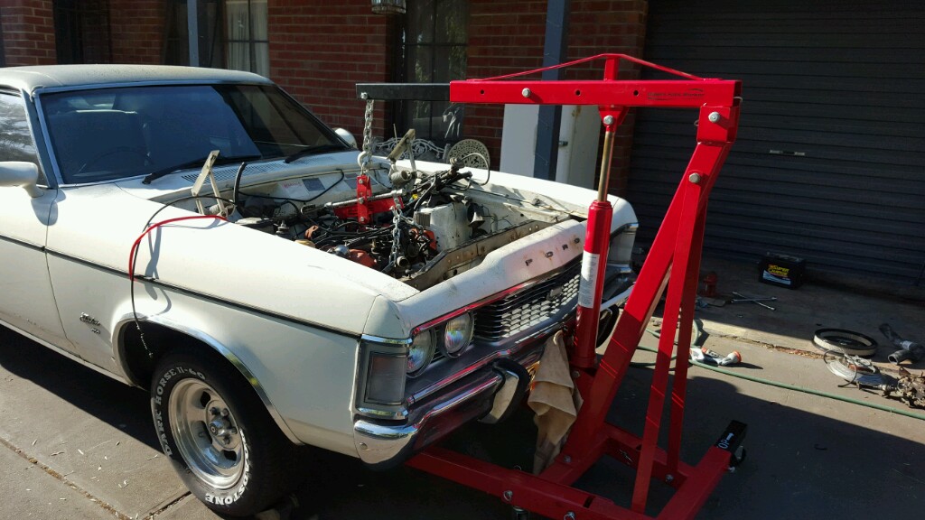

I was planning to pull the engine out Thursday but the weather was iffy and I had other things I had to do. These last two weeks I've also been side tracked with RC again, which doesn't help my cause.
I did drop off my driveshaft for balancing only to find out the new U-joints I put in were bad.

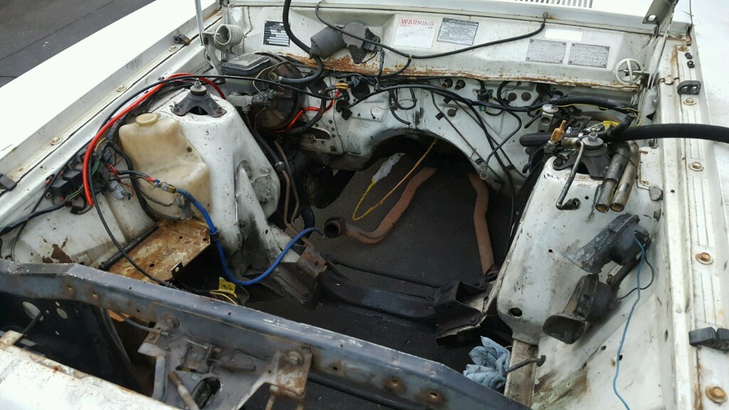

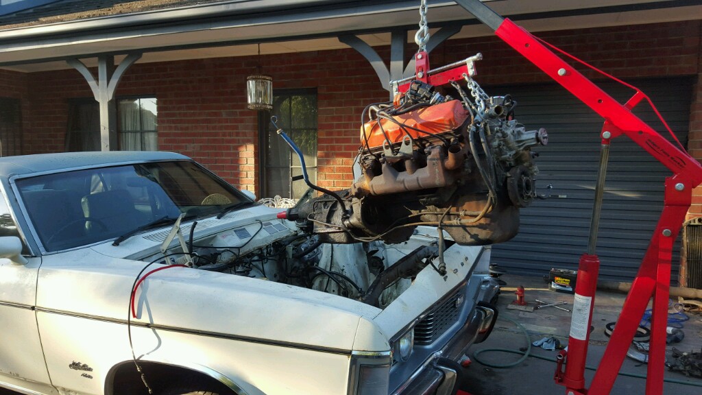

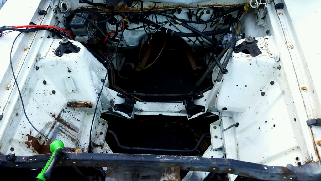

I managed to get this done today by myself, now the fun of scrubbing ,cleaning and degreasing. The complete front wiring harness will be replaced as well as the steering box. I should also replace the power steering hoses while it's apart but where do you draw the line?
Christmas makes this a year long project. I originally thought it would take no longer then 2 months when I started, a quick engine rebuild snowballed into something more.

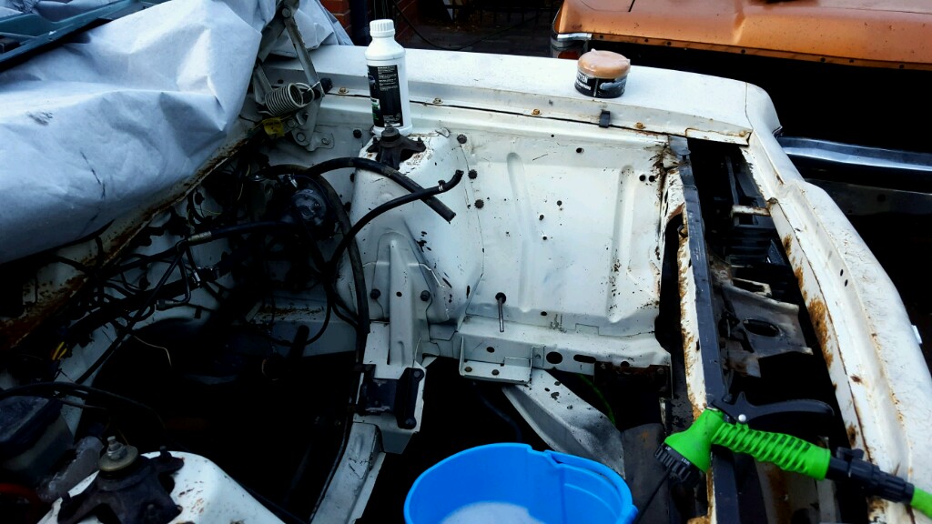

Not much to update but I started cleaning and degreasing the engine bay. Under all the crap it appears to be in quite good shape. I wish I could of done more today but it was too hot to work in the sun. I wanted to get the wiring harness out and tidied up a bit more, but I'm just happy to have made some progress.
I will give the right side fender well around the battery a quick sand and rattle can it with a color coded can, and touch up a few surface rusted areas.
At the end of the day It will still be a piece of crap, just a polished piece of crap.
