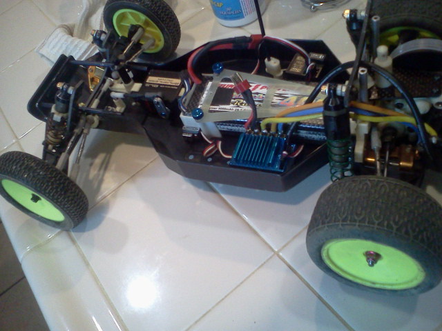

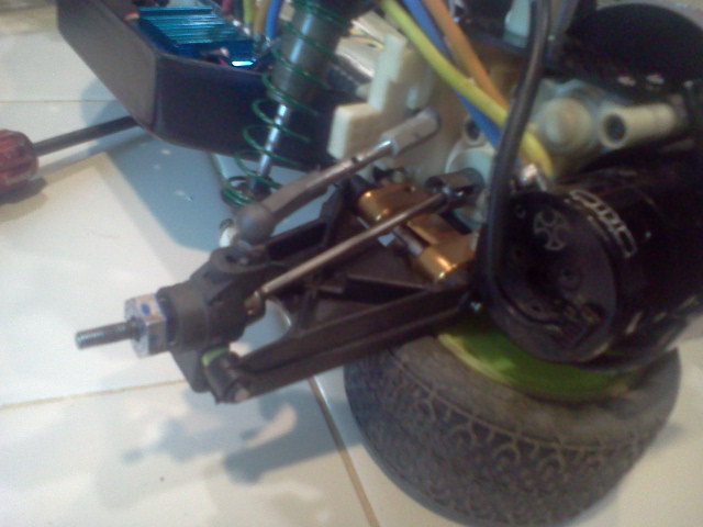

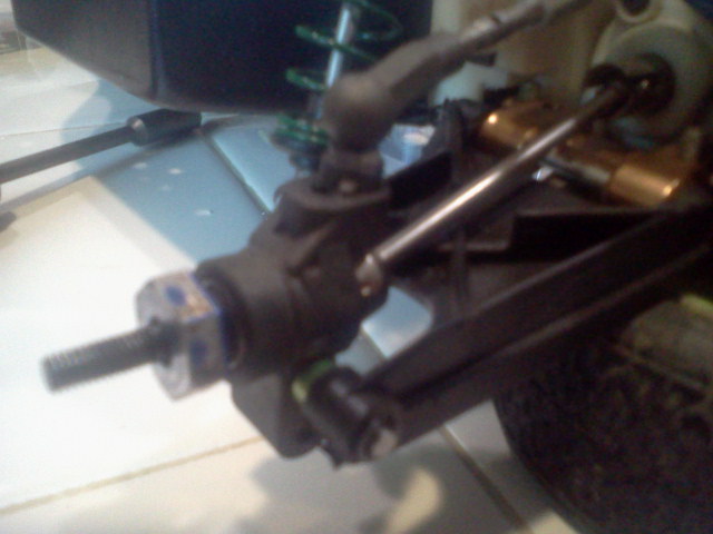

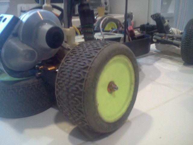

today I decided to put the hubs and cva's from my kyosho rb5 onto my rc10 worlds car...they fit perfect!!!!! all I did was open the whole a little for the hinge pin to go through...Bad thing is that the kyosho parts are so expensive! kyosho cvd's are $40 compared to AE $30..I had the parts on hand thats why I used them and I run kyosho 10th buggies

best thisng is using the hex instead of the pin,no stripped out wheels.. I added a green spacer on the hub,can be tuned to run the hubs forward or aft...Another good thing which was most important to me is that the cvd fits in the outdrive perfectly in the middle..Going to the track today to try it out guys

Hairy, looks good, what track you taking it to? Looks like OC or WC? Let me know how it works. I am working on some stuff myself to use modern up front and NOT loose track width...

JK Racing wrote:Hairy, looks good, what track you taking it to? Looks like OC or WC? Let me know how it works. I am working on some stuff myself to use modern up front and NOT loose track width...
I went to ocrc tonite, worked really good,Need more steering...I want to convert to an updated front end also..I also think the panther tires I have up front cause a bit of push...Ryan Cav's dad liked it!!!! He gave it a once over, said my front was too springy...
