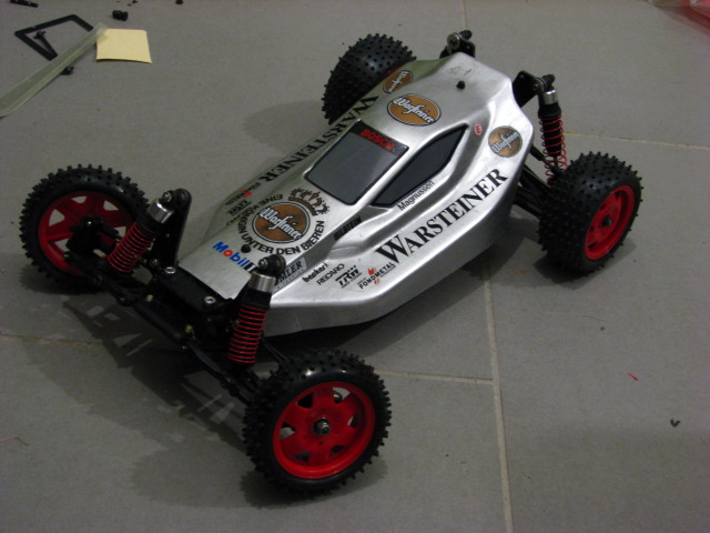

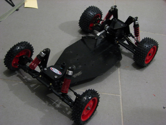

Going to a race with asso-man next weekend and trying to get his ready.
losi chassis and front bulkhead, andy's front arms for the ultima, incognito C-carriers and steering knuckles., carson 2.1 and 2.0 wheels with drastic tirestrinity ultima front shocktower, kyosho plastic shocks with red tamiya sprongs, optima rear arms with tamiya tg10 wide axles and hexes, home-made rear shocktower, stinger mk2 rear gearbox with yz-10 spur mount and HPI or axial .6 module spur, single-arm central steering, external painted tamiya body with kyosho sticker set

That's just a cool little runner! Why did you paint the shell on the outside, just reusing an old body?

I painted the oustide because the can of yellow I had left, turned out to be empty and started spluttering on the inside.
Up-close it really looks a bit ratty.
I brushed the paint further up with a hard toothbrush: just before it had dried completely. As it wasn't applied all at the same time and in different thickness some areas reacted different from others.
Mad-Max accidental
Luckily I found that sticker set to go with it. The silver looks a bit like a battered beer barrel so the stickers really fit the subject

I broke the middle gear on the stinger transmission: eventhough it is steel, it wore down just in one events racing. Apparently the xle it runs on came loose a bit. Ofcourse I didn't have a spare and actually I already had plans to add a slipper.
So, I decided to do away with the original inners and put a belt drive in. With some creativity I pushed a yz-10 top shaft with slipper in it, and a lazers ball-diff with belt pulley. No idea what the belt is from originally; just one of the many I collected in all sizes.

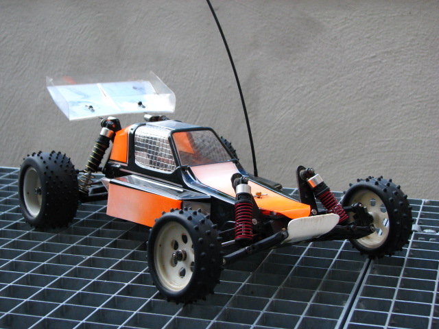

Next up was a change of dress; really wanted to use the Bolink Funco of mrlexan.
And finally, to match the old-shool lok of the body: a baja champ spoiler and pro-line wheels for the ultima:
RESULT: Hope to test it at the track in september
