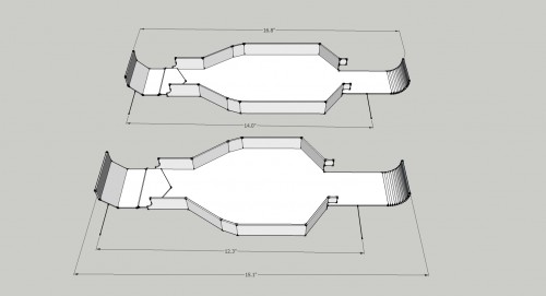

Hmmm, drawing from the given specs doesn't quite seem right:
I've drawn the SC10T chassis with 44mm (1 3/4") extra length over the RC10T chassis based on wheel base lengths given in the stats.
*RC222* has made his chassis 18.83mm (3/4") longer.
bigredjeep has made his chassis 50mm (2") longer.

I made my SC10T chassis 2.5" longer and it lines up perfectly (except I drilled the front mounting holes cockeyed and it's about 1/16" off, enough to drive me nuts). The front wheels are centered in the fenders when the suspension bottoms out.Drusky wrote:Hmmm, drawing from the given specs doesn't quite seem right:
