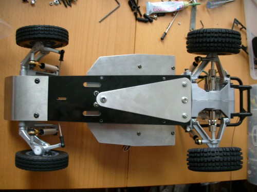

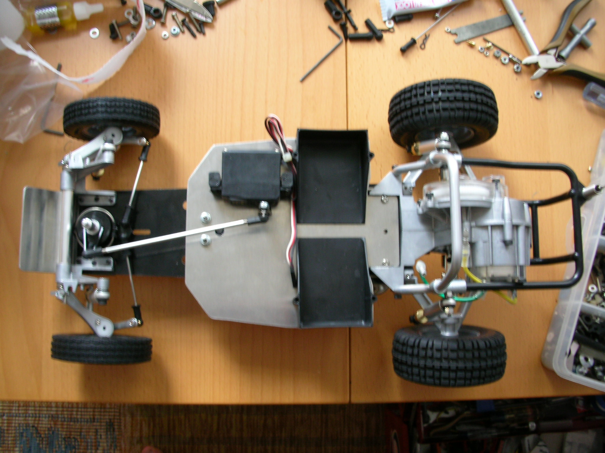

I figured I'd start a new topic for my buggy so it doesn't get lost in the "Exciting news" thread. I'm not done yet, but I'm getting there.

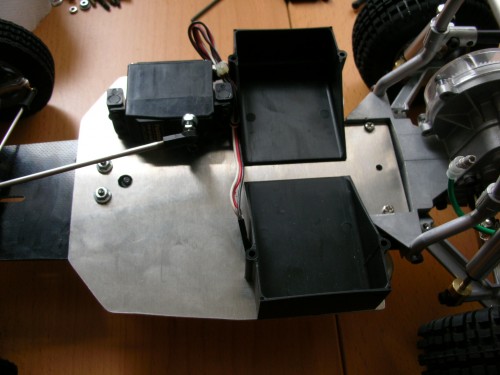

I wasn't looking forward to trying to find one of those weird little batteries that Tamiya says you're supposed to use with this kit, and I didn't want to get any hump packs. Basically, I didn't want to have to buy batteries that I can only use on one of my cars. Also, the plastic tub is cool for nostalgic reasons, but it just didn't seem like it would be very practical when it comes to running the car. So, I took a piece of aluminum sheet and made a new electronics tray that will hold a 6 cell stick pack. The servo is in the same place and I replaced the bent skinny rod with a straight, heavier rod, I think it is a Clodbuster part. I used the existing holes in the chassis to mount the plate, and used spacers and nuts to put it up high enough to clear those suspension bars.

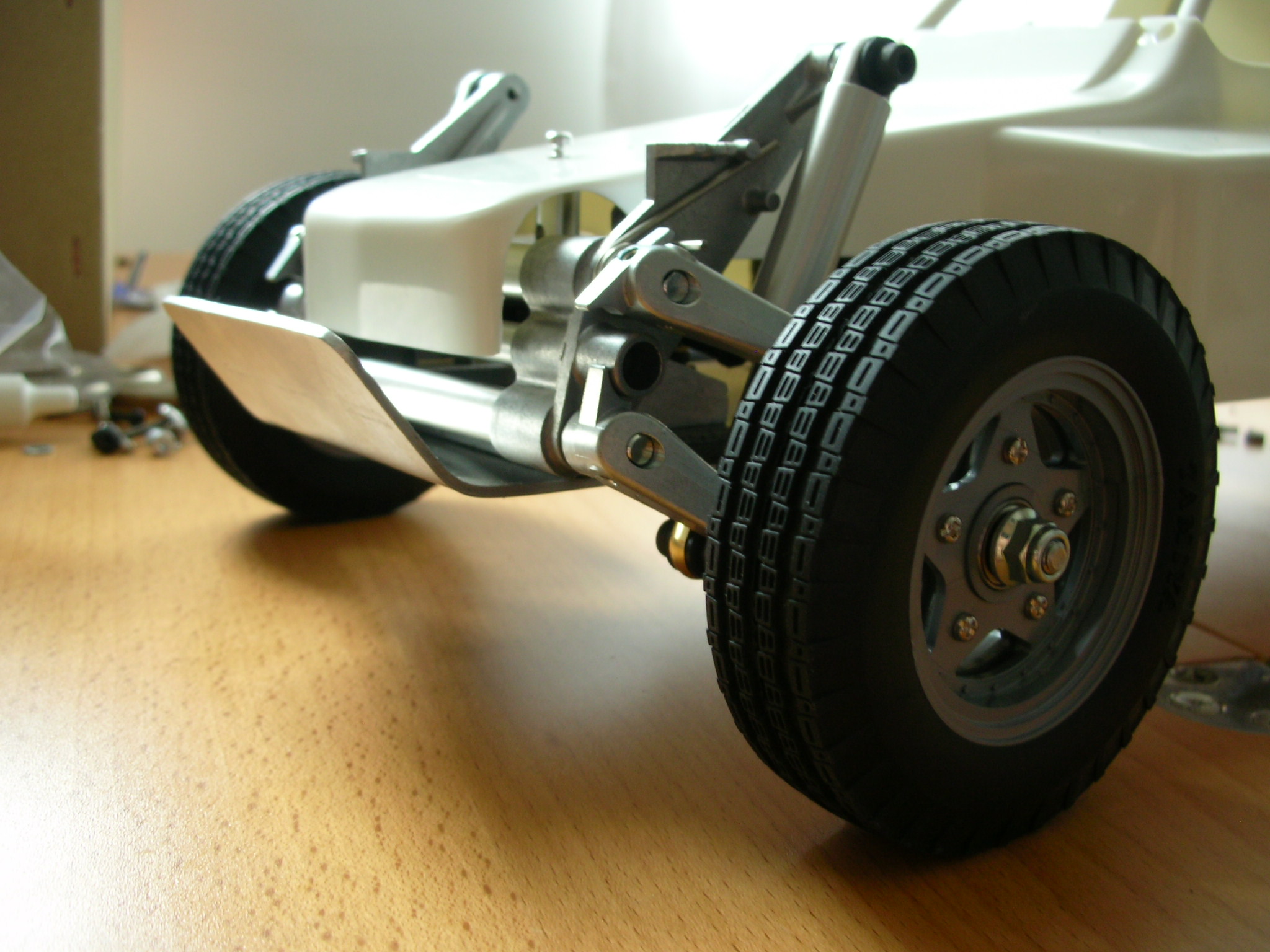

I also decided that I didn't really like the stock bumper. It's just too big. I saw some simple aluminum bumpers on ebay and thought "I can do that". I made a spacer out of Kydex so the screws holding the front uprights would clear, then just cut another piece of aluminum and bent it. Pretty simple and it looks better than that huge stock bumper.
More to come. Here's some pics.

You know this is downright blasphemy. The radio crate is one of the things that makes the Buggy Champ so bitchin. How are you going to be running this thing on the beach and splashing through water with your freakin jubblies all hanging out in the open.
Luckily I for me I made up a few hump packs because this isn't Tamiya's only vintage pony that needs one to run on.

shodog wrote:You know this is downright blasphemy. The radio crate is one of the things that makes the Buggy Champ so bitchin. How are you going to be running this thing on the beach and splashing through water with your freakin jubblies all hanging out in the open.![]()
I agree, the plastic box is cool as heck, but it just didn't seem practical. Besides, I'm never able to leave anything stock, especially anything made by Tamiya.
Not sure on the color yet. I'm leaning towards blue, maybe with some white. I thought about doing a few different sponsor bodies, Hawaiian Punch, Skoal (again) or a few others, but the decals don't really fit the body very well. It's still all up in the air right now. I'll prime the body tomorrow and pick something out on Monday. I'm really liking this little buggy. It's nice to have something that is fun, but not at all toy-like. This thing is almost like a functional piece of jewelry. I do want to get it some aluminum wheels, not sure if I should get one piecers or the outer rim kind.

May I suggest you countersink the screws on the bottomside; since you're not gonna run just beaches

Hey good work, thats pretty cool. The radio box is weird to me, its strange how its pretty loosely fitted and the servo is just taped too. Seemed a bit of a bodge to me when I built mine.

Ed, I doubt I'll be countersinking the screws on the chassis. I don't have the proper tools, and since this is hardly a racer, or anything close to a high performance machine, I don't really see the need. The Brooklyn concrete should smooth them out real nice.

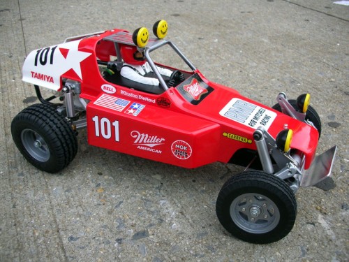

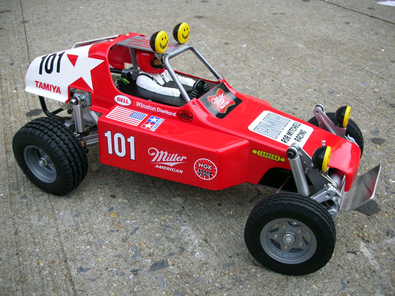

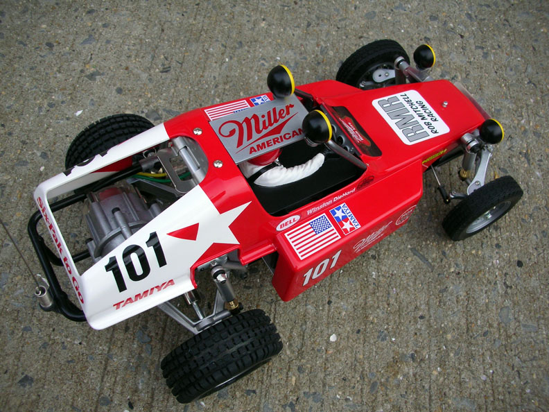

Okay, the Buggy Champ is done. I haven't had time to run it yet, but at least it's finally finished. The paint job was inspired by Bobby Allison's early-mid 80's Miller Buick Nascar. I'm happy with the way it turned out.

Very nice job there. I like the paint scheme.
Is that the new or old body shell?

Yes now taht I had a chance to take a closer look. I see it iss the newer buggy. The lights, the shocks give it away.MelvinsArmy wrote:Thanks guys.![]()
Steve, this buggy is 100% new.
Can't wait to see it live and in livng color..
