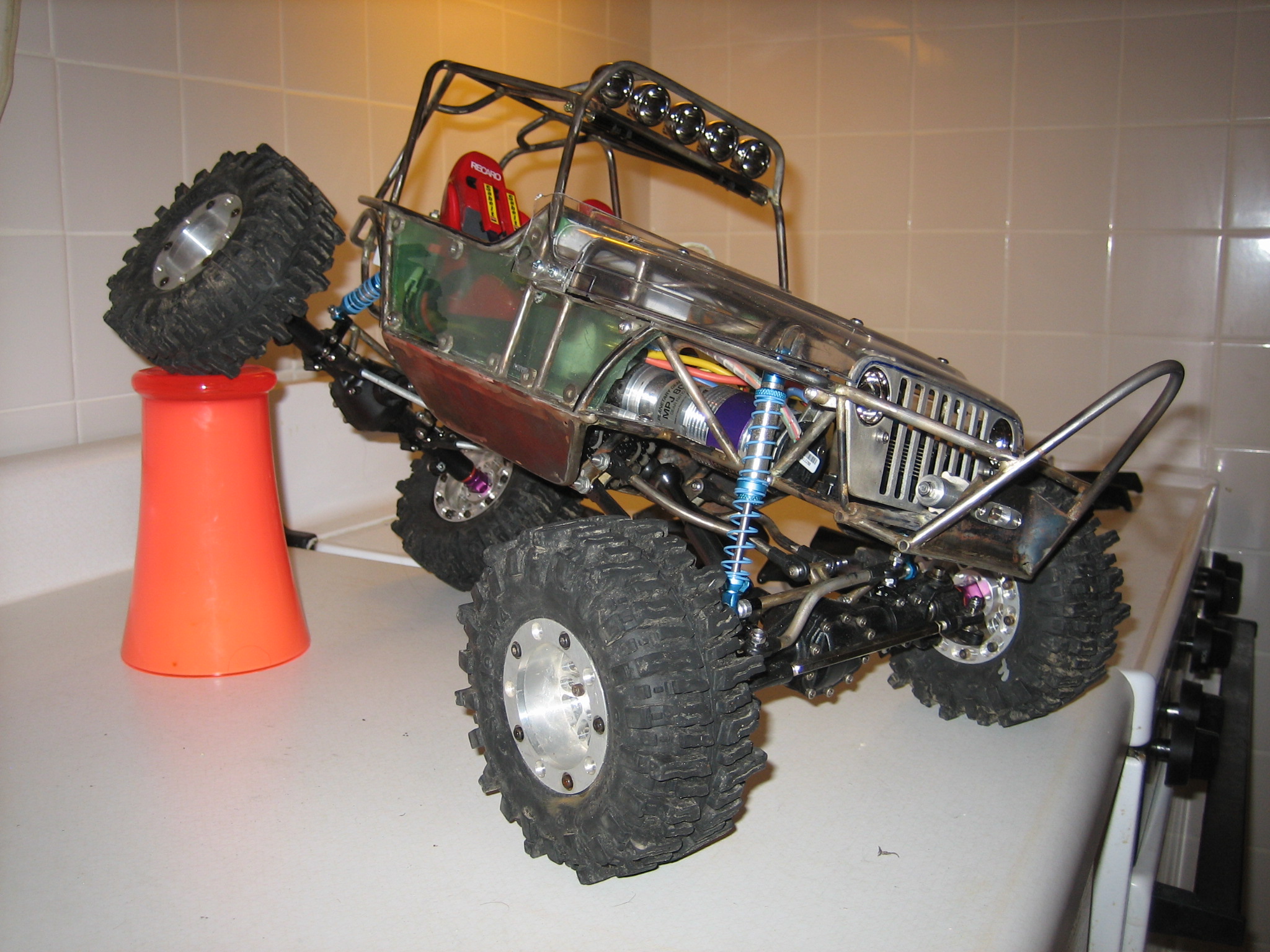

one of the best cages i have seen

This is super sweet.
I love aftermarket takes on the vintage R/C. As long as it is done well and tastefully.

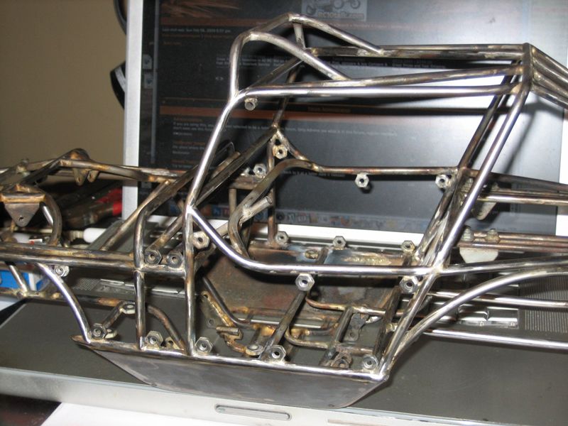

that is nice for sure.
anybody who likes this stuff should really try it for themselves.
once you get the hang of bending, fishmouthing, and brazing it becomes almost meditating.
certainly time consuming...

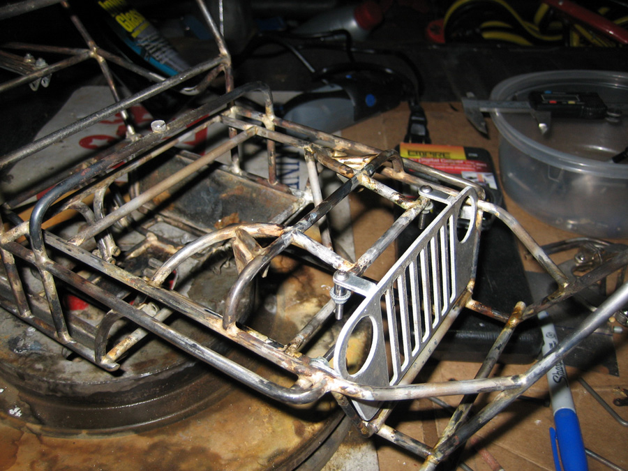

Badhoopty your cramwler cage is ACE! Where can I go to learn how to bend pipes the way you guys do? I have bought myself a blow torch and was even thinking of soldering brass together to make up a cage but Im sure brazing would be even better. please direct me...I must learn...
- jwscab
- Posts: 6580
- Location: Chalfont, PA
- Been thanked: 505 times
Re: one of the best cages i have seen
just need a cheap tubing bender, readily available. typically you use 3/16" tubing, which is pretty easy to bend by hand if it's steel. It's brake line. Stainless is a bit harder to work with.
for tight radius stuff, it's probably a good idea to fill the tube with sand, and close off the ends, make your bends, and trim the ends off afterwards.
as far as brazing, you can probably use just a propane torch and brazing rod, which has a flux coating. the fit up and jigging is the most time consuming. it also takes some skill to master applying the right amount of heat.
just takes practice. the cages on this thread look fantastic!

both scale4x4rc.org or rccrawler.com have tons of info on how to braze tubers.bormac wrote:Badhoopty your cramwler cage is ACE! Where can I go to learn how to bend pipes the way you guys do? I have bought myself a blow torch and was even thinking of soldering brass together to make up a cage but Im sure brazing would be even better. please direct me...I must learn...
you NEED to use harris safety silv solder AND flux, and you need to clean every surface to be brazed. anything but harris safety silv will either not work, work kinda, or not work... the harris stuff is much higher in quality and silver content compared to anything else and melts at a much lower temp than normal brazing rod, its like using deans solder compared to plumbing solder for electrical connections.
you will waste alot of stuff in the beginning. after you mess around a bit you figure out bends and how to measure and how to prep the joints. one thing i do on tricky bends is use a coathanger at first to get the right bend, and then bend my tubing or rod to match it. i'll also braze 2 pieces of tubing together to get the exactly the same bends in both tubes, then unbraze them for mirror bends on both sides of whatever.
i use harris 45 & 56 safety silv. 45 for the main stuff and the 56 for details and when brazing close to existing joints.
http://www.harrisproductsgroup.com/consumables/alloys.asp?id=30
hmmm... never knew home depot had it.
http://www.homedepot.com/webapp/wcs/stores/servlet/ProductDisplay?storeId=10051&productId=100672839&langId=-1&catalogId=10053&ci_sku=100672839&ci_src=14110944&cm_mmc=shopping-_-google-_-D25X-_-100672839
you can start out with a cheap mapp gass torch from home depot. 90% of the tuber below was done with one, but for the real tight areas where you dont want to spread alot of heat around you will need a mapp/oxygen setup. i got one from home depot for around 50 bucks, its awesome but you will blow through a ton of the little o2 cans if you use it for everything.
anything steel you can braze with the harris and a cheap bottle of mapp gas. tubing, rod, sheet, little bolts and screws, tamiya metal parts... i get my brakeline at the autoparts store and my steel sheet and rod at a hardware store.
for fishmouthing joints on 3/16" tubing or rod, i use a 3/16" dremel chainsaw sharpening stone. i go through a ton them, but its alot faster than using a file.
i've never used a bender, although i'd imagine they are nice to use. i just bend stuff with my hands or use a socket to wrap the tubing around to get my bends. for really tight bends rod is way better than tubing, since you cant crink it and its more predictable to bend by hand. stainless tubing is awesome but its a pain to bend by hand.
so i fishmouth and test fit the joint, then if everything is cool i clean the areas to be joined with a dremel flapwheel (important) and apply the harris flux to the joint, join the 2 pieces together, heat them with the torch until the flux turns clear and looks 'wet' and the joint just starts to glow red, apply the harris safety silv solder to the joint until it flows into the joint, then remove heat. you can also 'pre-tin' both sides of the joint before you braze them together, and un-braze anything that you mess up on or want to change.
the basic principle is exactly like soldering electrical stuff but with much higher heat. the hood its on in this shot shows how long this project has been taking...

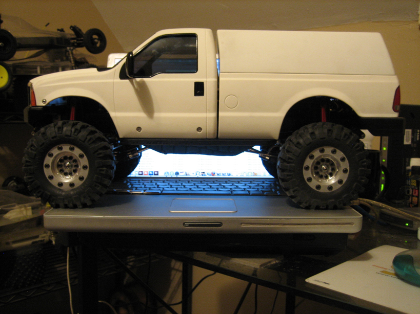

i very much like my hi-lift f350, which is basically tamiyas 2nd gen bruiser.
