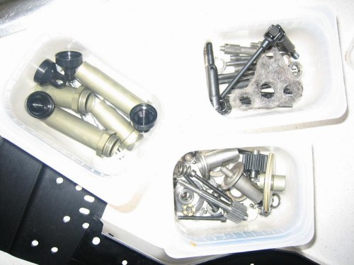

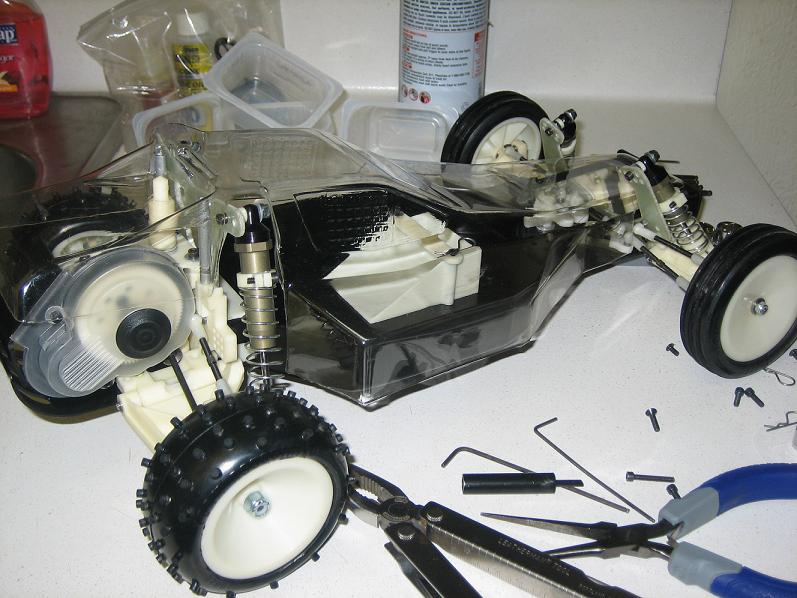

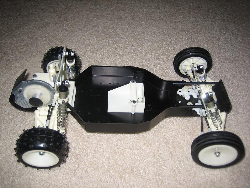

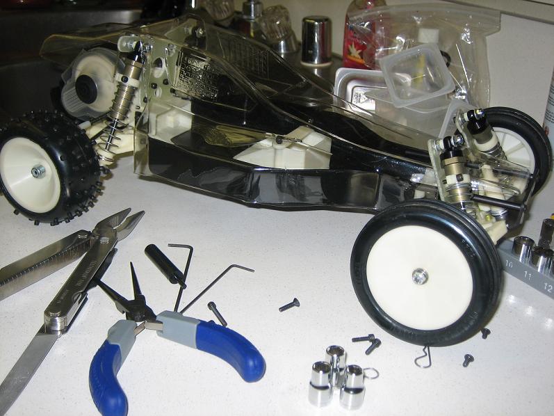

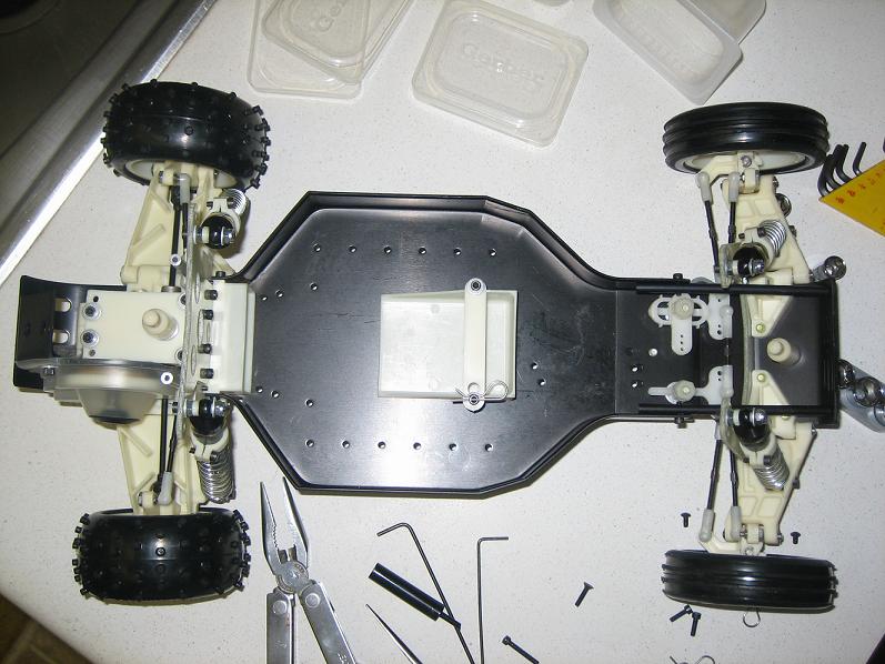

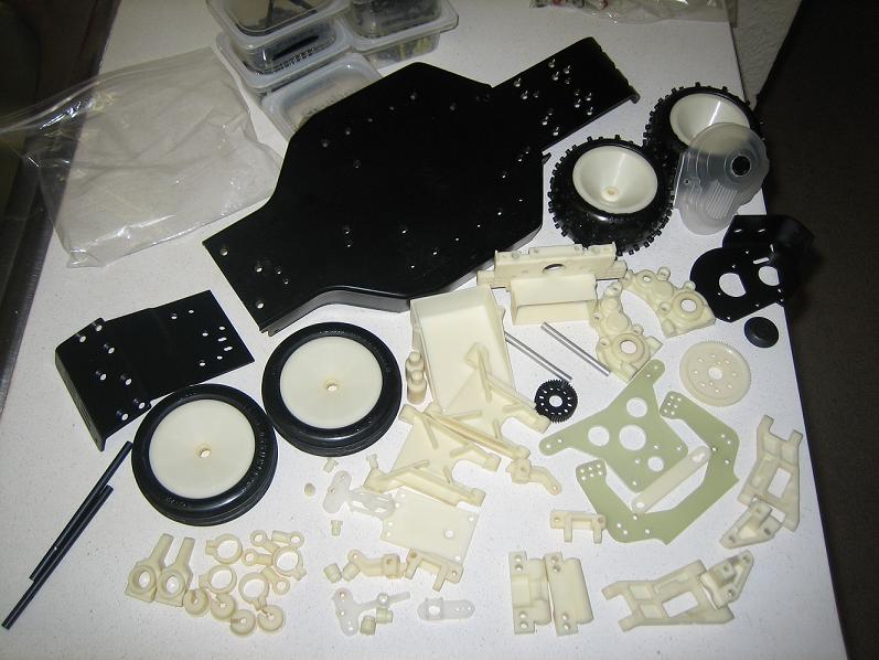

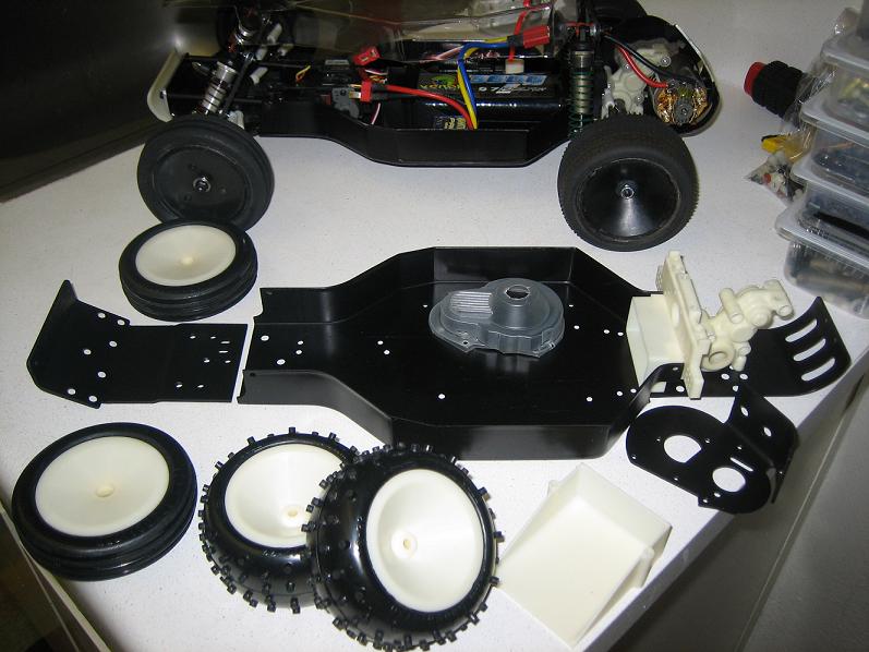

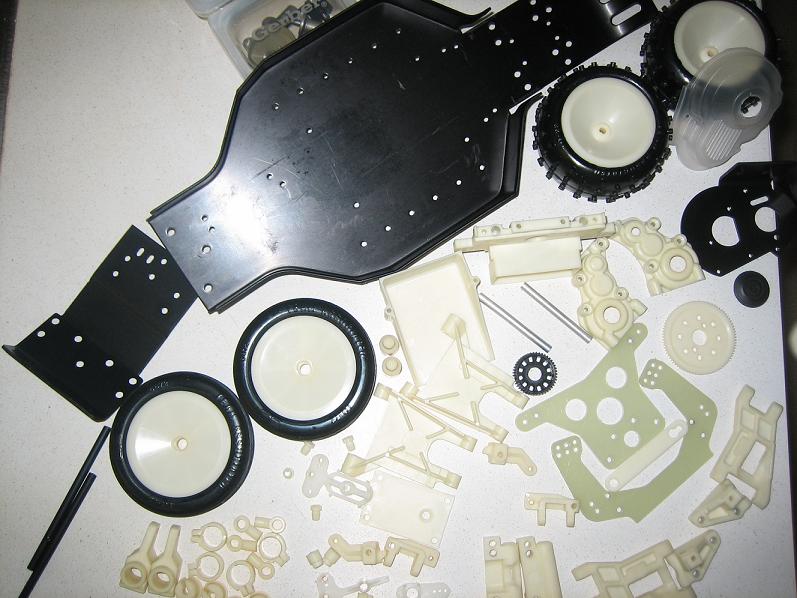

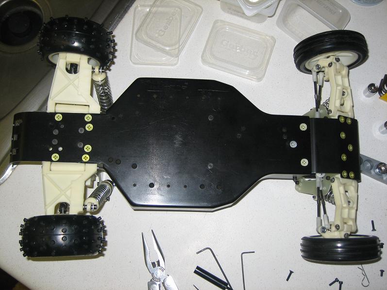

Picked this car up a few weeks ago off eBay. The overall condition looked promising. When I received the car it was 100% intact and in good shape. The car was covered in leaking shock oil, dust, and rust. The tires were unused but marred with old CA glue and looked like they were in the beginning stage of dry rot.
Originally, I thought of replacing all the hardware but decided to clean the current hardware up instead. The only replacements were a new shock rebuild kit and a few missing screws from the original build. I think the results came out well. Especially the tires.

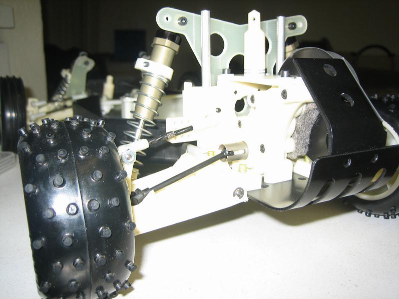

I also want to add...While doing the rebuild I noticed a few things that identified that the car was one of the first Team Cars out.
- "B" code Chassis has the six gear mounting holes countersunk - later versions weren't
- Nose plate is squared where it meets the chassis.
- The stealth came with the infamous slipper thrust bearing (brass ring w/ diff balls).
- The rear bulkhead is the old style with the ball end ears.

Another clue to its potential early-production status is the earlier version Stealth gear cover (without the support ribs).
