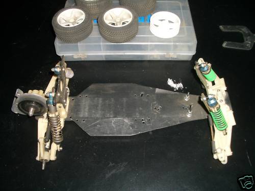

picked this up for $15.00, couldnt resist, new body, not sure if its a trx1 or something else.

You stole that
but then again when someone doesn't know how to list something its their fault
. Congrats. The chassis looks to have been 'narrowed' and drilled but other than that you have a great lookin runner there. Keep us posted on how it turns out.

Show us an underside pic of the car, I would bet it is a composite craft chassis. Looks like there are an extra set of holes just in front of the bulkhead. I presume this is to move the rear end forward to shorten the wheelbase on the car. -Jeff

ya it was called the javelin. i dont know what it looks like whether its a single window or what, but guess we'll see.
i plan to make a new chassis and top plate for this, ala composite craft. just gotta find a source for some carbon fiber with a kickup, im sure i can get some somewhere lol

That is not a javelin body. Or at least not like the ones I just sold on e-bay. They look similar, but do not have the hood scoops. I can post pics if people want. -Jeff

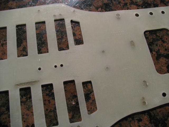

You can fill the holes with some epoxy, so they dont get hung up and further destroy the chassis. Also it will stiffen it up a bit. Here is a pic of an RC10L chassis that I just could not get myself to throw away.

Well
I have a good solution to repare such extra holes.
Put a plate of steel under the chassis, and press it to the chassis.
Put in the hole from the opposite side, a small drop of cyano glue and recover it with carbon powder (usually I file a piece of carbon plate to collect enougth powder). The powder will mix with the glue. And another drop of glue and powder etc...
when you have enougth hard mixture, you could sand the extra material.
That's my tips for such thing
