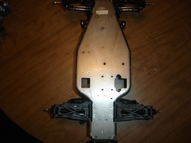

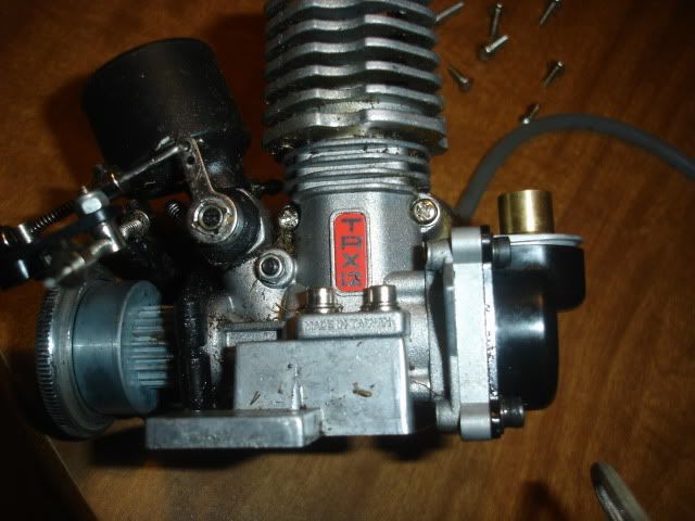

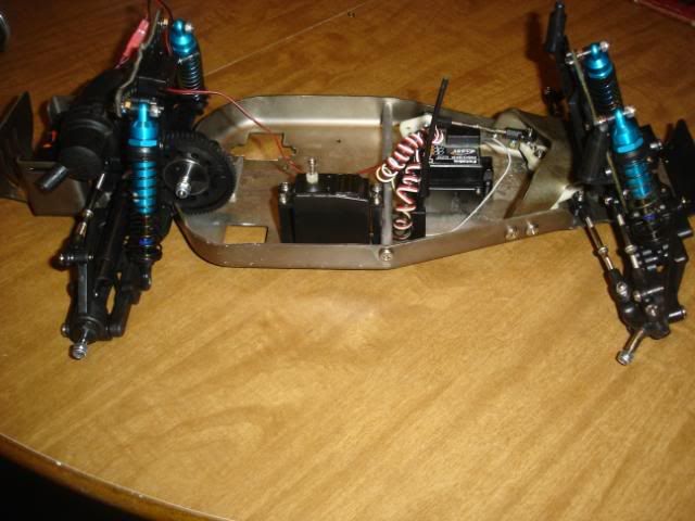

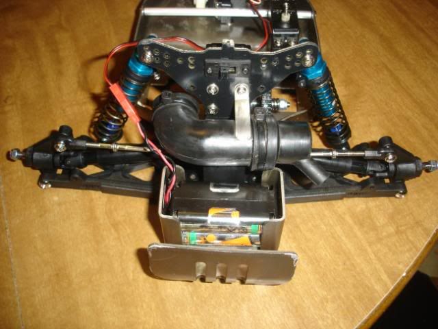

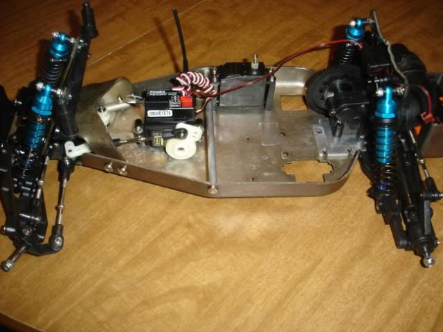

Looks like my wife must have uploaded a few pics by accident.These are during the rebuild process.
