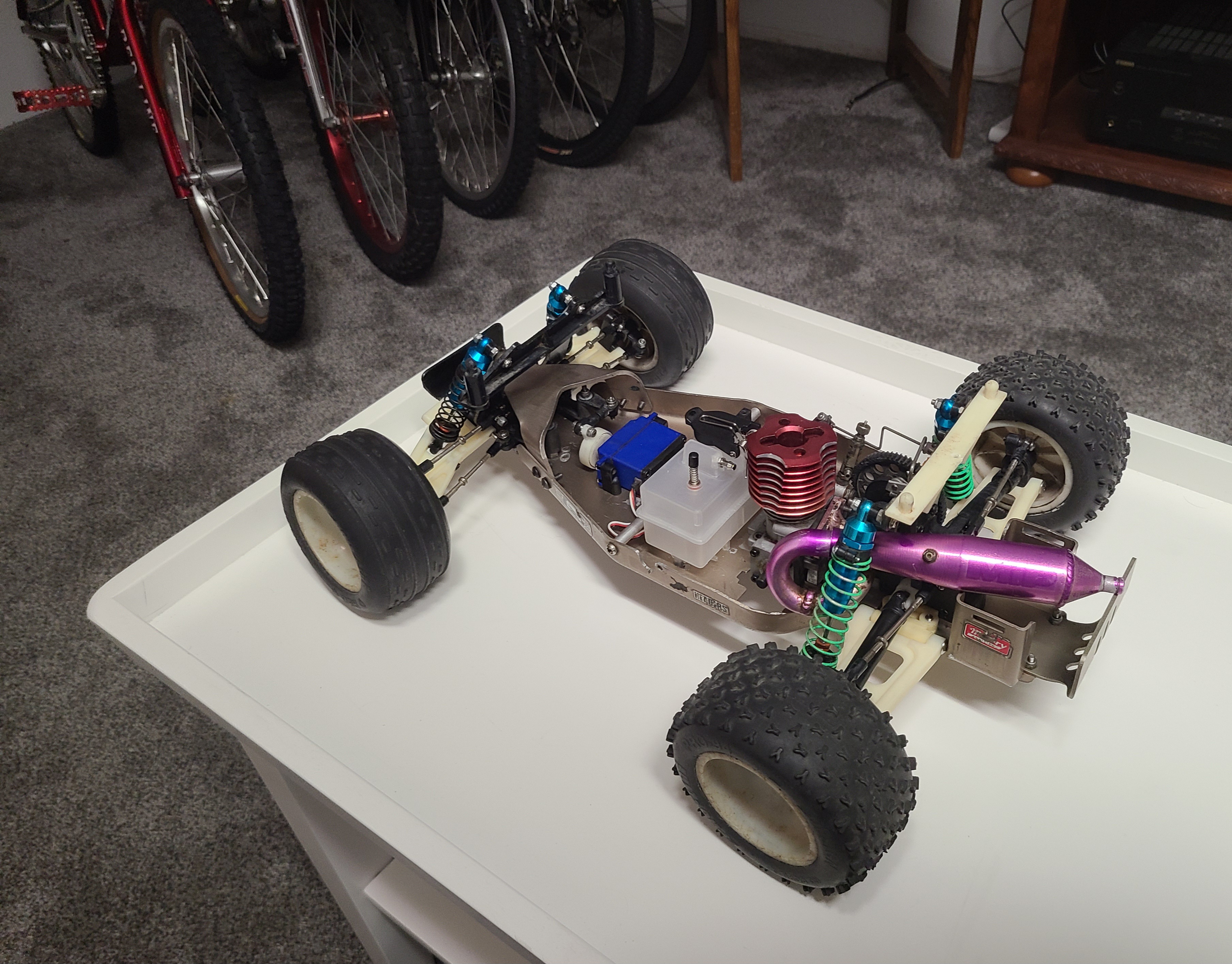

I recently got a wild hair and decided to pull my old nitro hawk out and give it a bit of a freshen up. My uncle gave this to me probably 20 years ago. Back then I modified it for a standard style crank, and put a disc brake setup on from a nitro rustler using the rustler input shaft and some custom brackets. (Huge upgrade from the clutch bell brake, and a lot better engine choices) the steering linkage was also worn out and I used a tmaxx setup.
This time around I pretty much just cleaned it up, dropped in a new 2.5 and some s9351 futaba servos. I've been searching high and low for another dahm's body but haven't been able to find anything. I'm still debating between the tbg nitro hawk body, or the srt body which I like a lot better. The only other thing I'd like to do is modify a rear exhaust header to use the old school mip stinger pipe.
Here's a few pics of it's current state, and one with the old dynamite .12 and mip exhaust.

A rustler body works pretty well but can't say it would work with that exhaust. The new exhaust idea is kinda restrictive to the 2.5 but won't be an issue if you built a shelfer.
Nitrohawks for the win! 8) :mrgreen:

Yea, I figured the stinger pipe would be pretty restrictive on a 2.5. but I definitely need to figure out some kind of rear exhaust setup for body clearance.
