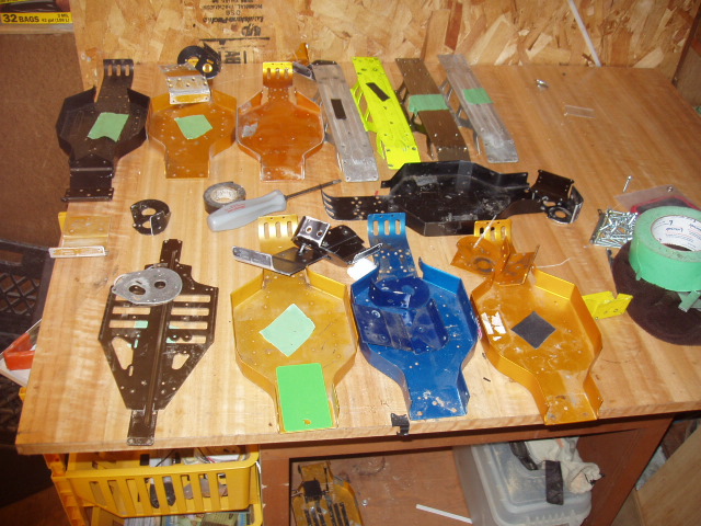

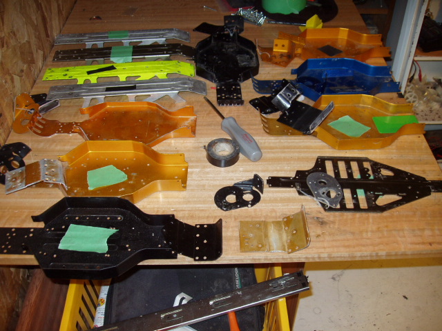

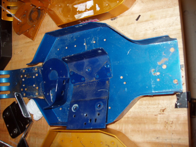

well almost got my pile of chassis ready for the powder coating i have a liberal sprinkling of rc10s kyosho ultimas and a LWB optima mid oh and how could i forget my rc10DS the blue one in the pic is an a stamp but has been drilled for stealth so if anybody wants to swap speak now im still not sure weather i should do the worlds in shinny green or shinny black ?
regards Paul
regards Paul
