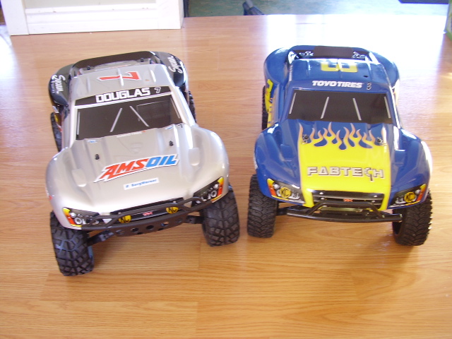

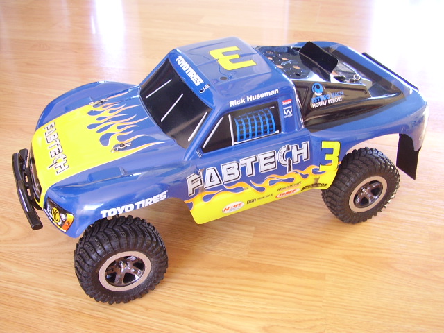

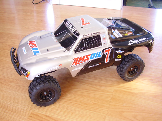

Moving the body mounts work great.I put on a set of 2.2 RPM Revolver wheels with the Yokohama Geolandars and I'm real happy with em!Here are a couple pics of mine compared to my son's stocksetup.
Dave
