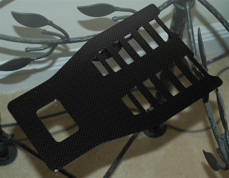

You like carbon look? Perso, I am not a super fan of fiber glass so I covered my 10L chassis with Oracover called in the US UltraCote. No big money here, just a bit of patience and some hand work. Notice, there is a lot of color choices who can match a painted chassis.
You need:
- An iron
- Oracover
- Small bottle of pain + solvent
- Small brush
- charp blade
The trick here, I keep that from a good friend who is into F3A, is to use very low heat to avoid formations of bubbles. You should be able to keep you hand on the iron. You can check his work here: http://www.znline.com
Have all fun,
Mannekenpis.
Nice looking carbon chassis, hu?
Chassis carbon (Medium).jpg (63.81 KiB) Viewed 2180 times

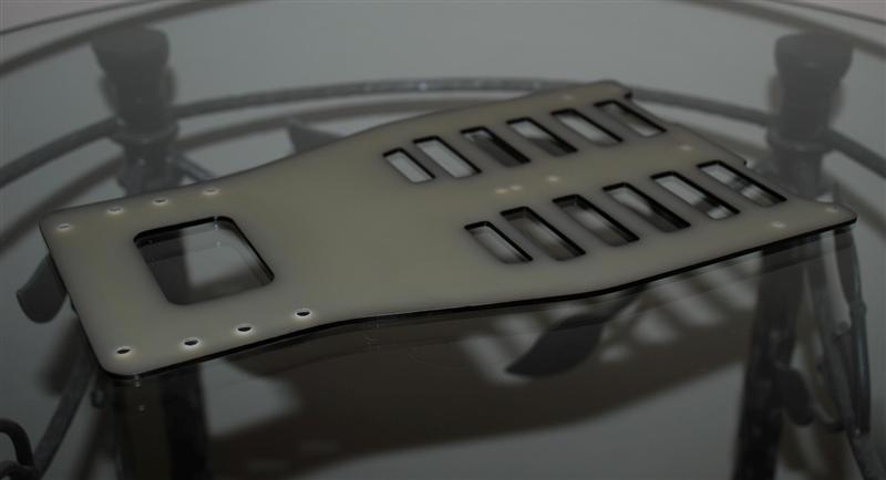

Paint the edge in the chosen color
Chassis fibre de verre (Medium).jpg (30.76 KiB) Viewed 2180 times

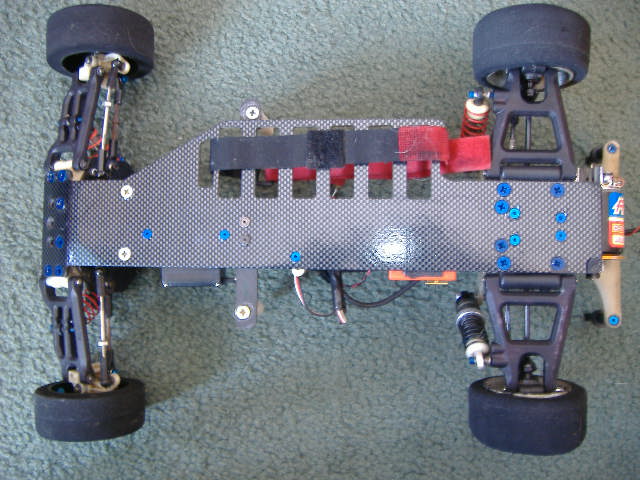

i have done that for a while now but using adhesive backed vinyl in the carbon fiber look.
pancar 031.jpg (69.97 KiB) Viewed 2165 times

Post by tulsa »
most of the vinyl i get is made by 3m and is self adhesive with a backing on it. just peel and stick.the heavier vinyl also works as a chassis protector as it will take quite a beating............

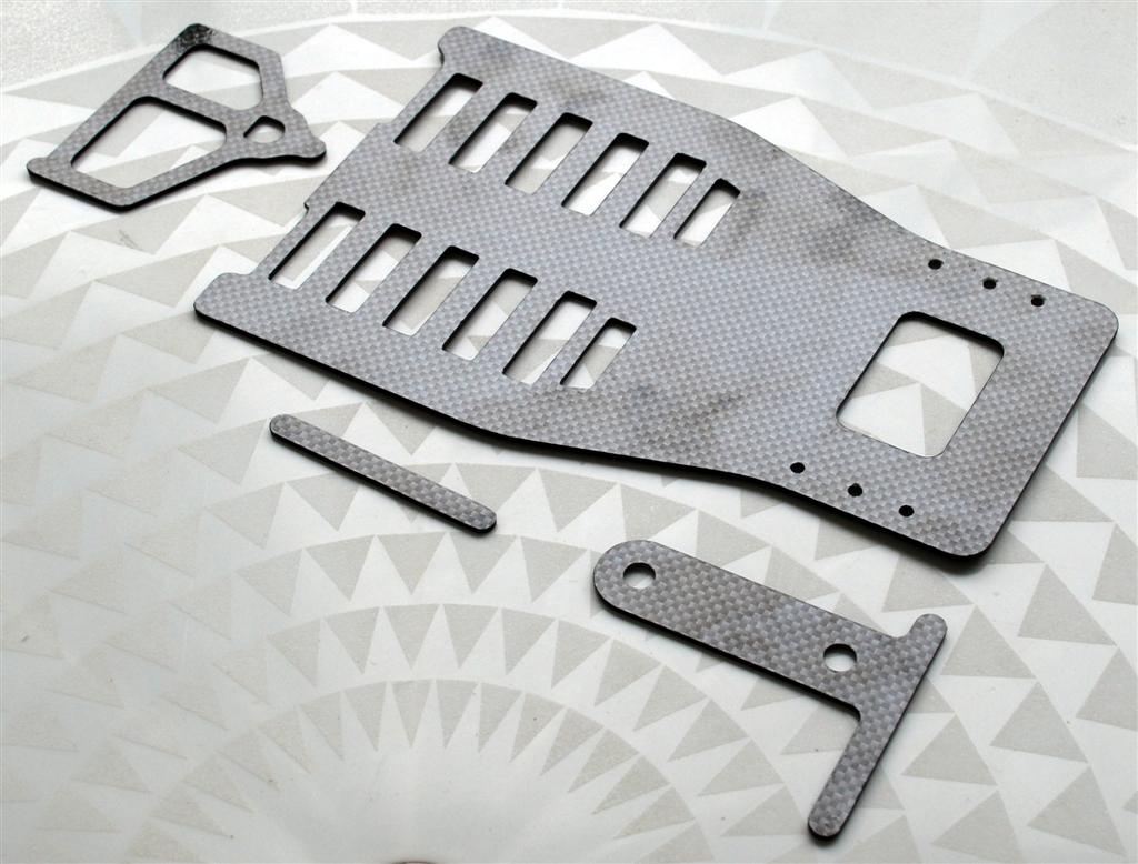

All parts done,
Chassis carbon (b) (Large).jpg (107.02 KiB) Viewed 2069 times
