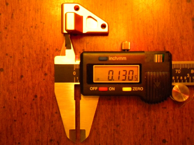

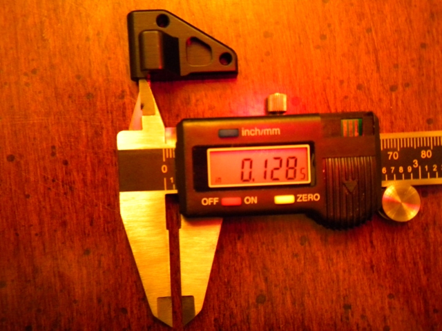

I will be re-coloring a few parts I just ordered from Atlas. I will try to remember to measure the hinge pin holes before and after so that an exact difference (if any) can be definitively determined. I will be happy to report the findings as well as post pics.

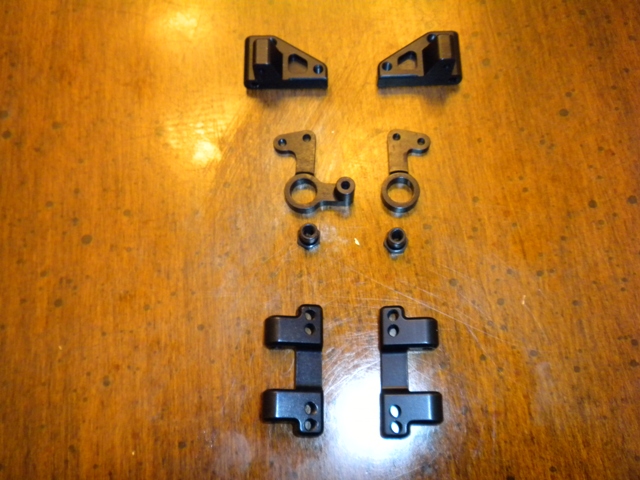

I am not. I have a family member that works for a local plating company. They do all of Kimber's handgun plating so I guess they know what they are doing. I've had some things done with them before and was very pleased. I have digital calipers that I can measure everything before and after.

Here's a picture of the measurement of the hinge pin hole diameter with the gold (as shipped) and the final product in black, after it was stripped and recolored. As you can see the difference is only .002"

That's looks really good...nice to see some numbers to back it up too.
