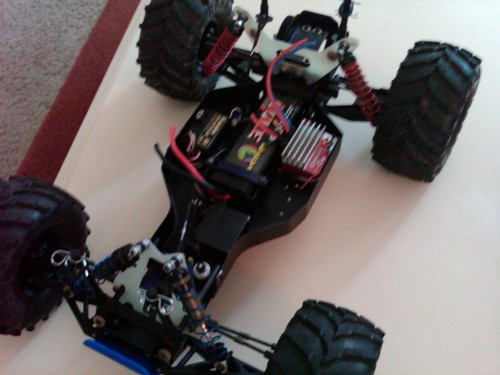

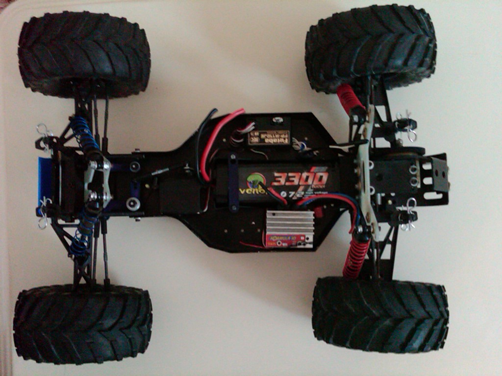

I'm brand new on here but not new to the Hobby. I dug up my old (or what the guy at the hobby shop called "vintage" - made me feel old) RC10T, after seeing my buddys new HPI blitz. My truck is in good shape and I got it up and running with a shock rebuild, tranny rebuild, new turn buckles (old ones were rusted) new 3300 battery pack, new brushes and lots of motor spray. Also updated to the new Deans type plugs. I am thinking of converting it to a SC truck. But I have some questions:
Tires: I've read I need new 3/16 hubs and bearings, are these direct drop ins? anyone have part numbers I will need from Associated to go with the SC10 rims and tires?
Wheelbase: I saw a guy on here made an amazing chassis mod by welding a piece of a chassis onto an existing one to extend the wheel base. Is this necessary? I was planning on just adjusting the body posts, tires and ride height. I am looking at bodies from pro-line made for the new SC10. Any ideas?
Here are some pics of the truck minus the motor. I will put up some more later on.

Hey thanks for the fast reply. It looks like chassis extension may create a weak point in an otherwise solid rig. I think I'll keep it as is. Invest the money ina traxxas waterproof electronic set up (maybe brushless) and just enjoy it. Any A
